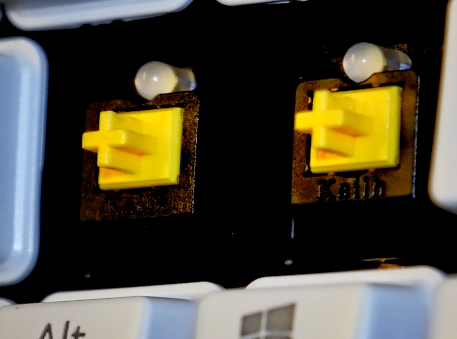

- "Original Factory MX Yellow Switches" -- yellow Kailh switches

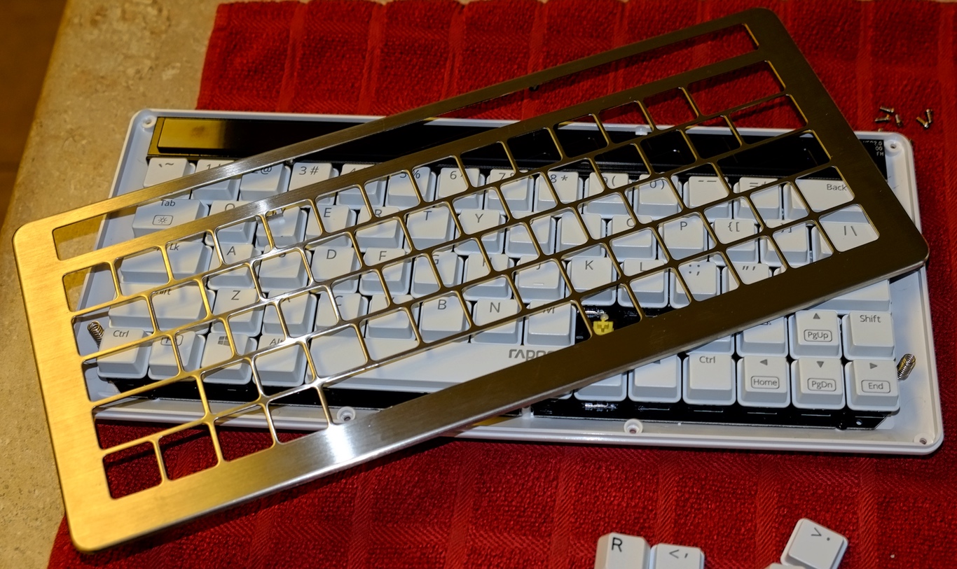

- top frame with its cutouts for each key obstructs easily switching keycaps
- at least to me the aluminum (ok, stainless steel) top frame makes the keyboard look cheaper
- factory keycaps shape
- to replace keys, you need to remove the top frame (personally, I'd like to cut off everything from the center of the panel except the outside frame and frame for the touch panel)

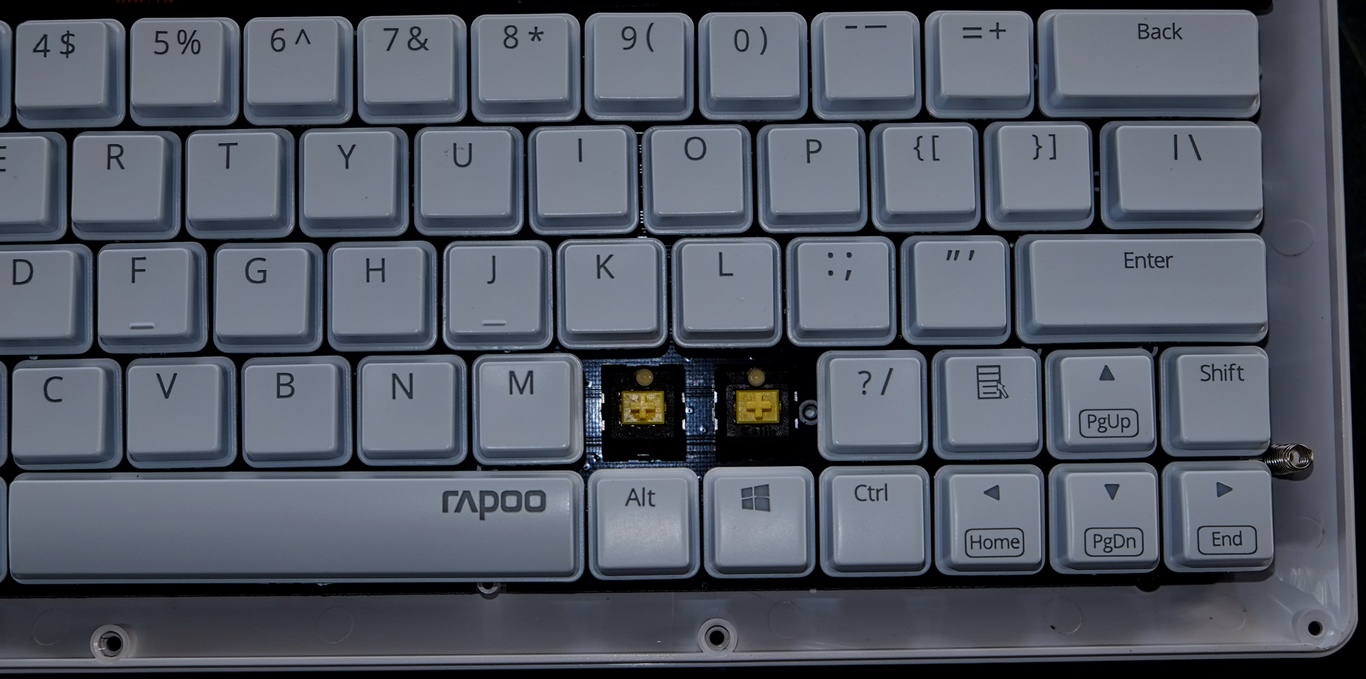

Yelow Kailh:

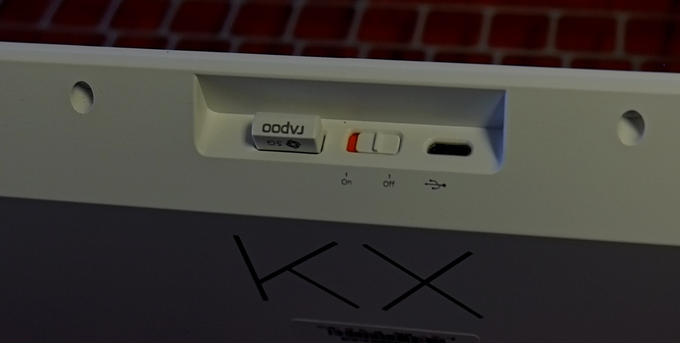

Wireless ON/OFF, micro USB port for charging or wired connection:
Top metal frame:
With metal panel removed:

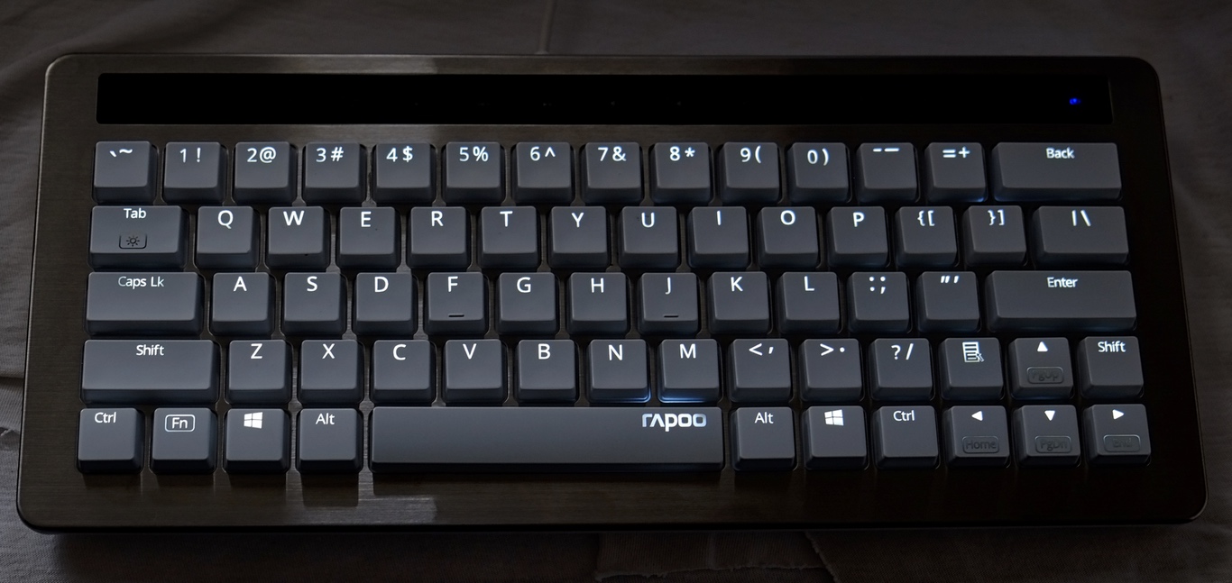

Lights on (lower level of the 2) -- you can notice a slight imperfection by the backlight protruding between N and M:

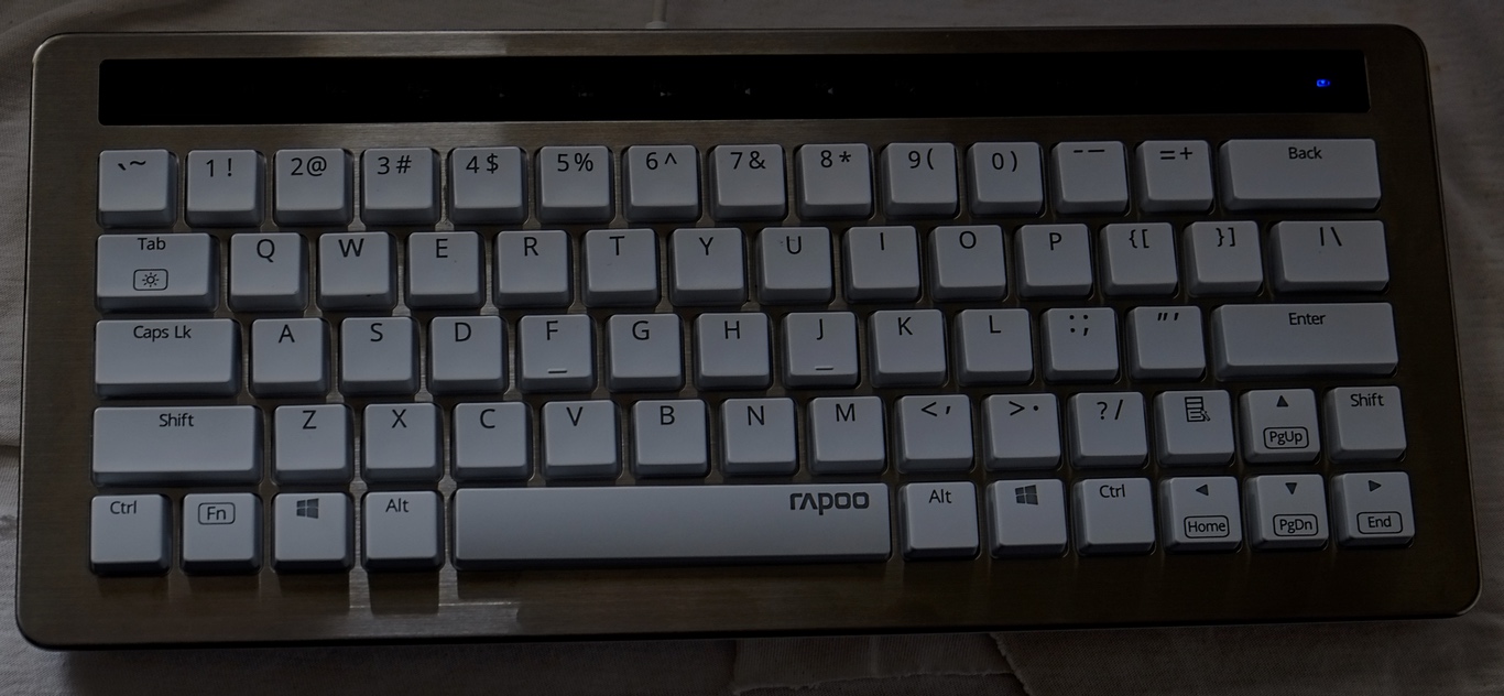

Lights off -- key lettering nicely visible:
Edit: Note -- I haven't seen any "PG1511" markings on the switches (as in some photos posted on other sites; these are clearly marked "Kailh".

Good review and pictures! Is the rectangular thing in the back the receiver?
You could test the top for steel with a magnet.
"5G Receiver".. :facepalm:

Findecanor wrote: Good review and pictures! Is the rectangular thing in the back the receiver?
I think it is, if you're referring to this:
It's one of those micro receivers (like Logitech's unifying receiver), quite cool that the keyboard comes with a storage cubby for it.
