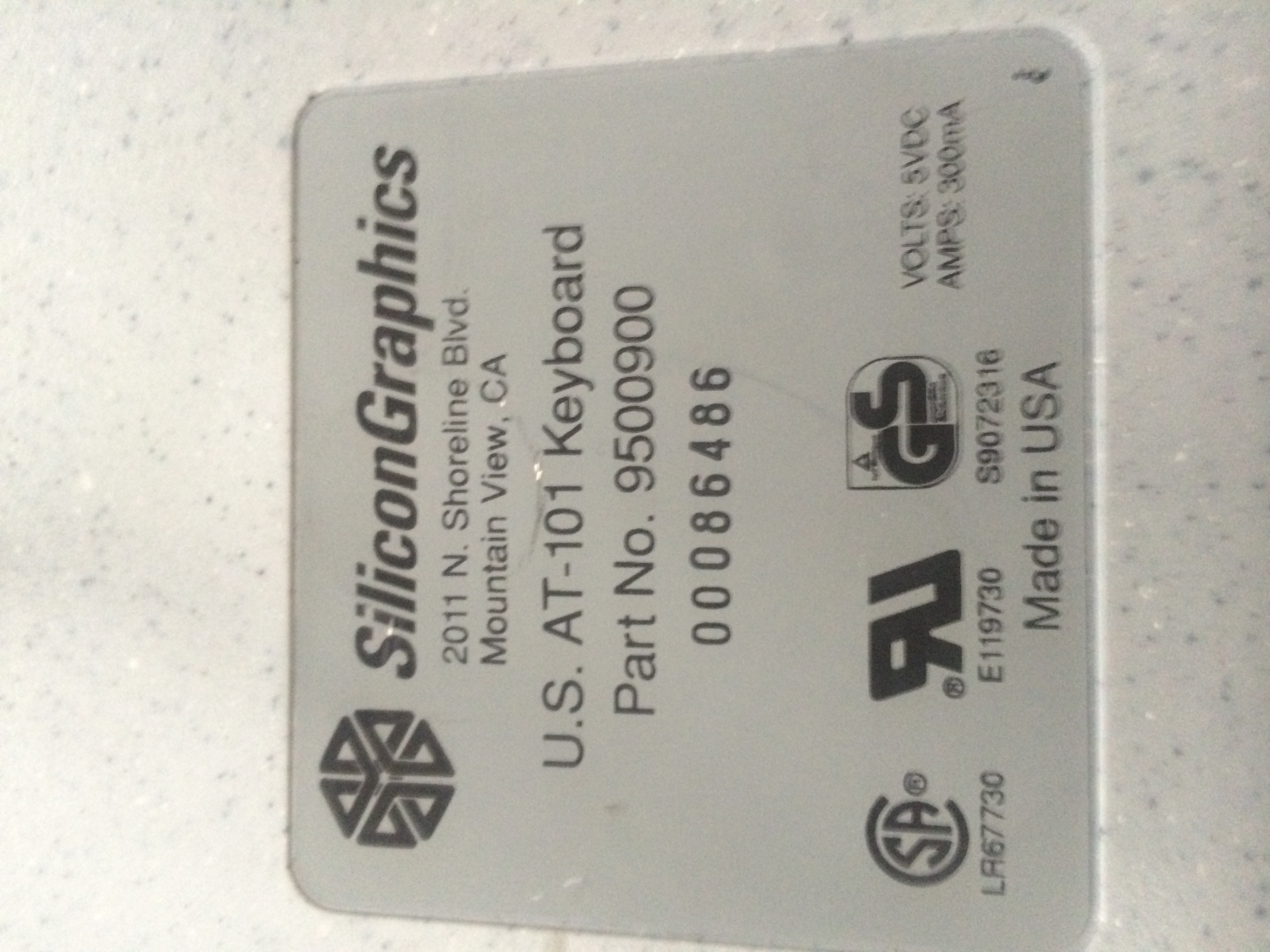

This is what is on it's back, hope it gives any clues.... I reused it's carcass to build the a clicky matias SGI :-)

Clicky Matias SGI? Did you reuse the original PCB / controller? Matt3o's after stabiliser measurements so we can design our own Matias custom keyboards. The tricky part is that we must reuse harvested caps, like you did.
That part number begs a simplistic interpretation of what year this came from!

Mrinterface wrote:This is what is on it's back, hope it gives any clues....
Maybe to an expert — I was referring to the dates stamped into the case mouldings. I wonder why some Bigfoot keyboards have them and some don't, maybe it depends on which factory made them, as the SGI keyboards were made in several.
25 Feb 2014, 19:44
Muirium wrote:That part number begs a simplistic interpretation of what year this came from!
The part number acts as the model number. 9500900 is the "Granite".
