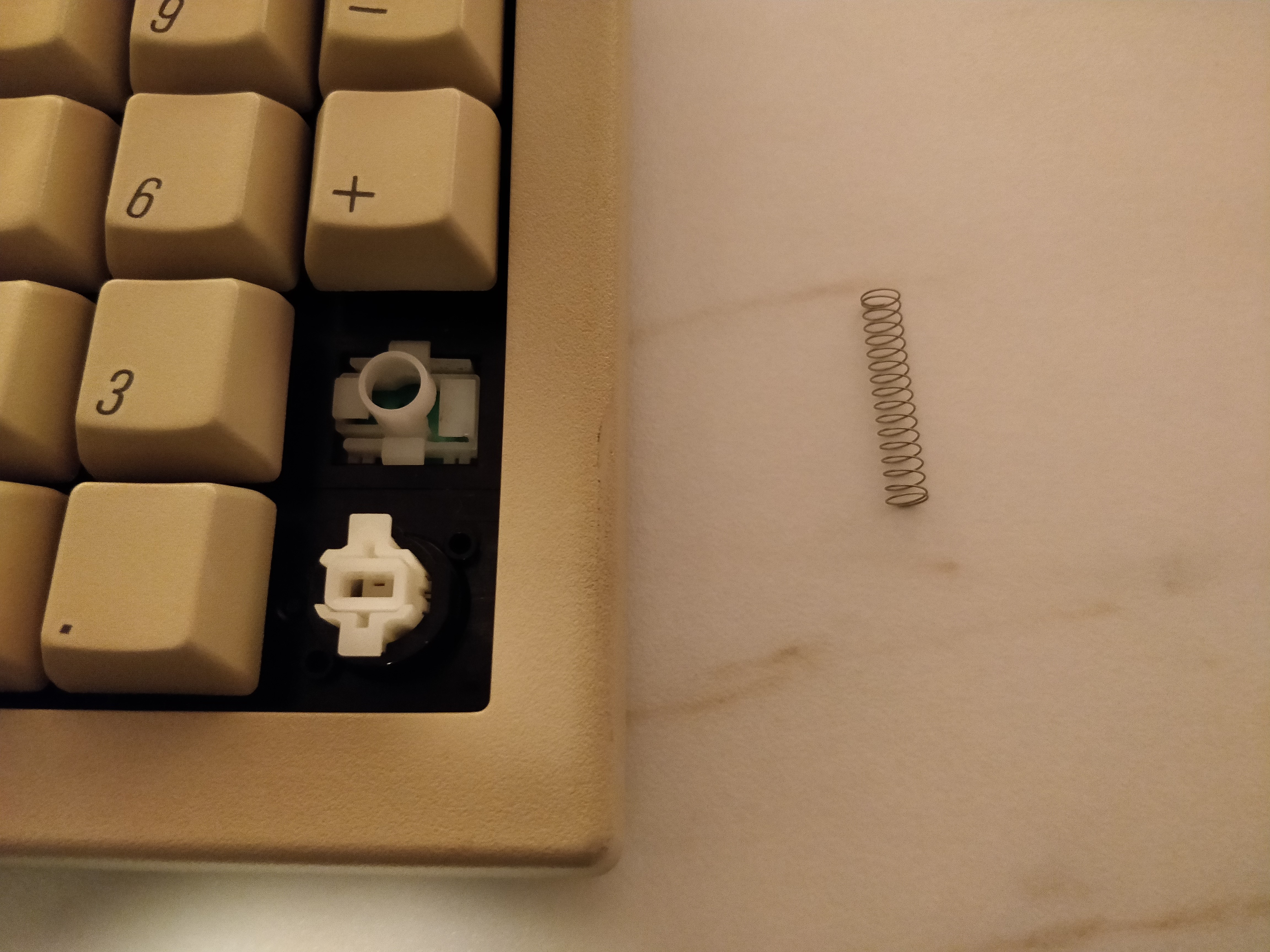

I've got one of these with white switches. Probably a stupid question, but where does this spring go? I'm fairly sure (but not 100% sure) that it's got something to do with the numpad enter.
What seems obvious, putting it in the hole on the upper part of the enter key, doesn't work. There's a plunger on the key which goes right down to the bottom of the hole and leaves no room for a spring.
I wish I'd paid a bit more attention when dismantling it for cleaning. I thought it'd be obvious how everything goes back together.

I think that it goes under the spacebar. I pulled the numpad enter on mine and there is no spring there just a short wire stablizer. but if you pull the spacebar to the right there is a place for a spring.
It's not the spacebar spring. I have the correct one under that key (it's a little smaller than the one in the photo).
So your keyboard matches mine with the same keyswitches? How strange. I'm sure the spring flew out when I removed the numpad enter. Maybe it wasn't even supposed to be there, and it fell down between the keys at some point and got stuck there...

Mine has yellow sliders instead of white. but other than that it looks the same. I checked under all of the large keys and the only spring that I saw was under the spacebar. Underneath the sliders there are also smaller springs which actually actuate the the switch(?)/membrane(?). Try pulling the sliders. They just pull straight out. You might be able to fell a missing spring by looking for a difference between key feel after the dome collapses.

Alternately, if you have either an ADB converter, or an old apple computer with ADB you could just look for the switch which doesn't actuate, or actuates lower than the others.
The sliders all have their springs installed. The keys feel okay when pressing down too. I got the keyboard just recently and it was pretty dirty so I totally dismantled it for cleaning. This spring is the only part unaccounted for.
If yours doesn't have this spring anywhere then I'm leaning towards it's not even supposed to be there and a previous owner dropped it down between the keys. Although, it seems too wide to fit between the keys... But I can't think of any other logical explanation.
I'll just leave it out then. Maybe I'll tape it to the bottom of the keyboard just in case one day I need it.
