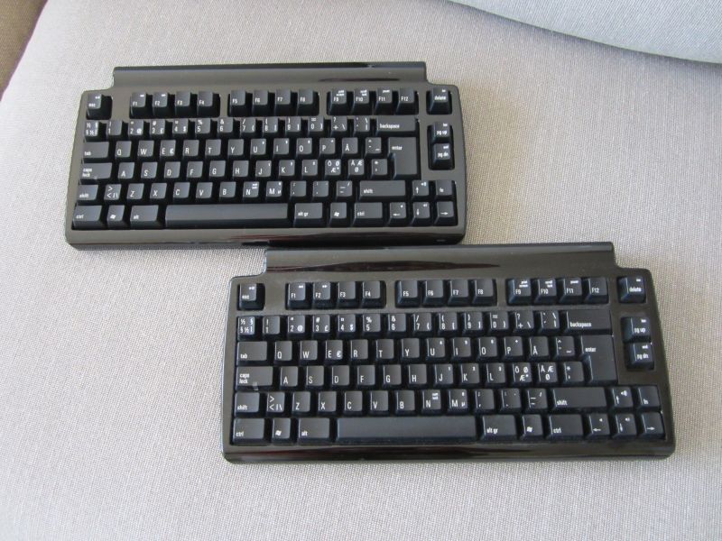

The Matias brothers, almost identical
These two compact keyboards are nearly identical: the other one is wired and the other wireless. If you place these boards side by side without any cables attached you cannot tell the difference. The shiny plastic shell is a bit of a turnoff for me aesthetically, but it’s something I can get over.
First of all, the switches are magnificent. They are the best tactile switch I’ve ever typed on which is why I have almost completely abandoned Cherry and Topre. The keycaps probably aren’t the highest quality but still feel quite nice and durable.
The Fn functions in these keyboards are identical. While some of the key placement is very well thought out, the rest is not very much so. The volume cluster in the arrow keys deserves all the praise I can give. Print screen, scroll lock and pause are located in the F9-F11 keys which is nice - you still have them but they’re not wasting space on the keyboard. I also quite like the placement of the delete key.
Having Home and End keys under Fn is just unnecessary and inconvenient. They could have easily fit another column of keys next to Page up/down and given dedicated keys for Home and End. The Play, Fwd and Rwd keys are located on ESC-F2 which is not very useful.
Unfortunately, the integrated numpad function (in the JKL cluster) is absolutely useless. You cannot lock it into numpad mode like you can in Topre 87U, instead you have to press Fn and the corresponding letter each time you want to produce a number from the numpad cluster. Firstly, the reach from Fn to the numpad is quite a stretch (I have long fingers and still struggle) and secondly this defeats the purpose of having an integrated numpad.
The Secure Pro has an excellent battery life provided you remember to turn it off when you’re not using it. I, unfortunately, often forget to do that and therefore get a battery life of approximately 3 weeks in one charge. An auto-off feature would be a really nice addition to this keyboard, but I’m not really sure how that could be implemented. The Secure Pro can be used while charging.
The wireless reception is great even with some distance making it a nice keyboard for a media center. I had my doubts about the tiny nano receiver dongle but it seems to work very well.
In conclusion, these keyboards are so nice to type on you can easily forgive some of the not so successful design choices. Home/End keys in the navigation cluster and a little more thought on the Fn keys, and this would have been the perfect keyboard.

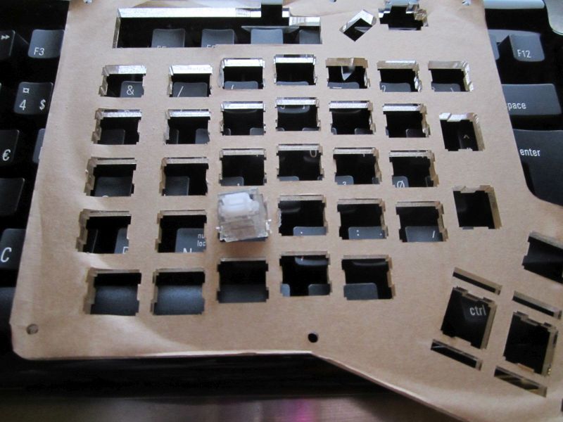

Funny you should mention the Tactile Pro and programmability. I'm building an Ergodox with Matias clicky switches at the moment. I haven't really tried the switches on a complete keyboard, only on a switch tester board I built from a cannibalized Alps board earlier.
The problem I have at the moment is that the acrylic case I received with the Ergodox order is designed for Cherry switches. There are these little tabs of acrylic I have to file away in order to make the Matias switches fit. It's going to be even more tedious than soldering SMD diodes, but what can you do.
I will surely report back once I've finished the build.
