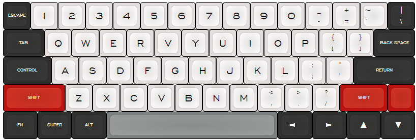

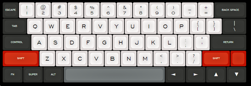

I'm building a 60% custom board with PCB, ergo clear... At the beginning I couldn't find key caps for my custom layout. After looking for Round 5 leftovers, luckily I found a layout with the right combination of colors for me, see the below image. At the beginning, I bought blanks key caps but I don't if I should sell them.
This is one of the combination, I've bougth several extra keys to change the layout and color.
Seeing your custom 60% keyboard, it was a inspiration as Matt3o's keyboards, but making a custom layout I couldn't decide to the get Macross set because it didn't fit with my layout, same for Granite set. Always, the issue is the lack of key caps.
So I'm thinking, do I need to re-invent the wheel? In the future I'm thinking to try the CM NovaTouch (after selling my noppoo choc mini), with a standard Tenkeyless layout, and I need to decide to stock or not keycaps for that one... My wallet hurts when I think to buy each part of the keycaps in small sets for make the right color combination.
I'll love to try ALPS (Matias Quiet), that one will hard to make a custom layout. If I try it, would be a hybrid: MX cherry and Alps.
28 Apr 2014, 23:48

mzero wrote:I'm building a 60% custom board with PCB, ergo clear... At the beginning I couldn't find key caps for my custom layout. After looking for Round 5 leftovers, luckily I found a layout with the right combination of colors for me, see the below image. At the beginning, I bought blanks key caps but I don't if I should sell them.
Great layout! Are you already committed to the 1.25x arrow keys? If not, by going 1.00x, you get more choices of caps for the cursor keys, and you gain an extra 1.00x for the right side of the spacebar, perhaps for an extra mod key. Another option is to change Backslash to Backspace and split the current Backspace key to become Backslash and Backquote/Tilde.

rjrich wrote: Great layout! Are you already committed to the 1.25x arrow keys?
That is a PCB constraint (duck mini v1.5), and about the [Backslash and Backquote/Tilde] instead of [backspace], I have to think it about because I have to mod my "universal" plate and I wouldn't like to buy a set just for a key, I've already paid my R5 order. I cannot live with arrow keys when I do program, this will be my work keyboard.
Muirium wrote:That's a very sharp colour set you've got there! I'll totally try it on my 60% when the caps arrive.
Thanks! luckily I could get them and there was not more options for 1.75x Right Shift, I've also get the gray ones, the blank 1x key cap next to the R-SHIFT is ok, because it seems to be part of the R-SHIFT in my opinion.

HKKB was my reference, so I couldn't get Round5 BACKSLASH and TILDE in the exact position as the HKKB, and also there is not 1.5x black DELETE button (not know if they were any), but I think I can live with that :geek:
Backslash is at the end as it was in the row two, and TILDE, I use it for "Ñ" that was a issue this layout, because to get it was pretending to use [FN]+[SHIFT]+[ESC]
The blank red will be mainly [ALT GR], but it could act as an extra [FN]
So for me, the anwser is "Not be conservative", many thanks guys for your time

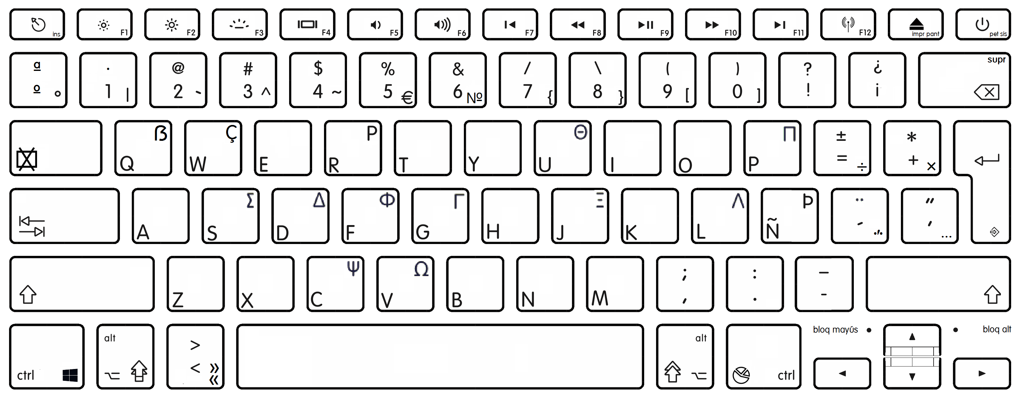

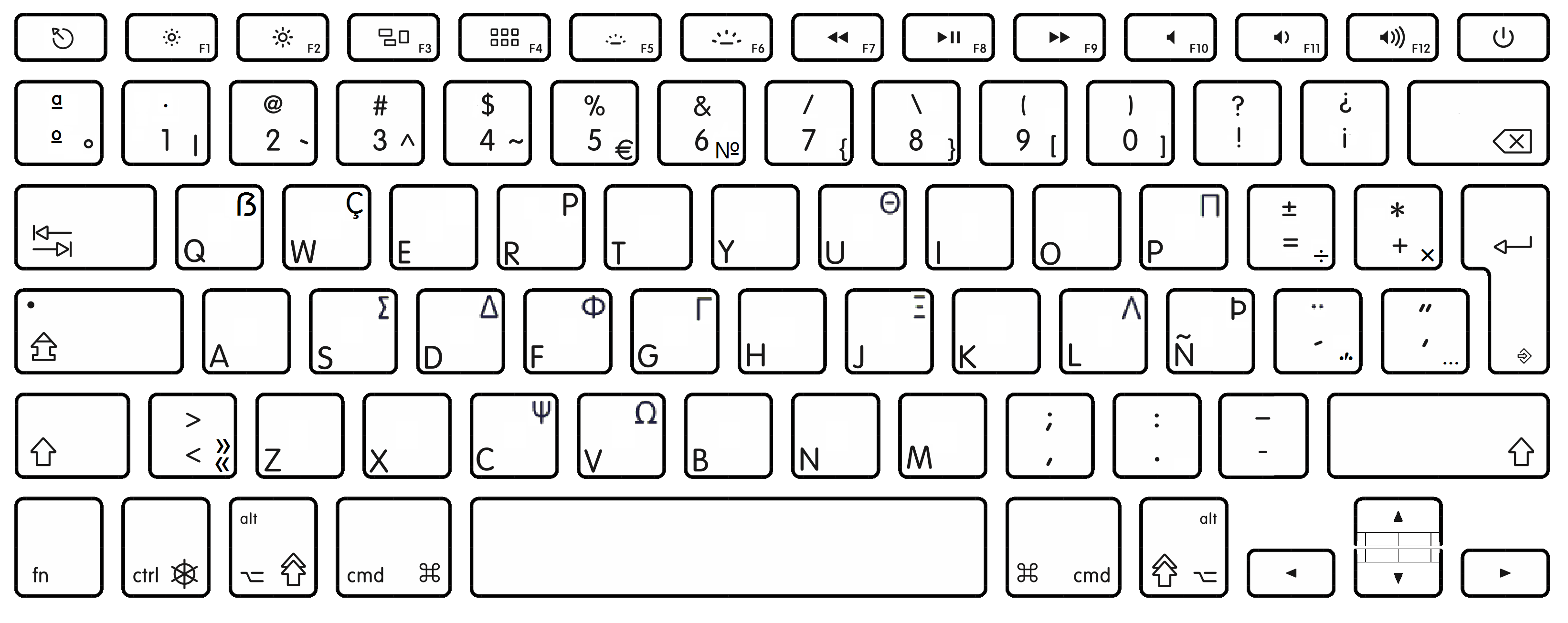

Hi, I am new in this forum and I want to share my creation with you. The base keyboard is Spanish Mac but I have tried to create a Multilingual keyboard. I leave two versions of my project: the first only changes letter keys; the second changes function keys too. Are these:
Spanish Layout.png (217.92 KiB) Viewed 6149 times
Spanish New Layout.png (217.14 KiB) Viewed 6149 times
I also create symbols to express the functions that I would like in it. I will explain them all if you don't understand it. Following the second image:
· The arrows in the left alt means Compose Key and it allow you to add more keys pressing a sequence of keys.
· The arrows in the right alt is a fuction key to add the letters in the corners of the keys holding it. (Like Alt Gr).
· If you push both Alts you will lock function key. (Alt lock "bloq alt in spanish").
· In Alt lock mode Shift and Alt keys exchanges their function.
· The Windows logo is the Windows key. If you hold it work as Control functions (or Alt functions if in that key don't exist Control function).
· The broken circumference opens the Task Manager. (Don't more Ctrl+Alt+Del). If you hold it work as Alt functions (or Control functions if in that key don't exist Alt function).
· If you press both Shifts you will lock caps. (Caps lock "bloq mayús in spanish").
· The key in the left of Q is the clear key and removes everything written.
· Push Shift+Delete is like push Del key.
· Symbols of FX: F1 and F2 changes the brightness, F3 turns on/off the ilumination keys, F4 toggle video mode, F5 and F6 are the volume controls (if you hold F6 volume was turn off), F7 to F11 are media keys and also (F7 home key, F8 page up, F9 pause and break, F10 page down, F11 end key), F12 turns on/off Wi-Fi.
· The key in the right of F1 is Escape (Alt+Escape = Ins key).
· The keys in the left of F12 is Eject and Power off. Eject allows to remove disc or usb, sdcard, etc. with security. Power off allows to shutdown, suspend or hibernate your PC.
· If you push Control+Arrows you will change the orientation of your screen. If you push Alt+Arrows you will insert arrows when you are writing.
· Supr means Del, Pet Sis → SysRq, Impr Pant → Print Screen.
· SysRq opens the CMD, terminal or command.
I hope to you like it.
PS: I'm not very satisfied with the positioning ot the ΅, Þ, ° and № key.

You have some nice ideas in there, Lynxeon. Using both of a pair of mods to make a lock is a very natural concept. Shift+Shift=Caps certainly works very well, as I use it too.
Unfortunately, Apple's layout creates a lot of problems for making it yourself. The half height keys (arrows and function row) are all impossible with mechanical switches and caps. Apple's skinny ISO Enter is also impossible to source a cap for. And the slight staggering they use on the function row is a problem too.
When designing mechanical layouts, you really want to use a 0.25 unit grid. Alpha keys, like Q, are 1 by 1 unit squares. Modifiers are typically 1.25 units. And space bars are commonly 6.25 units. 4.5 units is rarer, but possible. However, I've never seen 5.0 units available anywhere.
Here's an example of what's possible:
You'll find many more ideas in our group build thread here:
http://deskthority.net/workshop-f7/grou ... t7474.html

Thanks, but my purpose is create a theory keyboard and not a mechanical keyboard. Would become a reality only if anyone made in bulk.
08 May 2014, 22:12
You might be able to implement quite a bit of your logic using an Apple keyboard and KeyRemap4MacBook:
https://pqrs.org/macosx/keyremap4macbook/
There are similar remapping apps for Windows, too. Perhaps they can be scripted to try it out.
