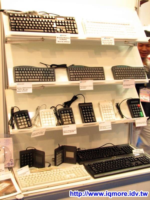

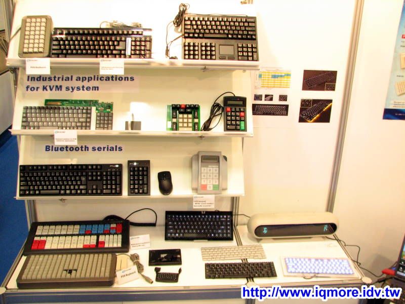

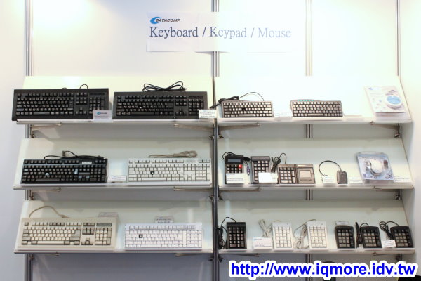

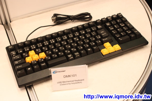

Hi m8's,
Met with Datacomp in Taipei, an OEM manufacturer (input devices mostly; POS, industrial, consumer) and thought id share some pics and a video with you. They have an alps type switch range they call datacomp switch (xiang min maybe?). Here goes:
Pics:
Apls type switch with RGB, video:
15 Jun 2014, 13:38
Intriguing. The DPK62A has a great layout, I wouldn't mind trying one of those! And the Alps mount caps on the white board above it would have lots of takers in the custom keyboard community over here for Matias boards. See if they'll sell you a box load!

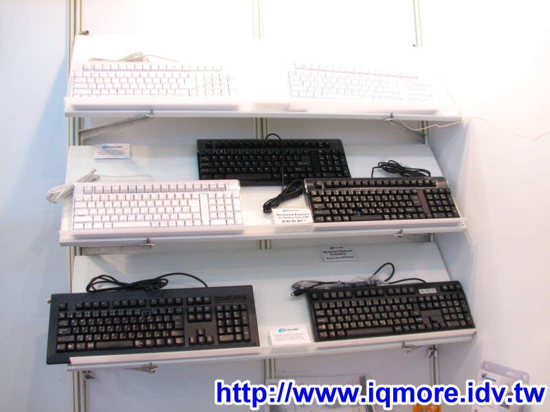

15 Jun 2014, 13:44
Those ALPS caps look lasered to me. Hopefully they're producing some better ones too.
Edit: They do mention "double injection" keycaps, but the picture shows Cherry MX mounts. Ho hum.

scottc wrote:Those ALPS caps look lasered to me. Hopefully they're producing some better ones too.
Ya that white board was pretty basic with lasered caps but apparently they also do doubleshots.

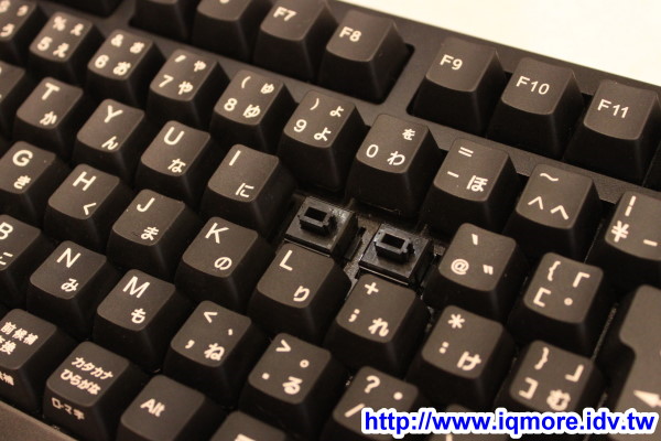

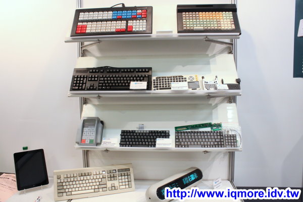

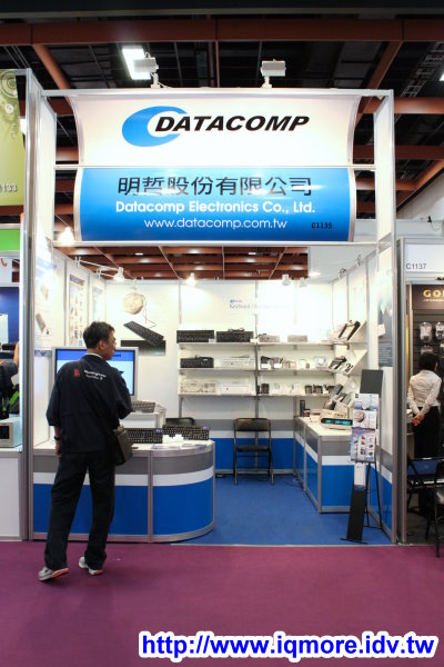

15 Jun 2014, 22:53
Somewhere in my photo archive I've pictures from a Datacomp expo in 2009, where they are showing at least the black variant.
15 Jun 2014, 23:18
Forward didn't stop making switches until 2012, so a switch from 2009 should not be the same product line. Unfortunately I know very little about Datacomp keyboards, and Datacomp aren't exactly forthcoming.

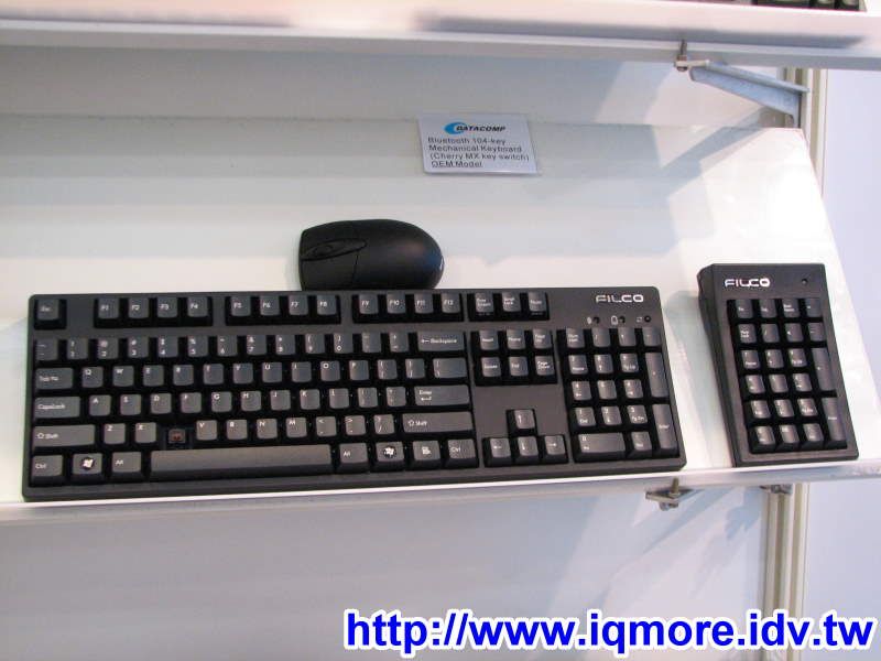

15 Jun 2014, 23:41
16 Jun 2014, 00:11
Wait, what has Filco got to do with Datacomp? (Plus, that being 2009, are those the 2KRO keyboards, with silver Filco logos?)

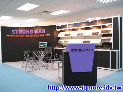

Strong Man used to describe their keyboards as having "Strong Man" switches, and thus far there is no evidence to support that any such switch exists. I've seen photos of the "Strong Man" switches in the Tactile Pro 2.0 (I think — it was someone on IRC and the images never got uploaded anywhere) and they're SKBM switches, from the same moulds (completely identical to those on my Tactile Pro 3 except with grey sliders). The other "Strong Man" switches were just Hua-Jie AK series so far as I can tell — they don't look any different from stock AK series switches.
Unfortunately, while even a luddite such as myself only has a "mere" 5 MP camera, so much of the world still clings to tiny little pictures like everyone's still on dial-up, so those new photos are still useless, as I can't make out enough detail. While it's true that they're Alps-shape, I can't get a clear look at the mould numbering to confirm or deny whether they came from the same moulds.
16 Jun 2014, 00:13
What the? That's most of the same stuff Kayvee saw just now. And this was all 2009? We need to get Mr. Beardsmore embedded in Taiwan…
The sight of those itty bitty Alps mount space bars, my goodness!
16 Jun 2014, 00:28
Most of the file dates are from 2009, one or two from 2010 and one from 2011 (strongman). But it may be old anyway, I think I visited that url again and saved some pictures. There are some Cherry boards there as well. Datacomp made the bluetooth Filco which was only available in Japan.

dorkvader
16 Jun 2014, 06:25
Daniel Beardsmore wrote:Wait, what has Filco got to do with Datacomp? (Plus, that being 2009, are those the 2KRO keyboards, with silver Filco logos?)
that is the bluetooth filco. I have one I desoldered for someone. I guess Datacomp OEM'd it.
I can take picturs if you like.
It's the hardest thing I've ever had to desloder. They used some exceedingly bad solder on it. Typical filco excellence otherwise.
I thought the bluetooth filco was more "known" or I'd have posted about it.
16 Jun 2014, 09:27
I knew of it, but I don't recall anyone previously mentioning that it was a Datacomp OEM. It's not covered on the wiki either, and I don't recall ever seeing any photos of the inside showing whether the parts are any different.
The assumption that everyone just "knows" everything makes no sense, and it makes doubly no sense if you assume that something undocumented is just "known".

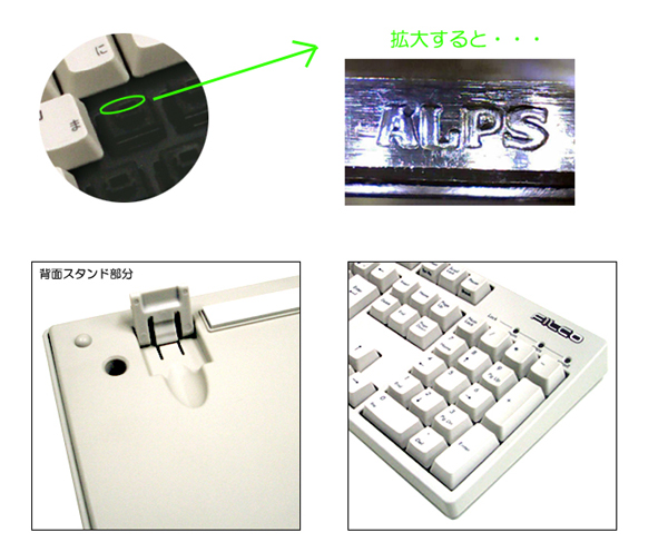

Do you know anything about the reappearance of the ALPS branded switches in 2010/2011? Back then when Diatec first announced the full-size Filco boards for the Japanese market? They were very clear and proud of the fact that they were using genuine ALPS branded switches, which were obviously long out of production by then.
Now that we know that Diatec/Costar sourced their ALPS switches from Forward, could we assume that maybe for some extra money they dug out the old molds with the original logo again?
From the Diatec press release in 2010.
I always assumed they had just found a bunch of spare new, old stock switches back then. But now with you having researched all this stuff, I really do wonder if maybe those switches were actually produced in 2010...

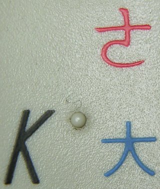

They look good for lasered caps, but they're likely that drill-and-fill type of lasering. The symbols completely wore off my Ducky 1008XM on several caps done that way.
