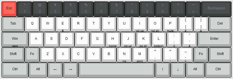

In the meantime, inspired by your works and custom keyboards, I'm just thinking of how my perfect keyboard would be. I love 60%s but I really need the arrow keys as I use them a lot in graphic design. At the same time I don't like 65%s. I've seen a photo of a keyboard with the arrows at the sides of the spacebar (I can't find it anymore, if you know about keyboards like that please link me to them) and made a lot of layouts using that concept...
http://www.keyboard-layout-editor.com/# ... ec97bf3d37
This is the most complete layout I've made, it's an US layout, but in my language I really need accents so I side-printed some symbols on certain keys. I'd like to access them using RAlt or atleast Fn. Would it be possible via firmware on a Teensy? Or should I do that via software with AutoHotKey?
Another problem would be the 4,75u spacebar, does it exist or should it be 3d printed ad-hoc? Are there any standard measures for spacebars?
Do you have any other advice about this layout?

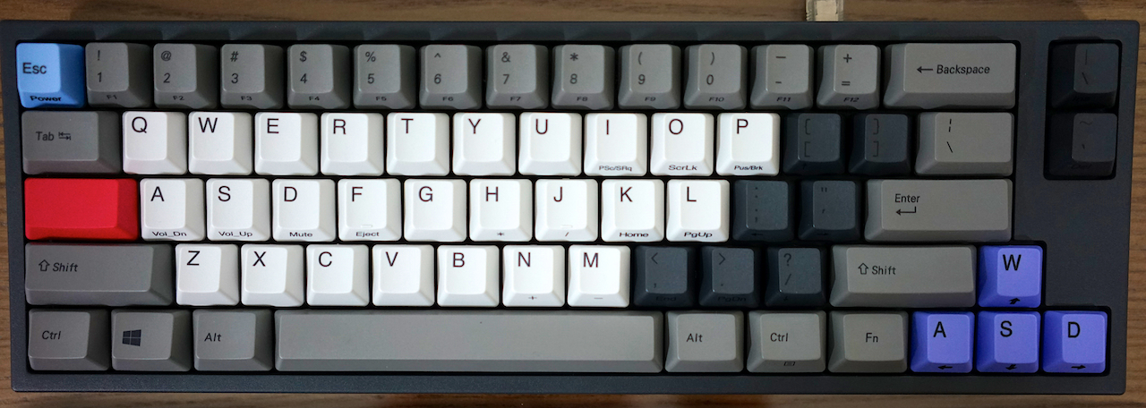

Another layout I like is this one:
I don't know if it should be called a 65% or what, but is this a custom keybard or it's available in the market? I prefer the 60% form factor but I can't stand the arrow keys on a Fn layer, so if I decide to buy a keyboard and not making it myself this could be the one.

Let's start from the end. The keyboard with the arrow cluster you posted is a Leopold FC660C, It's a topre capacitive keyboard. You can also find the FC660M, that is built around MX switches instead.
I like your design, I don't know if it would be comfortable to use the arrows that way though. Unfortunately I don't think you can find 4.75u spacebars (even though from the pic it looks like a 5u), 3D printing is quite expensive even for small items and I would suggest to just rezise it to a more standard unit. In the DSA family you can find 6u spacebars, in SA even 3 and 4 units, in DCS 4.5, 5 and 6 units. All profiles have of course 6.25u and 7u.
This is what I recently built myself (and in the upper corner you can spot the 660C)
I love this layout but I understand you prefer a more compact layout.
The layers can be programmed directly in the teensy, so no need to mess around with the software. Regarding the spacebar specs just let us know which one you choose and I'll let you have the stem position.

Maybe you could change matt3o's design: position the arrow keys a bit to the left - to get rid of the 4 keys on the right border. Than it would be more 60%. But i think the 4 keys there could be handy: for example PAGE UP and DOWN?

I'd get a Leopold FC660M to see if you like it. You're investigating several significant changes, all at once, and that will give you a valuable test. Compact layouts and mechanical switches are both big leaps.
Here's the thing about custom keyboards: they cost more than commercial models. I love my custom 60%, because I tailored it precisely to my needs so it's so much better than a Poker. But it is more costly, in components as well as quite a bit of time.
Caps are the crucial limiting factor for layouts. Unless you like typing on blanks (which is quite cool actually) you are limited to designing around their constraints. Space bars only come in a few sizes (really, only 6.25 units is mainstream) and many keys are difficult to find in any variation from their standard width and row. I would usually point you to one of the great Group Buys that we have for high end caps with custom size support, but Round 5 and PBT Granite are closed, and GMK Dolch is very expensive. I doubt you would like to pay more than a Poker for your caps!
So here's my actual advice. Find a switch tester, so you can try the MX line. Full keyboards are better, if you prefer! Find whether you like linear or clicky or tactile, and then track down a FC660M. You will know whether you're exploring the right direction when you have a good solid board like that. Then, if you want to go deeper, by all means get tangled up with the custom builders here! It's just wiser to know, first. And cheaper too.

I've now found which is the keyboard I got the inspiration from. It's the phoneboard also matt3o got the insipiration for his keycaps I think. If you know any other keyboard with this feature point me it out as I'd like to see more of these layouts.
I know it's an unusual layout but for my needs it could be good, so I will try something similar on my current keyboard using SharpKeys for some time, let's see how it goes.

I've seen most of your works so I already knew that keyboard :D I prefer to have enter and backspace at the side of the keyboard, that's why I don't like much that last row of keys.
The spacebar is 5u, you are right, I was designing the layout at 5.35am so I probably got confused. I'm now looking at all the keycaps families and getting to know them.

Also in my layout a played a bit with the stagger of the last row, I was questioning myself if that could be done or not but at last I tought it's just a matter of habits. I preferred to have a symmetrical layout than having the right staggering. Have you guys ever tried a slightly different stagger? How does it feel like?
