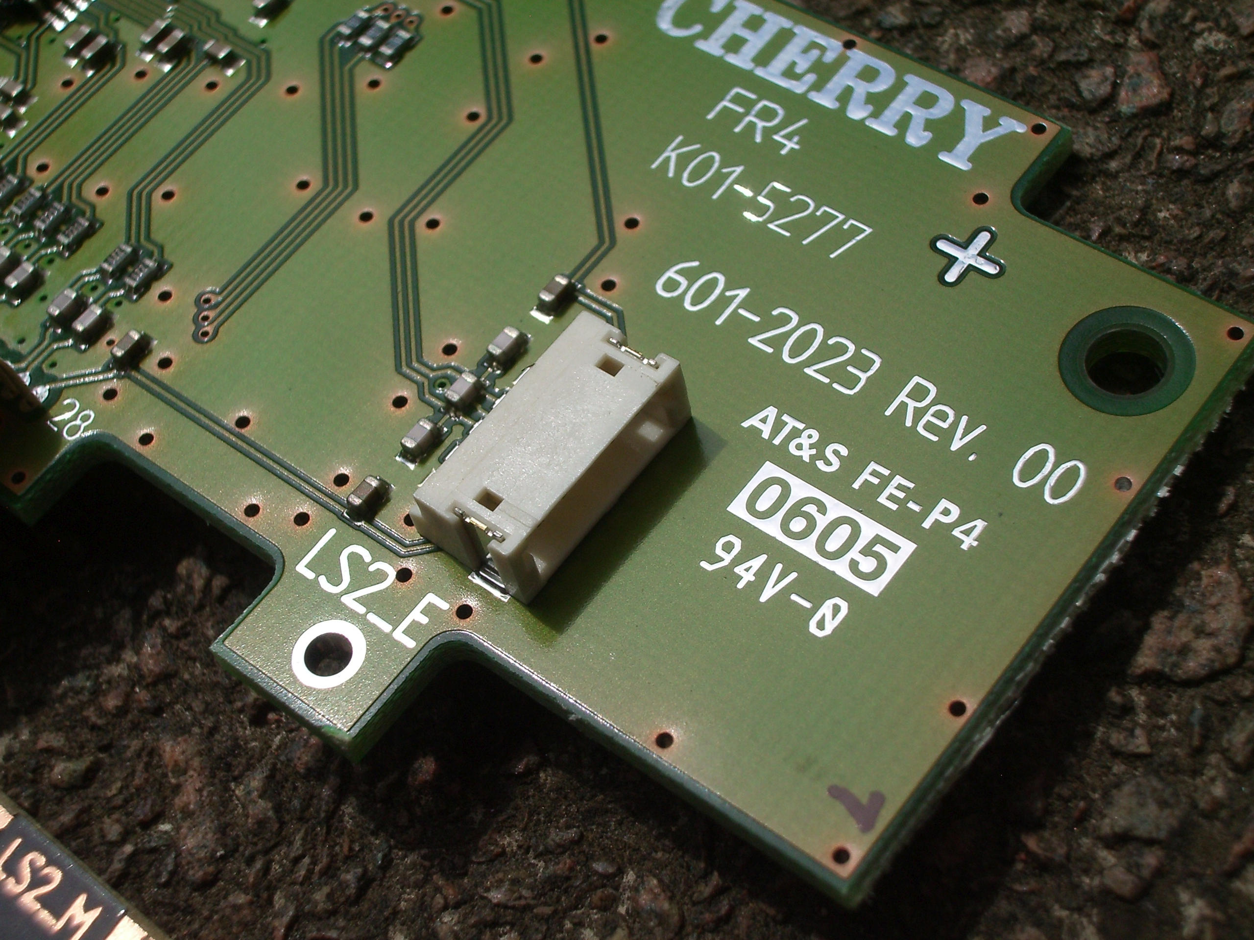

Even a luddite like me has a digital camera ;-) No mobile phone though.
Photo from a ca. 2005 ultracompact:
