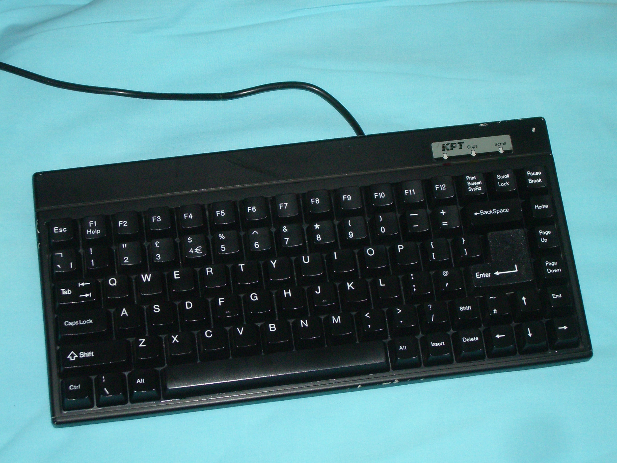

Since I am enjoying a typical English summer, I don't know for certain when I'll get chance to take the remaining photos of the [wiki]KPT KPT-84[/wiki] that lowpoly sent me, since I need a sunny day. Tomorrow looks promising though.
Photos round 1 (I often take them in several rounds as I identify issues with the previous round and make up a list of photos to re-take; once I have a full set of photos I'll put them straight onto the wiki):
[Edit: cross-posted to alps.tw's topic at KBT, so really some photos of the keyboard are in order, as he won't have seen lowpoly's sale topic! Round 1a:
KPT KPT-84 top.jpg (574.56 KiB) Viewed 2551 times

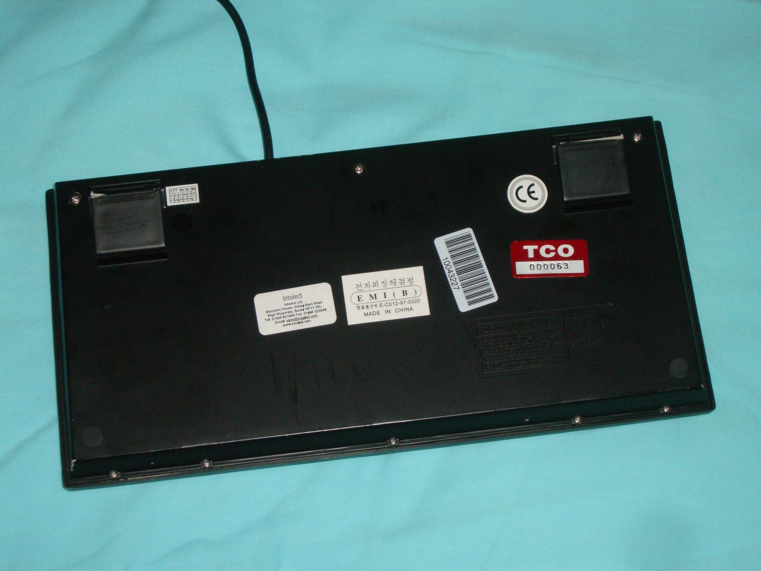

KPT KPT-84 bottom.jpg (536.92 KiB) Viewed 2551 times

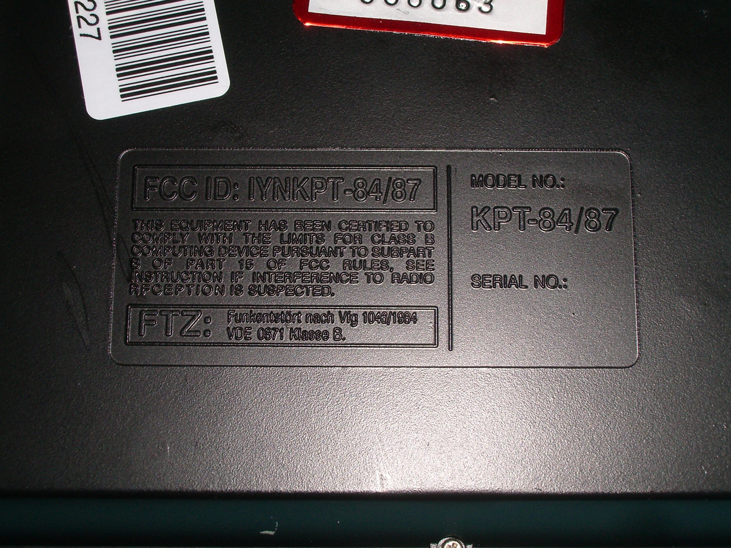

Round 1b: may as well have the model and FCC ID while I'm at it:
KPT KPT-84 model and FCC ID.jpg (1010.74 KiB) Viewed 2550 times

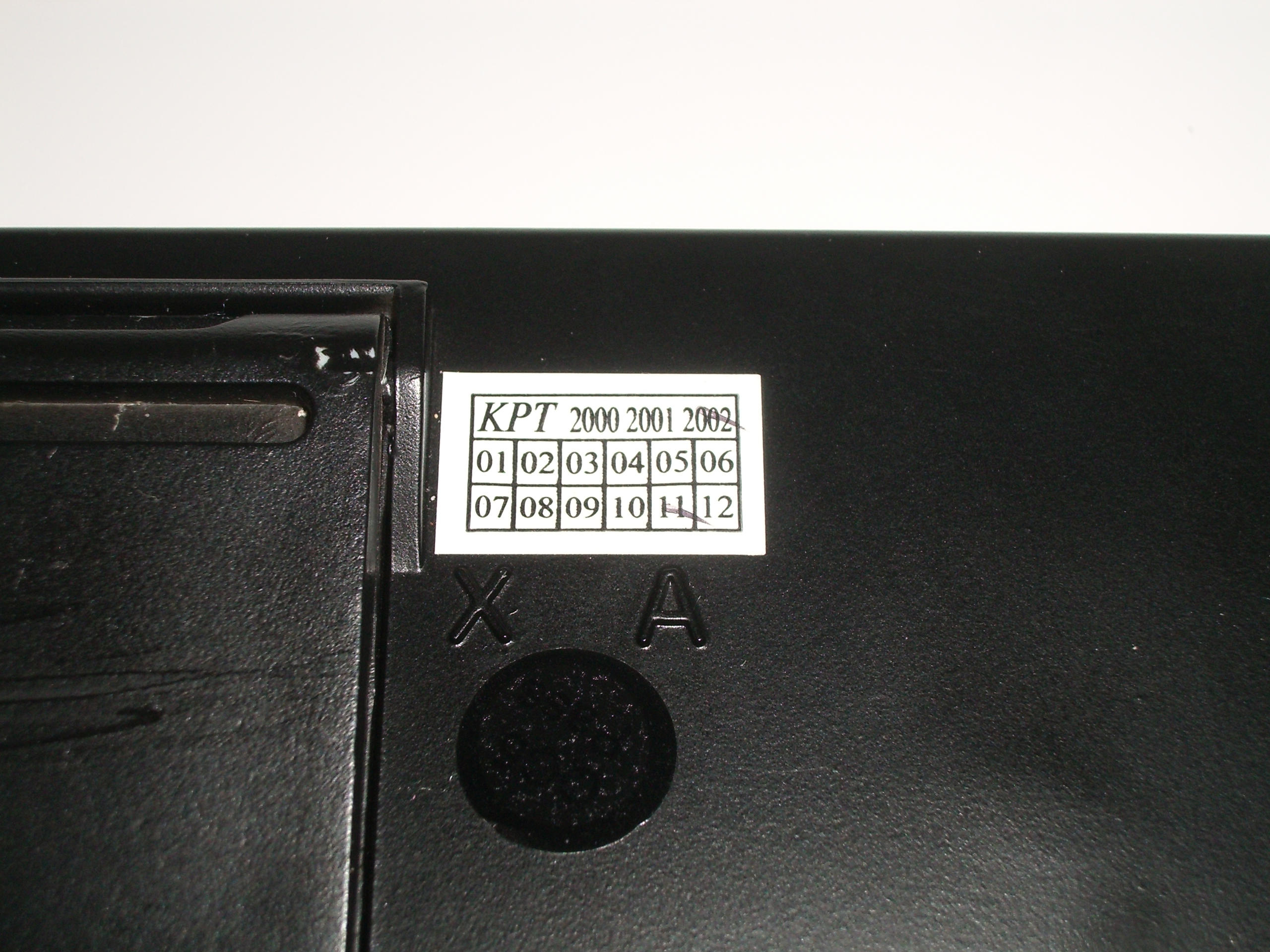

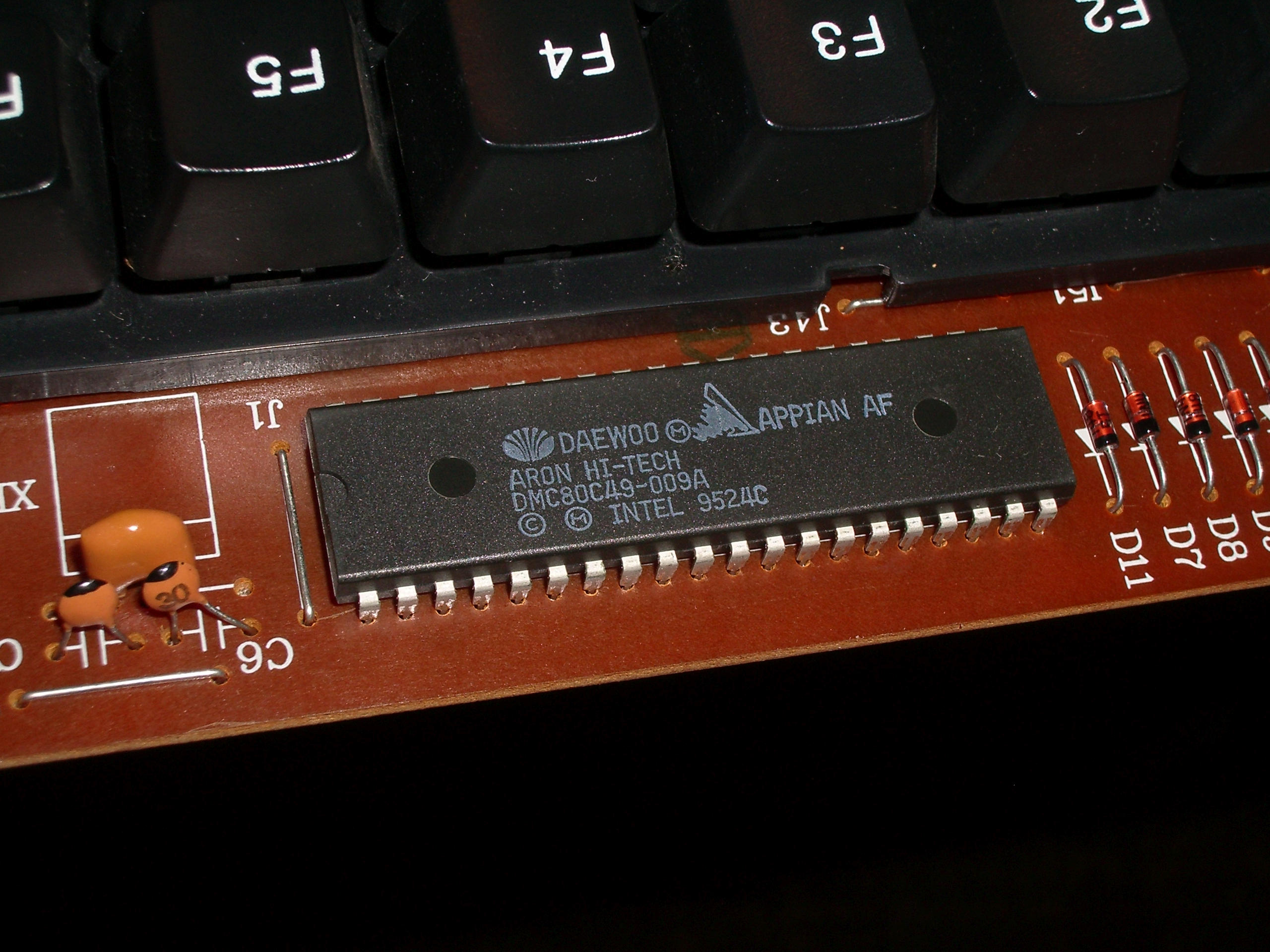

Firstly, the date on the chip doesn't come close to matching the date on the rear:
KPT KPT-84 chip.jpg (562.33 KiB) Viewed 2552 times
KPT KPT-84 years.jpg (549.47 KiB) Viewed 2552 times
Also note the brands on the chip — very strange: Daewoo, Appian (that's a blast from the past), and Aron Hi-Tech.

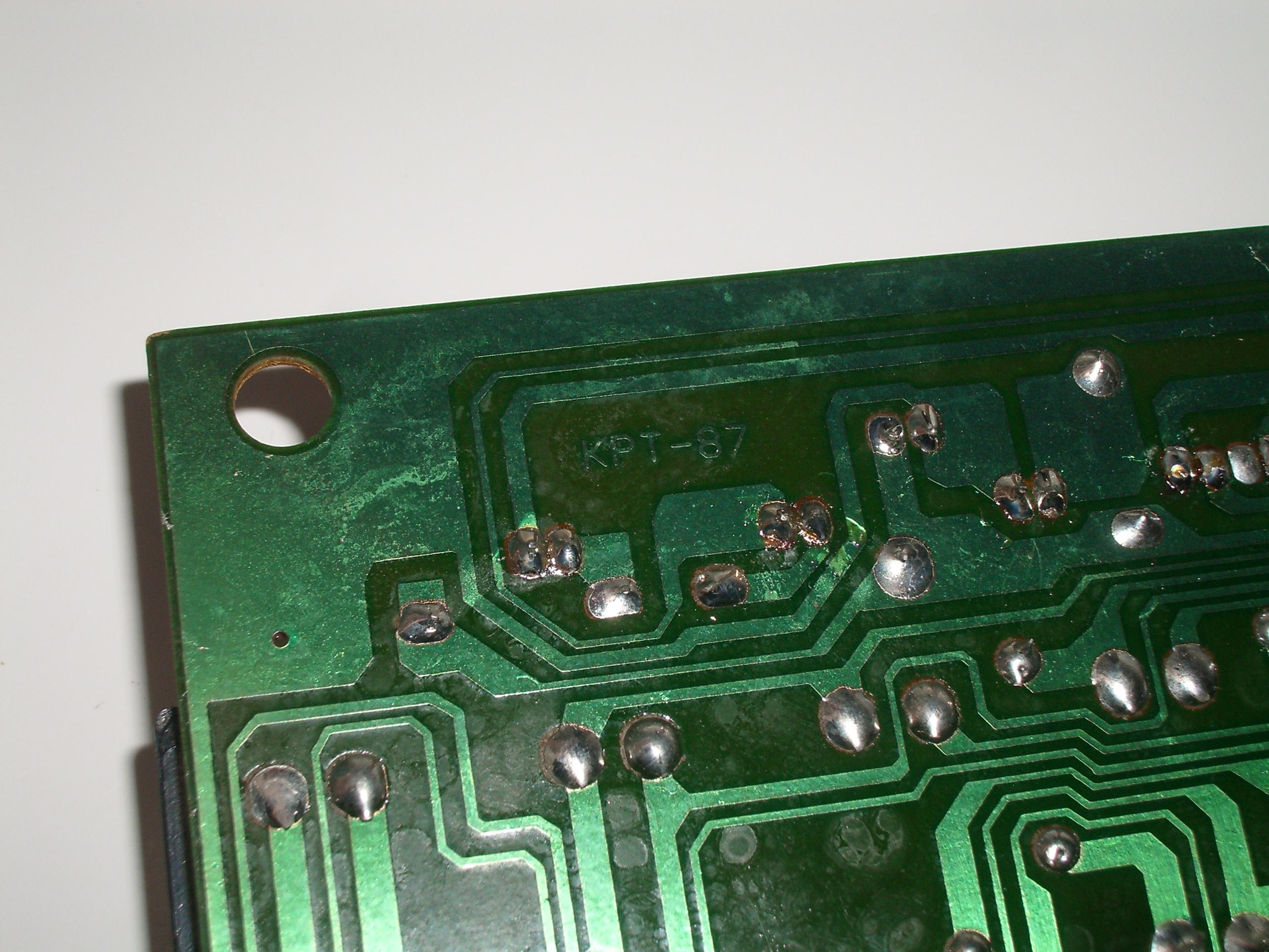

The PCB is marked KPT:
KPT KPT-84 PCB inscription.jpg (624.1 KiB) Viewed 2552 times

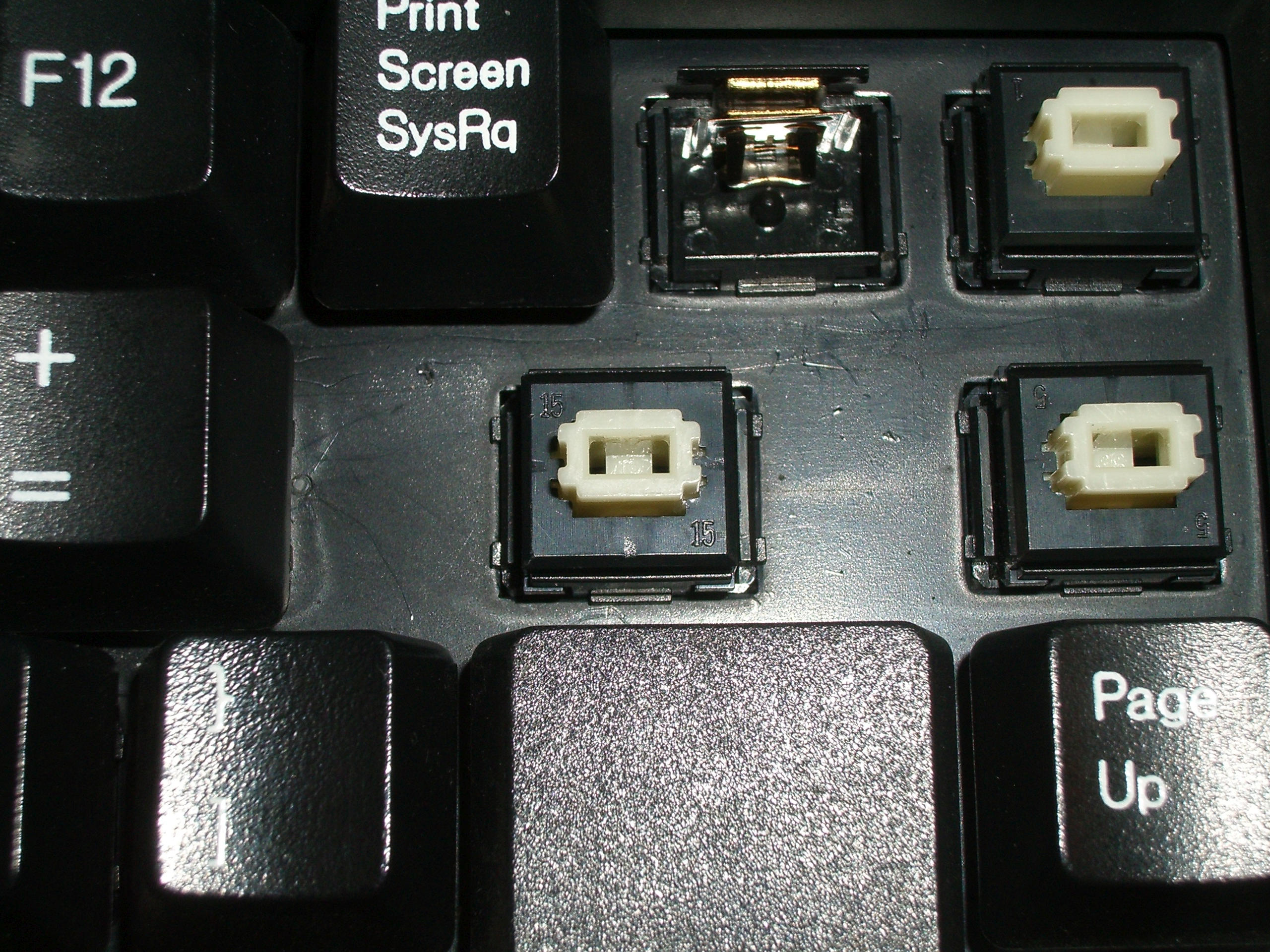

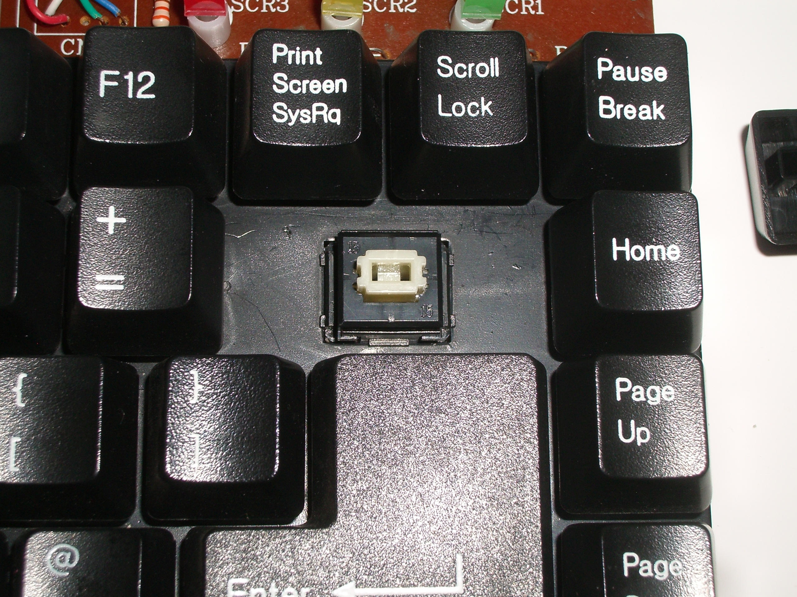

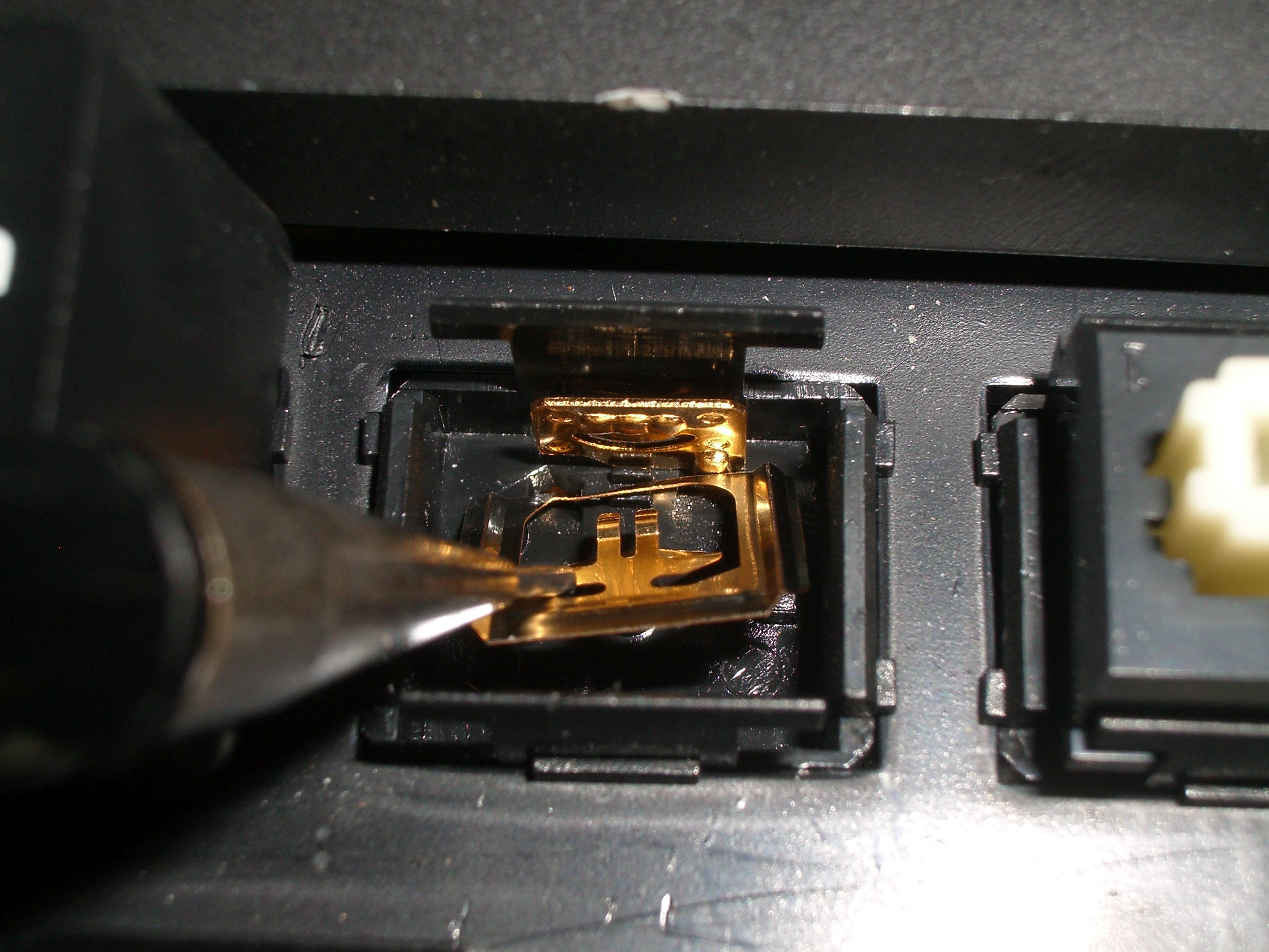

I was expecting Taiwan Tai-Hao APC switches, but instead I got what I am guessing is Himake or Hua-Jie (depending on which date you believe):
KPT KPT-84 switches.jpg (891.94 KiB) Viewed 2552 times

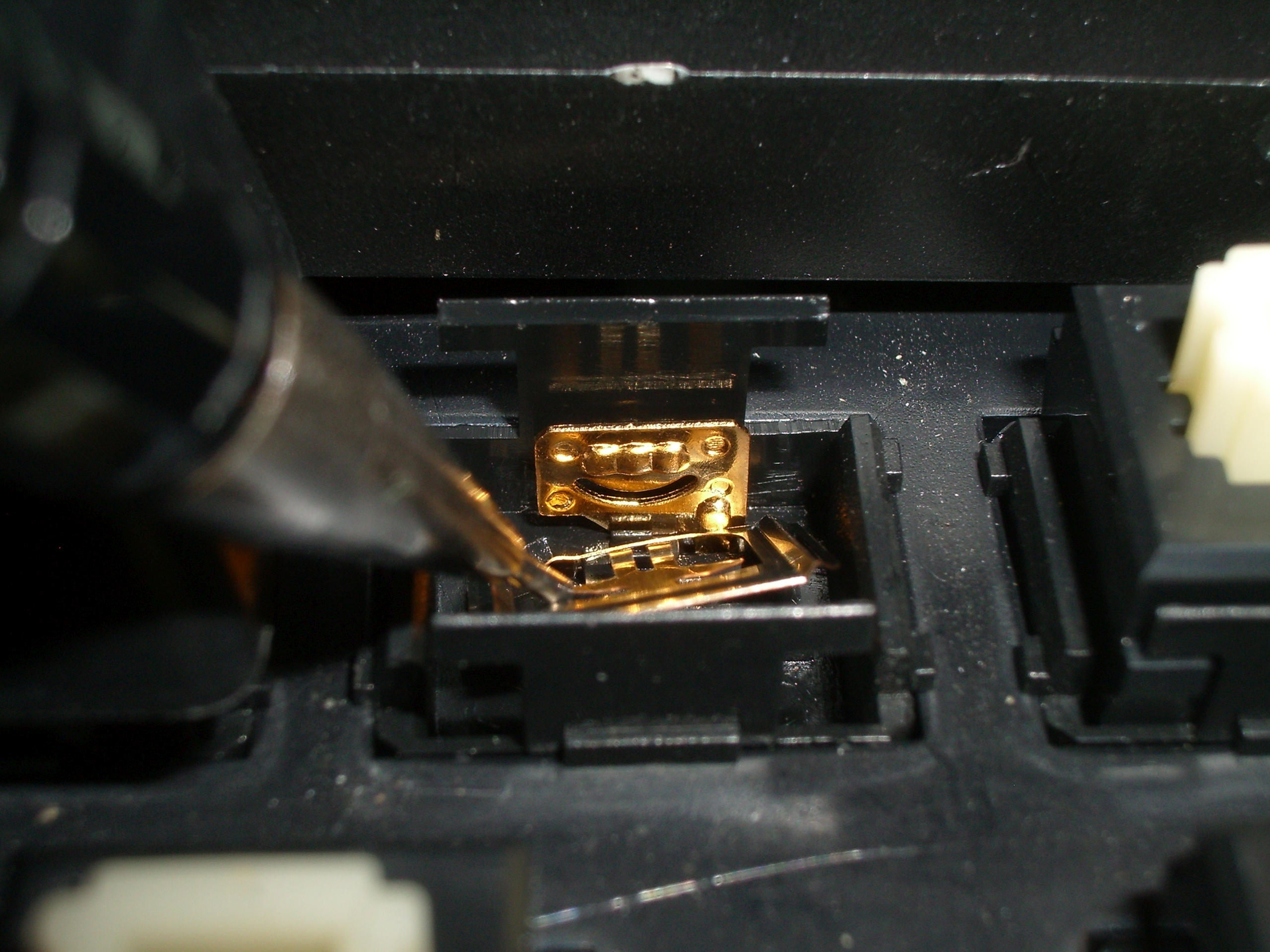

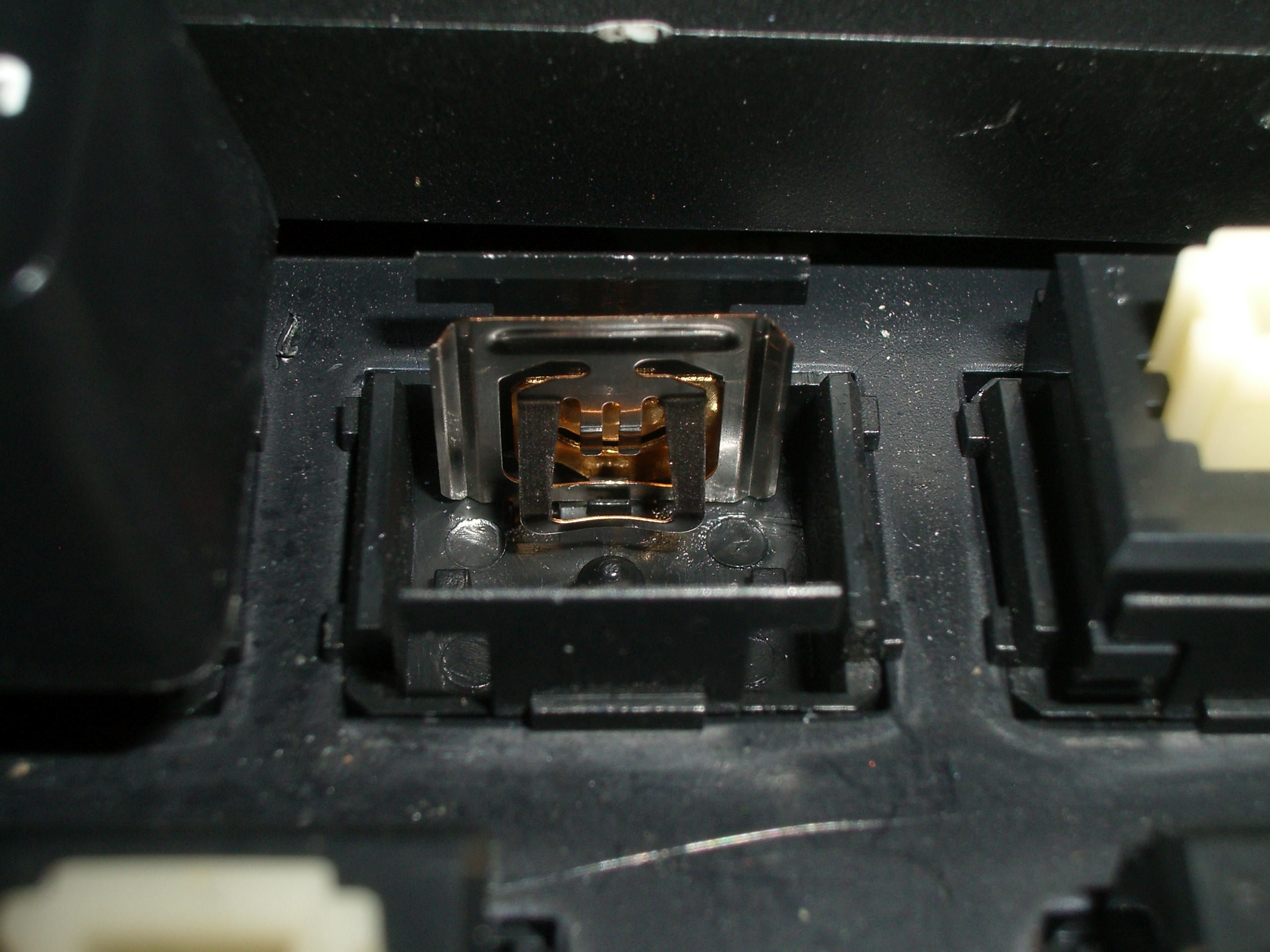

The design is curiously an intermediate between AK-CN2 and AK-CN2 (2). The stationary contact is the all-over-"gilted" mini design used in Xiang Min ("XM") switches and Hua-Jie AK-CN2 (2) switches, as well as some other switches that I'm guessing are from Himake or Hua-Jie.
KPT KPT-84 switch stationary contact.jpg (483.09 KiB) Viewed 2552 times

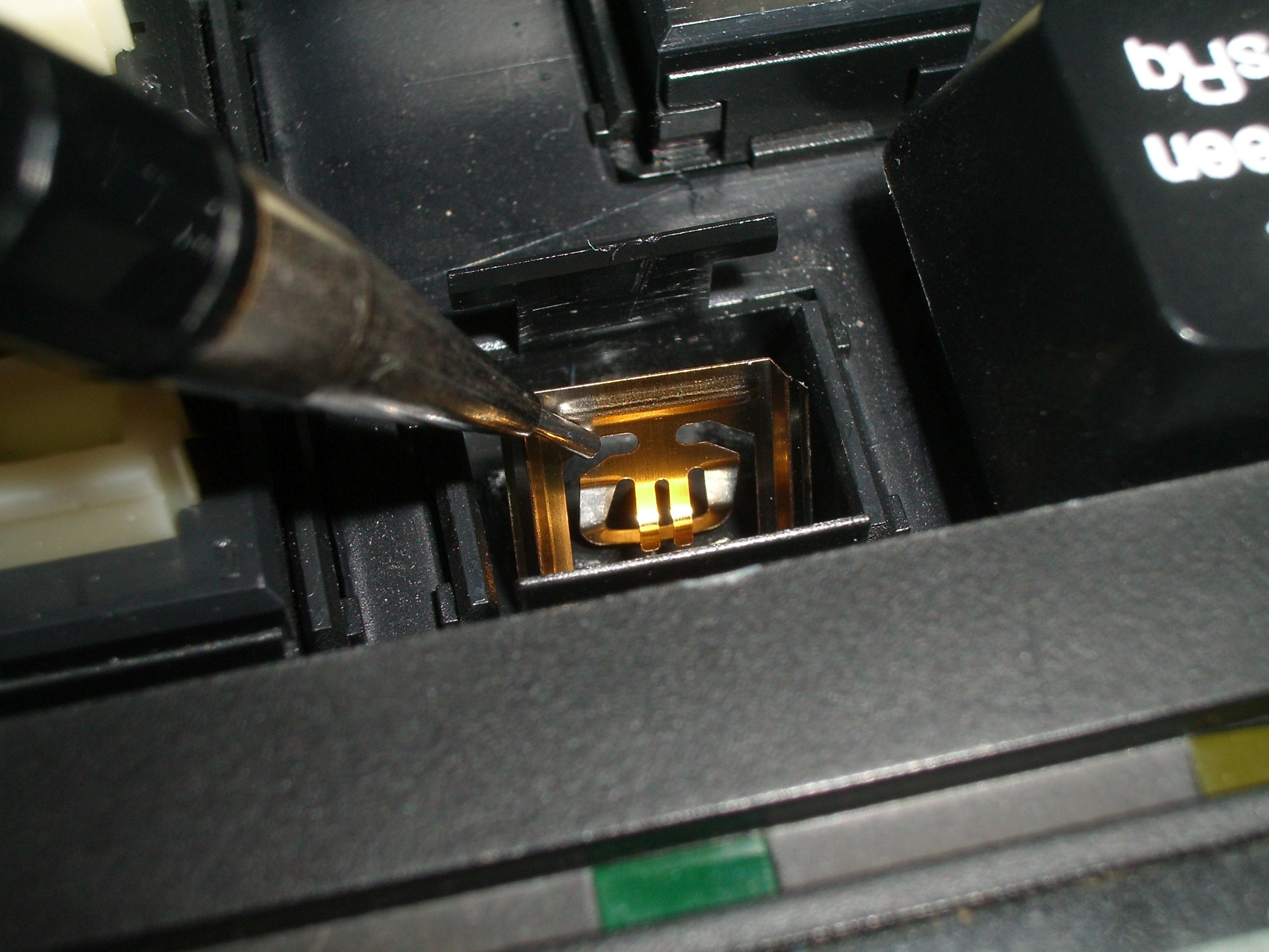

The movable contact design is half-way in between the two!
KPT KPT-84 switch inside.jpg (492.67 KiB) Viewed 2552 times
KPT KPT-84 switch movable contacts rear.jpg (498.76 KiB) Viewed 2552 times
KPT KPT-84 switch contacts.jpg (543.64 KiB) Viewed 2552 times

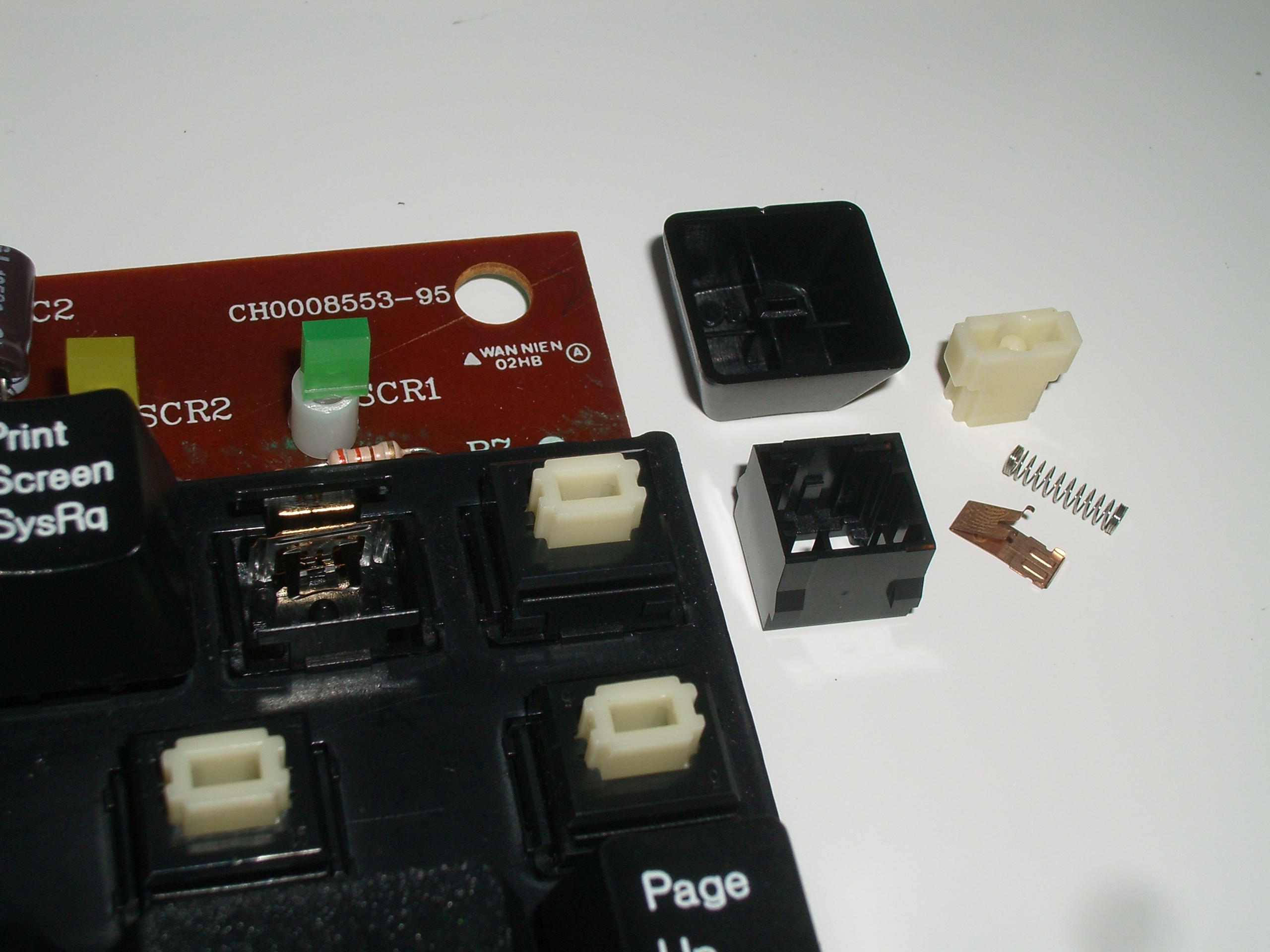

All switch parts:
KPT KPT-84 switch.jpg (365.67 KiB) Viewed 2552 times

Maybe Appian had a cut of the action in the switches, too…
The only apt description for the relationships between all those clone makers is truly: incestuous. My guess is that this kind of madness is quite common in all manner of generic components that we aren't interested in. Switches just happen to be the sweet spot for being the right size to investigate by hand, and actually making a difference.
12 Jul 2014, 02:15
It depends how a switch is made. Matias designs and sells switches (bizarrely unbranded, for no known reason) but they have no manufacturing capacity that I know of. The switches are assembled by Dongguan Gaote, who themselves don't make the parts either or, at least, not all of them. I don't know how many factories are involved.
The Chinese and Taiwanese love retooling, and I suspect this is just another Himake/Hua-Jie variant. It's not the usual font for the opposite-corner style of numbers, though; the only switch the font matches is this one:
[wiki]Hua-Jie AKF Cherry MX mount[/wiki] (not confirmed as Hua-Jie though; by rights I should rename it with a USw number)
Taiwan Tai-Hao APC switches have no parts in common with any other product. Xiang Min and Hua-Jie switches share all the metal parts, but the plastic parts are moulded separately. YH-B also has metal parts that don't match anyone else.
