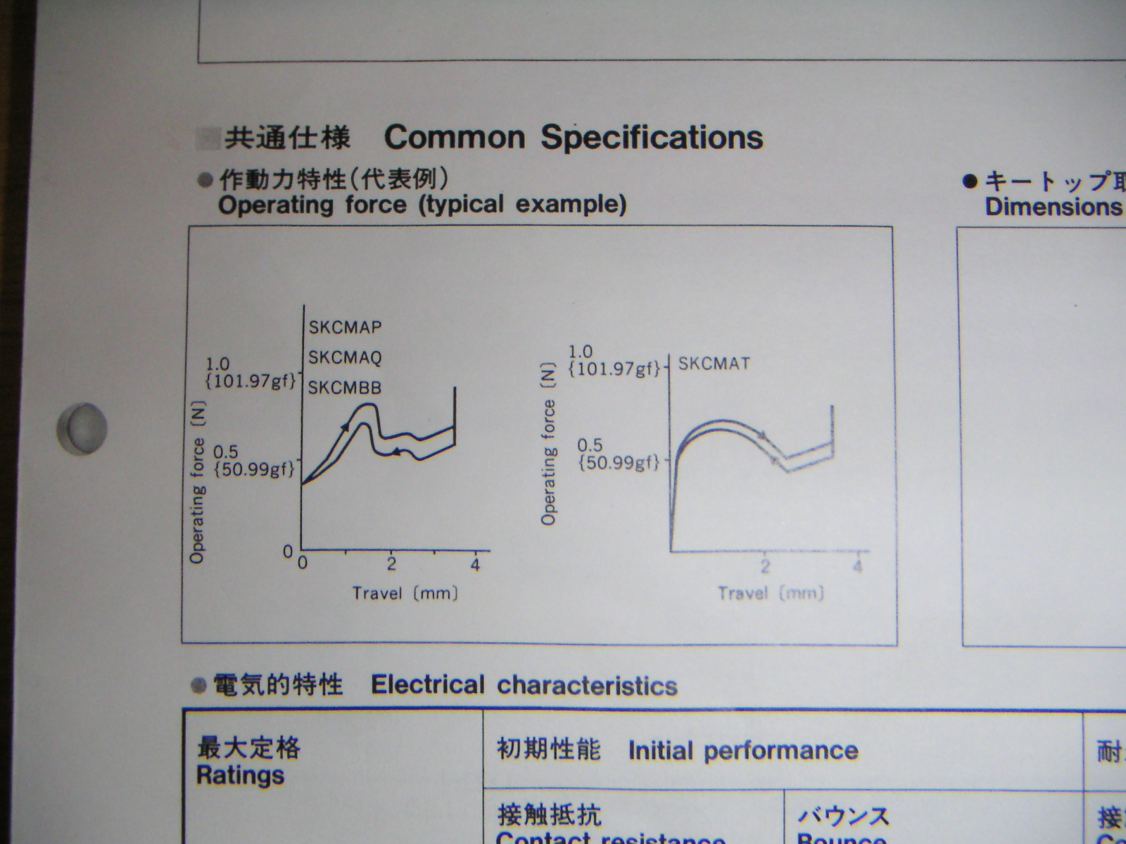

Firstly, how do they feel? The force curve for those is really weird, more like rubber dome (I'll dig out the graph later). The tactile leaf has an interesting shape, I can see.

They have a pretty significant bump pretty much right at the beginning, almost like an MX Clear in the size of the bump. The tactile bump is really smooth, but they're not as smooth after that. Not bad, but not super smooth feeling like linear Green Alps.

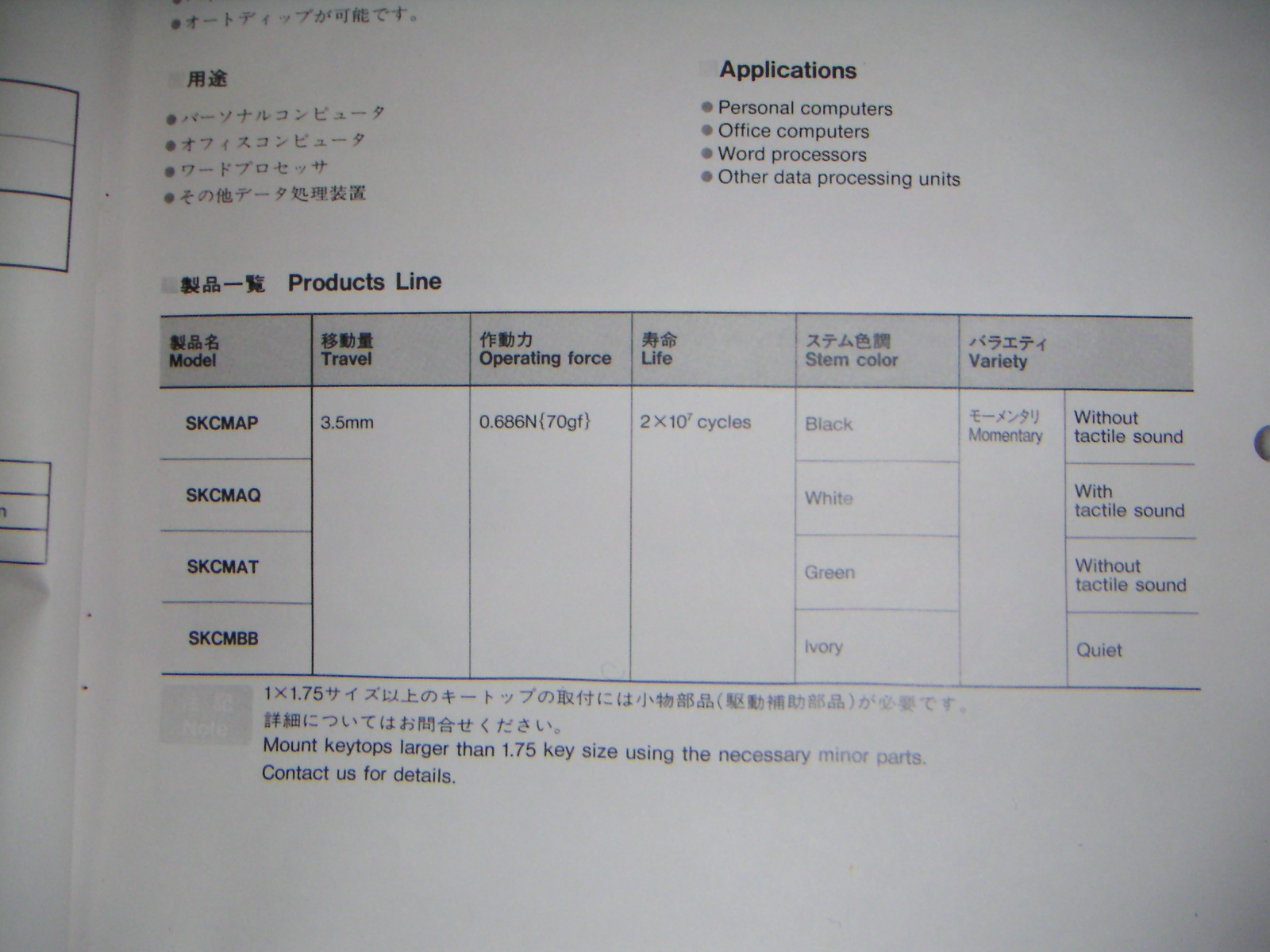

23 Jul 2014, 22:45
SKCLAR (Alps SKCL Yellow) is currently given the range 1988–1998.
SKCMAT (Alps SKCM Green) is confirmed as available for sale in 1994.
I don't know if the "half Alps" switches were on sale in 1994 — I don't recall if Sandy ever said.
Sandy doesn't have a scanner, so all I have of the 1994 Alps catalogue are the following photos he took in January to illustrate the unusual characteristics of SKCMAT. The switches were never rumoured, but they were never confirmed as being seen in any keyboard to date. We were both wondering what would have to be inside the switch to give it such distinct characteristics.
Your description is a perfect match for the published force curve.
I assume that the switchplate must also be different to give it the reduced pretravel of 0.5 mm instead of 1.5 mm.
