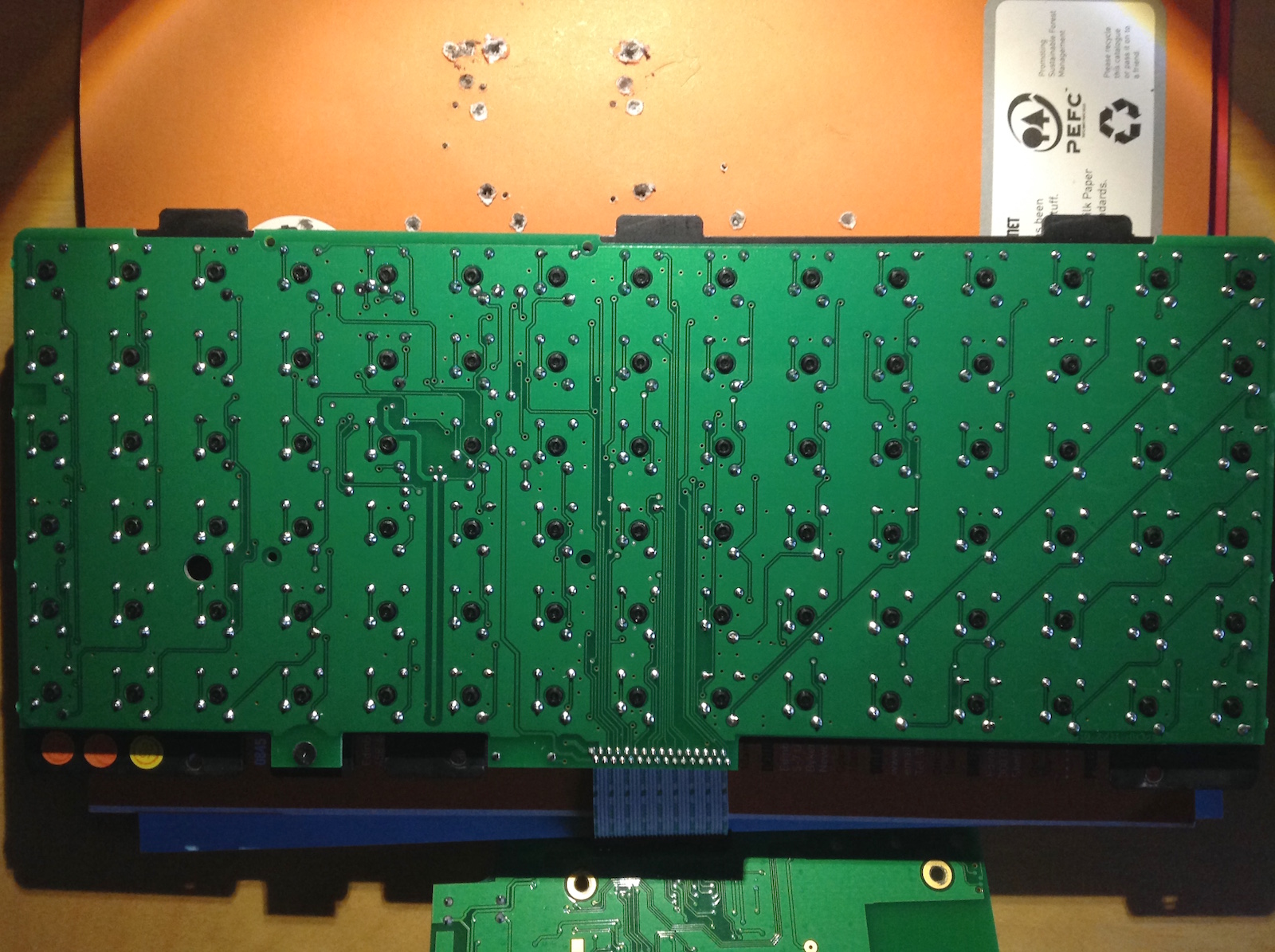

The software is just as bad as Davkol says. (Real bad. Tipro bad!) Ideally, I'd like to program these without it entirely. We've mastered PS/2 already, and much more arcane things besides. Anyone interested in meeting the internal remap challenge? Help us access our Access-IS boards, and type on our Tipros!
01 Dec 2014, 16:50
Good news.
That looks like a nice naked matrix to me! Naturally, I intend to swap out the controller and run my own instead. Phew!

I'll start a picture thread since I shot a bunch more than that one. Might even pick up a few tips that way if people notice it. The ribbon cable is soldered on both ends and I'm wondering what the best way is to jack into it when I ditch the controller board.
Besides that, my plan is simply Soarer's Controller (which I'm already comfortable with) on a Teensy 2++ so I have the pins for the matrix. There's diodes on every switch, so Access made a very nice little modular NKRO board for us to play with! Without that god awful software of theirs.

15 columns plus 6 rows is just 21 pins, actually, so you could cram it all on a regular Teensy 2. But then again that ribbon cable is 32 pins wide! Could be a lot of blank ones in there, I guess. The matrix needs exploring with a continuity meter sometime. But right now I've got the board back together on PS/2, as I'm typing on it.

@muirium: one reason I love love love access-IS is that just about all their KBs come with a seperate controller. Unfortunately, some of the newer ones (like yours) are a close-pitch connector that will be a pain to solder to. Best of luck.
https://www.flickr.com/photos/dork_vade ... 196279627/
^pictures of my old ones (recently sold). Note the huge pin header between the controller and matrix PCB: very easy to solder to.
