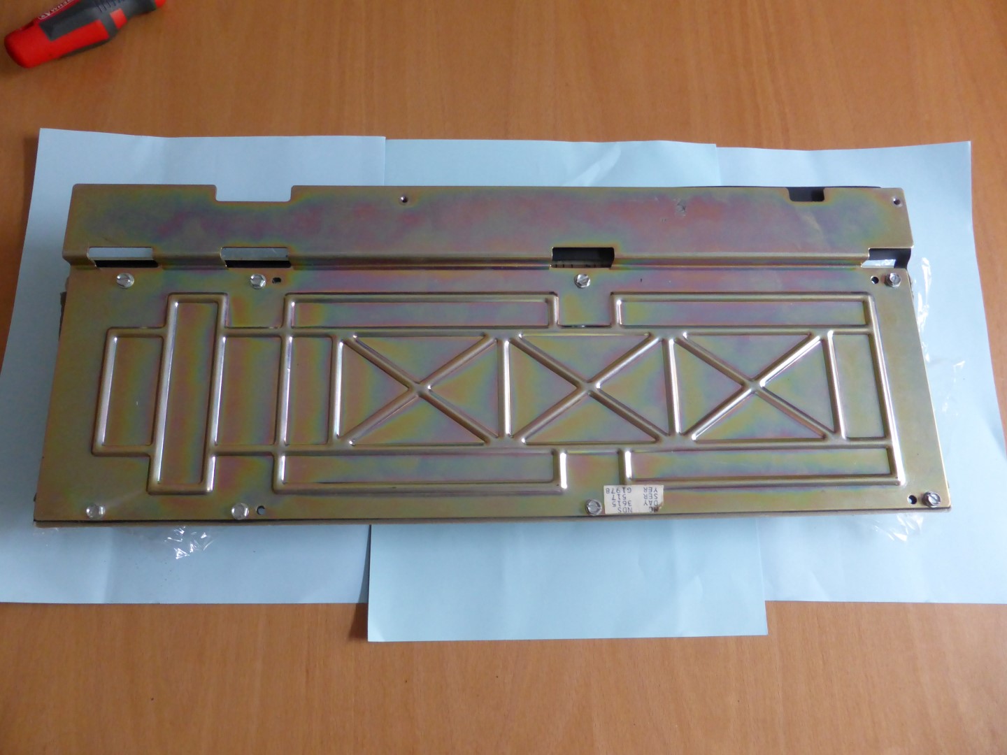

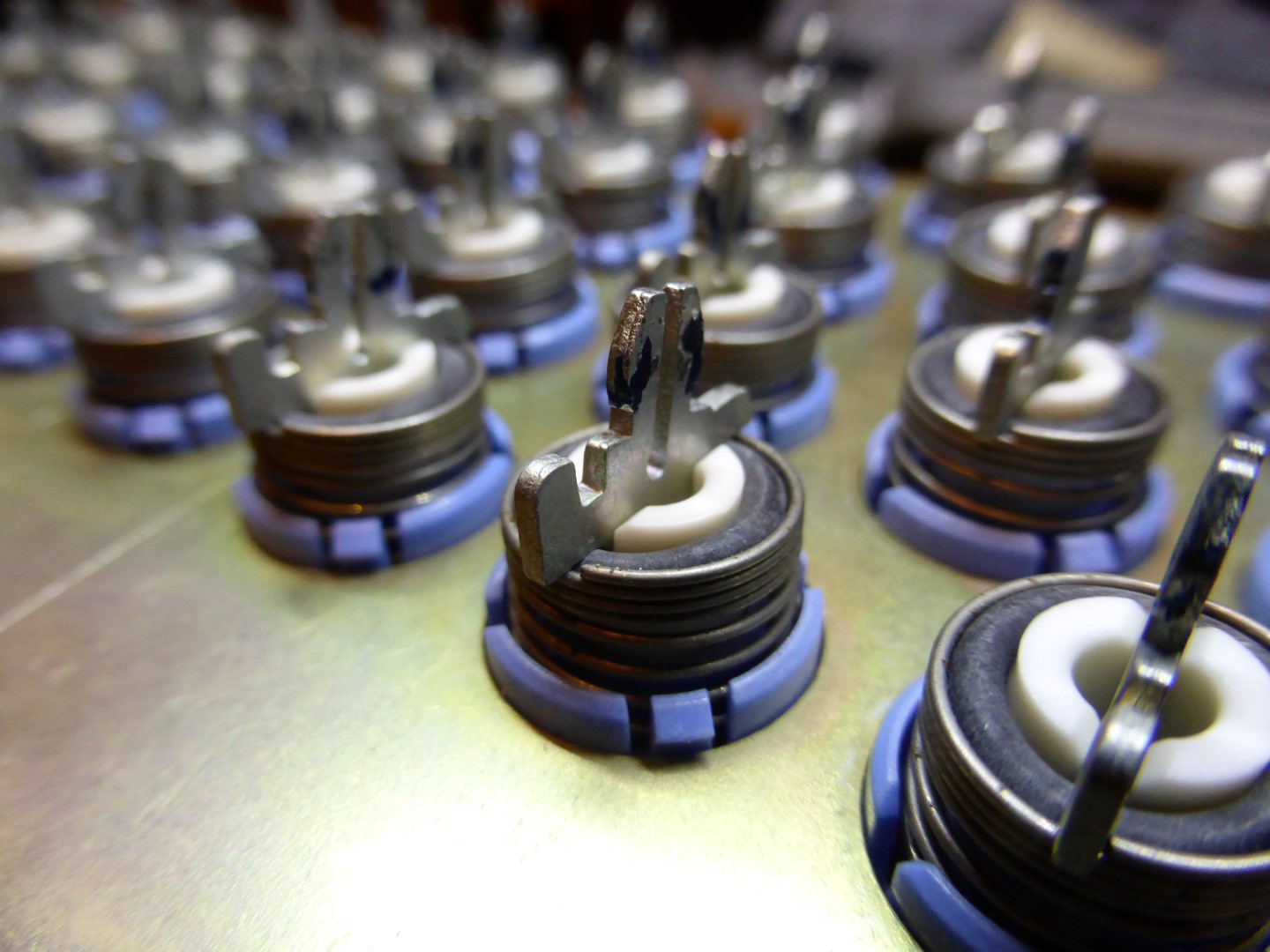

Here are some photos of the "full size" 3278 beam spring board I was lucky to find last november, shortly after I first read about xwhatsit's controller here on DT. This keyboard is fully working over USB with the controller now. I guess it's about time to post some pictures.
I'm talking about this:
P1000476 (Large).JPG (296.46 KiB) Viewed 25478 times
More here:

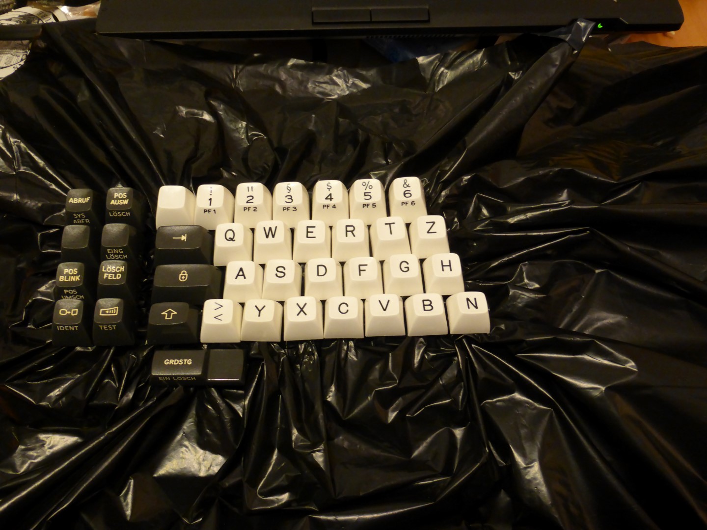

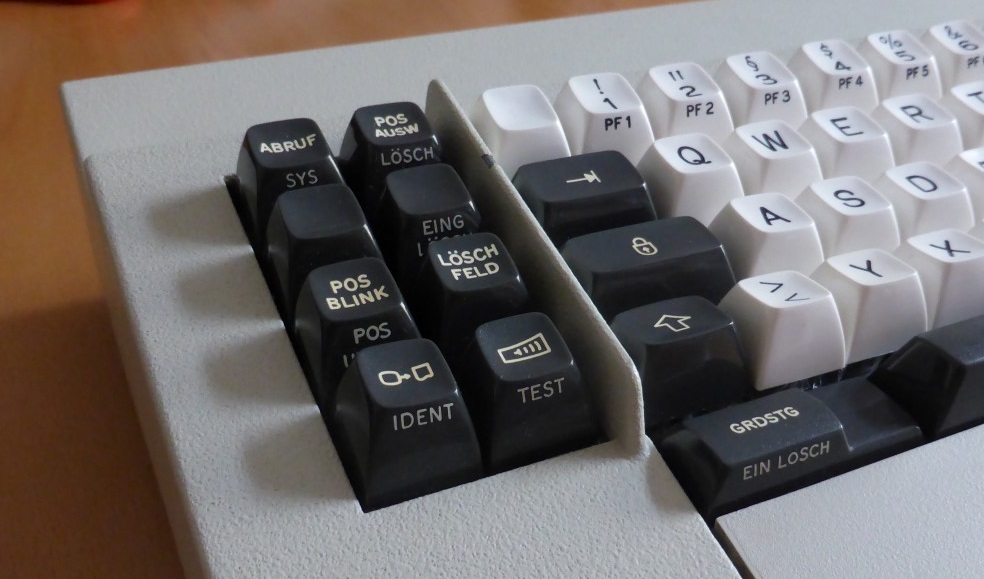

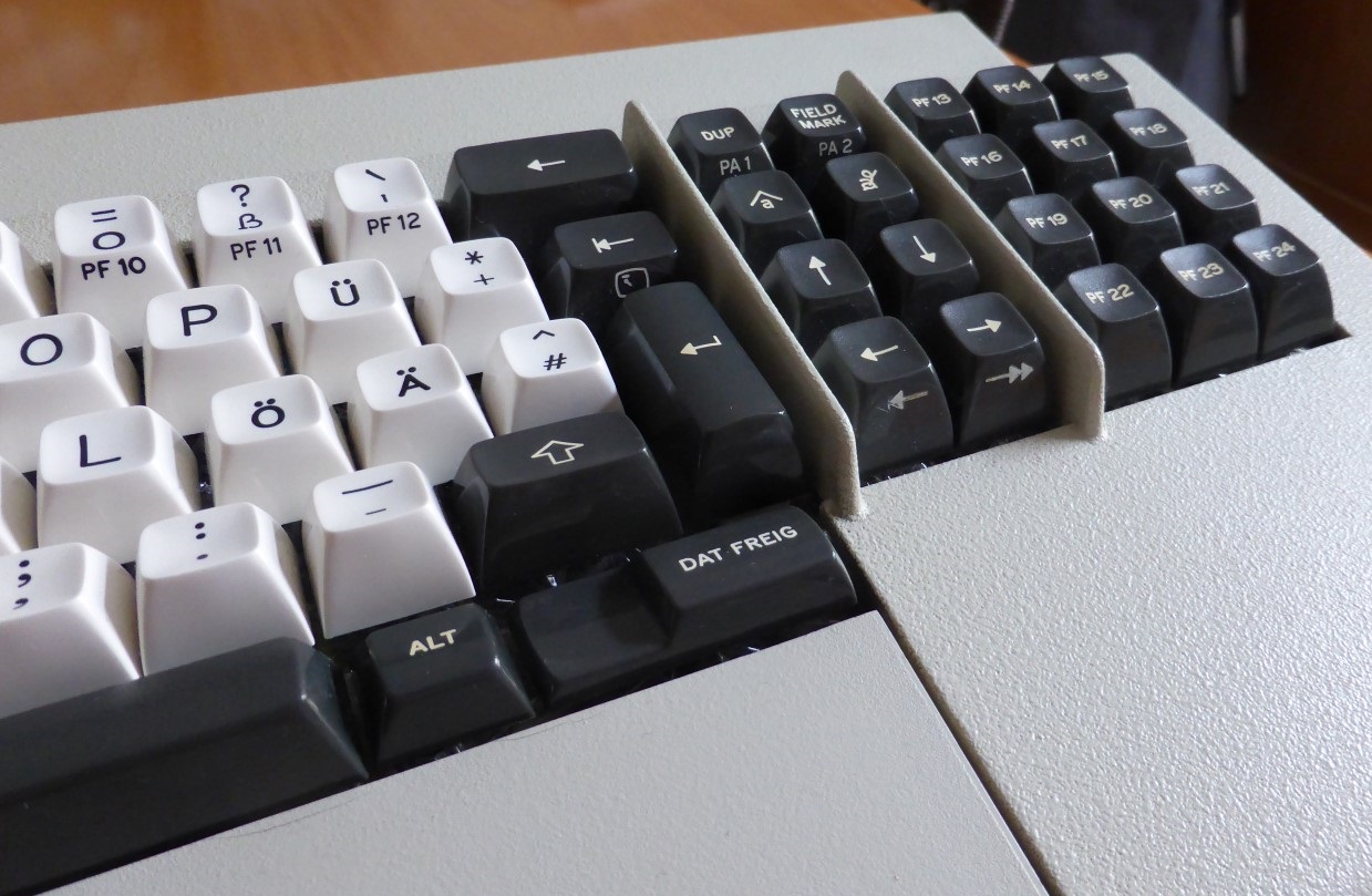

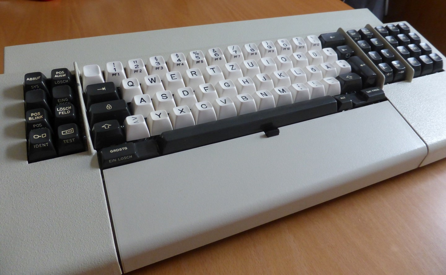

I've already shown the beautiful black and white double shot key caps of the 3278 yesterday. This model doesn't have the red and blue caps or the operator control panel of the 3278 A2, but a purer, monocrome look. There is also no IBM logo or anything like that on the keyboard.
P1000472 (Large).JPG (147.04 KiB) Viewed 25478 times
P1000474 (Large).JPG (278.27 KiB) Viewed 25478 times

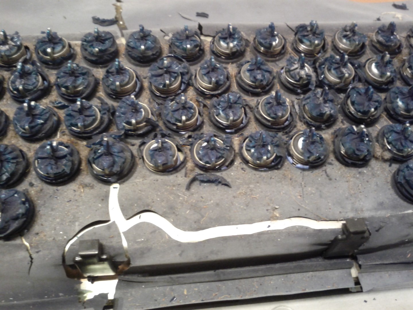

The metal parts on this board showed no corrosion like the ones on Monster-Toys' or my 3278 A2, but the protective plastic sheet had disintegrated much more. There was nothing to save here, crumbs of the foil were everywhere in this board, and I already saw the first of them when I opened the package that the keyboard was in:
crumble
crumble
IMG_20131109_184555 (Large).jpg (313.58 KiB) Viewed 25478 times

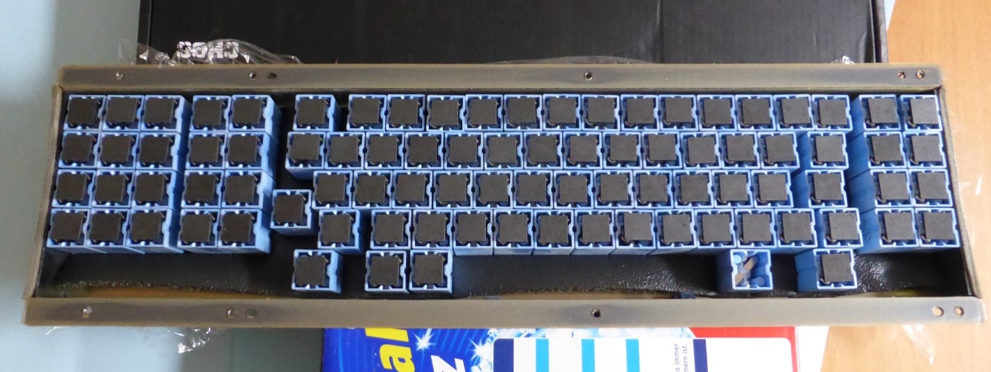

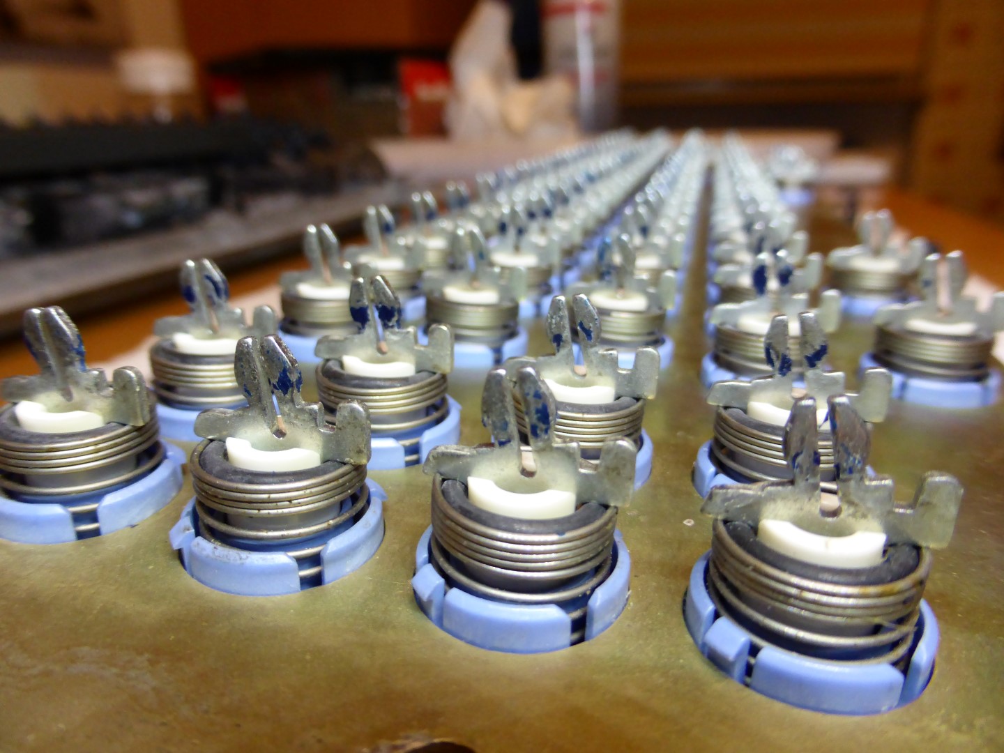

So the first step was to undress the board.
switches
switches
P1000804 (Large).JPG (239.27 KiB) Viewed 25478 times

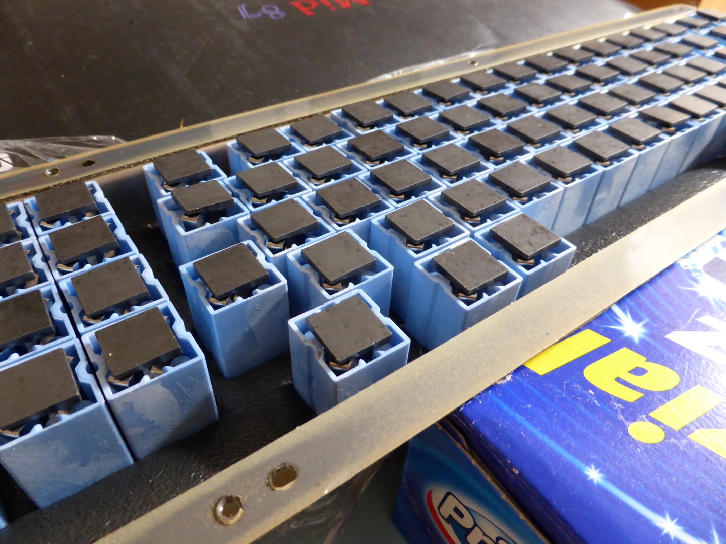

Obligatory switch tree nursery photo:
switches in rows
switches in rows
P1000806 (Large).JPG (285.49 KiB) Viewed 25478 times

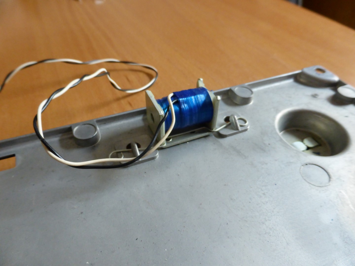

This is the solenoid that is used to rattle loudly with every keypress to give a more typewriter-like feel (I'm not going to use this becaus I have an older version of the controller. The current rev 4 supports this with a little extra controller):
solenoid
solenoid
P1000489 (Large).JPG (195.44 KiB) Viewed 25478 times

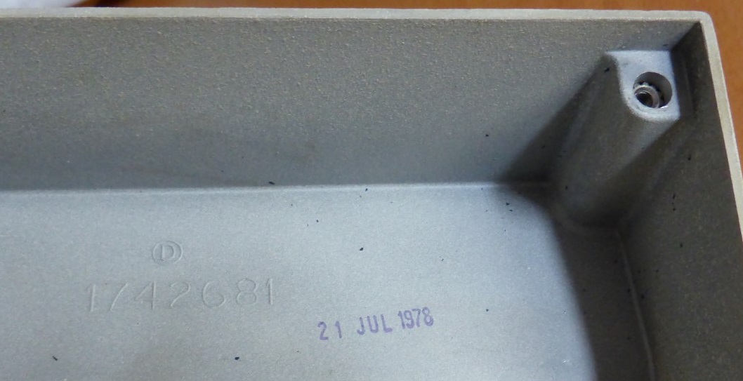

Date stamp in the case -- this is the only date I have because the sticker on the bottom side is lost.
date
date
P1000480 (Large).JPG (142.02 KiB) Viewed 25478 times

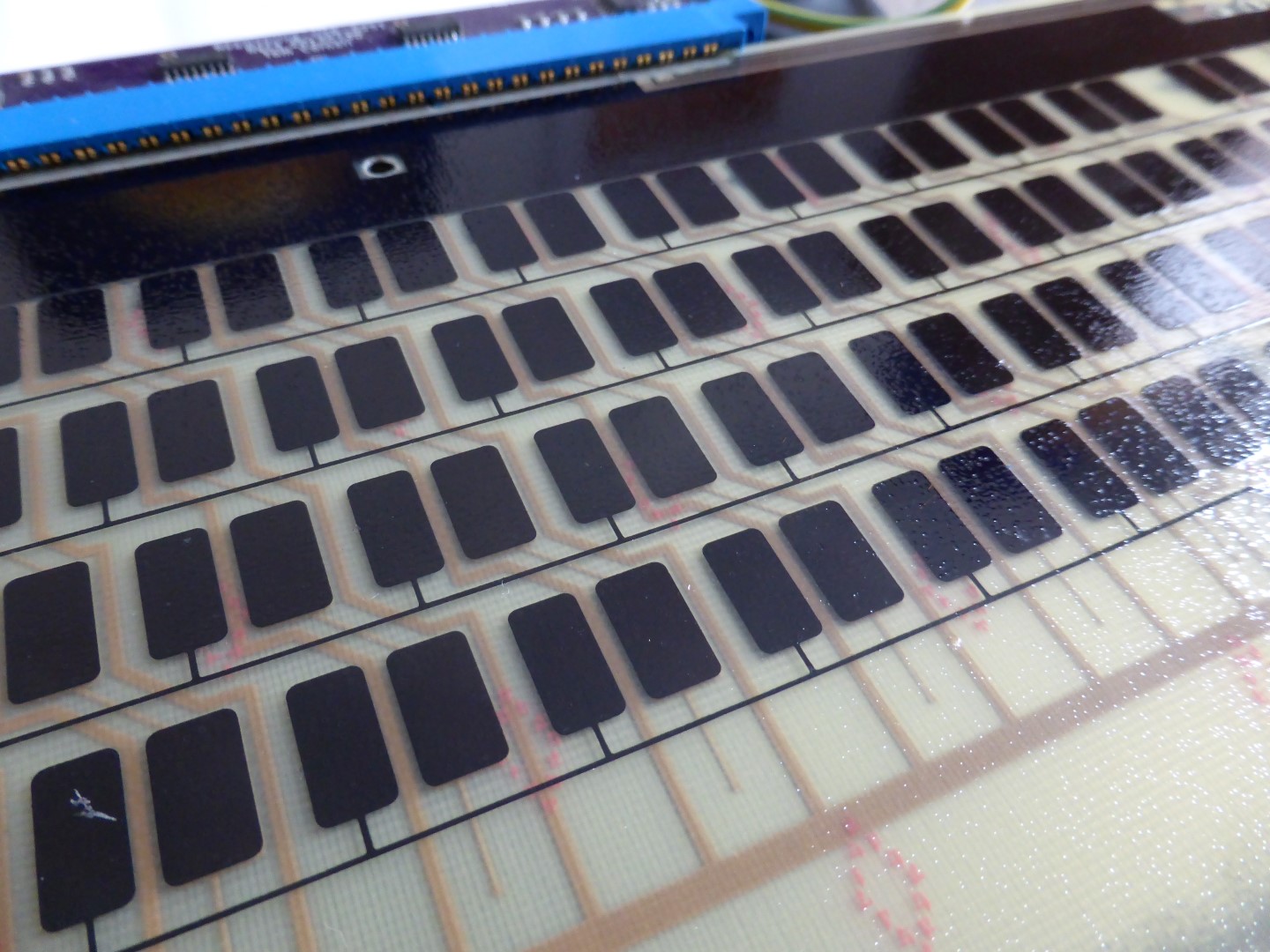

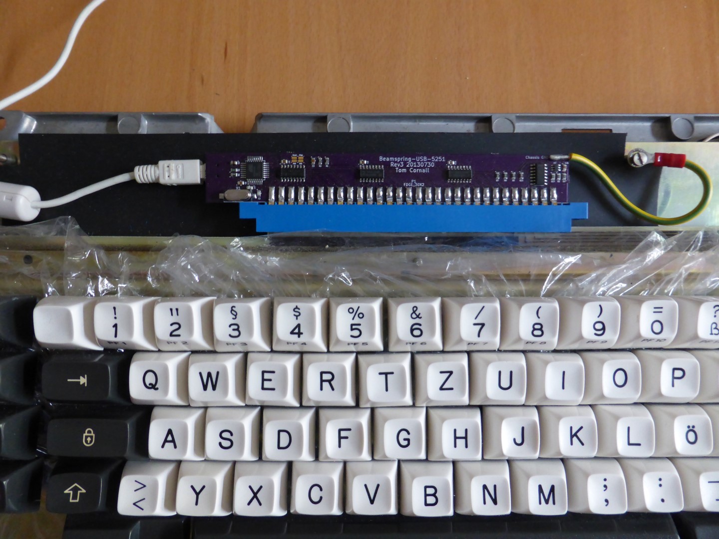

First tests with xwhatsit's controller showed that the controller couldn't calibrate all the keys -- there seemed to be some problems with the capacitance of some of keys which were either way too high or too low. So I opened the inner case to have a look at the PCB and clean it:
baseplate
baseplate
P1000491 (Large).JPG (218.08 KiB) Viewed 25478 times

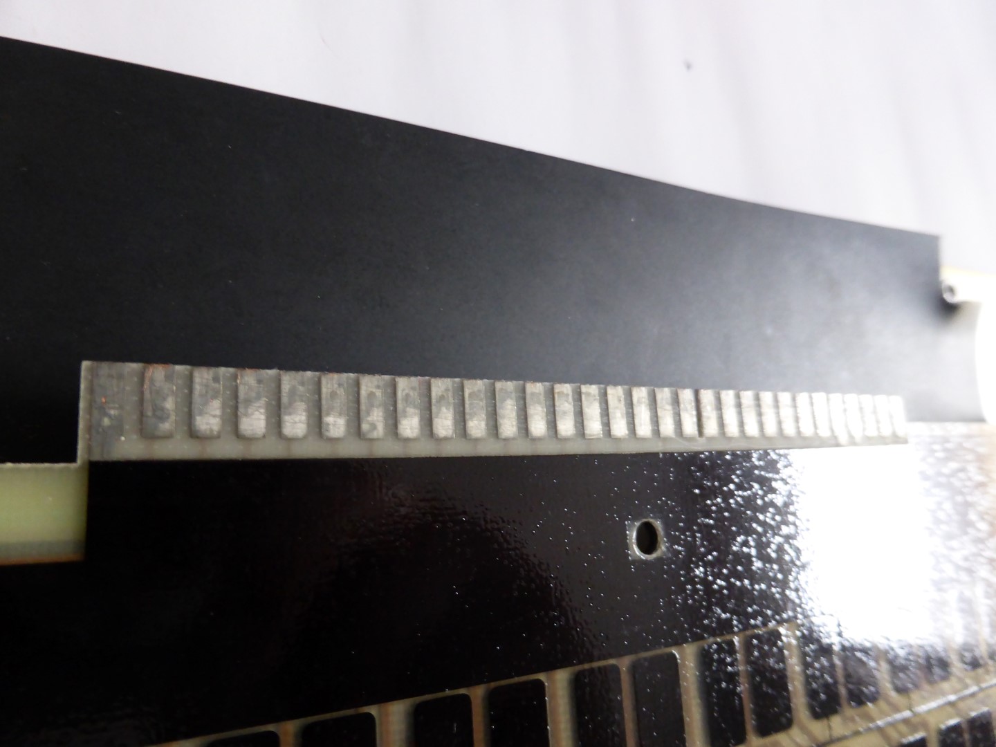

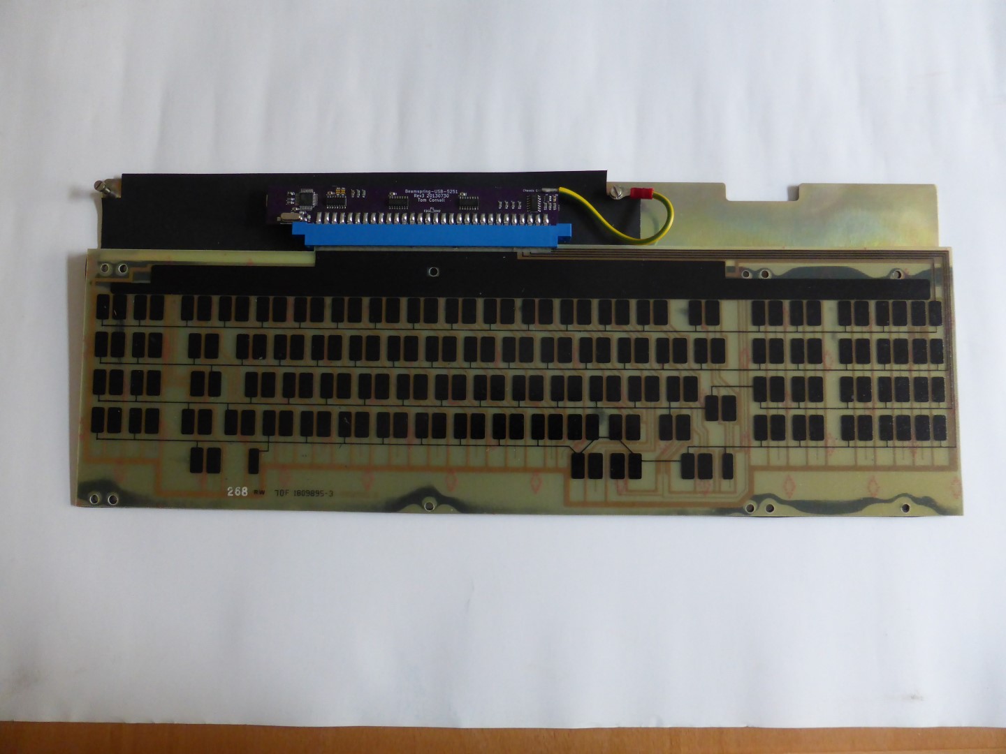

pcb with controller (1)
P1000500 (Large).JPG (197.9 KiB) Viewed 25478 times
P1000501 (Large).JPG (305.17 KiB) Viewed 25478 times
switches bottom (1)
switches bottom (1)
P1000495 (Large).JPG (261.17 KiB) Viewed 25478 times
P1000497 (Large).JPG (353.88 KiB) Viewed 25478 times
pcb connector
pcb connector
P1000509 (Large).JPG (185.2 KiB) Viewed 25478 times
After a cleaning of all the surfaces an the connector there were only few problems left when calibrating the controller. A firmware upgrade of the controller solved all these problem though. Thanks to xwhatsit, I now had a fully functional usb keyboard!
Only thing that was left was to put it all together again and find a solution for the replacement of the rubber foil.

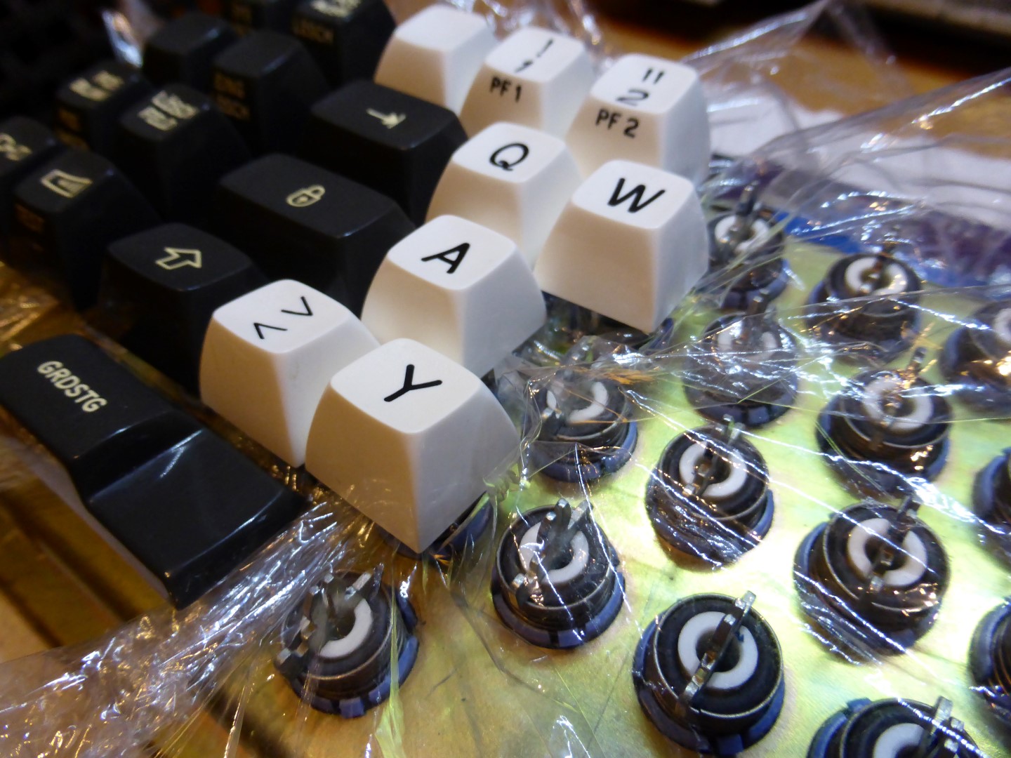

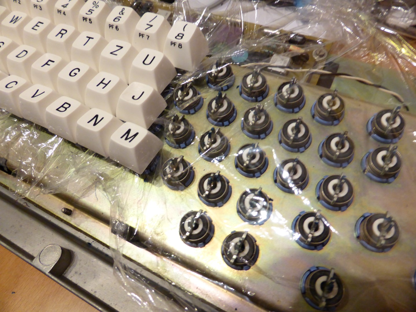

Replacement for the contamination shield:
P1000815 (Large).JPG (322.94 KiB) Viewed 25451 times

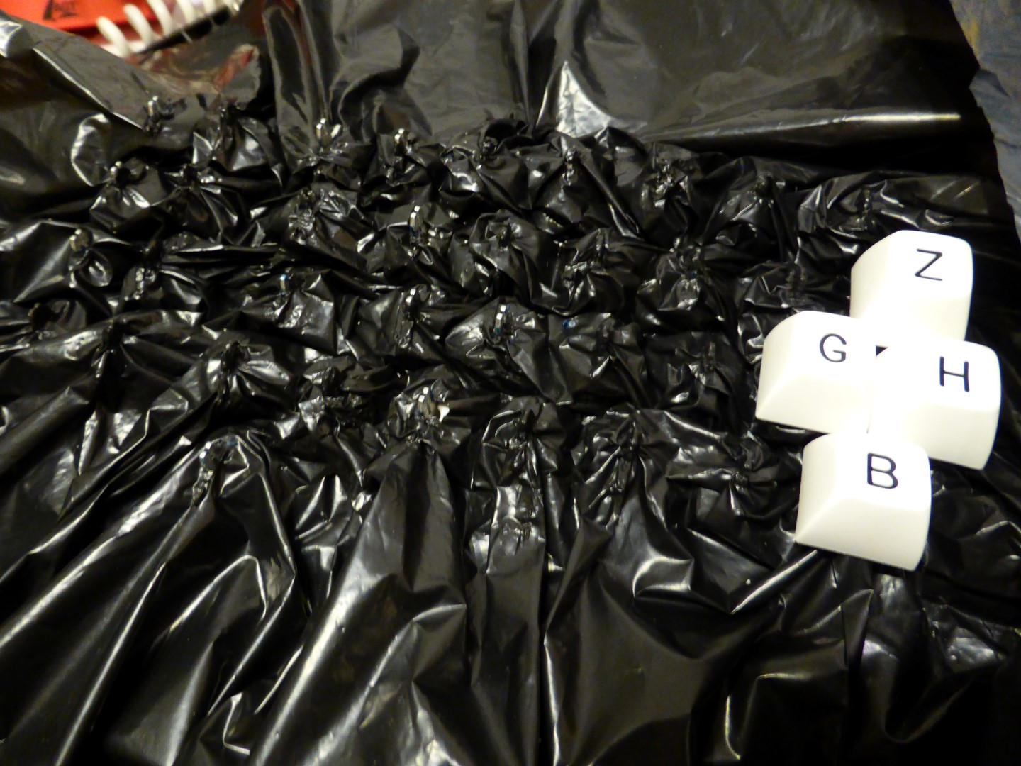

You definitely get the best feel and sound off a beam spring board by just doing without any replacement for the contamination sheet. The original sheet seems to me like an afterthought, and a board feels much better without it.
The problem with that is: if you really have a liquid or dust/dirt on your board, which is hard to avoid with everyday use, they can easily contaminate the switches and render them unusable. So IMO if you plan to use the board regularly, some kind of replacement makes sense.
MORE:
Parak posted a thread on GH about how he used some poly film to replace the contamination shield:
http://geekhack.org/index.php?topic=46134.0
I followed his approach -- first I tried a few different plastic bags, including some waste bags:
wastebag
wastebag
P1000404 (Large).JPG (268.19 KiB) Viewed 25451 times
This shows how the foil was laid out to leave enough spare between the switches:
wastebag2
wastebag2
P1000427 (Large).JPG (327.86 KiB) Viewed 25451 times
It's a compromise: if you don't leave enough foil between the switches, there will be "crosstalk" between the caps -- if you press a key, all the caps in the neighborhood will lean over towards the pressed key, which also feels pretty bad. This even happens a little bit with the original contamination shield.
If you leave too much foil between the switches or the foil is too thick, you feel the plastic foil crumbling and hear it rustling with every keystroke.
In the end, what I used was very thin clear "self-adhesive" wrapping film like it's used to wrap around sandwiches etc ("Frischhaltefolie selbsthaftend"), and that worked pretty well. It's still not as good as leaving out everything, but it's a good compromise.
fresh
fresh
P1000428 (Large).JPG (361.91 KiB) Viewed 25451 times

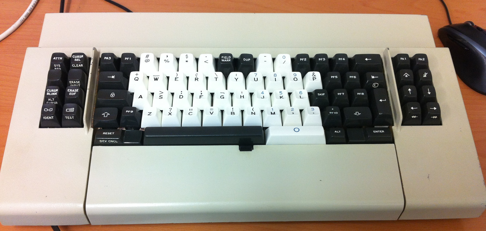

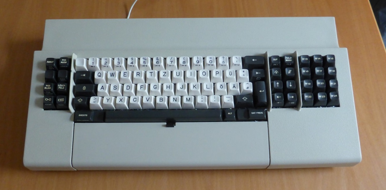

So everything works now and I'm very happy with xwhatsit's controller and how my keyboard turned out.
controller
controller
P1000482 (Large).JPG (299.16 KiB) Viewed 25451 times
keyboard
keyboard
P1000471 (Large).JPG (186.26 KiB) Viewed 25451 times

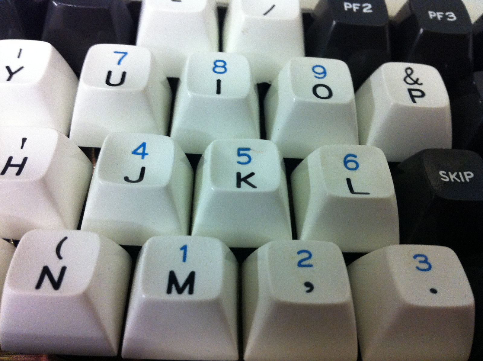

Oooh pretty Halvar. The black-on-white legends are so sharp. The Q and in particular the 3 with the neato punctuation (what is that? says the anglophone) is particularly gorgeous.
Here's my 3278 data entry keyboard (arrived today!), beautiful triple-shot white/black/blue keys. The legends are lovely—although not as good condition as yours, Halvar—the brown/grey keys on the 3727s and 5251s (my other two beamsprings) don't compare.
photo 3.JPG (330.84 KiB) Viewed 25379 times
