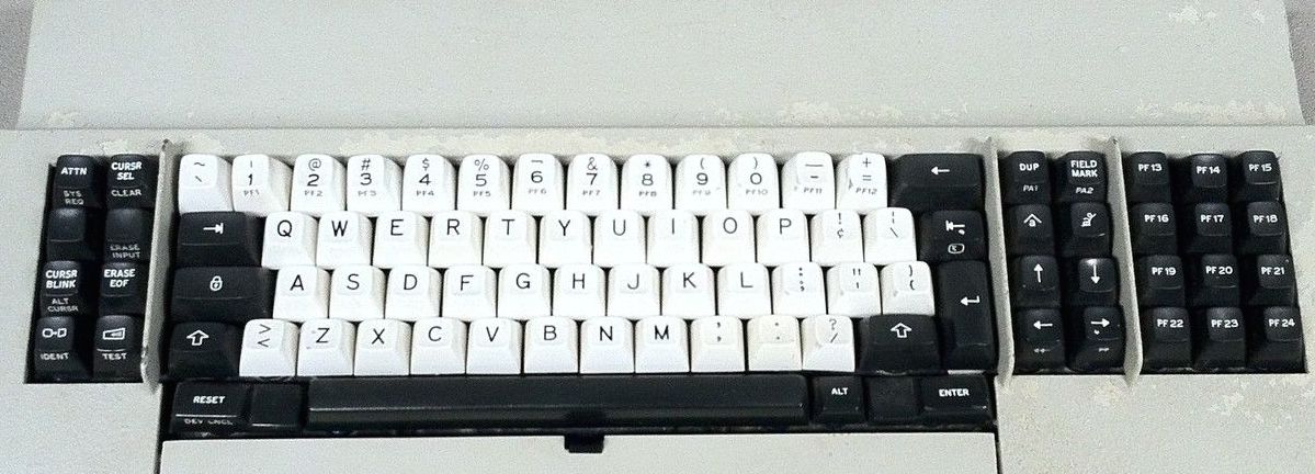

My IBM 3278 beam spring is on the shelf waiting for me to find the time to start the restoration and conversion to USB. In the meantime, although some may consider this sacrilege, I have been wondering if it might be possible to find somewhat smaller cases that would accommodate the innards of the 3278 beam spring. In particular, IBM produced some Model F versions of the 3278 beam spring board. In addition, Memorex Telex and Key Tronics made their versions of the 3278.
Does anyone here know if any of the cases from alternative keyboards to the 3278 beam spring (or others I have overlooked) would accommodate the internal keyboard assembly of the IBM 3278 beam spring keyboard?

Beam springs are huge. There's no getting around it…
IBM developed the Model F as a low profile replacement, and they certainly advertised it as such, compared to the "typewriter style keyboard" beam spring models. So while the layouts may be similar, these cases won't be deep enough to house beam spring mechanisms. Or at least I'd be surprised if they could.

I don't think there will be compatible cases from IBM, for the reasons that Muirium gave, but there is definitely some unneeded height in the outer 3278 case, maybe about 5 or 6 mm. The keyboard itself is in an inner case that cannot be made smaller I think, but you could design an outer case that is less high and maybe less steep, too.
The hard but ideal solution would be to make a case that can replace the inner case in a way that renders the outer case obsolete... :o That way you could probably save 8-10 mm of height.
The problem with all this: the keyboard alone, from the lower plate to the top of the key cap is still 50 mm! So you're really not gaining too much. It would probably be better to use a lower table.
