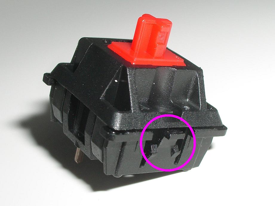

The switches have four tiny little "teeth" that click into place when using a 1.5mm plate.
Cutouts should be tight enough to be slight friction fit, but achieving that depends on the technology used to form the holes.
In this picture (from the DT wiki) you can see the "teeth".
Hope that helps.

Please forgive me being a bit slow here, but where on that switch are the teeth located - I can't seem to see what you're referring to. Also, you specifically mentioned a 1.5mm plate - are you able to get switches that are catered towards different sized plates?
