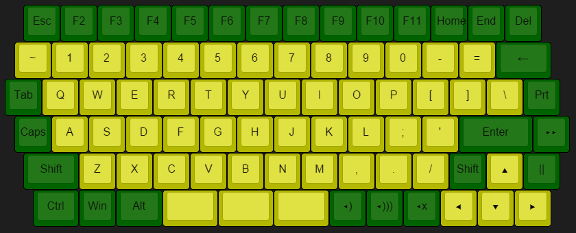

So with this in mind I came up with a few layouts that both get rid of most of these keys and get rid of the 16th column.
First draft version, ugly photoshop! This has a 5.25u spacebar, which I fix in the next designs.
Now with 4u length spacebar.
Editor link: http://tinyurl.com/kywf8xe

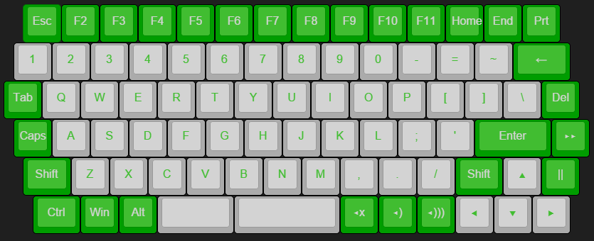

Third version in chalk, this design has a 6.25 spacebar as well as a better arrow layout, drawback is that the volume control keys are not nicely grouped.
Editor link: http://tinyurl.com/6-25space

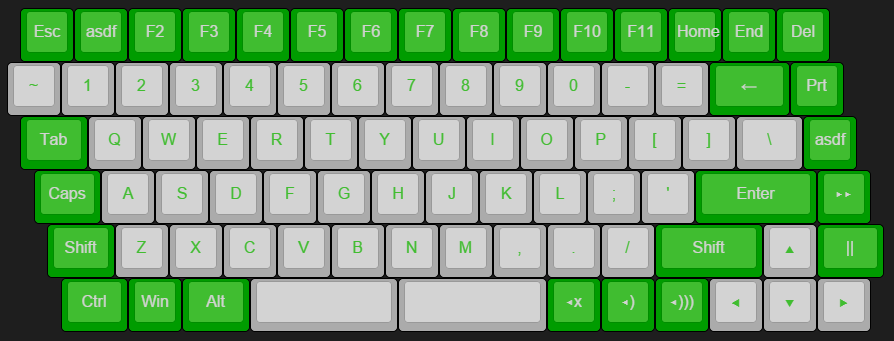

Fourth version, this has a smaller left side, but a grouped volume control and two extra keys. I don't like it very much yet.
Editor link: http://tinyurl.com/altctrllayout
I think I like the third version best as of right now.

28 Sep 2014, 15:36
You use Windows, and never use F3 (find/find again) or shift+F3 (find previous)? Interesting.
(F4 lets you edit the address in address bar in Explorer/File Explorer, but Ctrl+L does the same as well as focusing it for you for ease of overwrite.)

I'm very familiar with the 4th layout. beware or the backspace position, I find it a bit uncomfortably to the right
Bhuyakasha
28 Sep 2014, 16:40
matt3o wrote: I'm very familiar with the 4th layout. beware or the backspace position, I find it a bit uncomfortably to the right
Heh, I might have been inspired just a tiny bit by this post of yours (read: blatantly copied) for that last layout. http://deskthority.net/workshop-f7/cust ... t5663.html
Loved your brownfox tutorial as well, found lots of useful stuff in there.
Daniel Beardsmore wrote: You use Windows, and never use F3 (find/find again) or shift+F3 (find previous)? Interesting.
Holy shit, I did not know those things. I am very used to using Ctrl+F for the F3 one though and I don't care too much for the F4 one. Also, I will most likely simply code them as F3 and F4 and just set them as previous and next track in my hotkey settings in Mediamonkey.

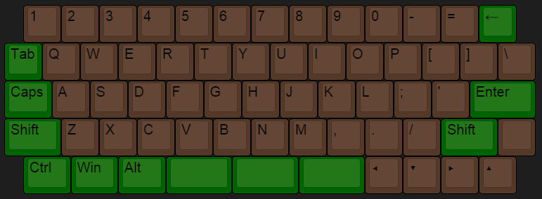

Layout design
I'll start off with the progress on the design of my layout. So I thought I had already decided on the 3rd layout from my previous post, but I changed my mind. Following from seeing a post somewhere about a keyboard without stabilisers I started to fiddle around in that awesome editor tool (http://keyboard-layout-editor.com. I wasn't meaning to actually build something like this, because I don't want a 60 percent keyboard, but I just like the way they look. Here's what I came up with:
I don't actually think this was that great, but when playing with it in my original design it sparked some pretty nice ideas.
Here's the use of it in the original:
This already looked really cool to me, because it gets rid of the blocky feel of the old layout. The previous version still was a bit too conservative in my opinion.

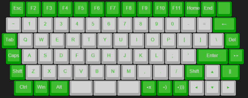

Then here's me fiddling around for a bit more.
Evolution 3
Maybe it's nice to have the arrow keys line up? Makes for an awkwardly large pause button though, which doesn't make much sense.
Evolution 4
Maybe I actually do want somewhat larger modifiers on the left. This also makes the thing a lot clunkier though. Also, good luck finding 2 2.75u keys in the same set, same goes for 3 1.75u keys.
Evolution 6
An important realisation I had here was that the number row was in a really awkward spot before, it was shifted an entire unit to the right because of the staircase design.
Much better now, with number row shifted to the left and moved the `~ key. I think arrow keys not lining up actually helps the design a lot. Looks much cooler. Note that it is actually quite close to evolution 2.
Sidenote, it's retarded to split up a 4.5 spacebar into 3 1.75u keys, 2 times 2.75u is much more logical (even though this is not in the current design anymore). Right now it's a 4.75u spacebar split into a 2u and a 2.75u, because after a tiny bit of research I noticed that I only use my left hand for space when my right hand is on the mouse.
And yes there was also an evolution 5 inbetween, but the only difference with 6 was a shorter left spacebar along with bigger alt.
Something that I also thought a bunch about is how to make the q, a and z keys staircase (staircase is now a verb). On a standard keyboard the last drop is .5 u, but I think it looks quite nice if it's actually a .25u drop. I don't think I would really mind getting used to that, but the reason I didn't do it is because I like my left shift to be bigger.
I also decided to implement a printscreen key as I do use that every now and then.

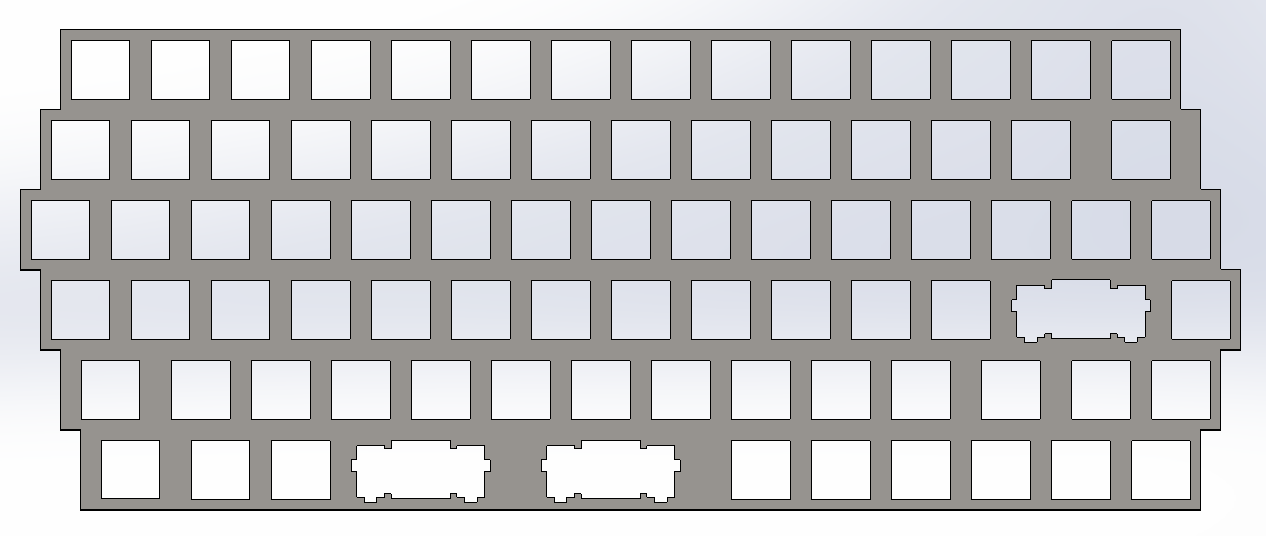

I have had an introduction to SolidWorks once, but am still quite a shitter on that area. I did manage though, so here you can see the plate.
You can see that I used the cherrycorp stab cutouts. I noticed the platemounted ones are quite rare, so I may want to reconsider. I think both costar and cherry are fine actually, but I thought I'd try out the cherry ones.
Question, is it possible to just use PCB cherry stabs on a plate mounted keyboard? Shouldn't be too big of a deal right?

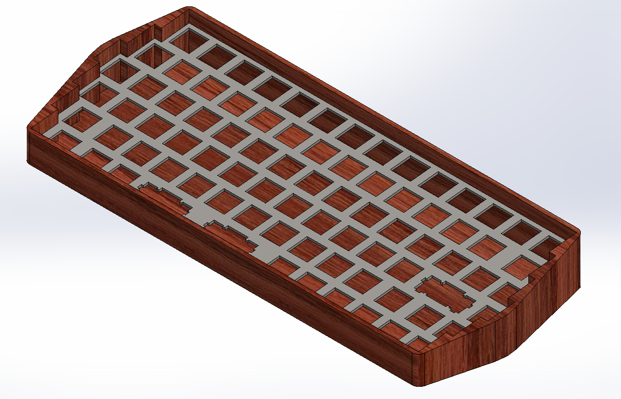

So anyway why not model the case in there as well...
I am still thinking about how I will attach the plate to the case. I could glue it I suppose, but a glueless board would be preferred. Maybe make the wood stick out a bit and screw it to the plate.
Any recommendations for how to attach the plate to the case?
I didn't make a hole for the usb cable yet by the way. I will most likely make the bottom plate separate from the rest of the case and screw it on. I thought about sliding the plate into the case from the side as well, but that might not be so smart after all if you take into account the usb cable.
What do you think?
