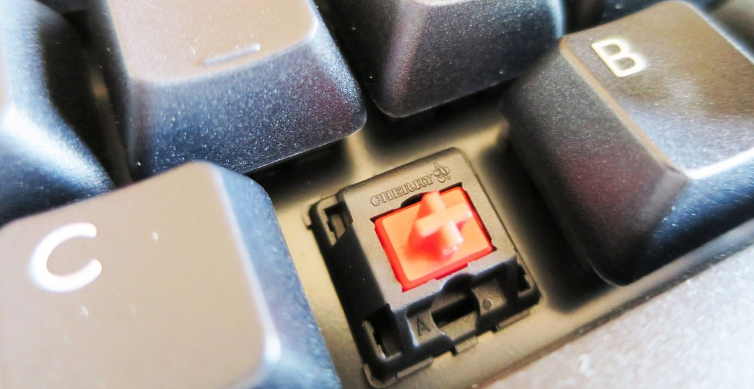

Having tried a large array of keyboard switches, I had almost given up on Cherry mx altogether. Before today, I had tried blues, greens, browns, and clears, (as well as vintage blacks in a Wyse terminal board not connected to a computer).
Blues sounded and felt like typing on rice crispies. Greens were much the same, but heavier. Browns and clears felt like there was sand in the works. Vintage blacks were agreeably smooth but a bit heavy, and I wanted some tactile feedback.
This left contemporary blacks and reds. I was concerned that blacks would be a mite ponderous and that reds would be too light, but after squishing each of these in a switch tester, I opted to give reds a go. I was banking on the tactile feedback coming from bottoming out.
Today the reds arrived, installed in a Kul ES-87.
http://www.xtremehardware.com/gaming/ta ... 7/?start=3
The Kul keyboard itself has a lot to like. It is a solid TKL with some intelligent DIP switch options, such as Win/Mac, Caps/Ctrl, Fn/Menu, and even Backslash/Backspace -- all with extra keycaps to match. And instead of a Win key, there is a generic diamond; it is nice to know that not everyone has been bought by M$.
In the negative column, the Kul is fitted with thin ABS keycaps with infilled laser legends; these are begging to be swapped with some nice dye-sub PBT caps.
When I started typing, I found that reds were not as overly light as I had feared. And because I tend to bottom out with just about any switch, I got a solid clunk from each keycap hitting the plate -- until, that is, it came to the stabilized keys (Backspace, Enter, Left Shift, Right Shift, and Spacebar). The stabilized keys felt decidedly mushy, owing to the Cherry mx stabilizers. It seems that with Cherry mx you have to contend with Costar rattle or Cherry mush on the stabilized keys. I had not noticed this so much with tactile or tactile/clicky switches, but with reds, the difference between a regular key hitting bottom and the stabilized keys was obvious and annoying.
The next thing I noticed was the scratchiness. This is particularly evident when slowly pressing a key -- it seems to arise from a combination of the plunger and spring rubbing against the switch housing. This sensation of scratchiness is not noticeable with buckling spring or Topre switches. It is also not noticeable on my old Wyse board with vintage blacks. I had seen numerous posts about this from others, and I can now vouch for it myself. Perhaps this could be alleviated by taking the switches apart and doing a proper lube job, but this seems like more trouble than it's worth.
There is also a discernible wobble to the keys arising from the tolerance between the plunger and switch housing. This is alleviated in part by installing keycaps with a lower profile.
Having read many complaints about the undue lightness of mx reds, I did not see as many accidental presses as I had anticipated, except with the spacebar. For me at least, this keyboard needs a heavier switch under the spacebar, perhaps with some tactility as well.
Overall, my impression of the Kul ES-87 with Cherry mx reds is somewhat positive, and not as negative as I had feared. I am somewhat surprised to find reds more or less tolerable, and I think it would be worth experimenting with different keycaps and O-rings to fine tune the experience.
By the way, after trying a few caps from various sets, some of the best I have encountered are the PBT sets from Leopold -- these are available on eBay at reasonable prices. And I think that O-rings might even out the disparities in sound and feel between the regular and stabilized keys.
While I don't see any Cherry mx switch replacing my current favorites (IBM Model F capacitive buckling springs and Topre 55g switches), if I had to choose a switch from the Cherry line, it would be red. Whereas I sold my first Kul (with mx clears) shortly after receiving it, I think I may keep the Kul with reds around for a while.
This relatively positive experience with reds and my overall liking for somewhat heavier switches has me wondering about contemporary blacks or vintage blacks in a contemporary board. . . .
