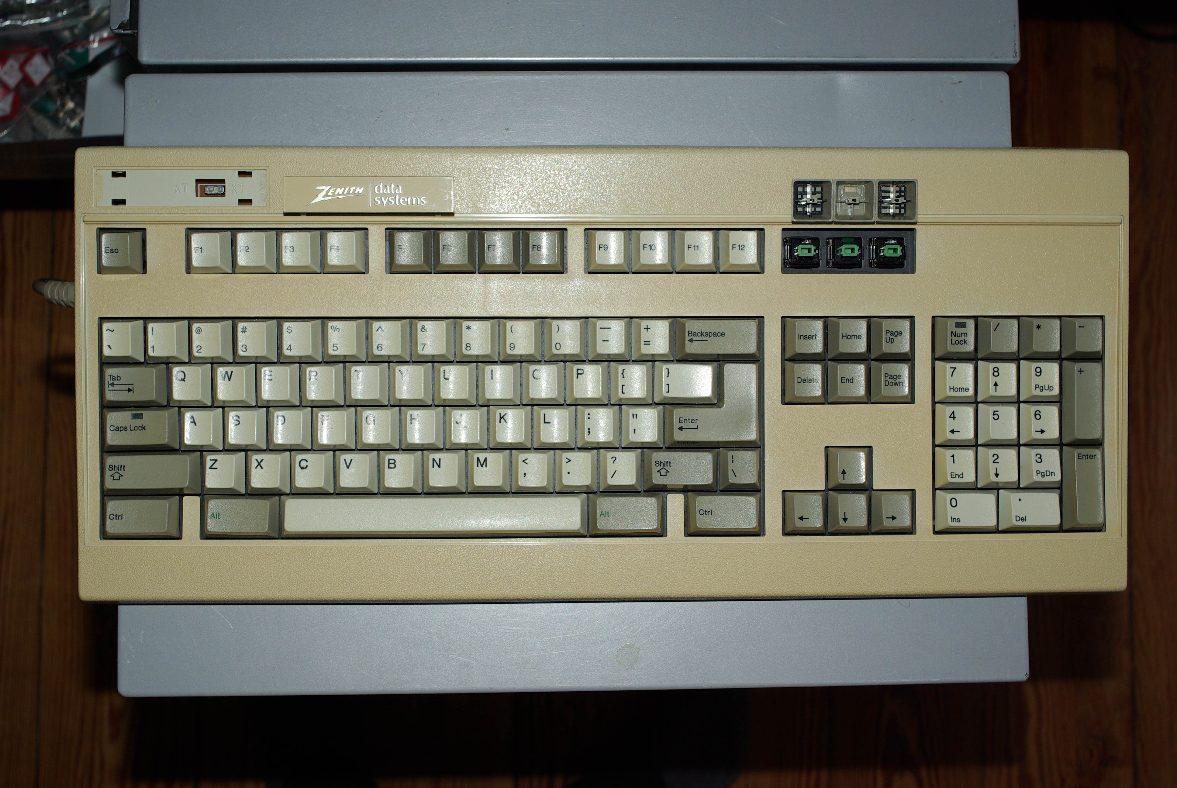

Friend gave me this for free and I know little about it besides it has (mostly yellow alps on it.
The switches feel really nice. Unfortunately the case is damaged where the power cord comes out and the bottom plate has some corrosion. Also one of the switches is broken and missing the keycap (f10)
If someone smarter than I am can enlighten me with some info on this, it would be much appreciated.

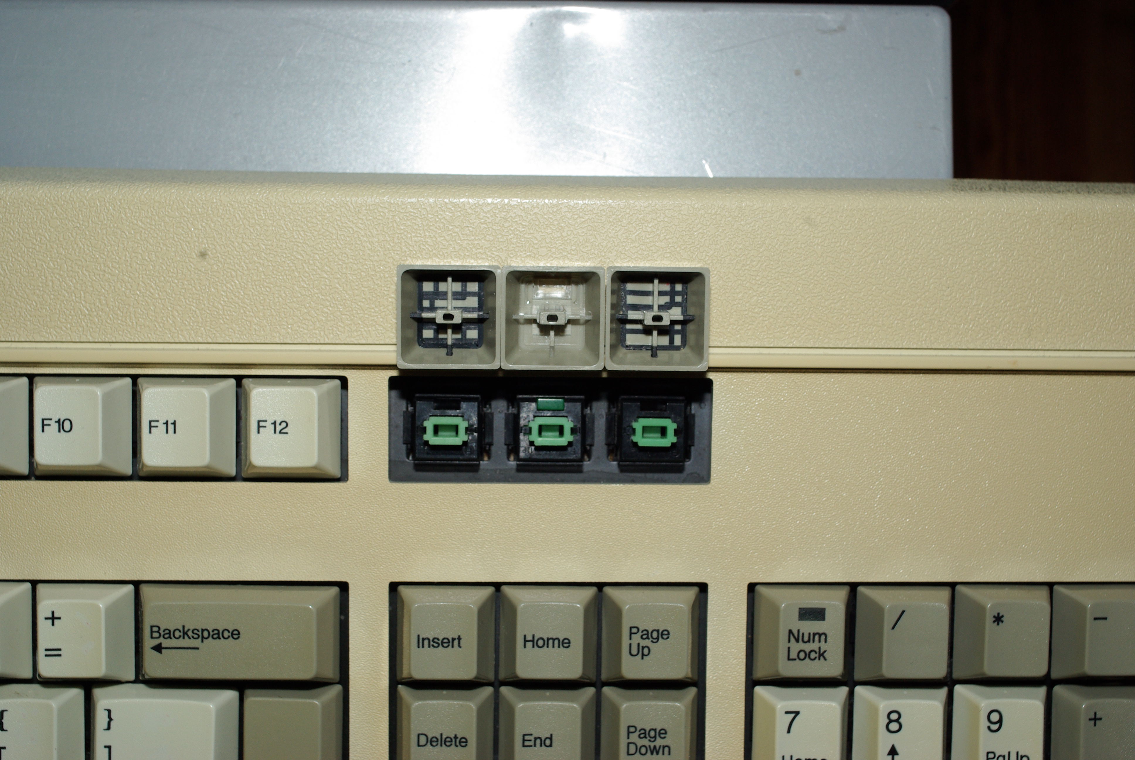

See this is where Alps starts to get really weird.
The general consensus is that green switches are a bit lighter than yellow (I confirmed this myself with my own switches).
So why would you make the lock switches green Alps, when the rest of the keyboard uses switches perfectly capable of taking LEDs?
I do wonder if it was that only green Alps were manufactured with the LEDs inside originally.
Grey on space bar is of course stiffer.

I had another keyboard with green sliders on the switches with LEDs and otherwise yellow switches. The green switches have tall white switchplates (like certain orange Alps switches have), while the yellow switches have short white switchplates. My working hypothesis is that the tall white switchplates are the final few batches of green and orange Alps switches before they switched to short white switchplates and changed the slider colors to salmon and yellow.

As far as the greens go, sounds like I'm wrong, but I didn't spend a lot of time trying do differentiate in feel, although one of the greens felt stiffer than the other. I would like to restore this but I have no Idea how to get it working unfortunately :(.
Also forgot to take a pic and mention but most of the keycaps are doubleshot though the plastic seems pretty thin and from the yellowing I'm assuming ABS.
11 Nov 2014, 18:54
Yup. Doubleshot almost always means ABS. Only very recently has this been anything other than 100%.
The cable is good old AT / DIN 5. Looks like an ideal job for Soarer's Converter. I wanted that Zenith which Seebart mentioned, because the short right Shift key has a perfect HHKB style Fn candidate next to it. I use Soarer's to play the same trick with my IBM Model F XT.

Ok yeah it is a standard din5 end on it. Just fits very very snug. In the process of cleaning the keycaps. I should retrobite but I don't have the materials to and want to put money into other projects currently. Wanted to correct myself on the green alps, they are definitely lighter than yellow once I spent a couple minutes actually playing with them.

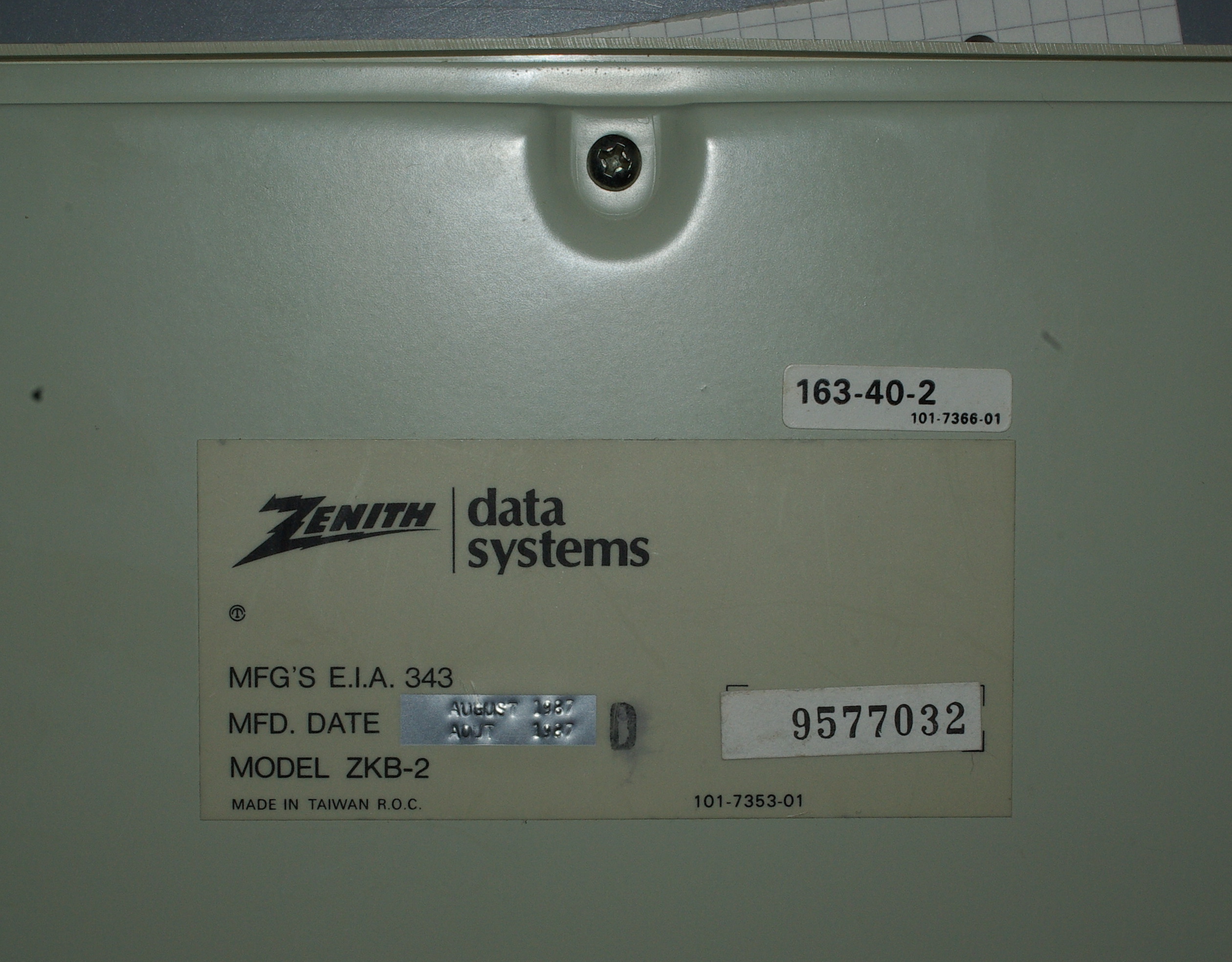

My ZKB-2 reads August 1987 on the label. I love the "hidden" AT/XT switch compartment. My ZKB-2 has a audio click feature, I don´t know what it´s called. With the metal backplate the ZKB-2 is a very solid keyboard. The metal feet are similair to those on my NTC KB-6151N. As far as I know all Alps SKCL have a notch for the LED, Alps SKCM do not. Green being the oldest of that series. Of course that´s all in our Wiki. I just noticed the LED keycap does not "snap in" when pressing the cap back onto the switch.
