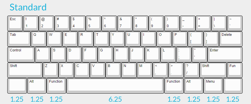

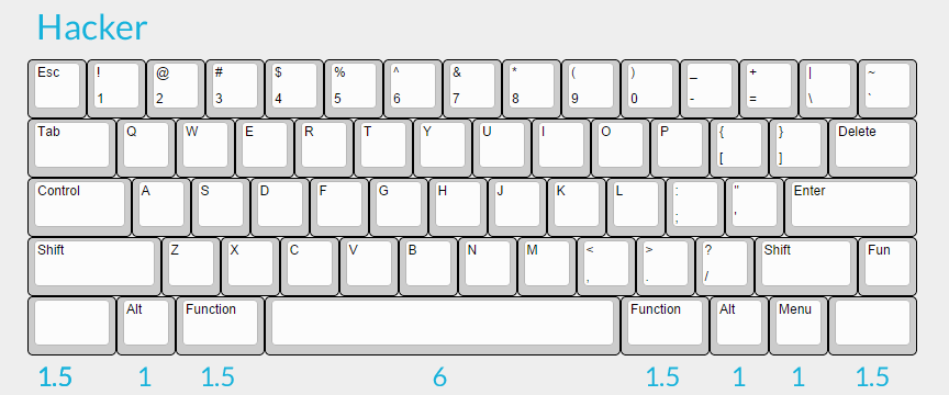

@Muirium: Yes, I have been looking at profiles, and as much as I admire Matias and wish him well, I have just about given up on the forthcoming Matias 60.
However, I really like the Infinity keyboard kit project that was available on Massdrop, and it looks like there may be a second round. It is a bit pricey for a DIY kit, but there are not that many keyboard options with Matias switches, and they have chosen an intelligent layout based on the HHKB. Split right shift key!
https://www.massdrop.com/buy/infinity-keyboard-kit
Here are the two Infinity layouts:
Note that the bottom row contains Function, Alt, Menu, and blank keys as mere placeholders; the layouts are entirely programmable.
19 Nov 2014, 03:15
I like the "Standard" layout, of course…
Both of those will be quite challenging to source from classic caps, though. Not impossible, but challenging. Fortunately, short right Shift was quite common, once upon a time. Often the \ key went to the right of there, thanks to its natural place being taken up by our old ungainly friend Big Ass Return!
Yeah, it's tricky.

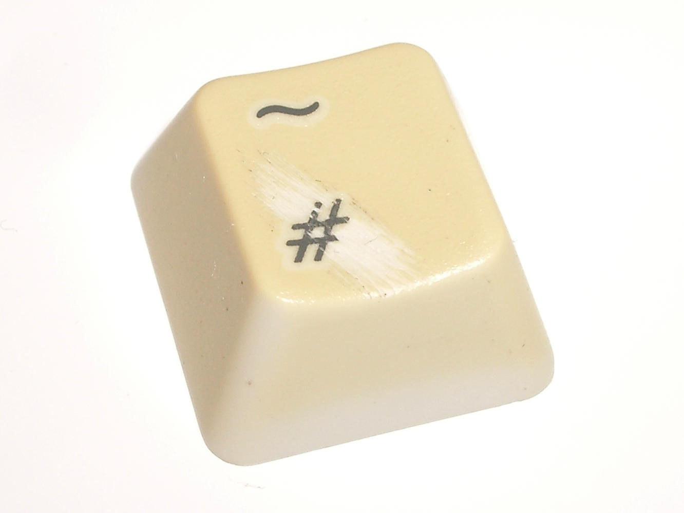

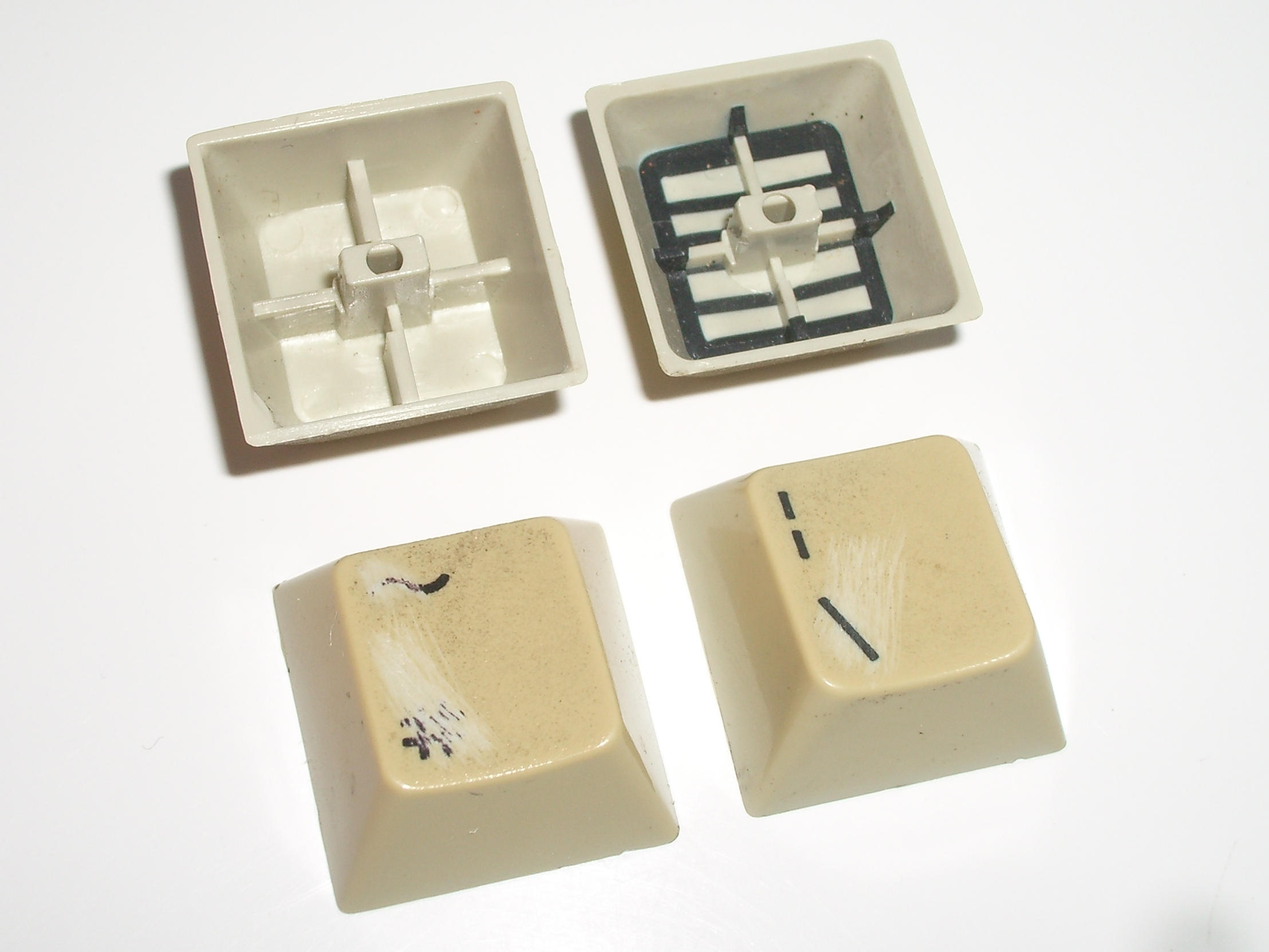

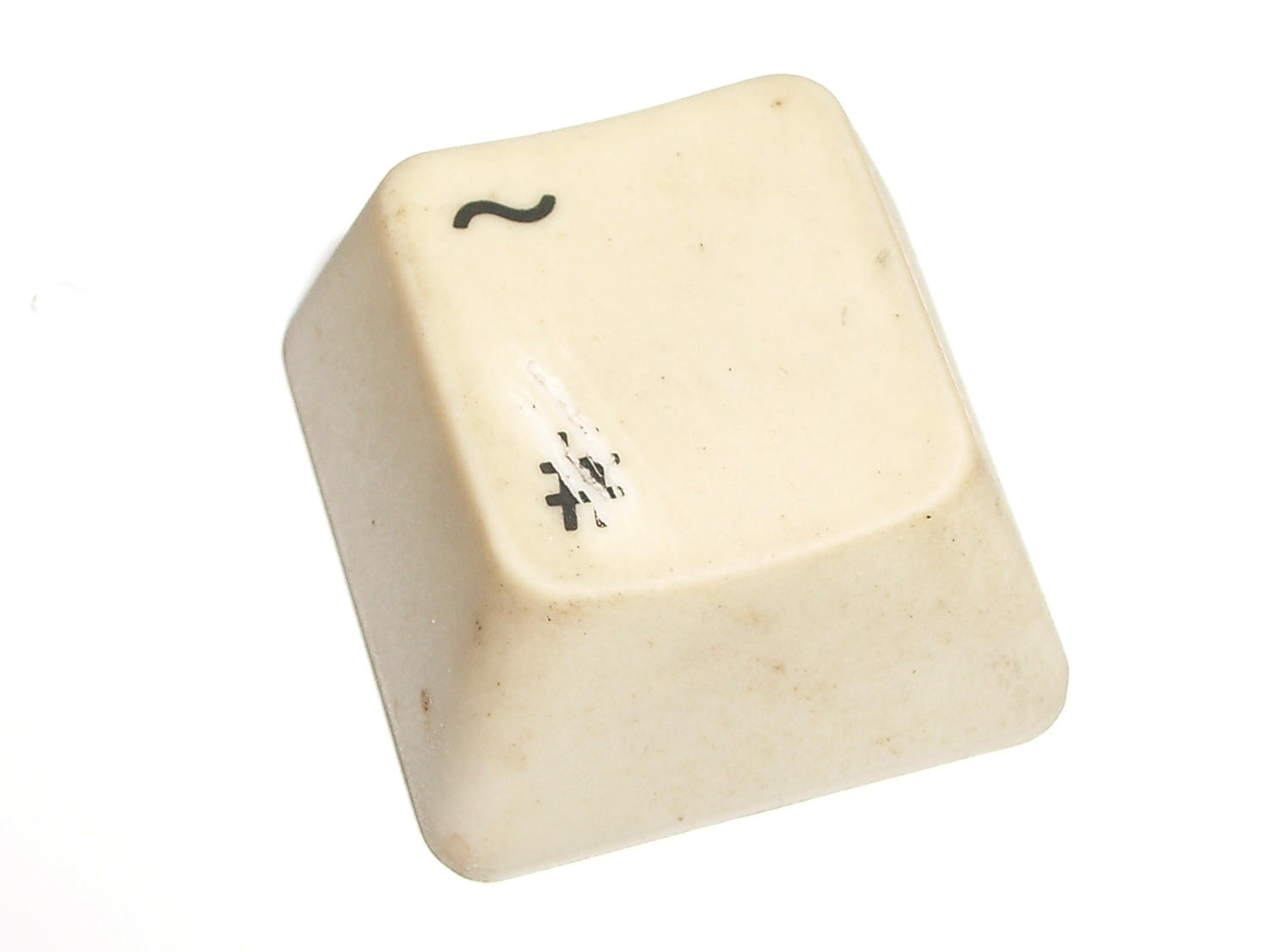

19 Nov 2014, 22:58

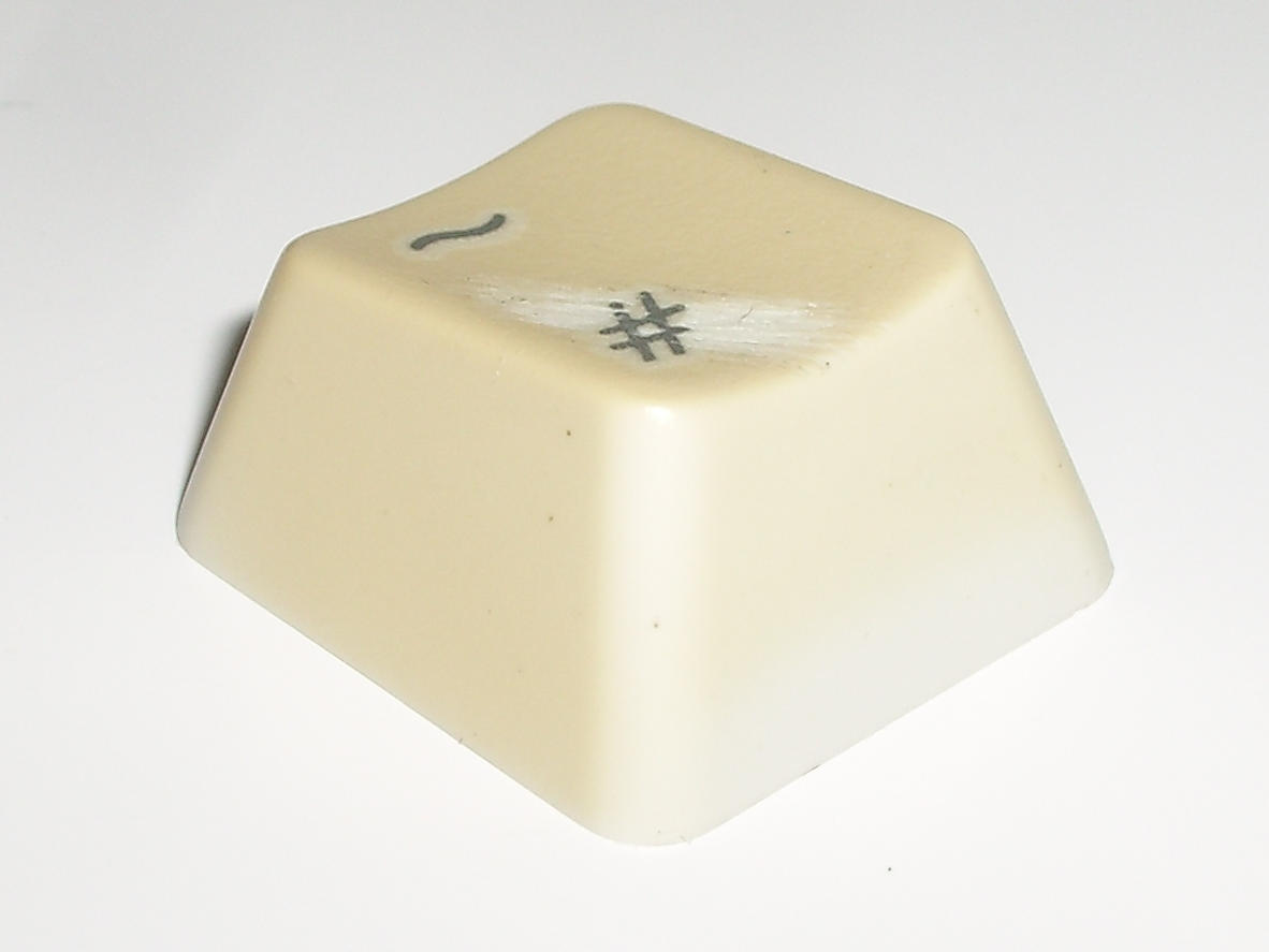

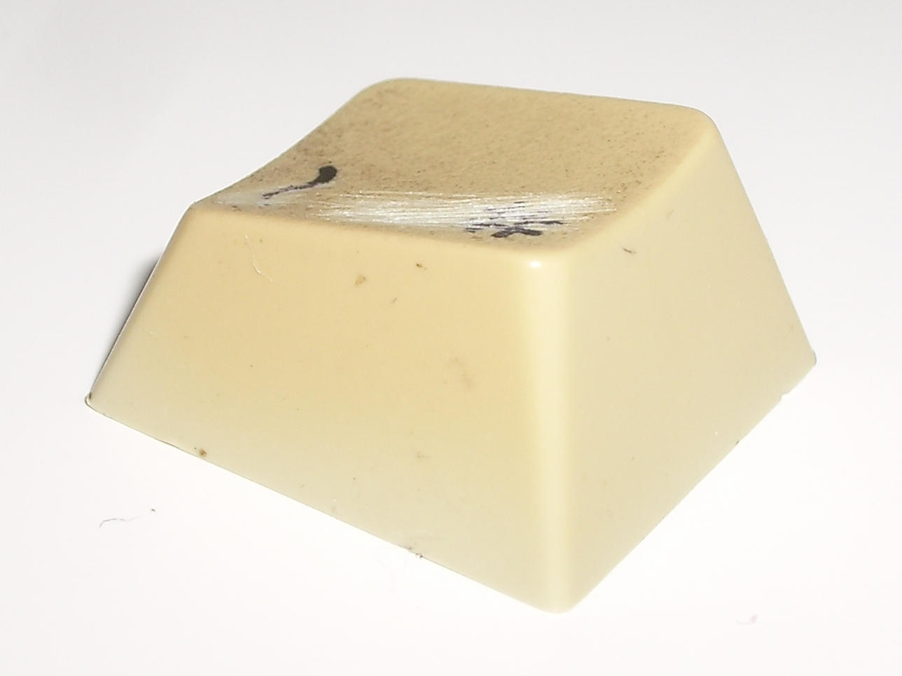

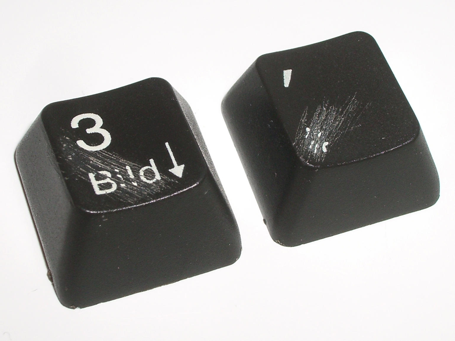

Some unscientific tests:
1) Tulip ATK 030244 — most keys are double-shot, with an alternative printing method used for the regional keys; the alternative method is flush with the surface of the keycaps, is difficult to scrape off appears to have penetrated a little into the plastic, and maintains the same shine as the surface of the keycap.
Tulip ATK 030244 (Monterey K102) -- unknown and double-shot.jpg (196.67 KiB) Viewed 13629 times
Tulip ATK 030244 -- yellowing.jpg (55.79 KiB) Viewed 13629 times
Both types of keycap have yellowed badly.
2) Datacomp DFK192 — thick gloss pad printing, which scrapes off more easily, as the plastic seems to be softer and easier to disturb.
Datacomp DFK192 -- thick pad printed.jpg (140.27 KiB) Viewed 13629 times

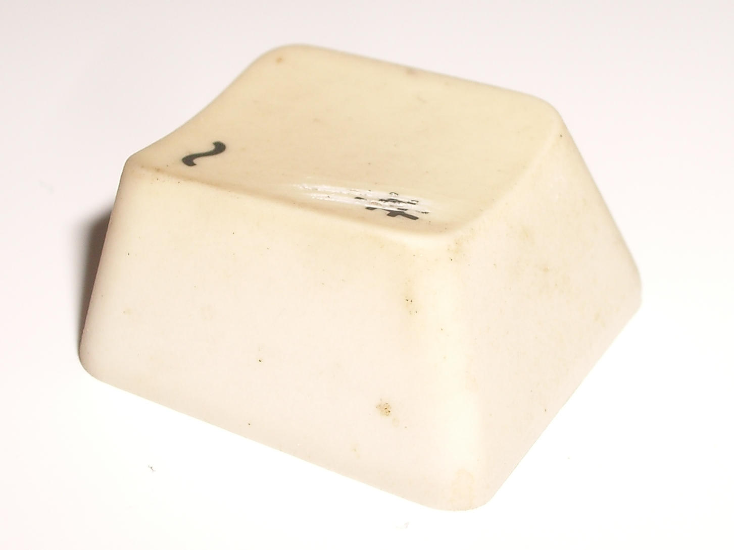

3) Acer 6312 — legend is very easy to scratch off and clearly has not penetrated at all, yet still appears to be dye-sublimated; the plastic has yellowed, but to a far lesser degree than other keyboards might.
Acer 6312 -- unknown.jpg (60.49 KiB) Viewed 13629 times
Acer 6312 -- yellowing .jpg (55.81 KiB) Viewed 13629 times

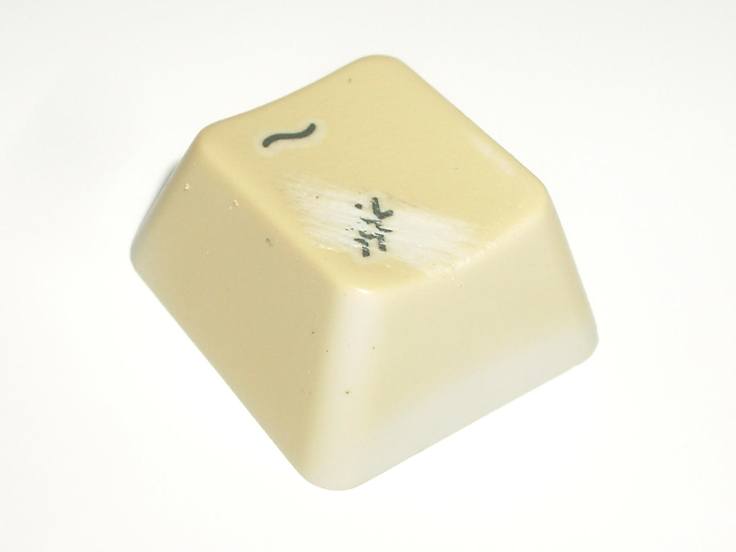

4) Mitsumi KPQ-E99ZC-12 — pad printed with selective image clear coat. For anyone who doubts the longevity of pad printing, they need a Mitsumi as the legends on this keyboard are virtually impossible to remove.
Mitsumi KPQ-E99ZC-12 -- selective image coated pad printed.jpg (53.02 KiB) Viewed 13629 times
Mitsumi KPQ-E99ZC-12 -- yellowing.jpg (44.96 KiB) Viewed 13629 times
Having continued to attack the surface with a knife I finally got to the point that the clear coating was starting to give way, but this took a lot of scraping with sharp knives to get to this stage:
Mitsumi KPQ-E99ZC-12 -- further scraping.jpg (55.98 KiB) Viewed 13629 times
You've seen keyboards where the clear coat is significantly stronger than the ABS and the legend remains when the rest of the surface is worn away, and this is that type of clear coat: extremely durable.
