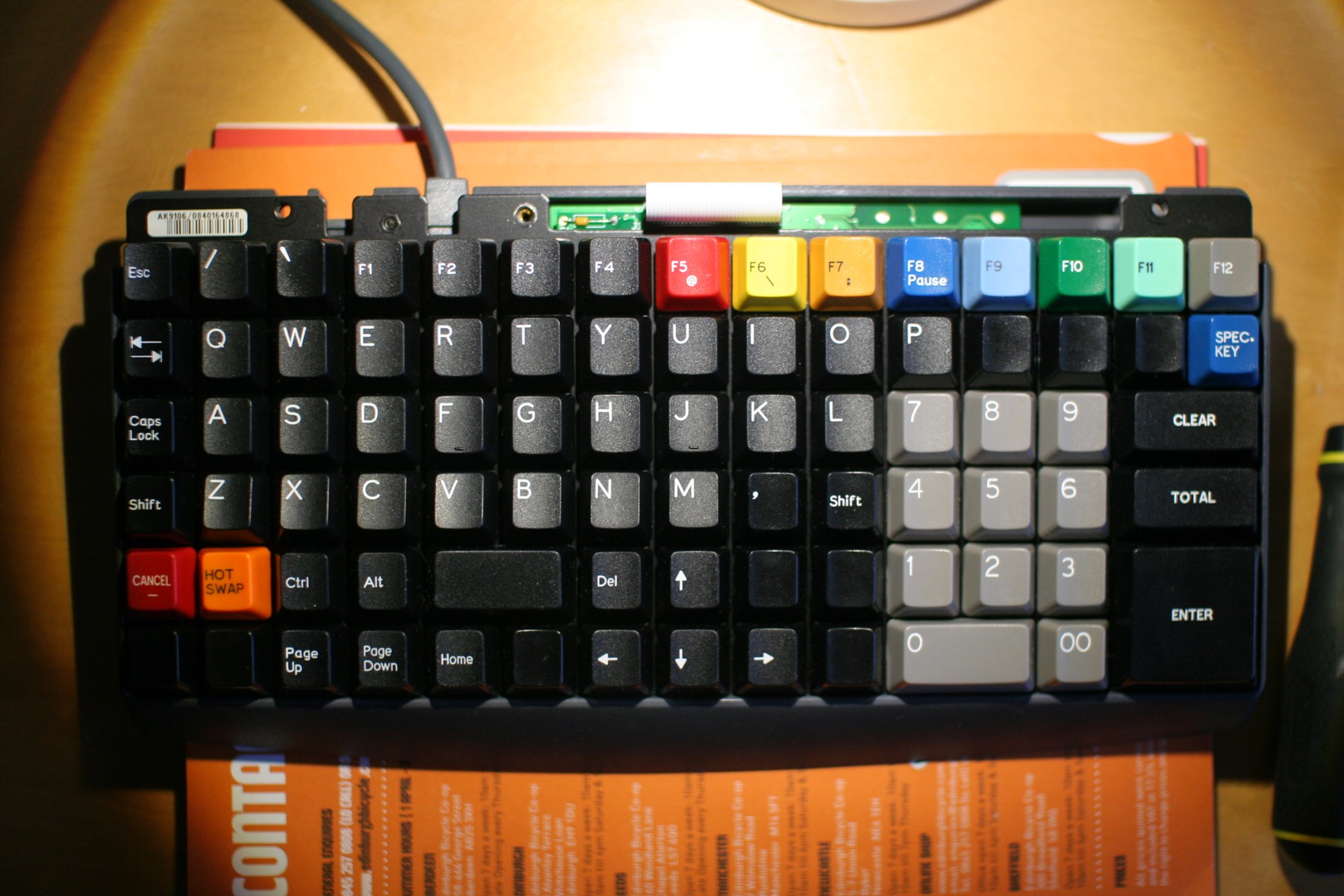

A pile of these Access-IS matrix keyboards sits on my desk, new in their boxes. They're all spoken for, so don't ask! But here's a peek inside for anyone interested in Tipro's English rival…
These are the AKEOCTI Model. A nice compact 15 column by 6 row matrix, fully NKRO, in a fairly attractive case. They're solid wee things, and have a decent enough set of caps, the alphas being doubleshots. The main downside of these PS/2 boards (just like older Tipros) for me is the quirky software used to program them. They ship with many keys unassigned — most of the black blanks, and a few more besides — so for USB only guys like me, looking to convert them, they need reprogramming. This is not pretty. Davkol's tutorial has the gory details!

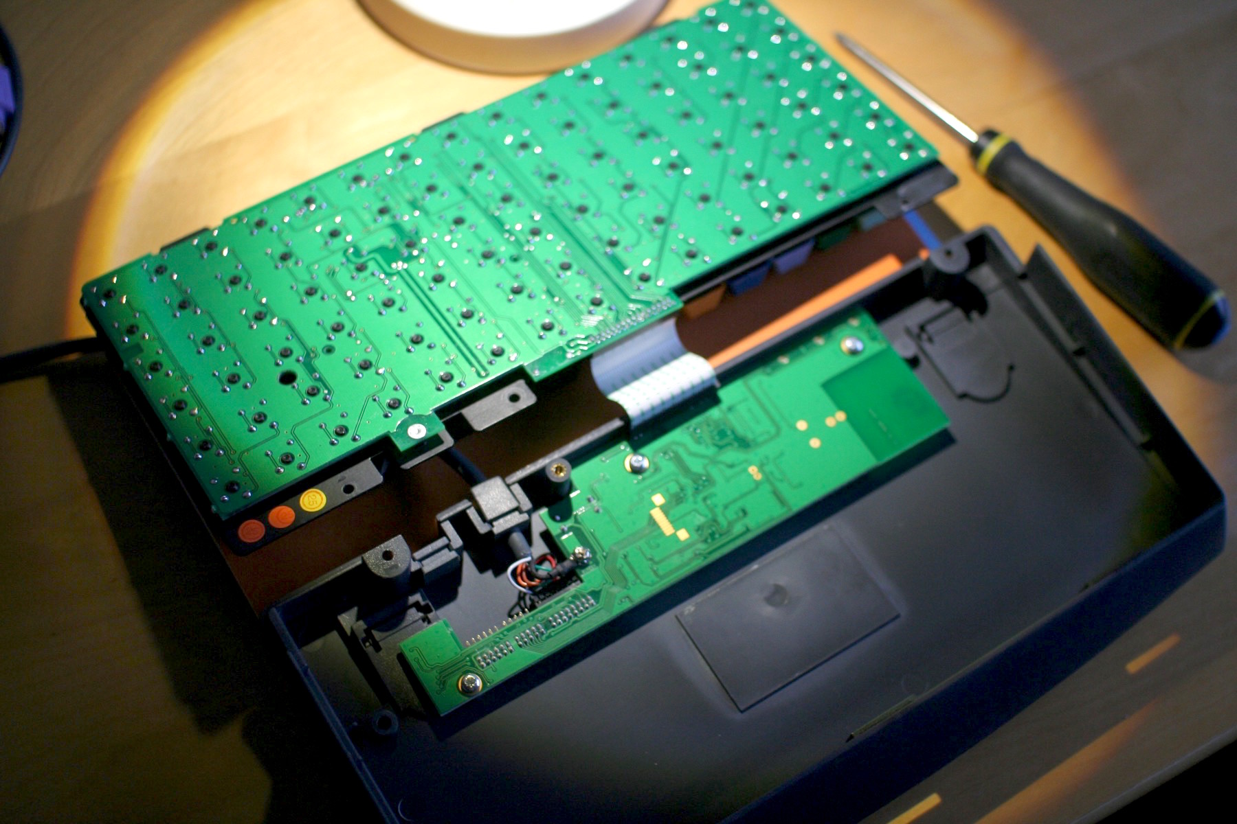

I gave it a shot, but couldn't get the SoftProg software to work. So today I stripped mine down to take a peek for alternate routes. Fortunately, I found one…
Excuse the northern winter light! The case is in two parts. The smaller one is the upper housing you see removed here. All that takes is a couple of screws. It covers this ribbon cable:

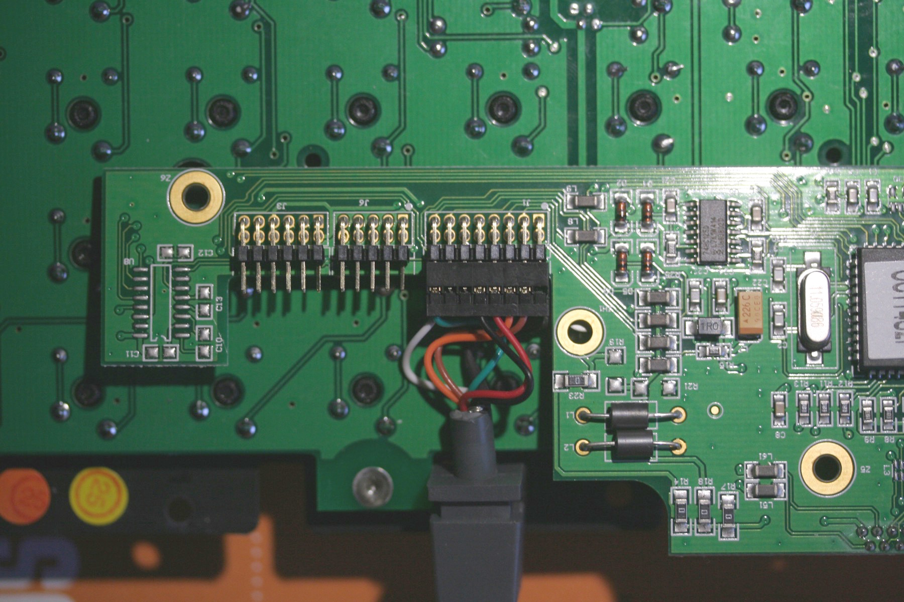

Which leads into a second PCB:
Separate controller sighted! Here's the matrix, viewed from below:
Four solder joints for every switch. You know what that means: there's a full complement of diodes, for NKRO.

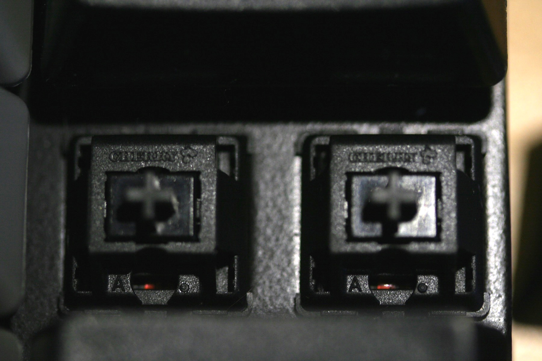

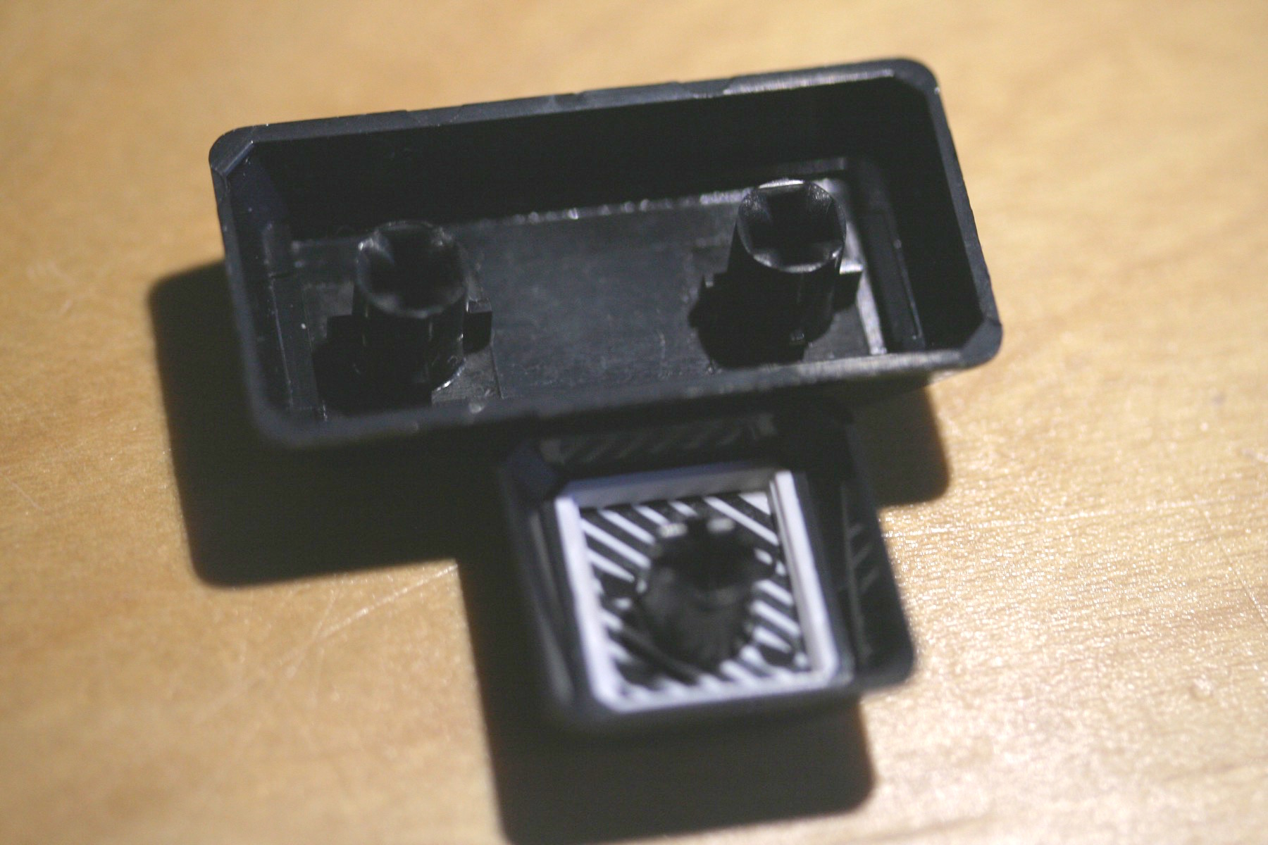

Plate mounted MX blacks all round. The switch spacing is compatible with Tipro and SP POS caps. Here's a SPH 2x1 key. A fair bit taller, of course.
The stock Access caps are cylindricals like this. (SP's DCS profile? I'm guessing so.) Alphas are row profiled thin doubleshots. While the POS specific keys are not.

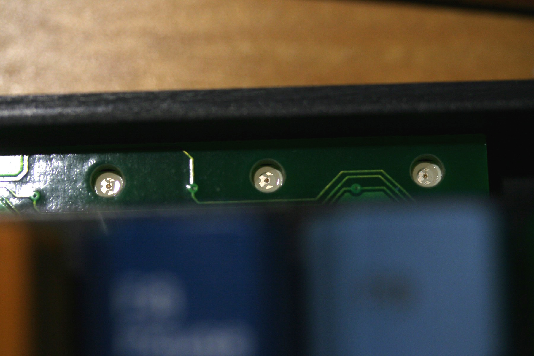

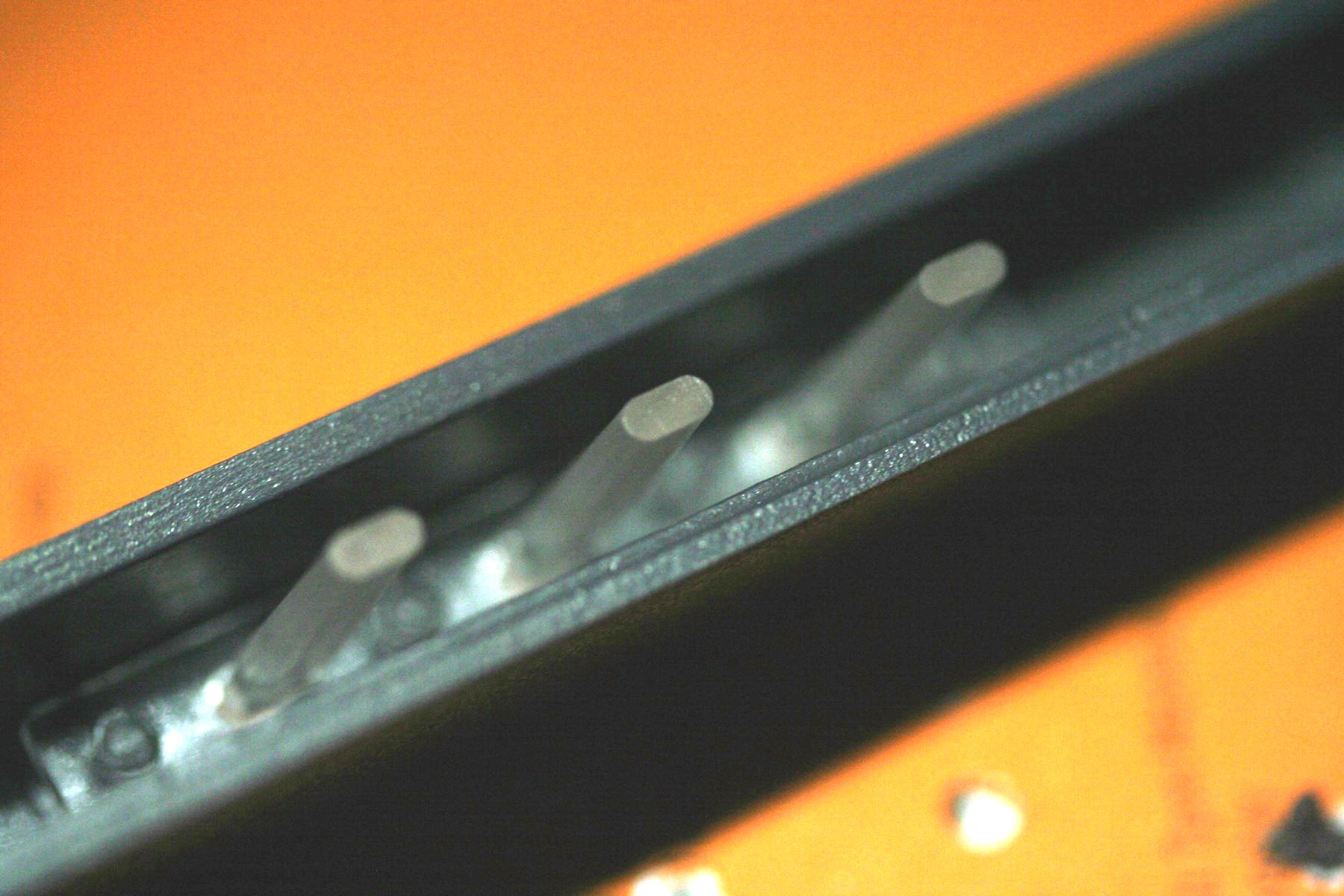

There's also three LEDs along the top edge of the keyboard. I gather these are programmable too. Fortunately, for me, they're on the main PCB, with the switches, away from the controller.
These light pipes in the upper housing make them visible in use.

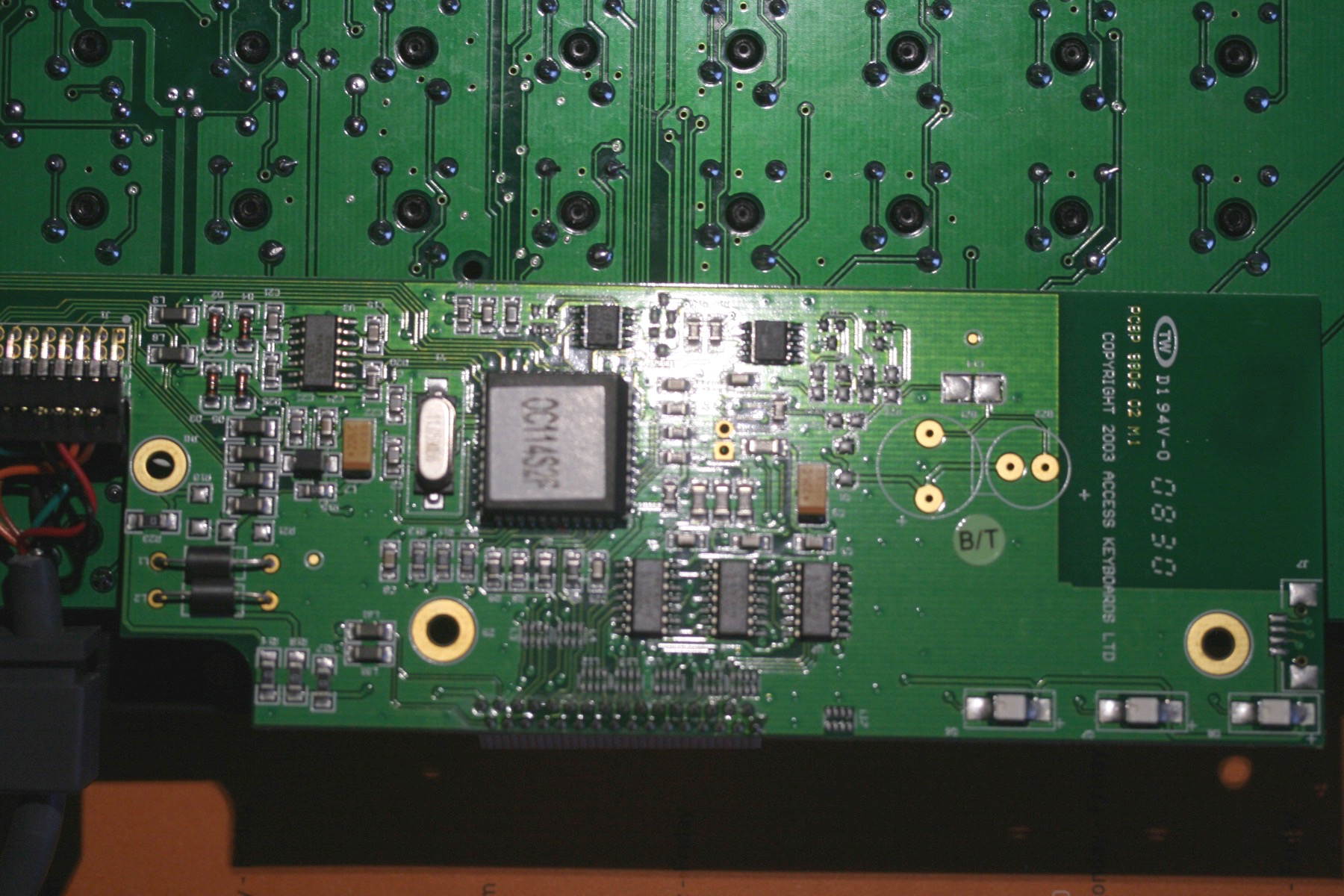

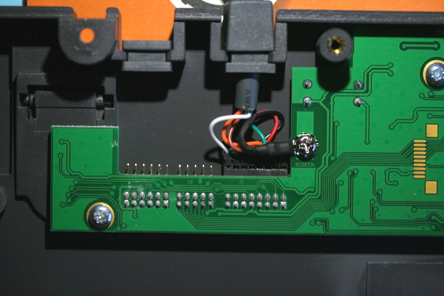

Now for that controller. Here it is:
Only one of these three sockets is in use for the external cable. (Which is a double tailed PS/2 with passthrough on this model.)
Wouldn't it be nice if one of the other two was USB? Yeah, I doubt it too!

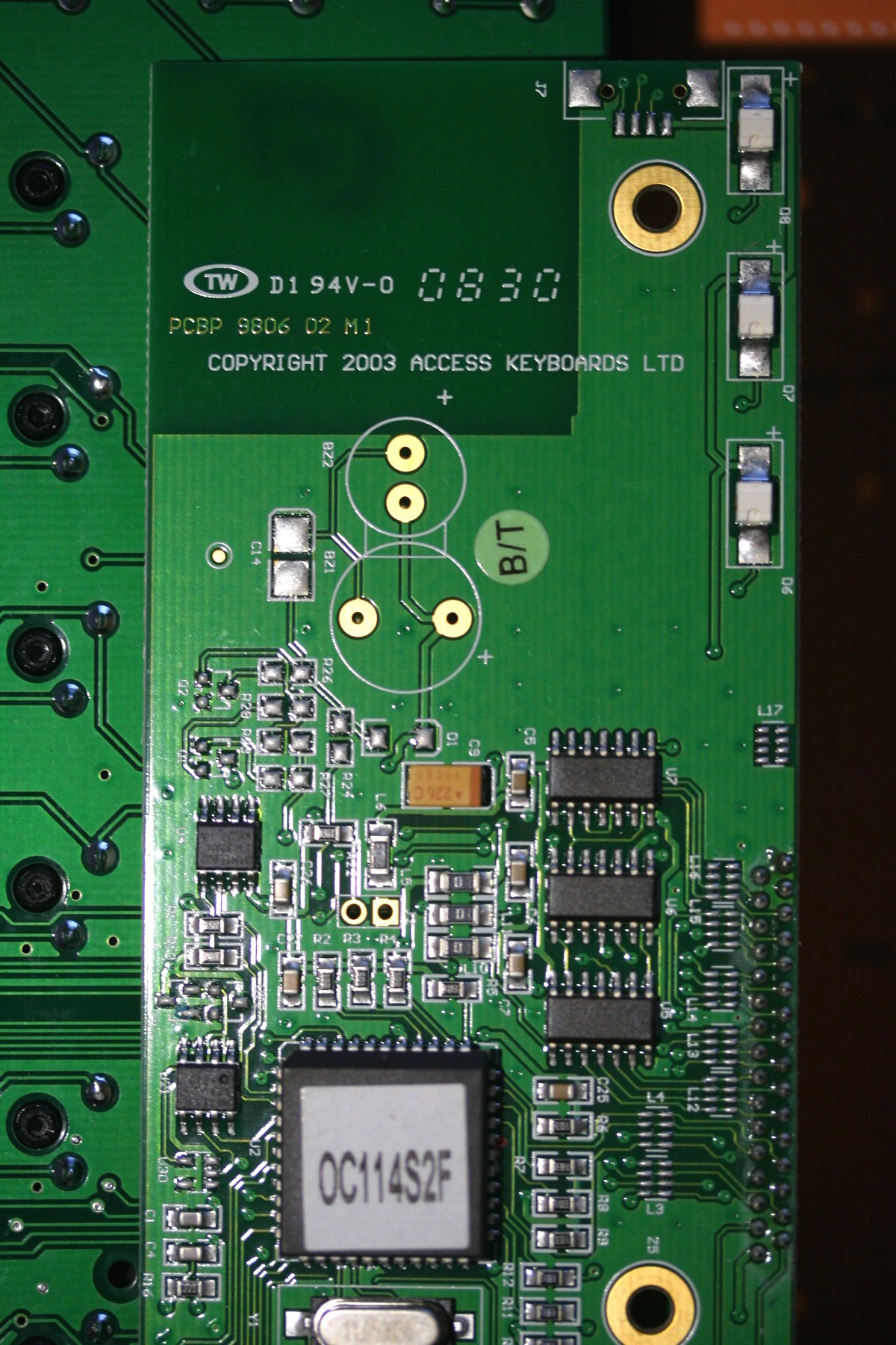

Here's the controller, with its 2003 copyright date.
My plan is to replace it entirely. From what I can see, the whole switch matrix is laid bare on the ribbon cable which joins the two boards. And those three LEDs, as there's nothing else to join them. The ribbon cable is 32 pin, and soldered at both ends. I intend to hook it up to a Teensy and run my own programmable USB controller. Anyone got advice about how I should hook it up, physically?

How is the flat flex connected to the controller pcb ? Are the metal pins that are soldered into the board on a connector or directly soldered to the flat flex ? It looks like a custom job but i bet you somewhere you can get the female connector for that flat flex that they have oh so kindly soldered onto the board, i very much doubt a small company like access would get there own connector manufactured good luck finding info on it, i guess you could ask them if they are sill going.
failing that you could just de-solder it from the matrix and have 2 single in line cable ( like a floppy drive cable but only one row) going to your new board.
Why do people not standardise what would have been wrong with them using a standard pin header form someone like molex they have 1000s of different ones.
I also see some unpopulated places for a coin cell battery and related caps and diodes i wonder if they planned to have volatile ram on-board but then changed there mind or it was just an option and they did not fit it... cheap cunts.

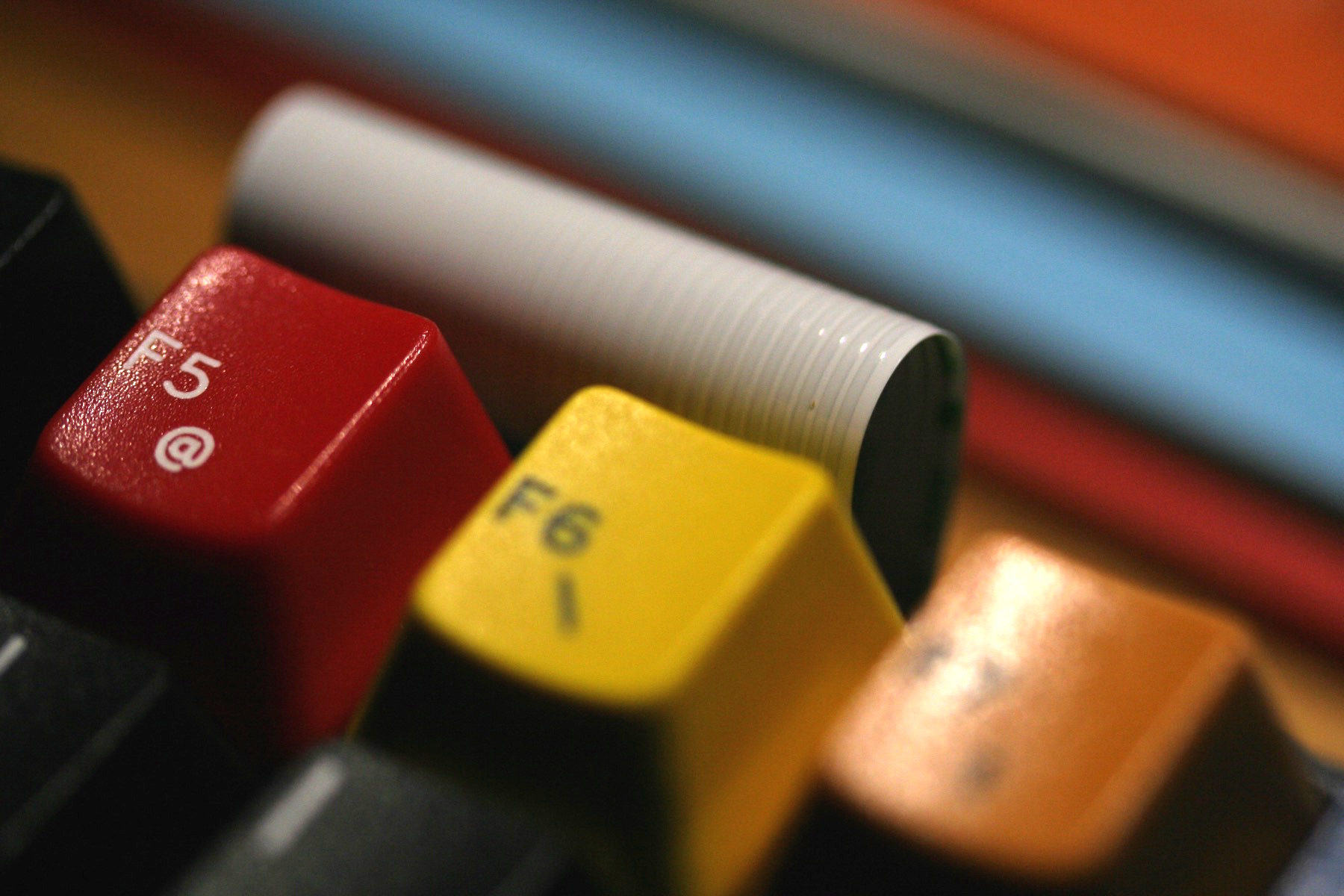

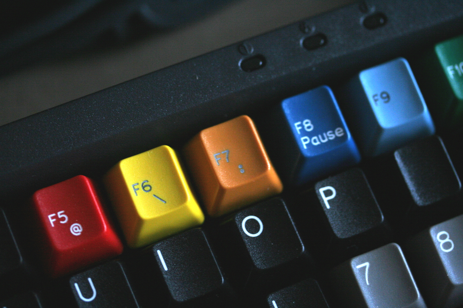

Here's what I was talking about with the handful of dodgy legends:
Does that look laser infilled to you? I don't actually feel engraving when I touch them, but they're a little faded on 3 or 4 of the boards; and always just those pastille caps. The doubleshot alphas are all fine, of course, while the non-DS black and white POS caps also look new. Just seems to be a problem with the pastille shades. I saw this on the board I proxied CeeSA last year, too.
Wouldn't surprise me if it's a quality control issue and they looked like that when fresh out the factory. Ho hum.

It looks like the F6 and F7 are just lasered, not infilled.

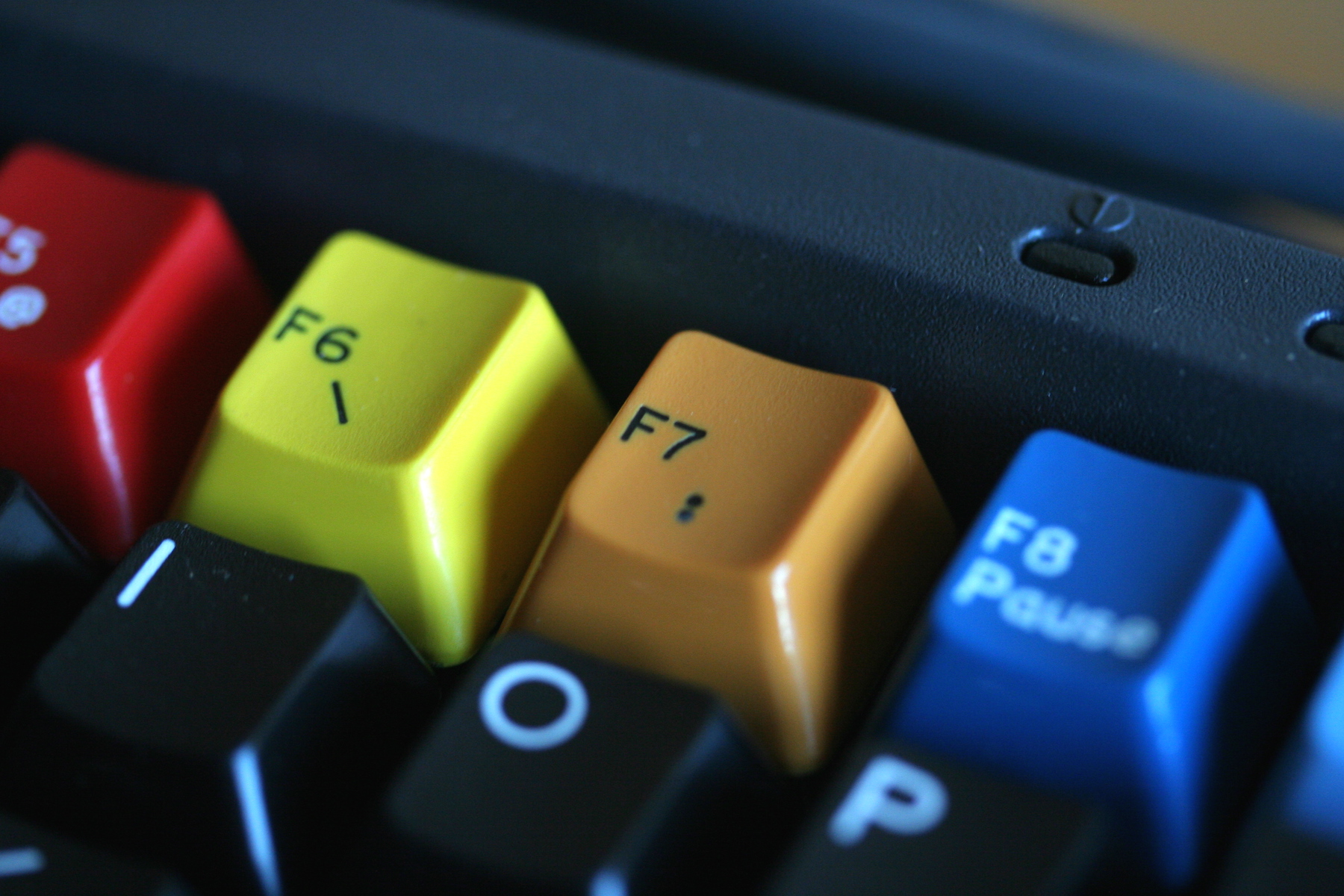

chzel wrote: It looks like the F6 and F7 are just lasered, not infilled.
I must admit I'm no expert on cheapo caps! (I'm spoiled with dyesubs and doubleshots.) But the good ones of those function look like this:

My Access-IS came today, now I have to think of a decent layout for it. Thank you very much for doing this Mini-GB/Proxying, Muirium!
19 Dec 2014, 15:10
You're welcome. I suggest Colemak with home row separated in the middle. That's what I'll be trying for myself when I've more caps and get down to sorting out that controller.

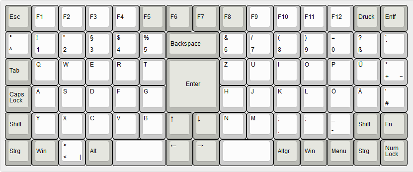

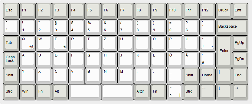

Currently I'm thinking about these two layouts:
Access-IS split ISO.png (22.59 KiB) Viewed 82511 times
Access-IS non-split ISO.png (21.23 KiB) Viewed 82511 times
HzFaq
19 Dec 2014, 15:30
That split ISO looks interesting, I was just planning to use mine as a numpad/macro board but I'm actually kind of tempted by both of those layouts.
19 Dec 2014, 15:31
Option 1 is similar to what I'm thinking. I'd likely lose the F-row, though, shift everything up one, and come up with something smart for the bottom row.
Khers
19 Dec 2014, 15:32
The four switch enter in the first option will be mightily heavy!
Nuum
19 Dec 2014, 15:35
Yes, it is, I plan to desolder all switches under the 2x1 and 2x2 keycaps and swap in some lighter springs.

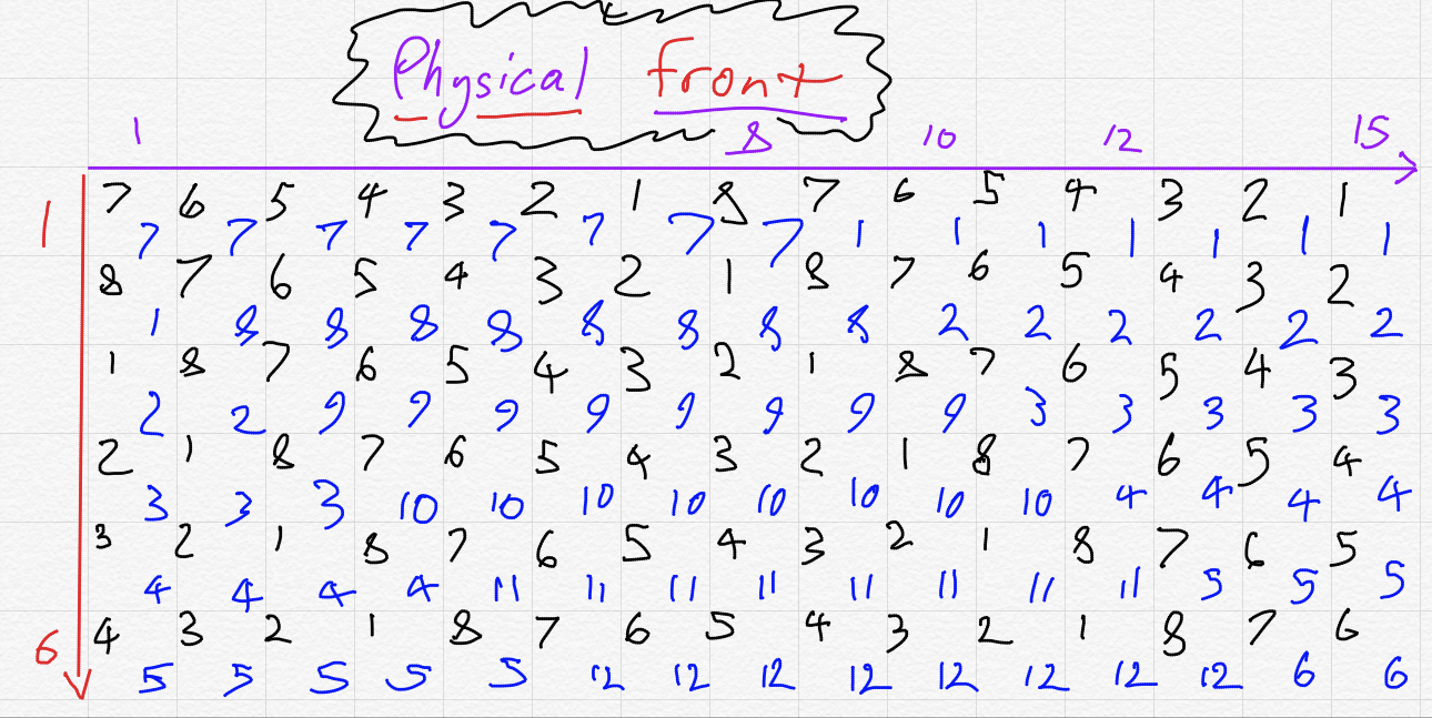

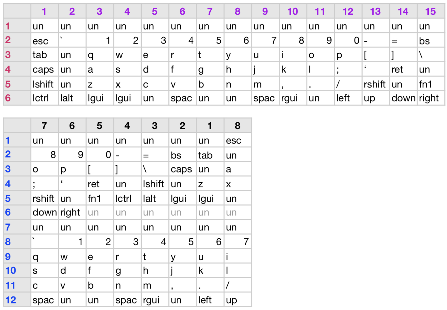

Oh, I finally got around to Teensying up one of these guys. Works a treat. The matrix is complete monkey-balls insanity. You’d think a 15x6 rectangle might have a 15x6 matrix, but it’s actually 12x8 and runs at 45º across physical rows and columns… all to save a single controller pin! 15+6=21 versus 12+8 = 20. Thanks, Access, for giving my multimeter a real bleep out.
Here’s my scribbled diagram from that session:
Yes, I’m sure there’s a better way to present that data! I was writing on the iPad as I went.
As you can imagine, such a kooky “logical” matrix makes for madcap programming when you want to dial in your own choice of layout. I made a spreadsheet to convert from one coordinate system to the other. An example:
And yes, I’m sure there’s a better way to do this in code. Again, just quick and dirty stuff for me.

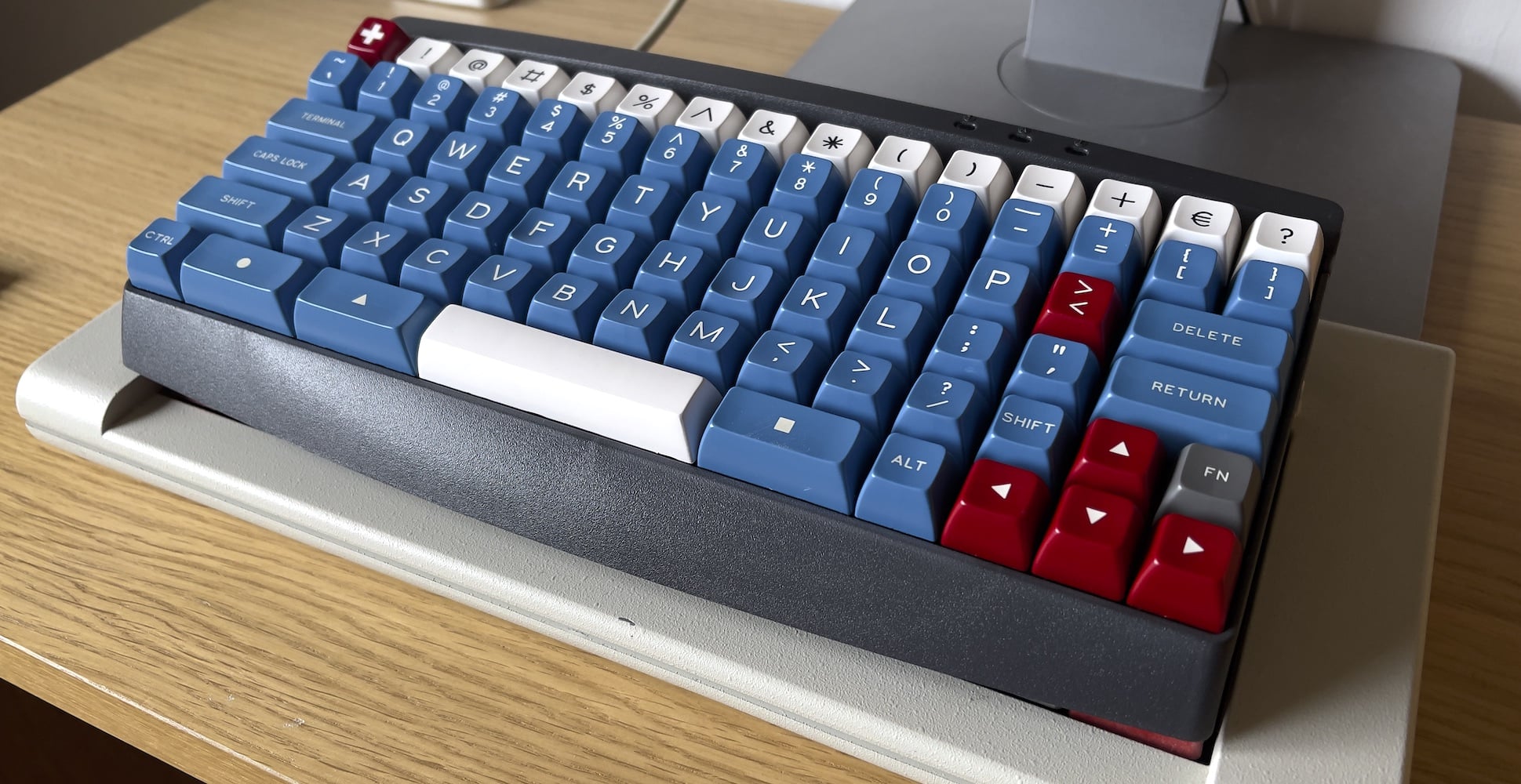

31 Mar 2021, 12:34
Almost there now…
For certain values of almost. :roll:

Muirium wrote: 31 Mar 2021, 12:34 Almost there now…
Cute! Reminds me that I have a Tipro I really need to do something with, luckily it's a USB model so I can reprogram it on a modern computer. The previous owner swapped in clicky Razer green switched and a buzzer tactivates if the 2KRO is exceeded so it's a loud (but crazy solid) board.
I guess it makes sense that SP would have POS compatible keycaps considering they where cranking out cash register sets until the enthusiast market showed up.
micmil
01 Apr 2021, 05:09
I suddenly don't feel so bad about the glacial pace of most of my projects.
That color scheme is drool-worthy.
