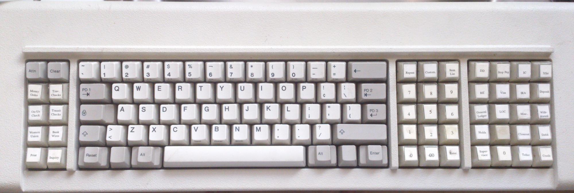

If you're willing to travel further down the rabbit hole, you could always get one of these and convert it to a layout very similar to the standard 105-key ISO layout (except for having the function keys on the left). :evilgeek:

Thomas
02 Dec 2014, 23:15
quantalume wrote: If you're willing to travel further down the rabbit hole, you could always get one of these and convert it to a layout very similar to the standard 105-key ISO layout (except for having the function keys on the left). :evilgeek:
Honestly speaking, I think the Model M / F is as far as I'm willing to go down the rabbit hole in the foreseeable future. ;)
That said, the keyboard in the picture sure looks interesting... What layout is this and what are the blank keys on either side of the space bar for? Anyway, extra keys are always helpful, and I actually like having function keys on the left. I always found the function keys on top of the main block a bit awkward to reach. It's a bit more comfortable on the Model M. (My ideal layout would have a separate numberpad-sized set of keys on the left that could be mapped to some to my most used programs.)

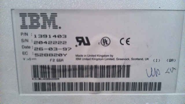

cinnamonrollz wrote: What year is your model m? Early model m's feel pretty good, they kinda feel worse after 1987.
That would go a long way to explaining my issue. Mine is from 1997, must be one of the last IBM made in its own factory in Scotland:

Kishsavers, eh? As it happens, I just wrote this about them for the DTAs:
webwit wrote: Image
IBM 4704 "Kishsaver" family
Before the IBM [wiki]Model M[/wiki], there was the even meaner, tougher and rarer Model F. Until recently, Model Fs were all quite large. But last year, thanks to Kishy and SmallFry's detective work, the "Kishsaver" 4704 series burst onto the scene. These are seriously rare and high end, metal bodied keyboards. And with Xwhatsit's controller inside, they are perfectly usable today! If only there were enough of them to go round…
A size for everyone. Thirty years ago! 80s IBM wherever did you go?
