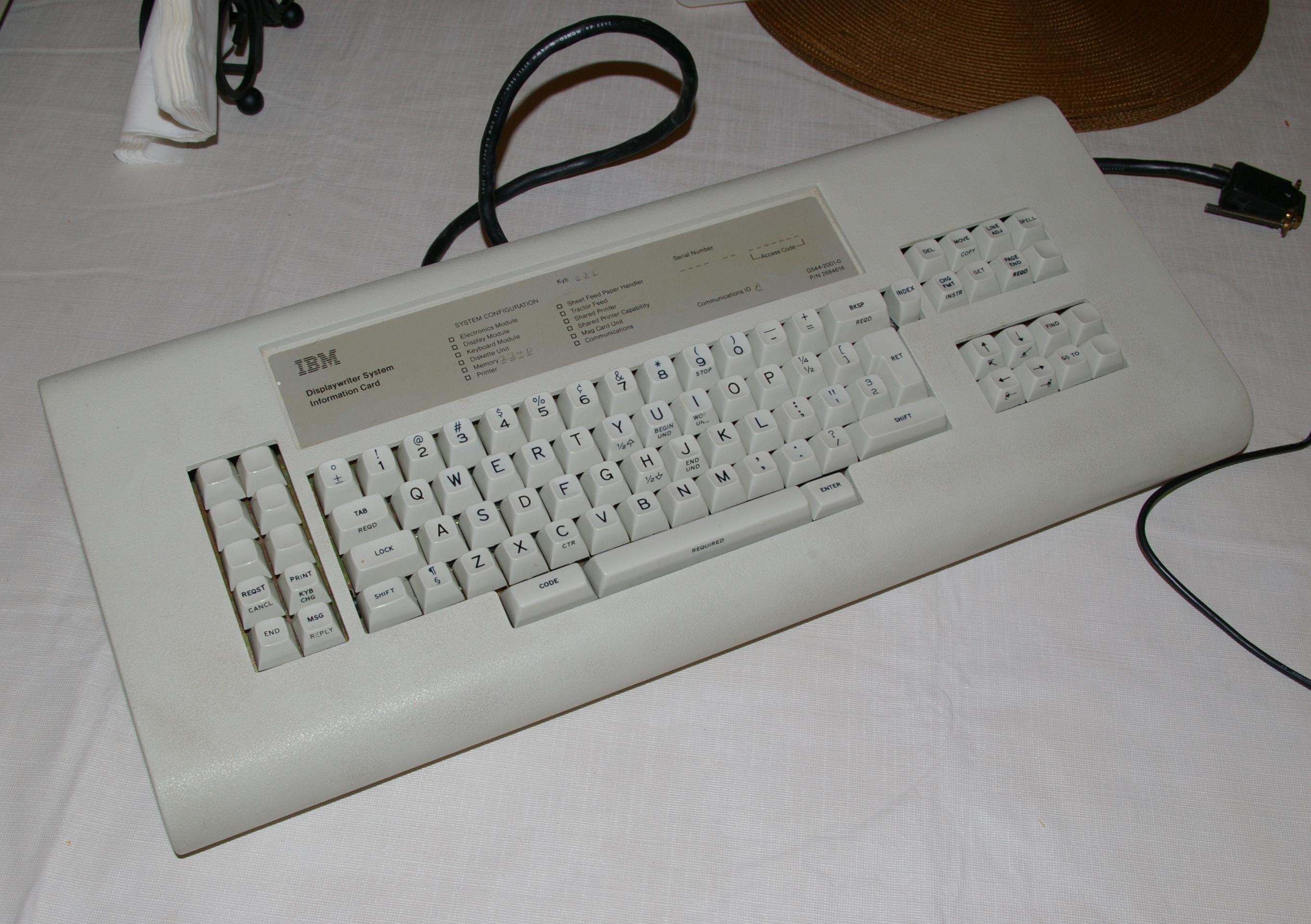

Beast of an F I call the Beige Whale
Rotti
17 Dec 2014, 22:30
Much thanks to hwood34 for selling me this exceedingly hard to document piece. Anyway enough of the formalities.
While this may LOOK like a 5291 "Bigfoot", the internals are totally different along with different legends. The best I can tell it cam from the IBM 5324 system. There seems to be very few images of this system let alone of the keyboard.
I will post a teaser pic here and then a link to the album on flickr

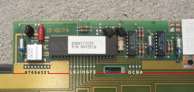

ImageIMG_7723 by christopher.hurlbut, on Flickr
17 Dec 2014, 23:12
Weird, looks like it's in two parts?
The square silver topped chip (in the picture you linked of the underside) is IBM's typical analog heart in all its capsense controllers. Beamspring and F controllers all have those. Usually, though, the PCB simply hooks up to the "pad card" (the main PCB where the capsense pads are, behind the buckling springs). This looks like something else is going on up there in Bigfoot country…
Rotti
17 Dec 2014, 23:17
Muirium wrote: Weird, looks like it's in two parts?
Yeah that is the daughter board. Not sure what is going on there. Though dfj from GH irc feels that the voltage regulation among some other things is going on on that daughter board

Unfortunately, this variant uses the 8-channel controller chip 8273565 (the square silver chip), so Soarer's controller can't be used with this (see his post here: https://geekhack.org/index.php?topic=50 ... msg1148867 ).
I don't think there's a converter yet that can convert the signals transmitted through this cable. You will have to find information about the protocol or try to reverse-engineer it. The pin assignments, scan codes and information on page 3-19 of the manual are certainly helpful for this, but that's only a start. When you have that, you can maybe write a converter that runs on e.g. a Teensy or Arduino. You will need a voltage level conversion in your converter, too, since this seems to work with 12V, while modern microcontrollers and USB work with 5V.

really nice find Rotti. But its too small to be a whale! This is more whale size:
Rotti
18 Dec 2014, 15:19
Halvar wrote: Unfortunately, this variant uses the 8-channel controller chip 8273565 (the square silver chip), so Soarer's controller can't be used with this (see his post here: https://geekhack.org/index.php?topic=50 ... msg1148867 ).
Good catch with the 8 channel capsense controller. I remember seeing that post in my travels of explorying Soarer's firmware enviroment. Though I haven't used it yet.
What do you think the chances are that 5V would work but they just used 12 due to availability?
seebart wrote: really nice find Rotti. But its too small to be a whale! This is more whale size:
That is beam spring correct? I think I remember that layout when I was digging for info on this particular piece. I liked the white whale/moby click reference due to the relative size and lack of info on this. I think I found 2 pictures outside DT and GH environments.
18 Dec 2014, 16:25
yes I believe it is beam spring and called "great white" by some.
Touch_It
18 Dec 2014, 17:05
It's definitely a beam spring from an IBM display writer. The last, or one of the last beam spring keyboards to be produced. On topic, its sad that soarers converter will not work as I'm sure that would be far easier than reverse engineering. Glad there are people way smarter than I on these forums.
18 Dec 2014, 18:00
Yup, Great Whites are pretty big.
http://deskthority.net/wiki/IBM_Displaywriter
But that's only the second biggest discrete keyboard I've ever seen. The largest one is much bigger…

Current progress:
At this point it appears that the supply voltage for this board is +12 and it then gets stepped down on the daughter board inside the keyboard. From here it goes to a couple chips on the daughter board which is referred to as an "adapter card" by the service manual I have found. From there it goes to the actual keyboard PCB that has the capsense chip and the cpu as well. Either tonight or tomorrow I will be applying 12 volts to the daughter board and poking around with my multimeter to check what voltage is actually being supplied to the keyboard pcb, though we are suspecting 5.

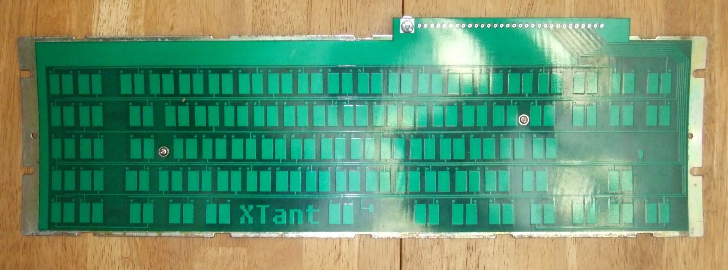

I think it's not possible to use xwhatsit's controller, because the original controller is on the main keyboard capsense PCB instead of a separate PCB in this keyboard, so the ribbon cable where you would solder in xwhatsits controller doesn't exist.
It might be possible to use wcass's XTant PCB though as a replacement for the original PCB, and the you could use xwhatit's controller again.

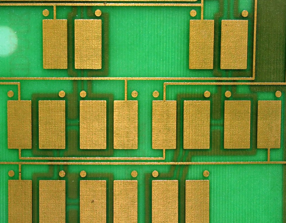

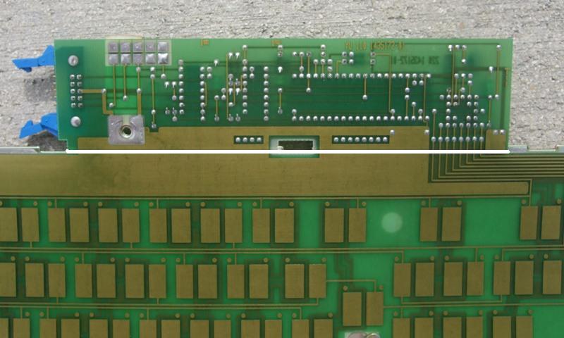

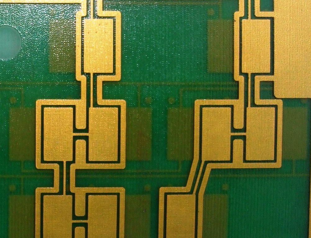

I guess that you are partially correct.
The picture of the F matrix and controller can be found in this post from wcass on the Bringing the IBM PC XT into the 21st Century thread.
I reproduce the pictures from wcass here for completeness:
original picture from wcass in http://deskthority.net/post57904.html#p57904
matrix top.JPG (217.98 KiB) Viewed 8761 times
matrix back.JPG (170.07 KiB) Viewed 8761 times
I guess that one could solder the xwhatsit controler to the original pcb using wires. This will avoid the custom made PCD What do you think ?
When reading (again) the XTans thread, I could not find how did wcass finally did his nice PCB (again, the picture is stollen from this post
original picture from wcass in http://deskthority.net/post185610.html#p185610
The alternative as you said, would create one new PCB from scratch.
