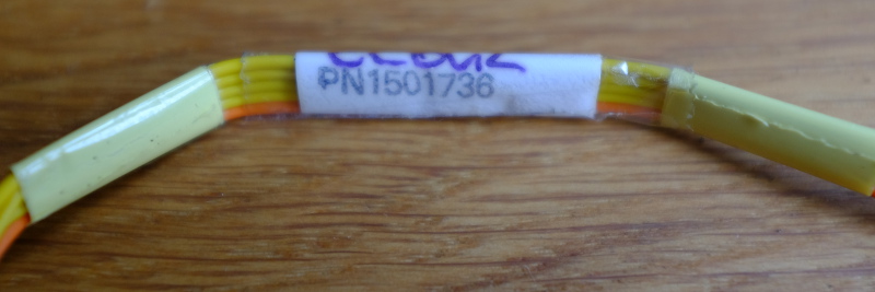

Hi,
  • In this post you can find a similar thread that shows the restoration of an IBM 122-Model-F that I did.
  • Here there is a link tp a similar post on my IBM 1390120.

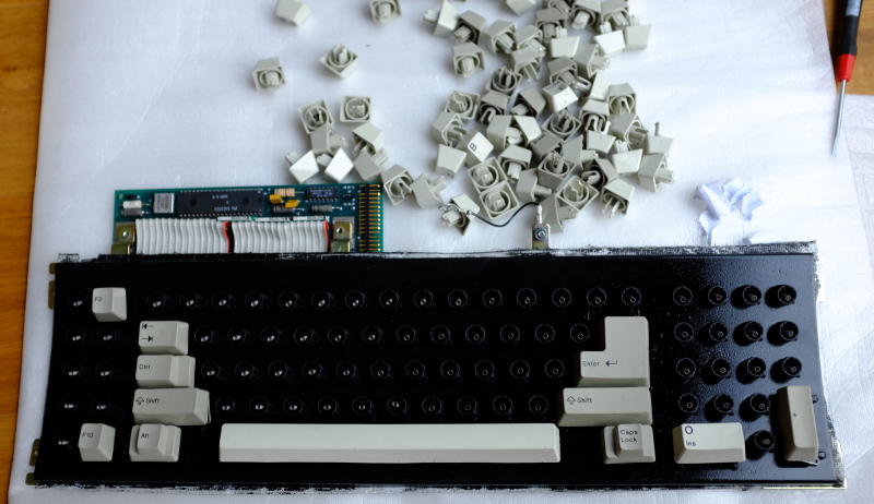

Today I am posting a (large) set of pictures of my IBM AT restoration process. It consisted actually in two basic things: new foam and a flipper replacement.
There is nothing here that cannot be found somewhere else, but I guessed that some people may be interested in having all these pictures together.
Special thanks go to andrewjoy and 0100010, who kindly offered flippers after my post here.
The index follows : Attached you can find the compilation in a tar.bz2 file.
IBM_AT_2014-12_small_jpgs.tar.bz2
(16.6 MiB) Downloaded 248 times

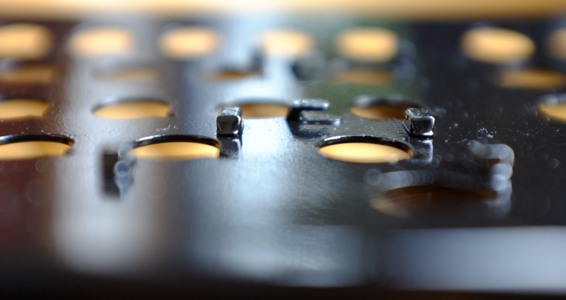

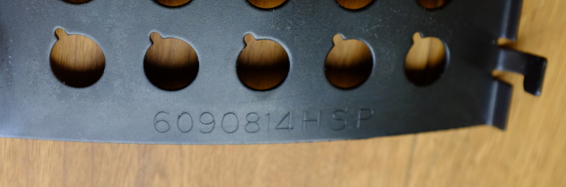

23 Dec 2014, 22:25

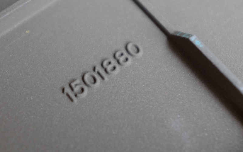

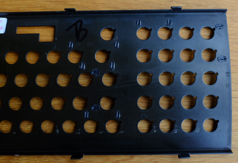

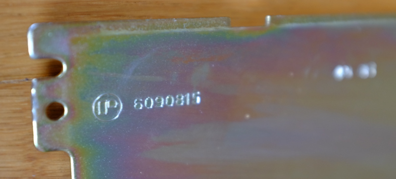

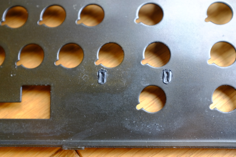

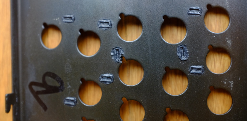

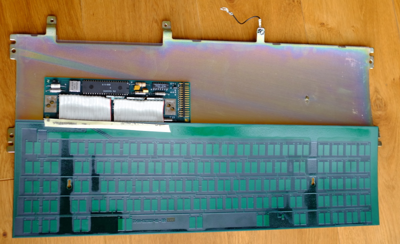

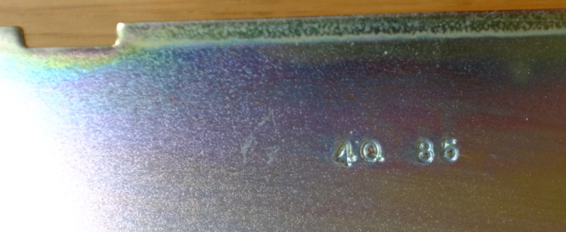

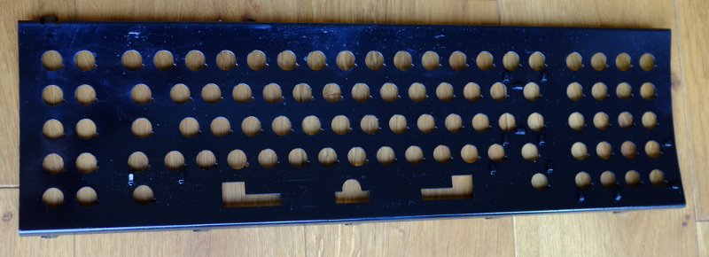

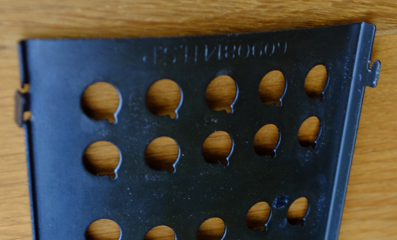

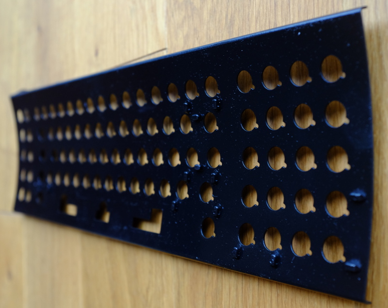

parts - 01 - Top Metal Plate
Back to index

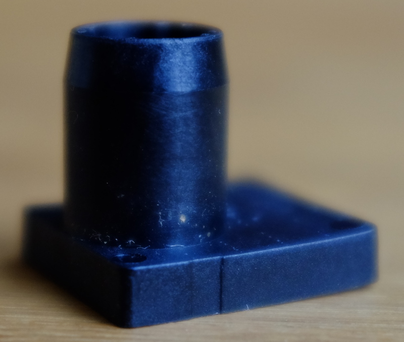

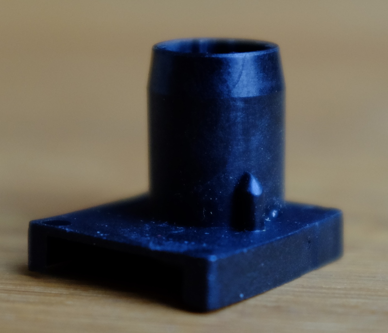

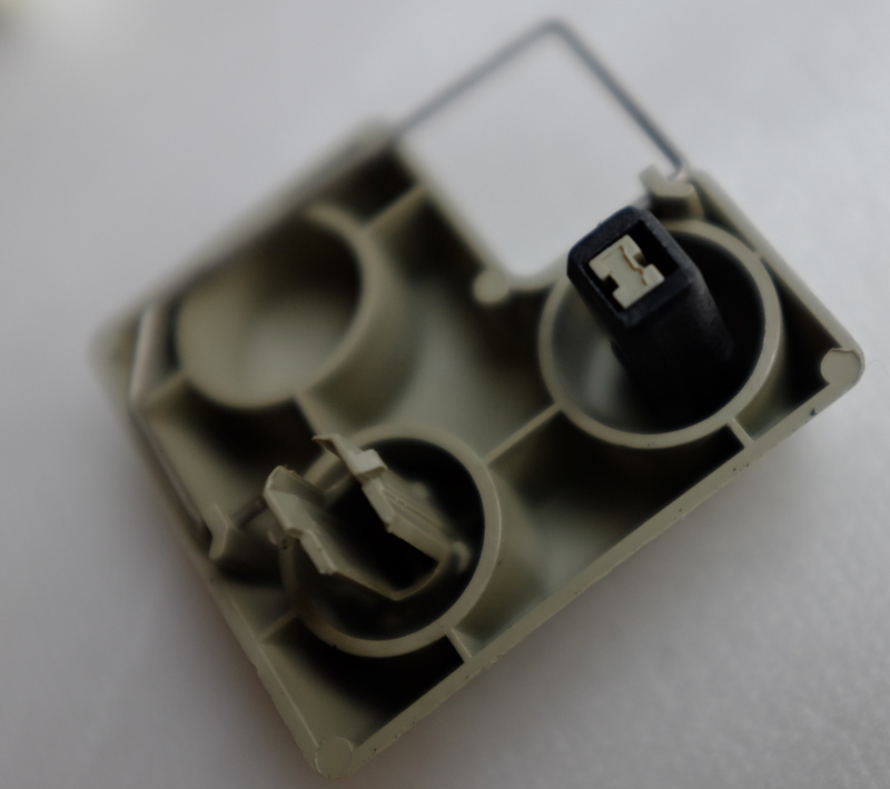

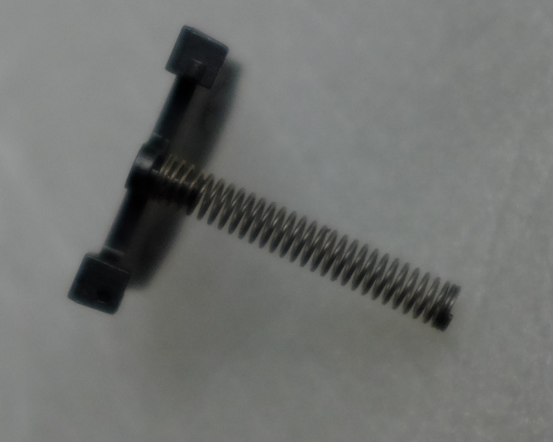

23 Dec 2014, 22:28

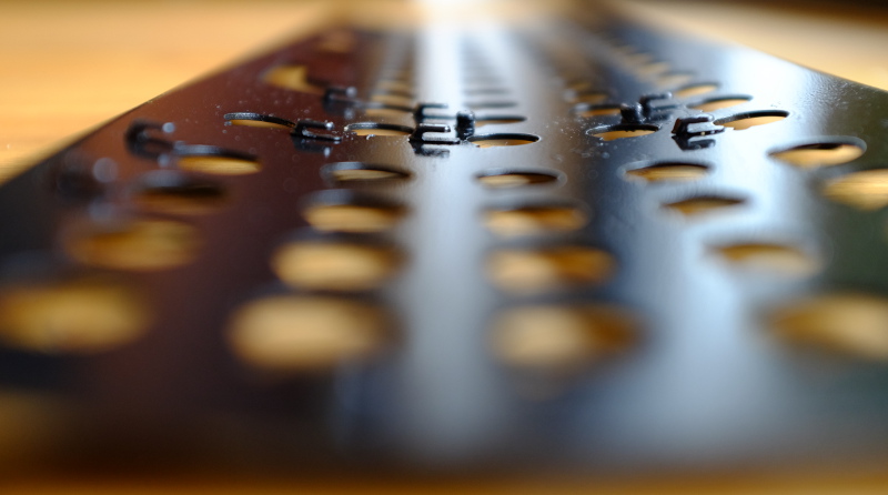

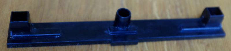

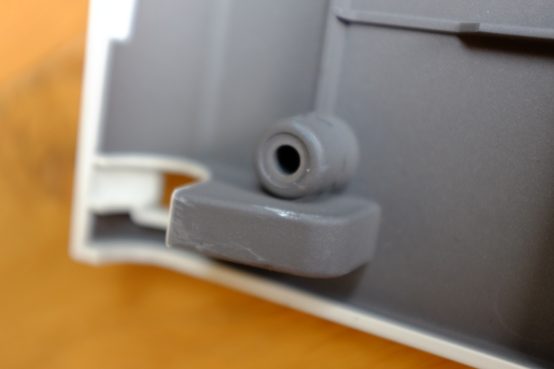

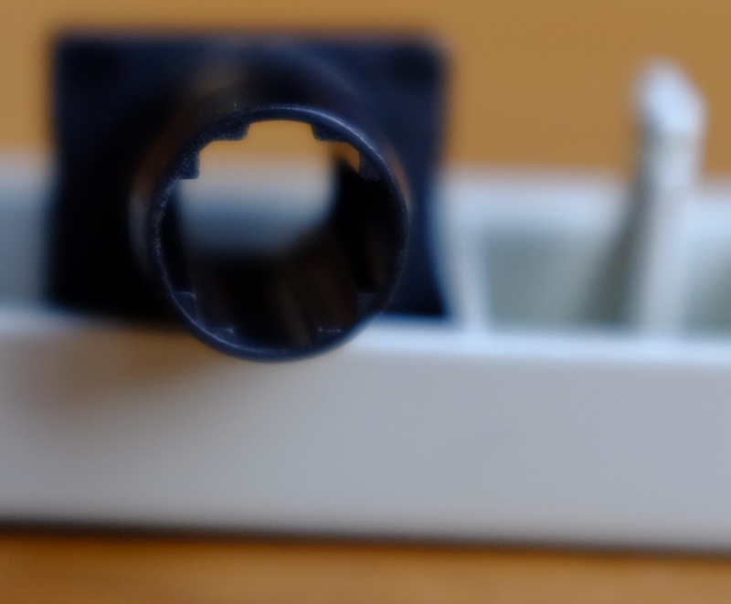

parts - 02 - Barrel
Back to index

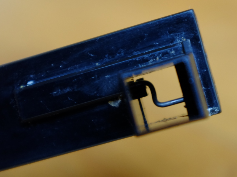

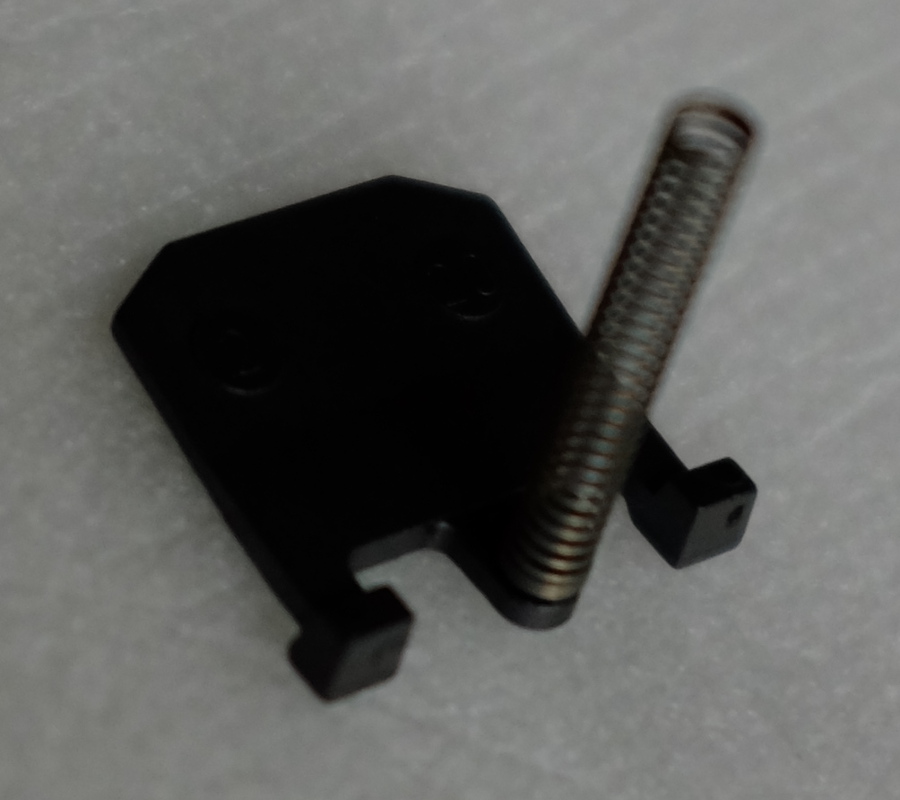

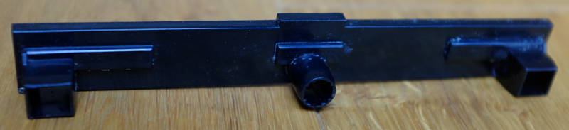

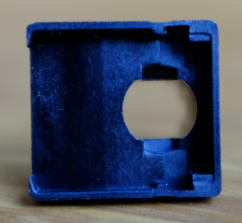

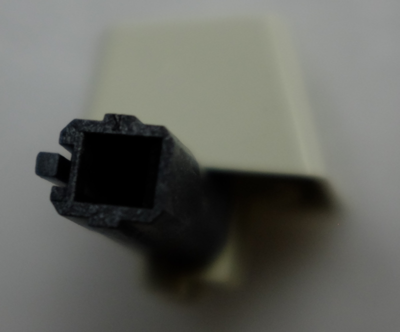

23 Dec 2014, 22:32

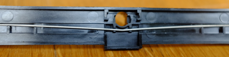

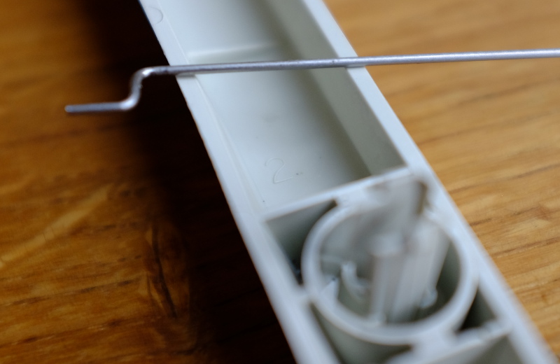

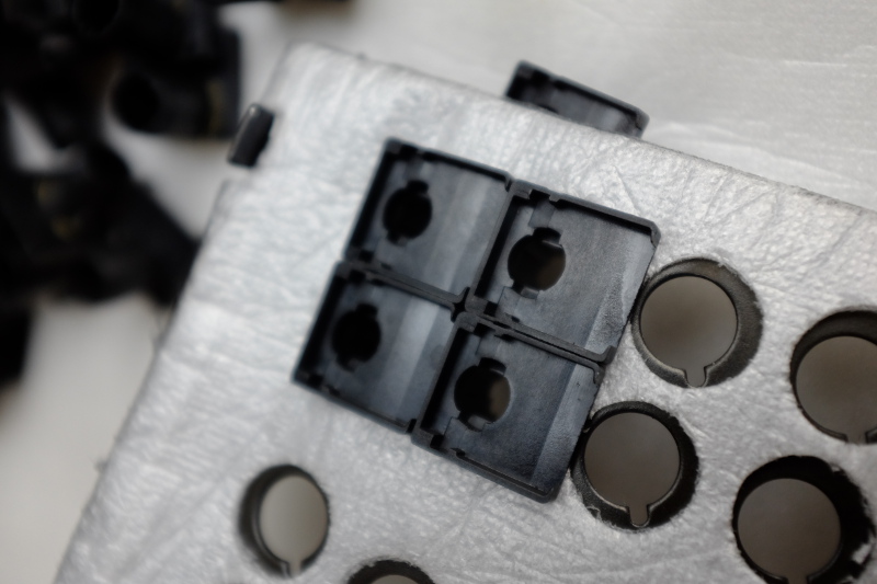

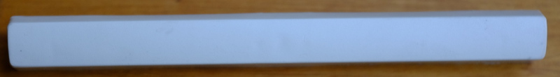

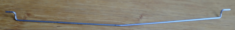

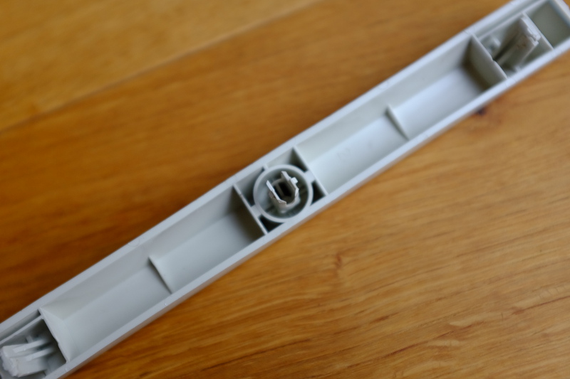

parts - 03 - Space Bar
Back to index

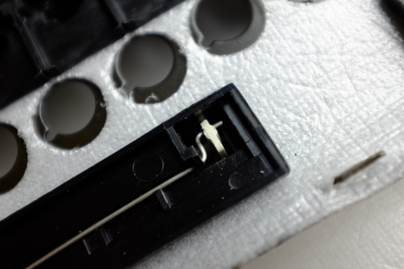

idollar
i$

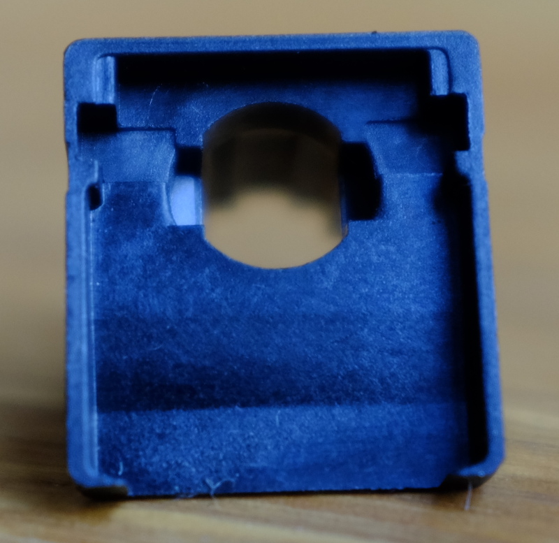

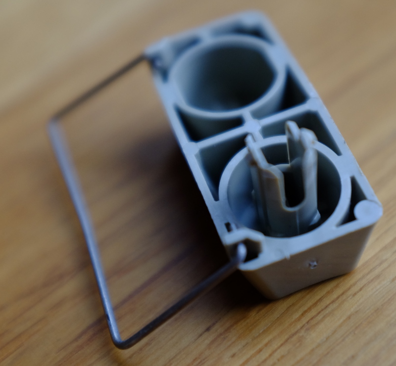

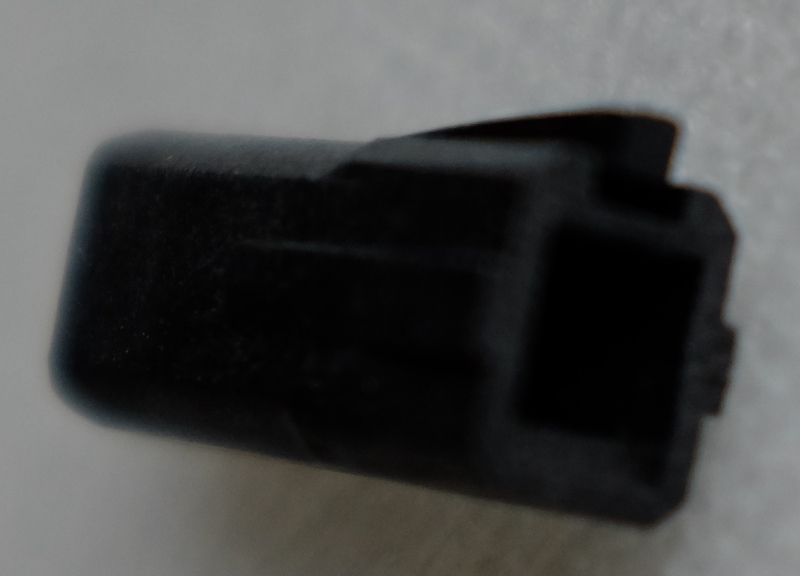

23 Dec 2014, 22:35

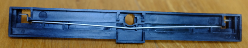

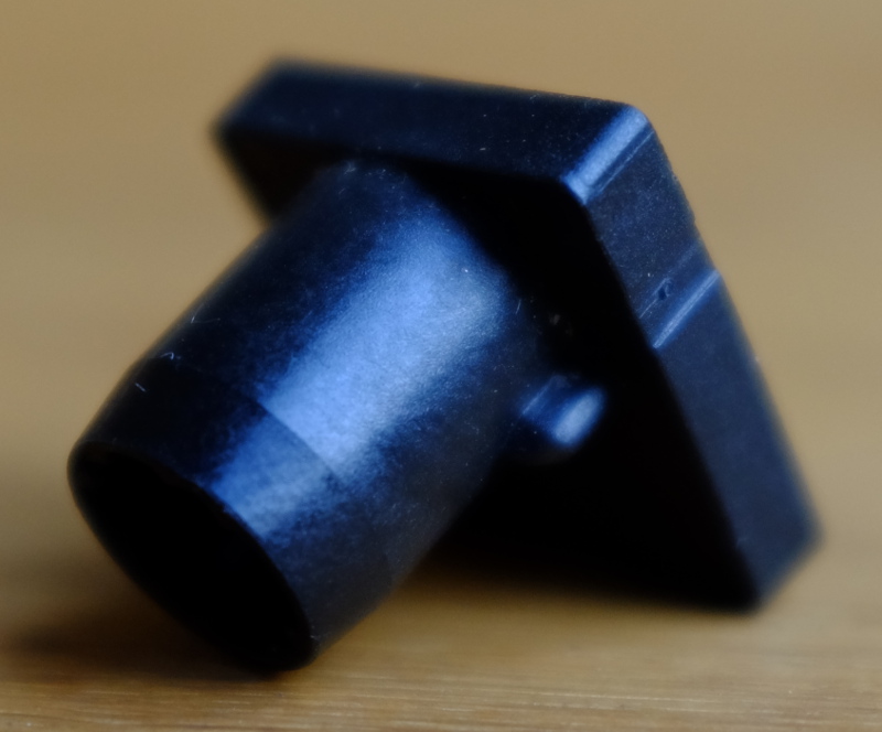

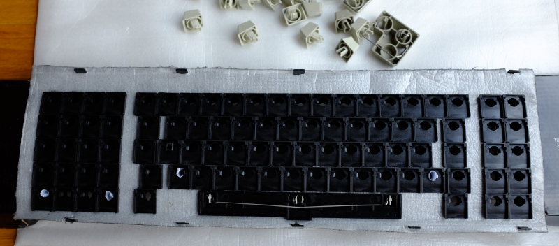

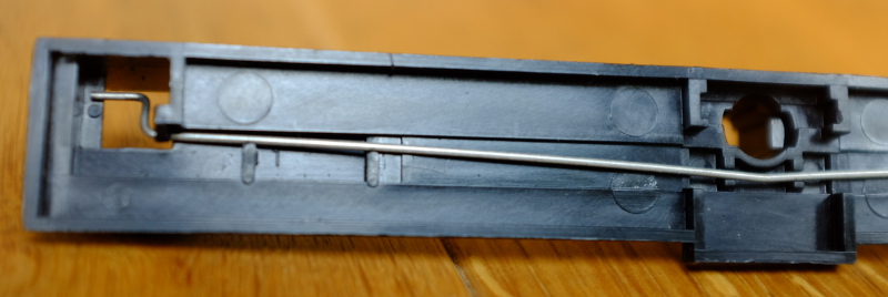

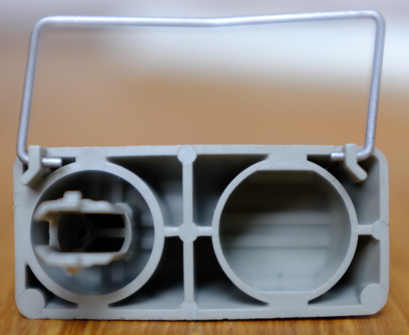

parts - 04 - Keycap with stabilizer
Back to index

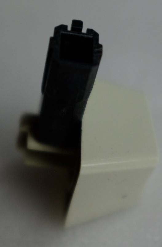

idollar
i$

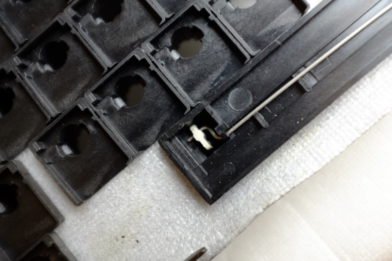

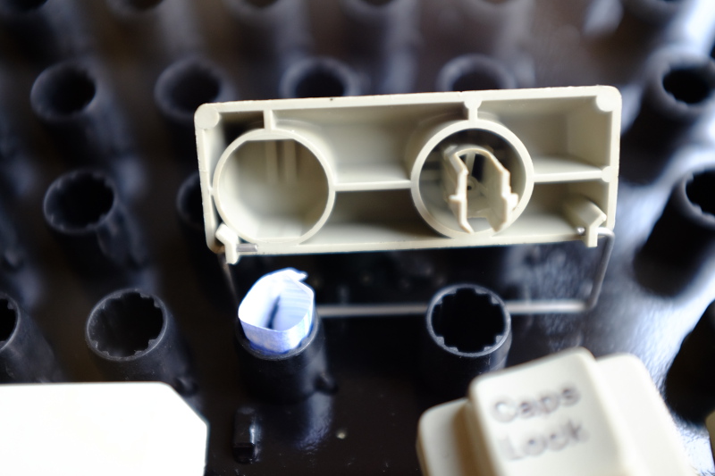

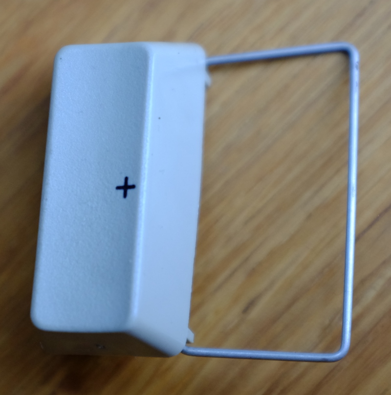

23 Dec 2014, 22:37

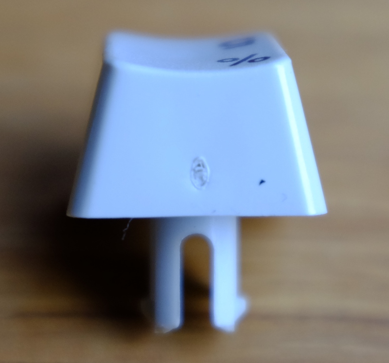

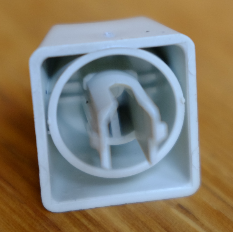

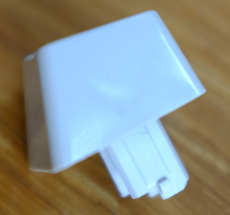

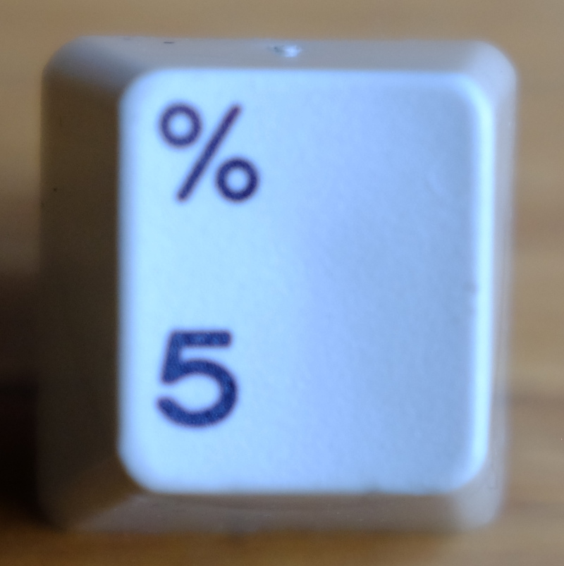

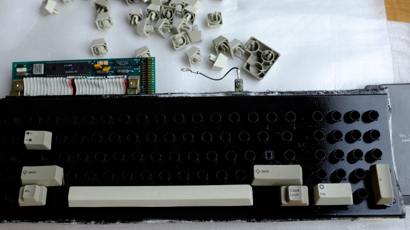

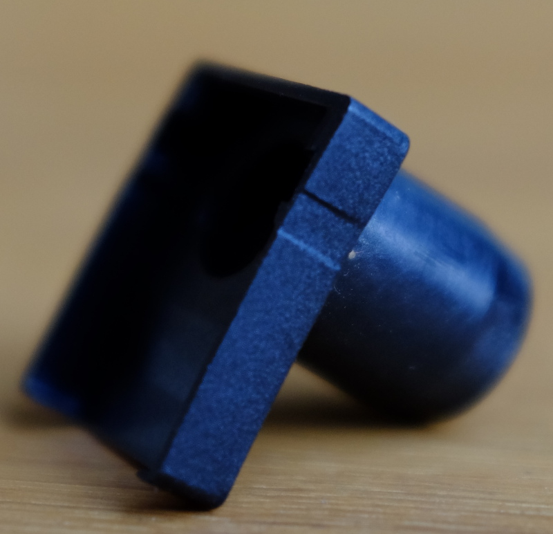

parts - 05 - Keycap
Back to index

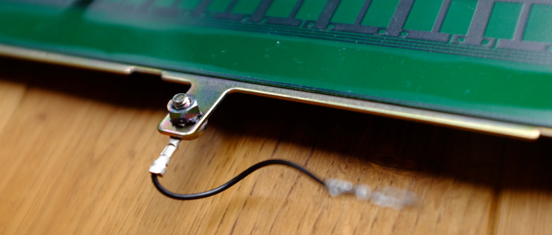

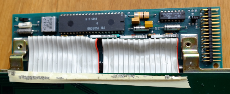

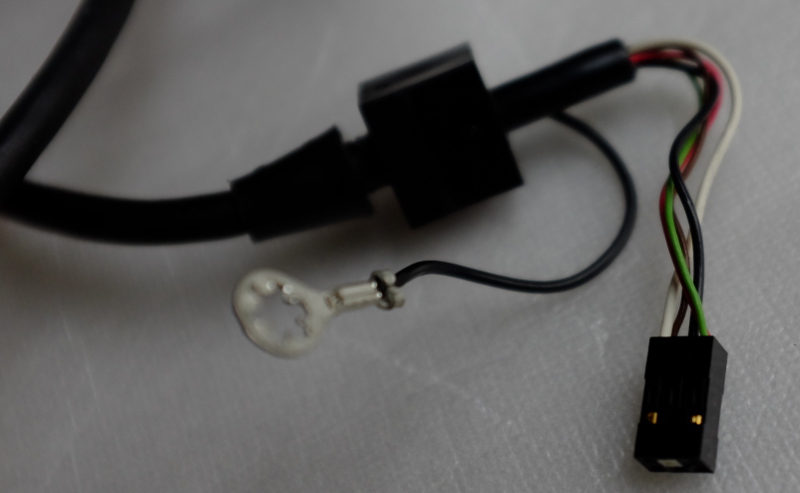

23 Dec 2014, 22:39

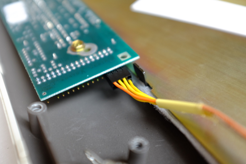

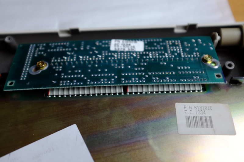

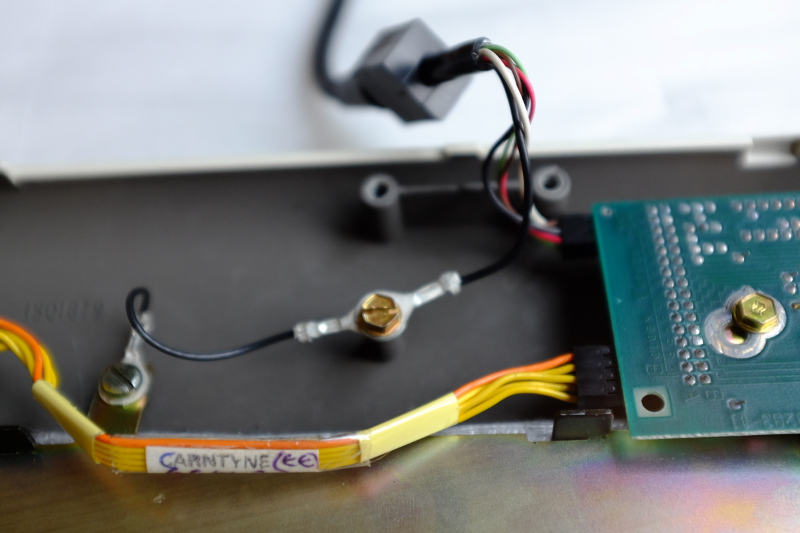

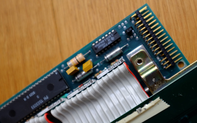

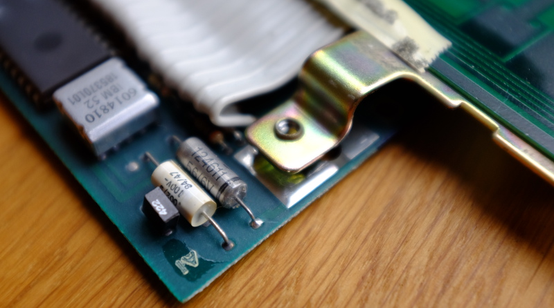

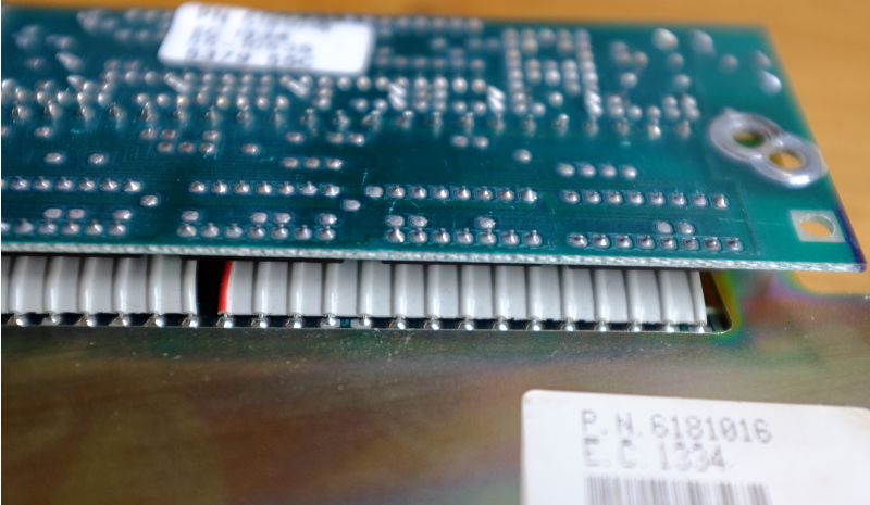

parts - 06 - Controller
Back to index

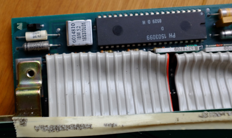

idollar
i$
23 Dec 2014, 22:41

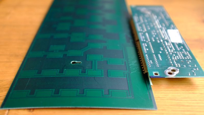

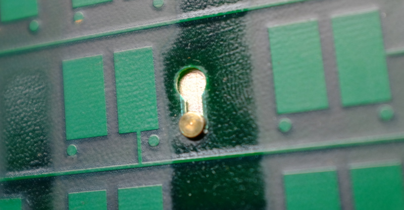

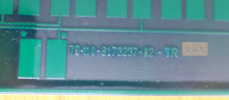

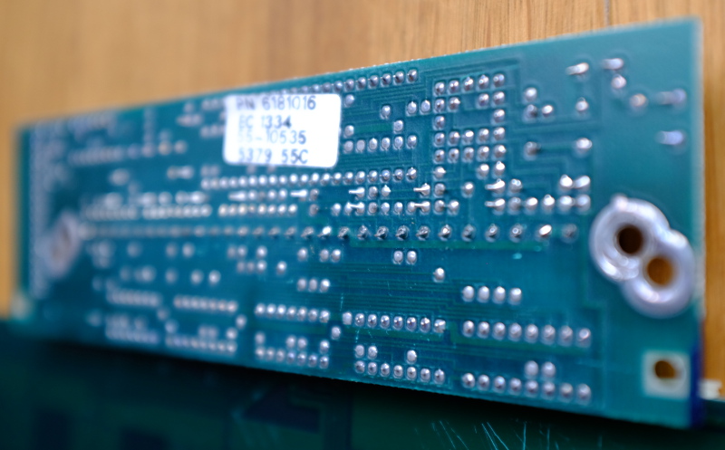

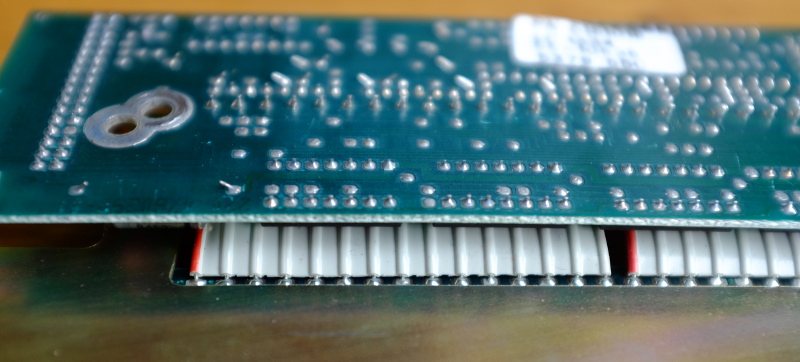

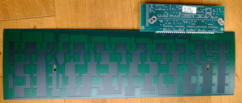

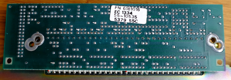

parts - 07 - Main PCB
Back to index

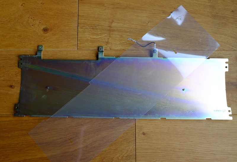

idollar
i$

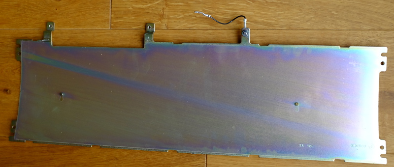

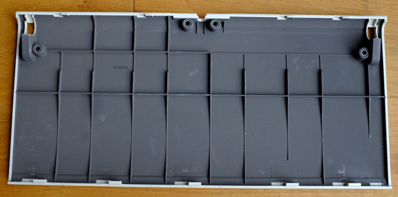

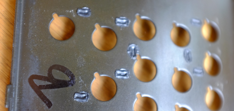

23 Dec 2014, 22:44

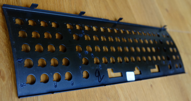

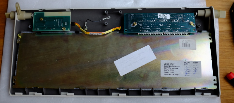

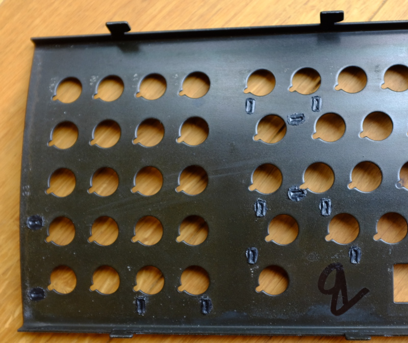

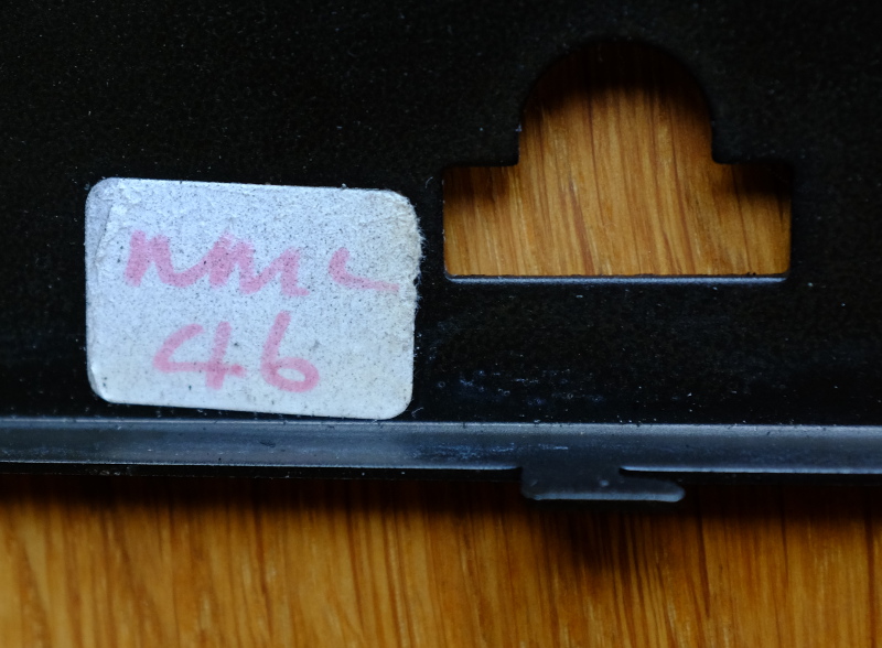

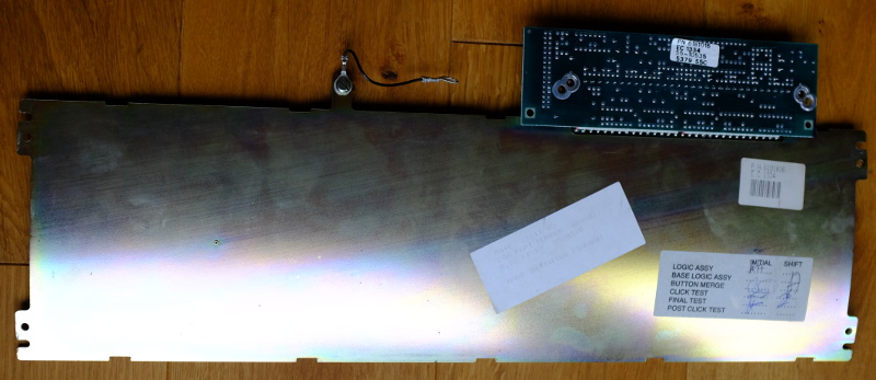

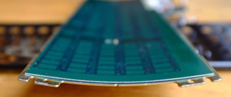

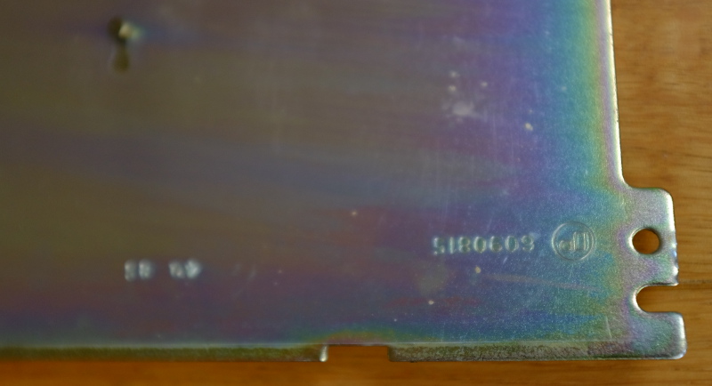

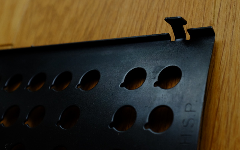

parts - 08 - Bottom Metal Plate
Back to index

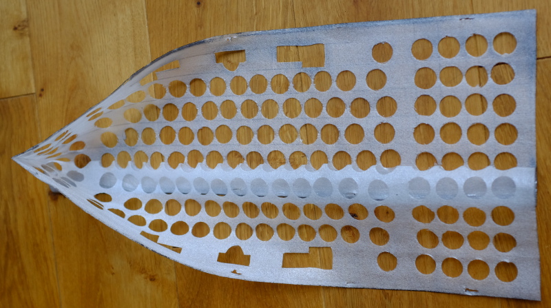

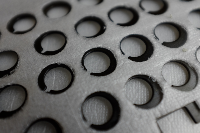

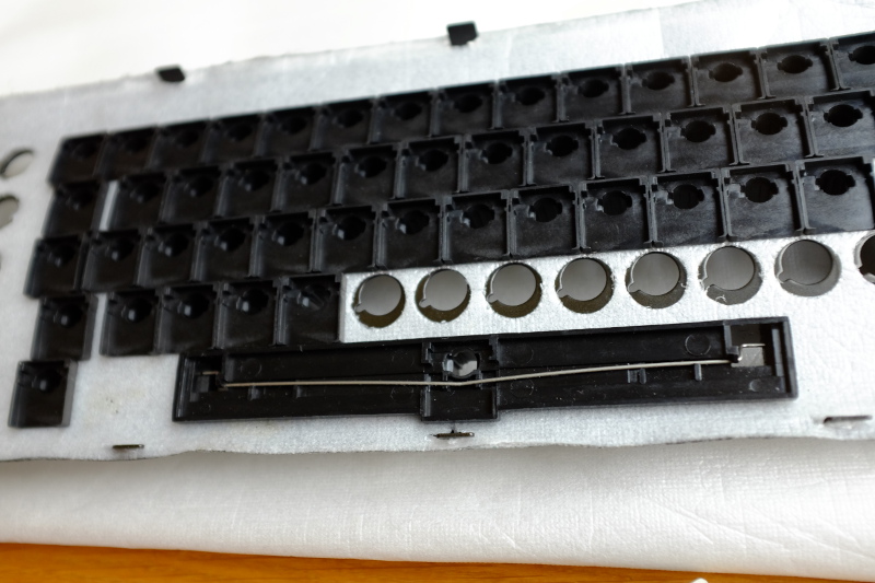

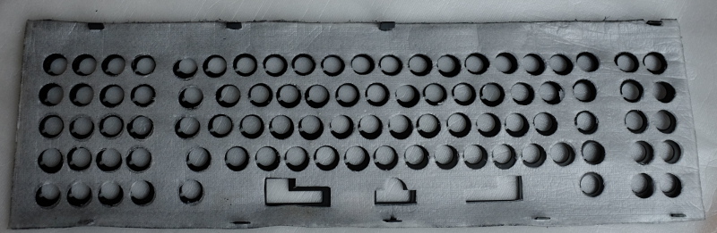

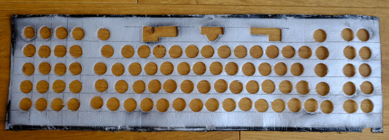

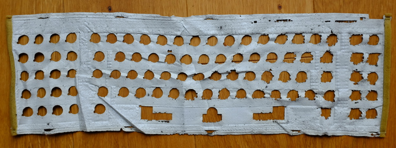

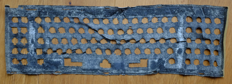

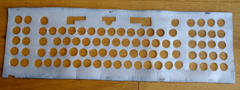

parts - 09 - Foam
Back to index

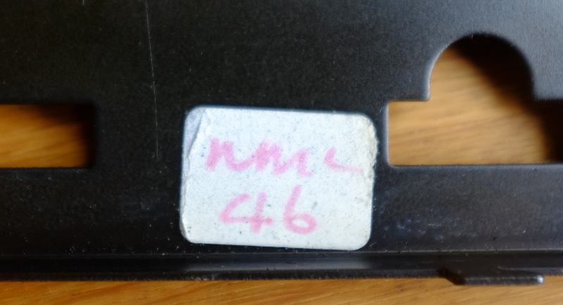

23 Dec 2014, 22:54

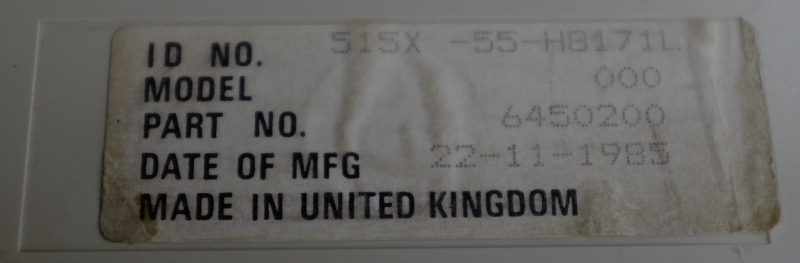

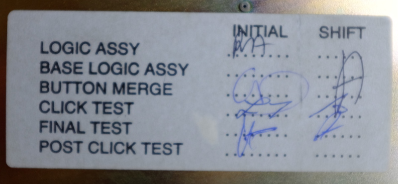

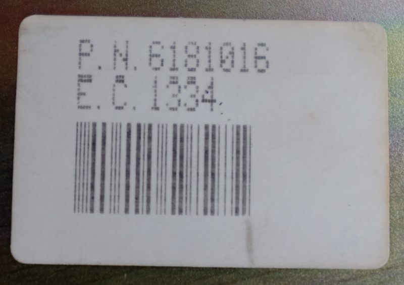

parts - 10 - Stickers
Back to index

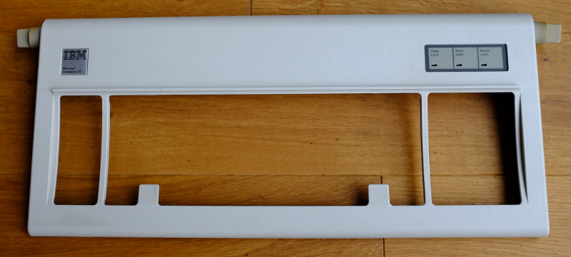

23 Dec 2014, 22:57

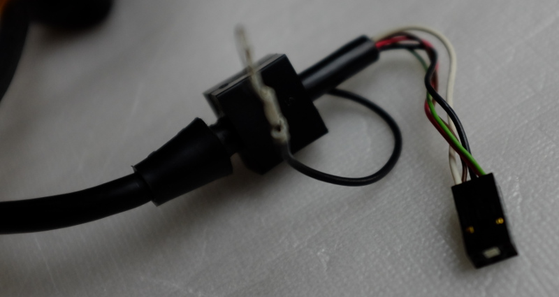

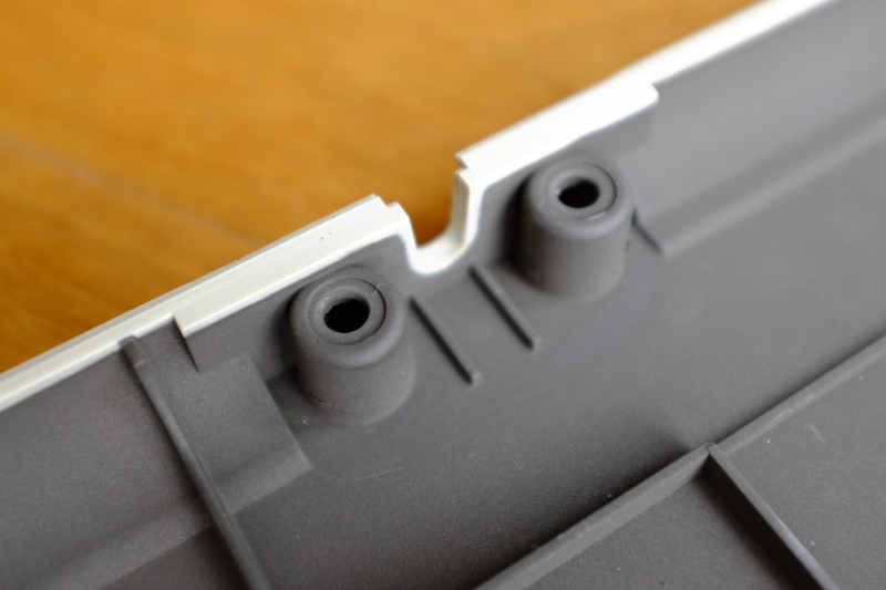

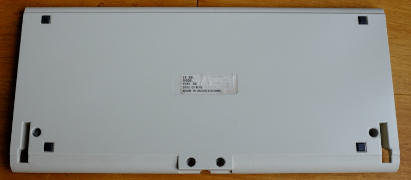

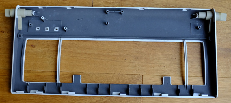

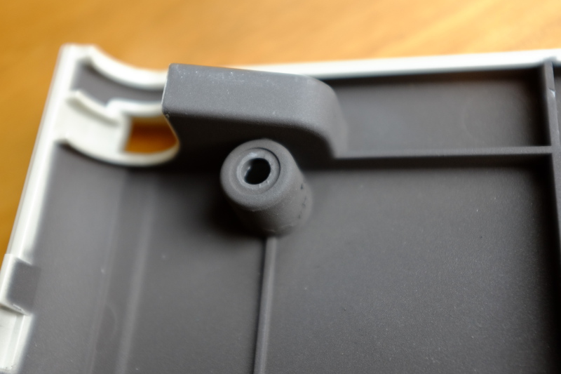

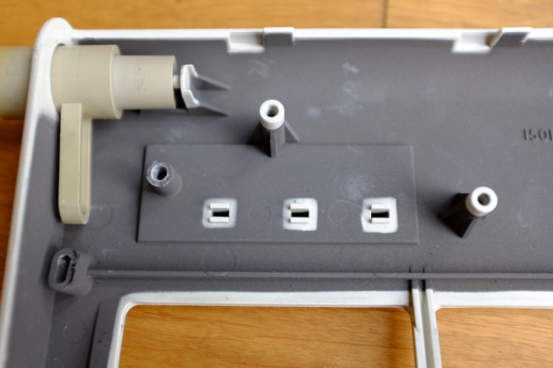

parts - 11 - Case
Back to index
idollar

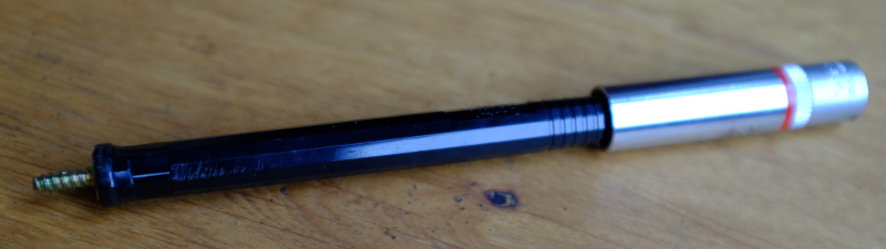

i$

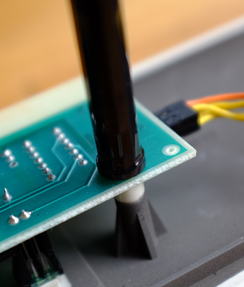

23 Dec 2014, 22:59

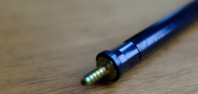

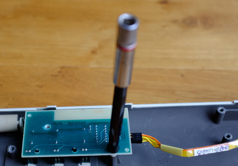

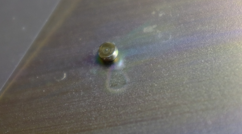

parts - 12 - Screewdrive :-)
Back to index

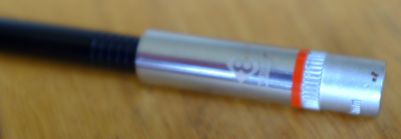

These are not 5,5. I do not have a screw-driver. A mechanical pencil helped here.

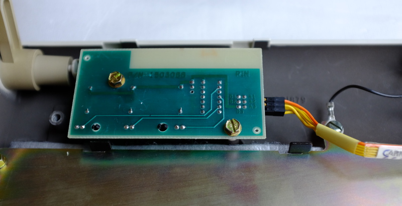

idollar
i$
23 Dec 2014, 23:03

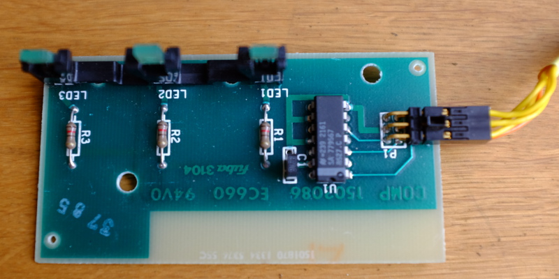

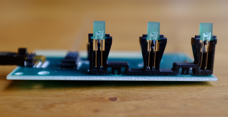

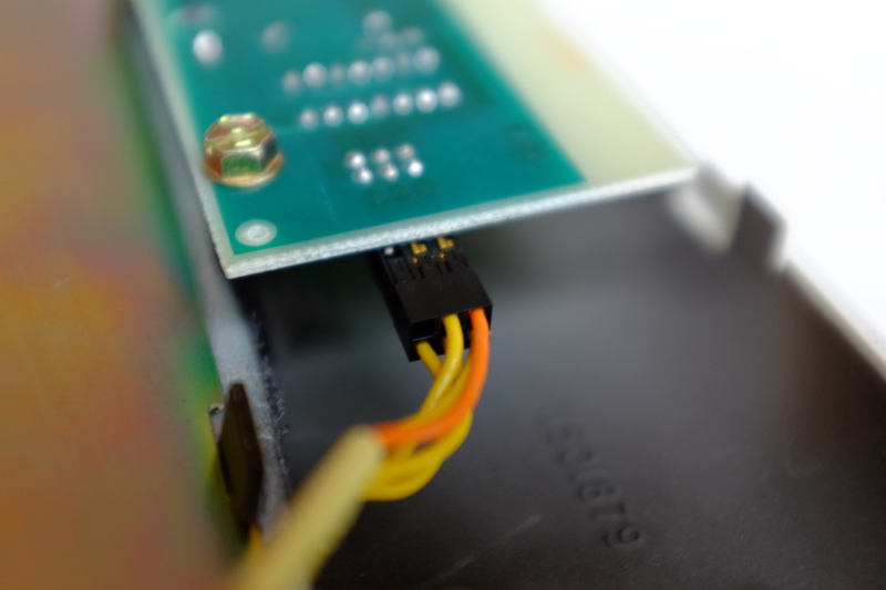

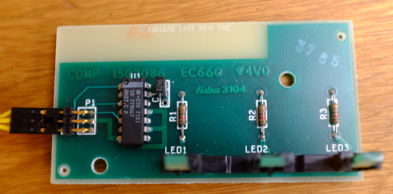

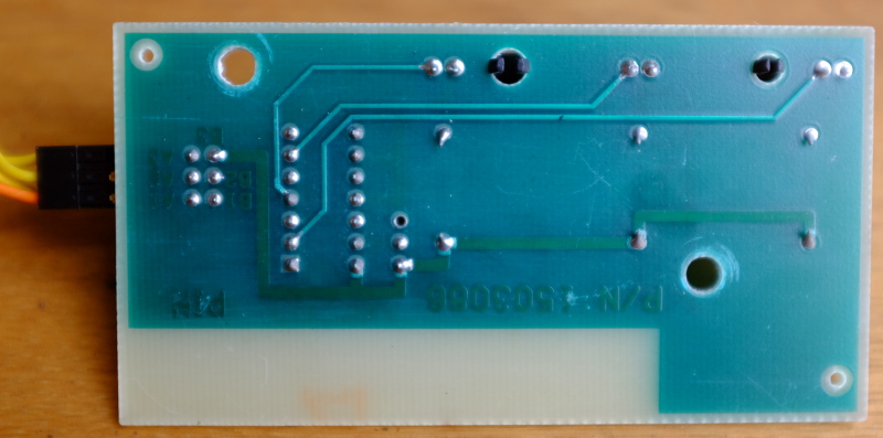

parts - 13 - LEDs PCB
Back to index

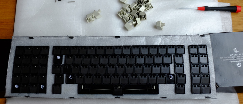

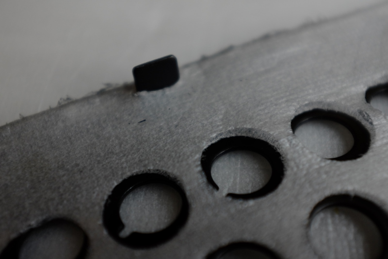

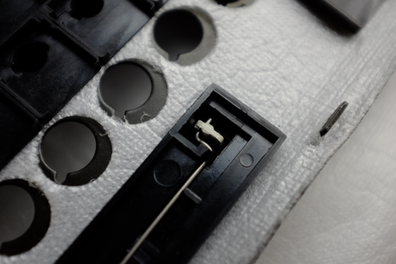

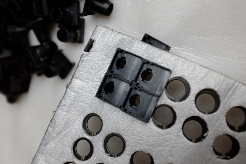

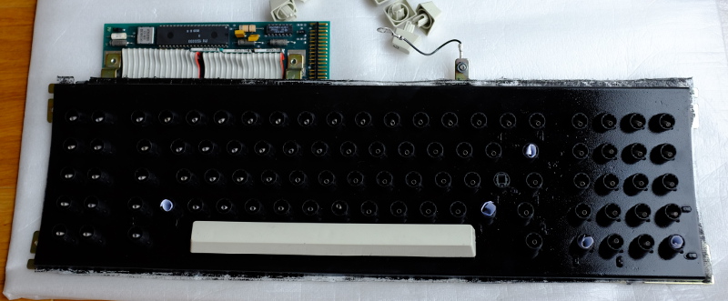

mount - 01 foam and metal plate
Back to index

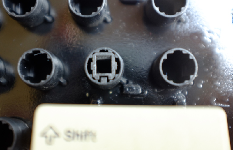

mount - 02 - barrels
Back to index

23 Dec 2014, 23:13

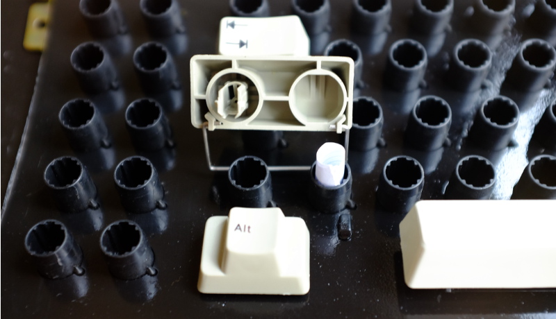

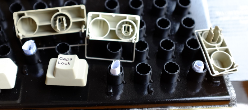

mount - 03 - Empty Barrels
Back to index
I know, I missed the enter key paper. I was lucky to realise on the mistake before mounting back the back metal plate :-)

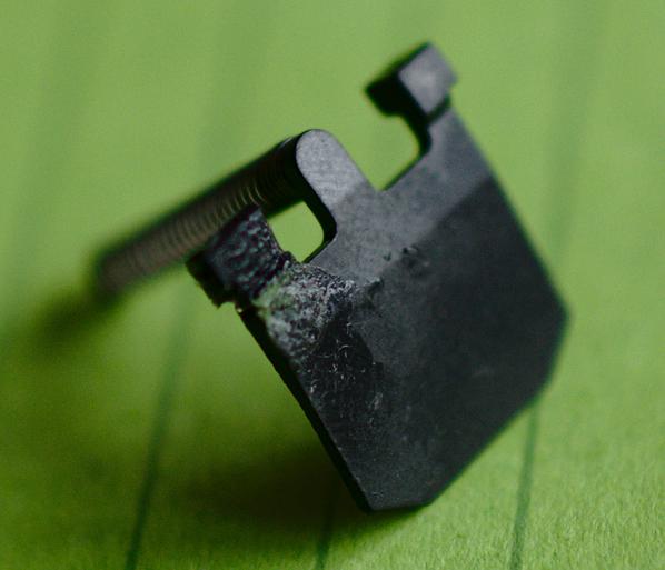

idollar
i$

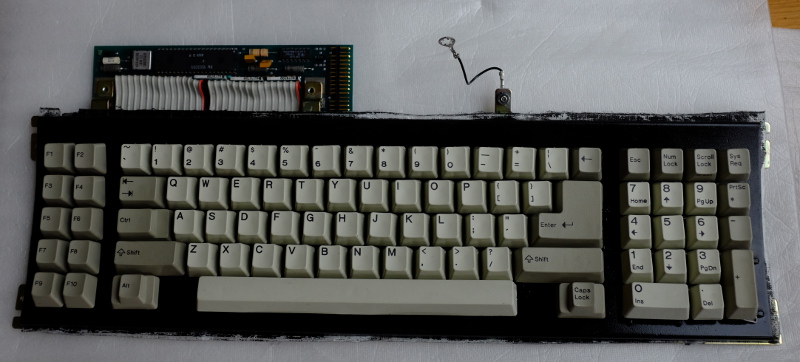

23 Dec 2014, 23:16

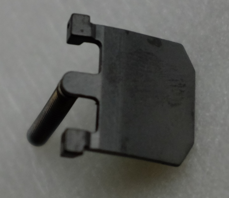

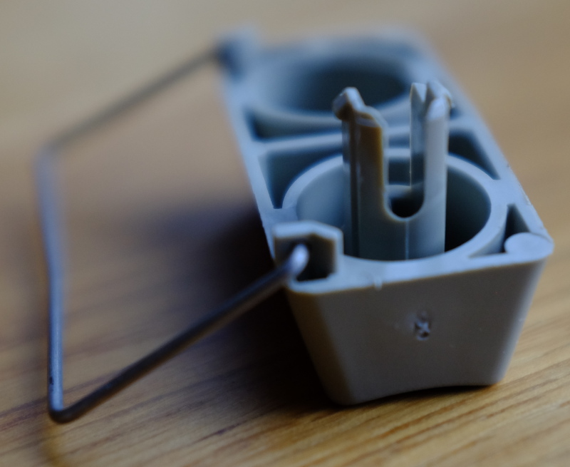

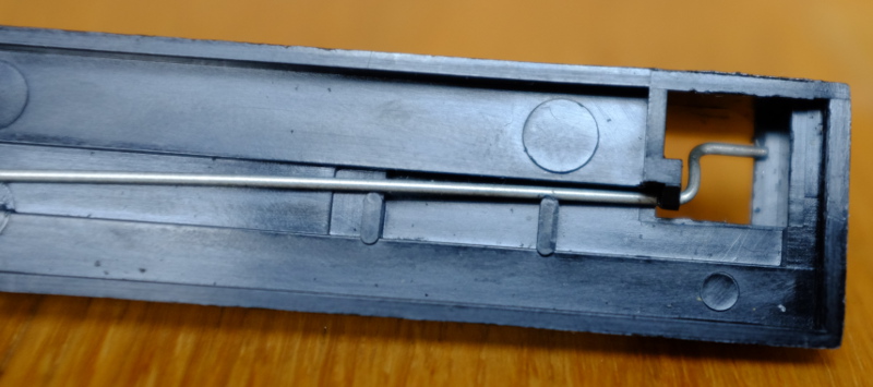

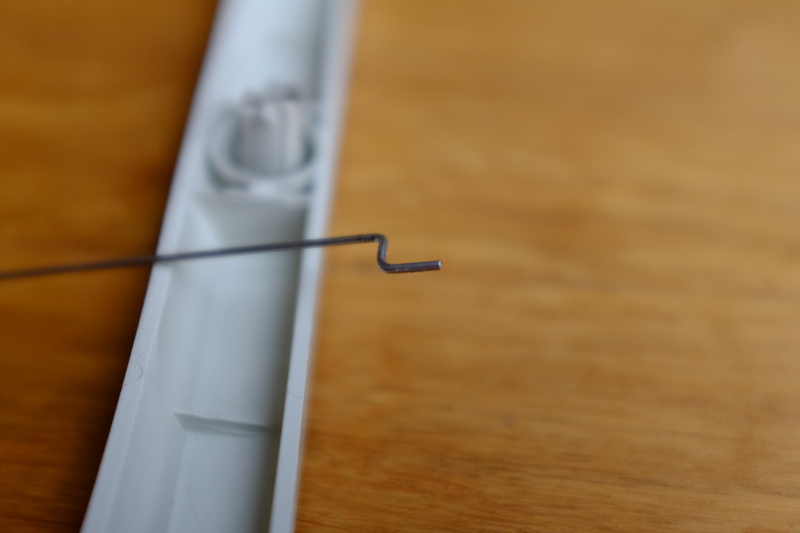

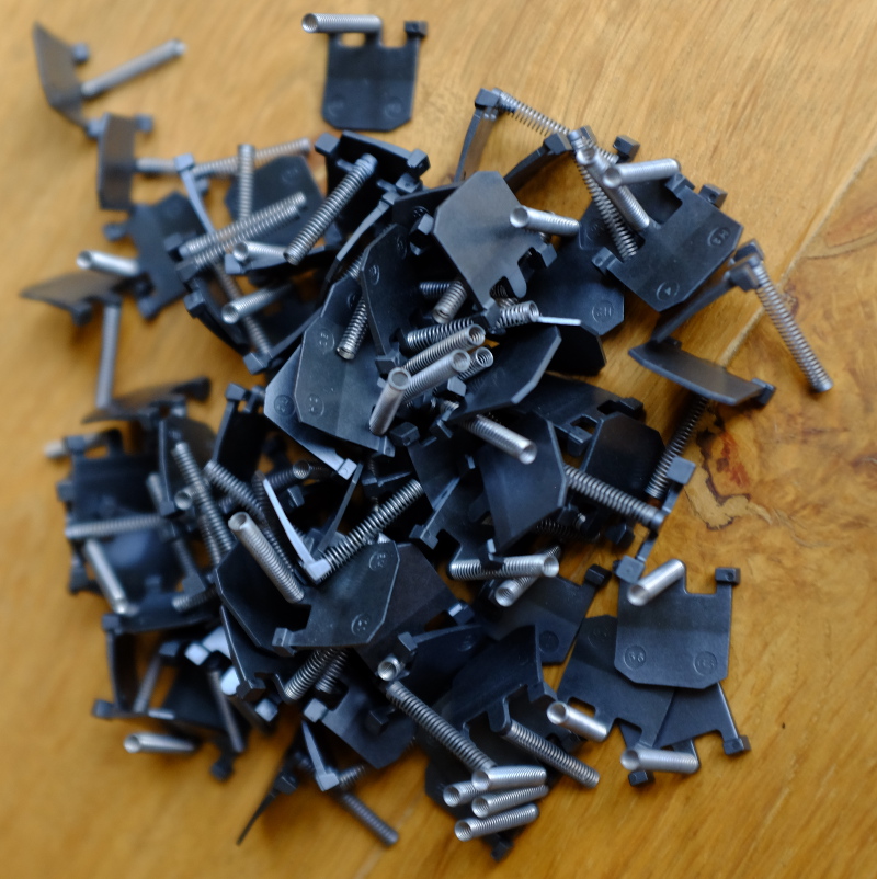

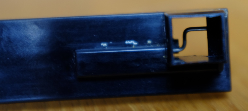

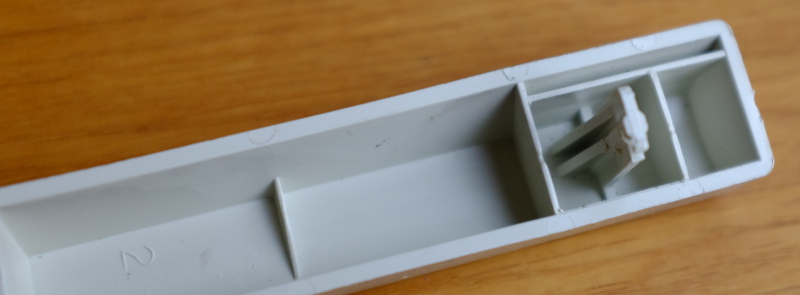

mount - 04 - Flippers
Back to index

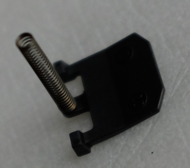

This is the flipper that I tried to repair. The glue would not hold !!

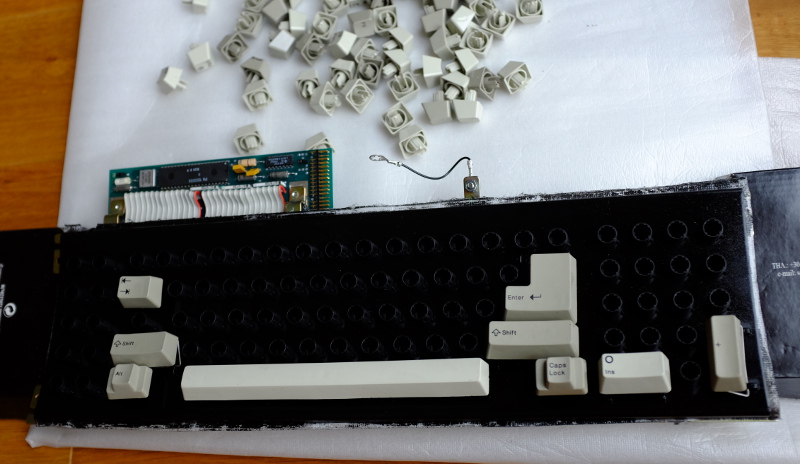

mount - 06 - Assembly
Back to index

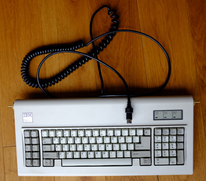

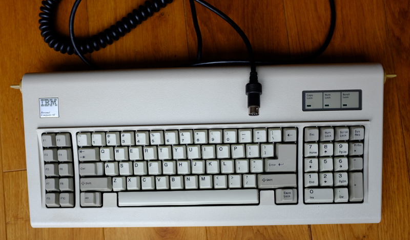

mount - 07 - Final Result
Back to index

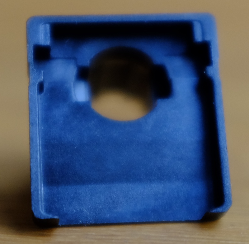

Beautiful board you have there. I've wanted one for some time now..

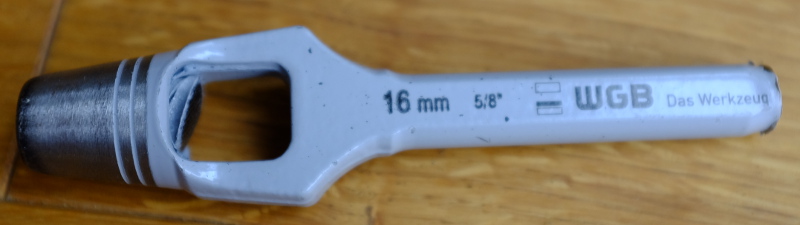

Great photos. I really want one as well. I think if I did get one though I would mod the layout to as close to ansi as I could get. I really like giant enter keys but for whatever reason, IMO it feels out of place on a IBM board. On another note, what did you use for foam, and it looks like your mechanical pencil trick for a hex driver worked really well for you. Thumbs up for ingenuity.
idollar
i$
24 Dec 2014, 00:11

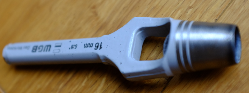

The foam that I use was actually the plastic that the seller used to wrap up the keyboard !
It was not thick enough, so I simply fold it. You can see it here. It is the last picture on this section. I also used to avoid scratches in the wooden floor ;-)
I punched bigger holes using a 16mm = 5/8 punch tool from the local hardware shop (Bauhaus).
It actually works very nicely.
I have collected another set of foam that was used to cover the screens of the new computers at work. It is very similar.
