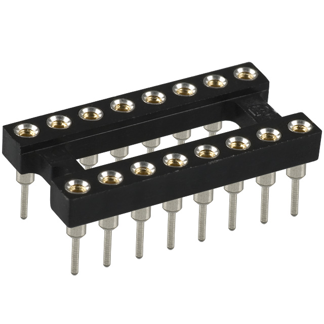

JBert
30 Dec 2014, 23:24
I've seen somebody post that they simply buy a bunch of DIP sockets with round holes:
The trick is then to weaken the plastic until the metal bits come out.

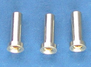

PJE
04 Jan 2015, 02:08
You may also be able to use individual pin socket inserts embedded in the PCB. These sockets can sit flush with the PCB depending on they style chosen.
shamanas
08 Jan 2015, 10:05
Those should actually do (I had them bookmarked from a while ago, one of the sizes should be really similar to the pin of a Cherry MX switch) :)
chzel
08 Jan 2015, 10:34
Those are vias, essentially rivets to connect the two sides of the pcb. They will not work because the have no springiness to maintain contact.
