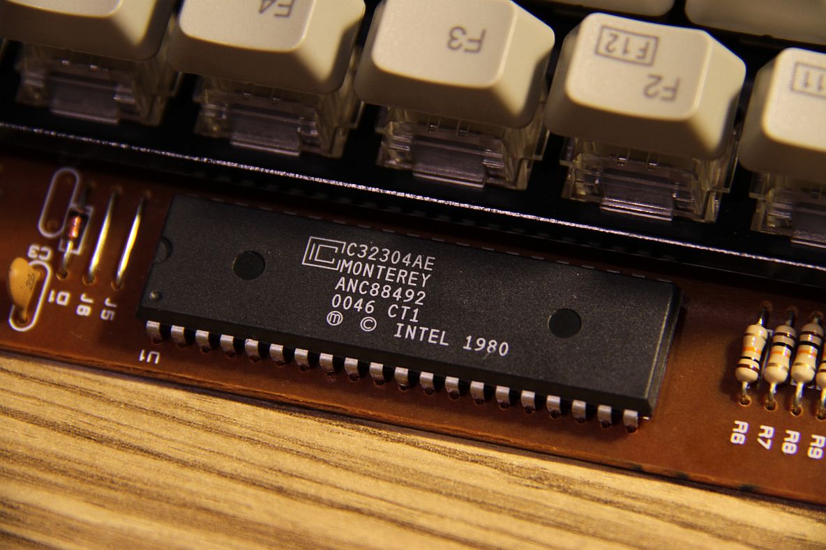

I have provided the image of the controller for my MiniTouch but not sure if I ever got photos of the switch internals. Would that help at all? It would be pretty easy as I actually have them all desoldered as I replaced all the switches with Matias tactile.

Assuming those have the narrow copper click leaves, they're T1 (if not, you have something weird). The controller photo … ah, it's in a PM, which I can't cite in a reference :) Re-posting it here:
002 SIIG MiniTouch controller IC.jpg (162.95 KiB) Viewed 2219 times
2000 — very late issue!
Added to [wiki]Keyboards and switches by year[/wiki] as I have no reason to believe those are anything other than AK-CN2.

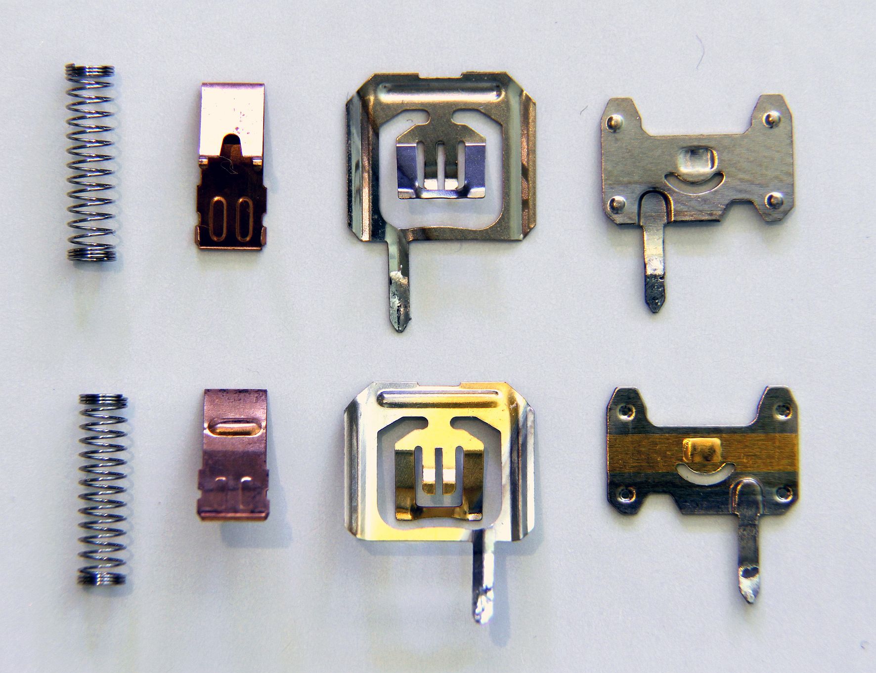

Ok here's a pic of the internal components of two of my MiniTouch switches. I chose one with a two-digit number (11) on the housing and another with four-digit (2F82). They seem to be the same to me. Is this the narrow click leaf?

Yep, that's the narrow leaf. The wide leaves looks virtually the same as the ones from Alps switches. I'm getting close to completing a clone recognition chart: [wiki]Four-tab clone[/wiki].
Basically what I aim to confirm is when the type you have, was introduced, and when the previous type (OA2) was phased out.
