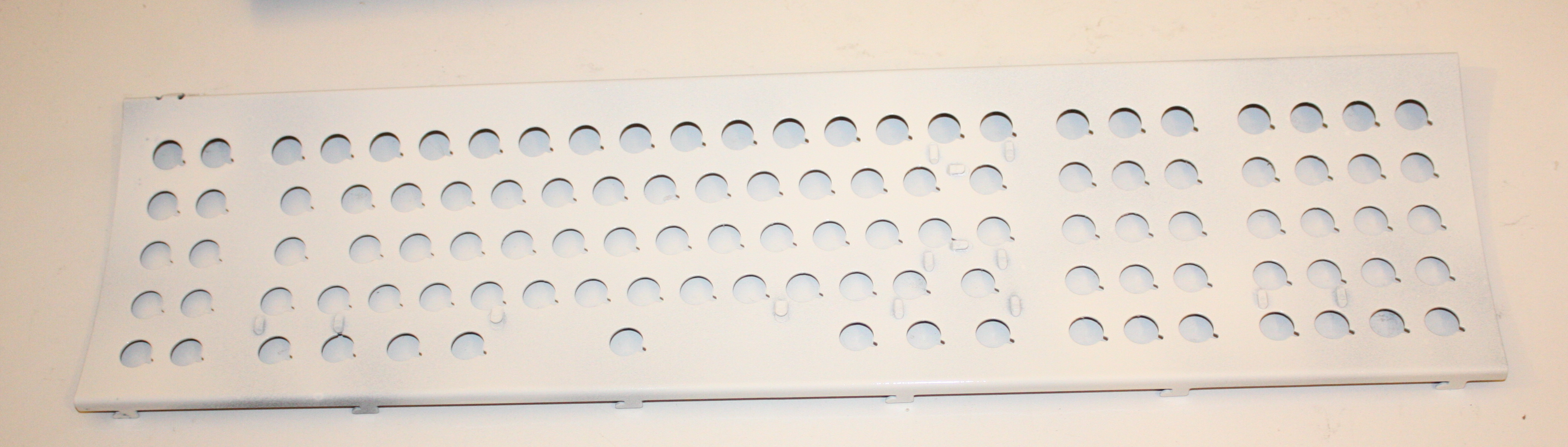

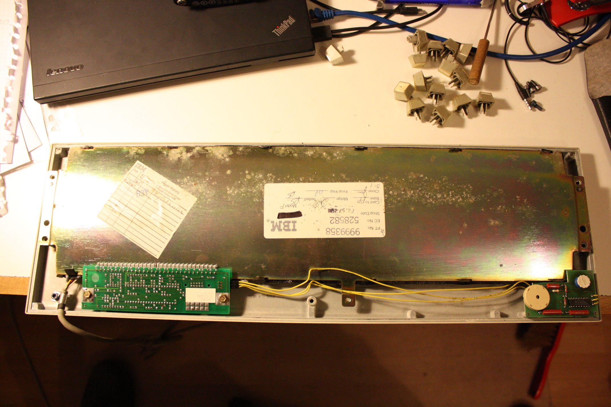

Well, the first thing I did was to open it:
opened
opened
To my surprise, it has metric skews. Maybe in 1983 IBM still hoped that one day the US might make the switch that it hasn't made yet. You can see some corrosion in the backside of the board, but that a way more harmless then it looks like in the picture.
Apparently it was repaired at some point, I can't figure out what was been done. I guess as of today nobody would repair a keyboard anymore.

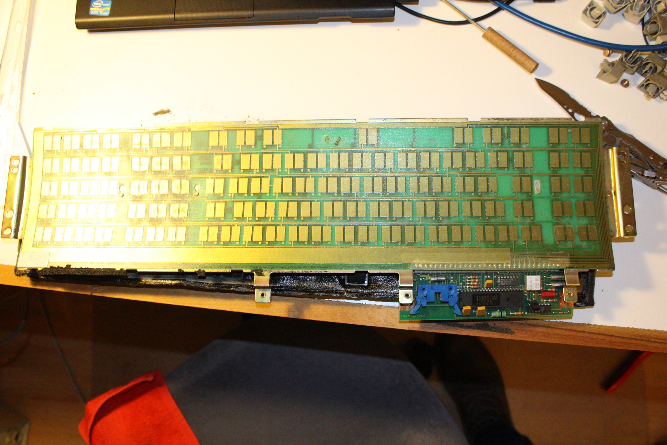

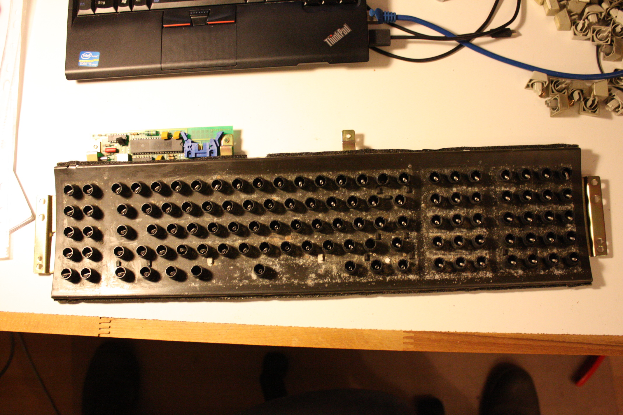

This is the board:
board
board
The board itself makes up a significant portion of the weight.
The board looks dirty, so I'll disassemble and clean it.

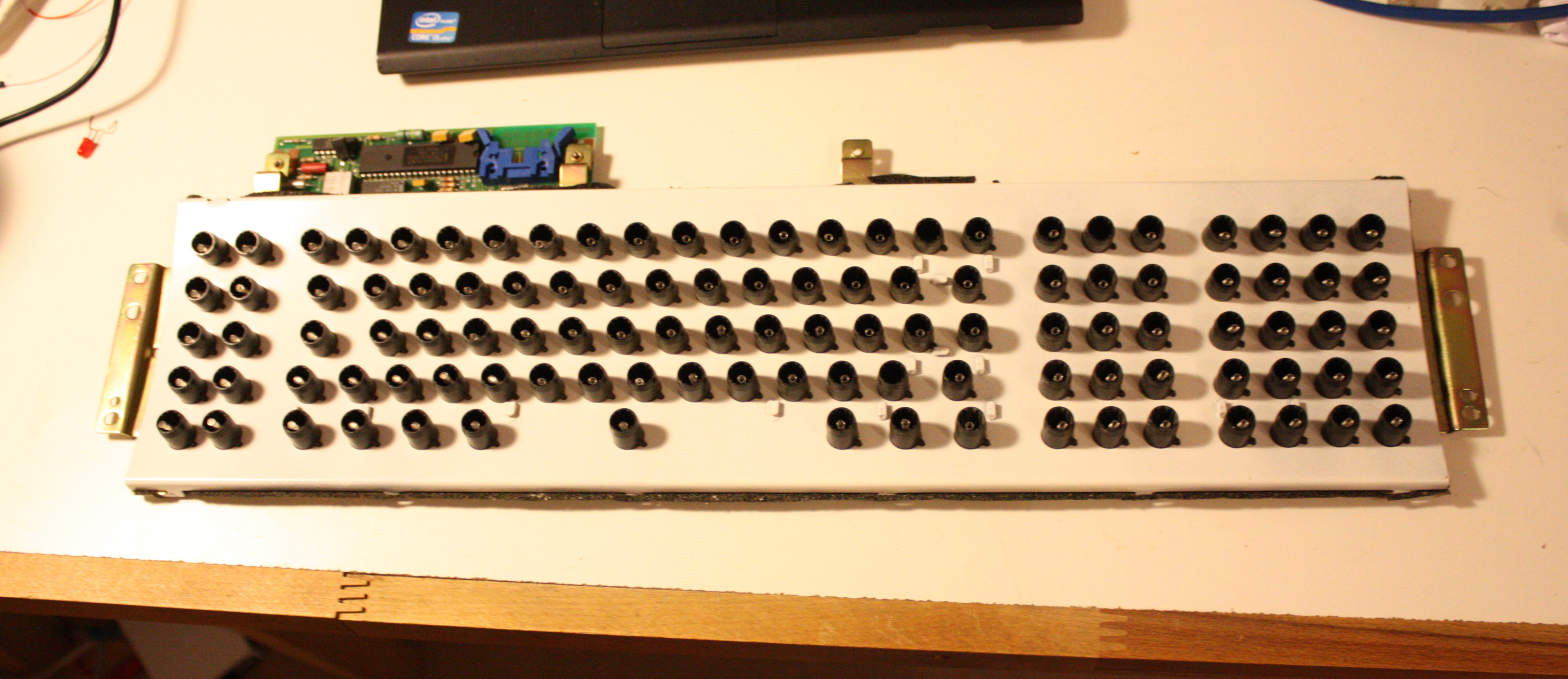

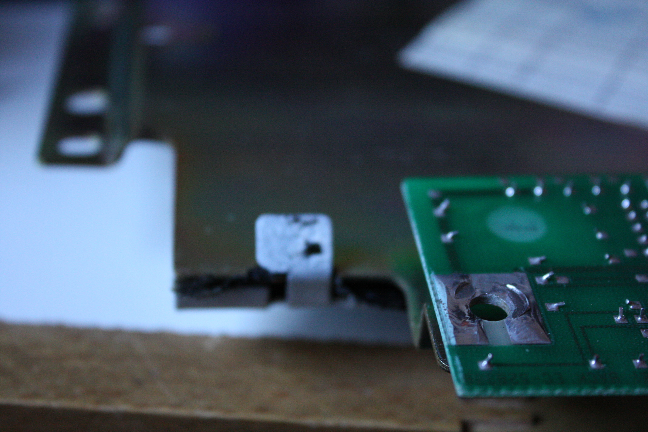

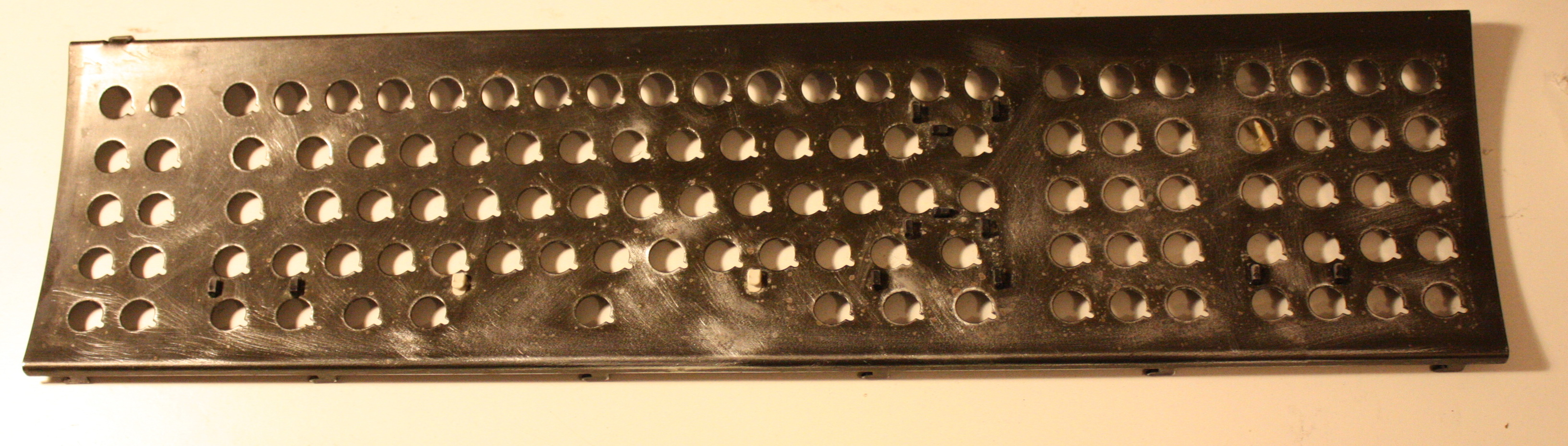

The "board" itself is a sandwich of a sheet, the pcb, the barrels with the springs, foam and another sheet. After beding back one cramp, the upper and lower sheet can be slides against one another and the sandwich opens.

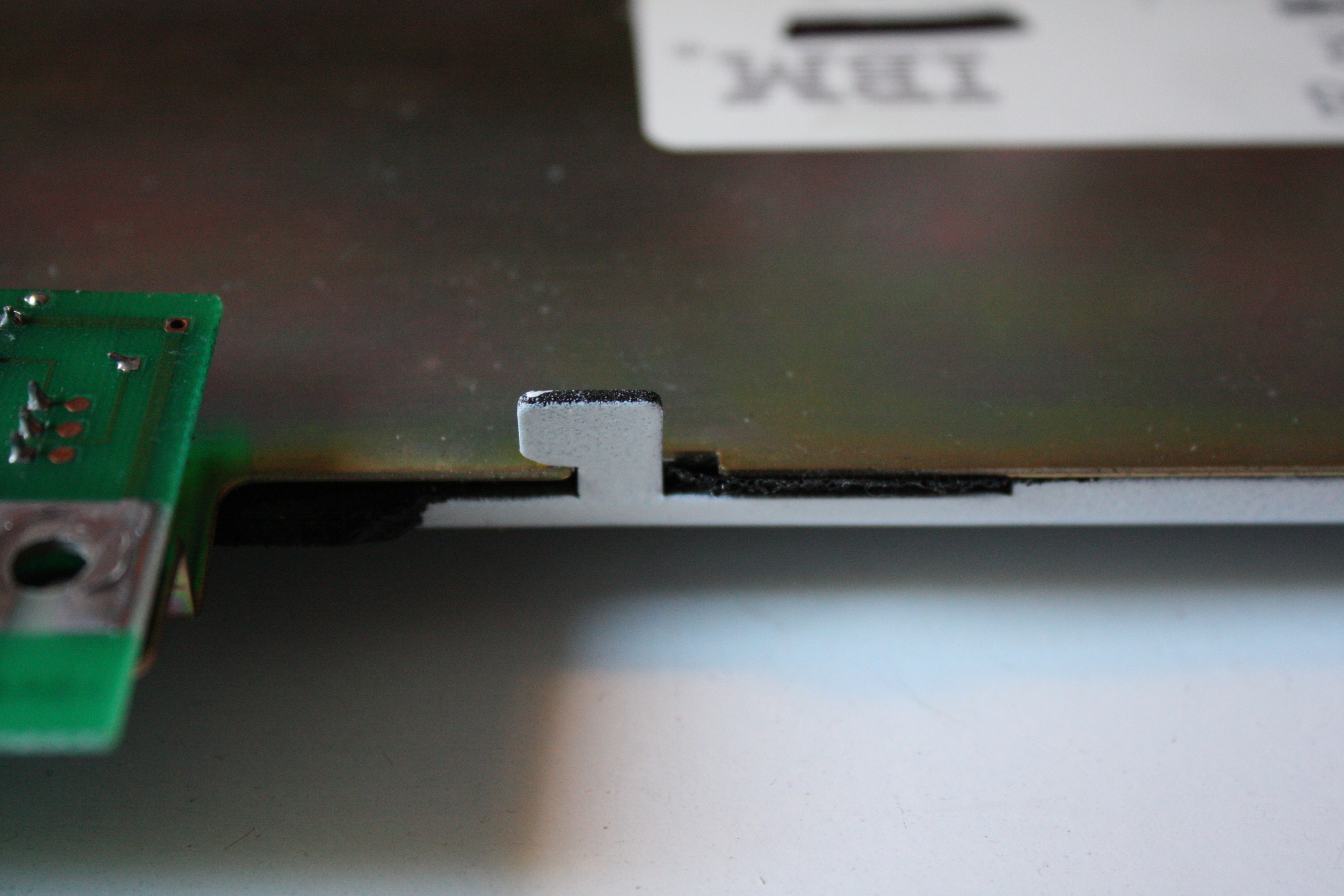

The cramp that prevents the sliding in lock position: (picture made at the end, herence the white color).
cramp
cramp

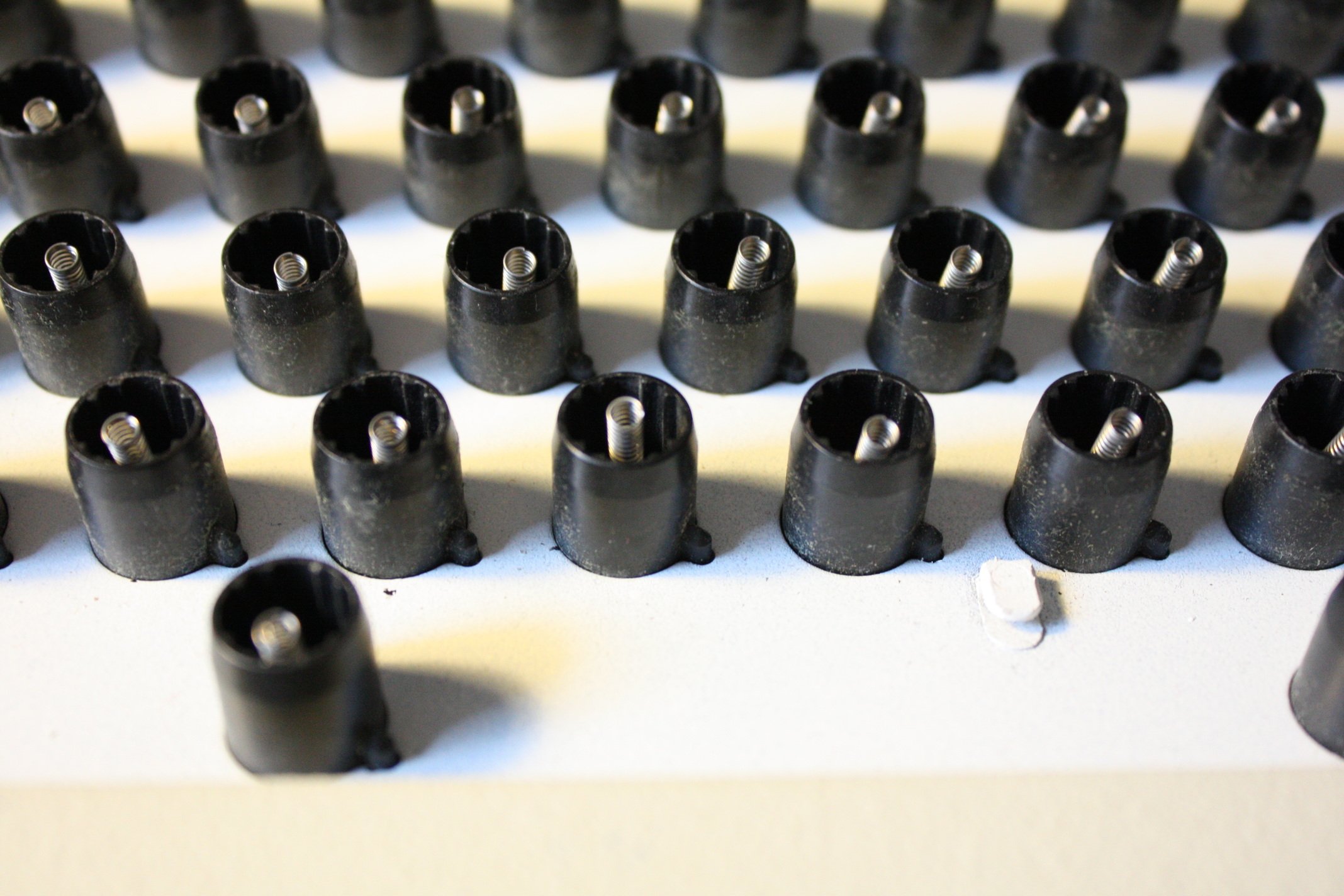

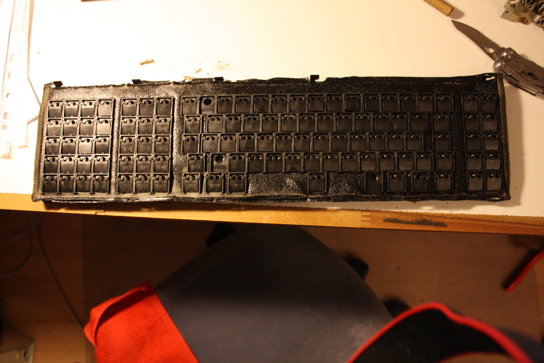

The two parts:
pcb
pcb
barrels
barrels
I expected the foam around the barrels to disintegrate completely, but it was in a surprisingly good condition. What a luck, because replacing that would have meant I'd had to punch more than 107 hole in a piece a foam, at the right position, I wasn't looking forward that.

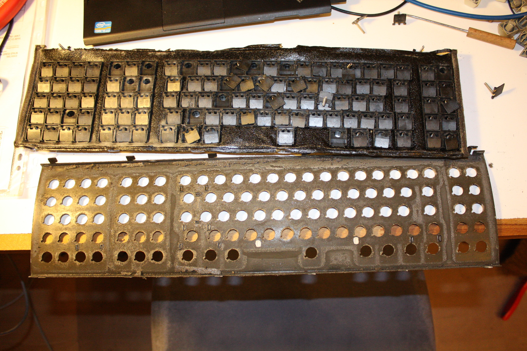

Remove the foam from the upper sheet:
oh no
oh no
And loose lot's springs. If you ever do the same, keep your workspace cleaner than I do, finding these once they are lost is quite tricky.

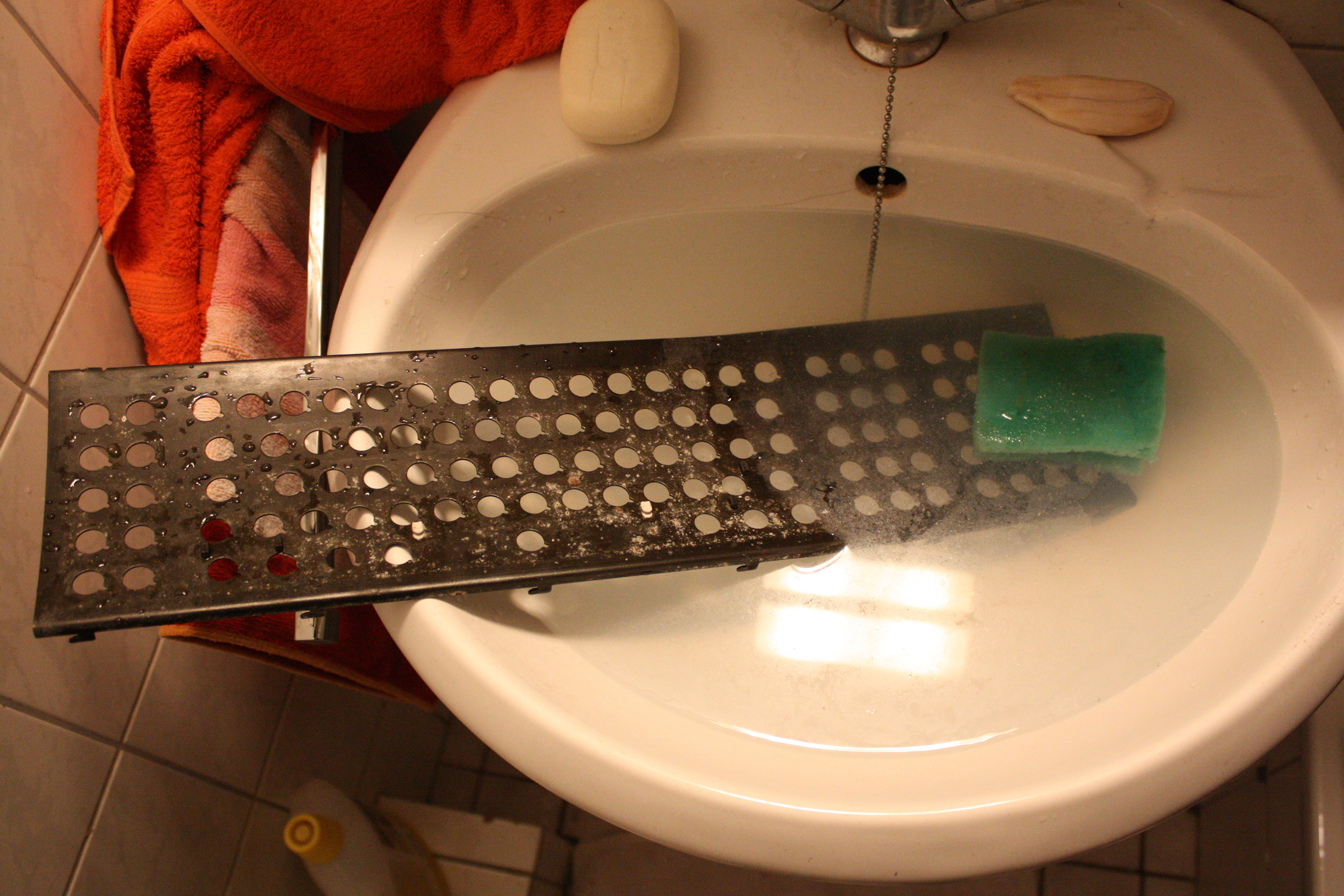

Now it's time to clean the thing, the reason why I disassembled it.
cleaning
cleaning
As You can see in the water, it was very, very dirty. However, the most ugly parts wheren't dirt. On the left part you can see how it looked like "clean", the right part, under water was much worse. This plaque was corroded metal, and I couldn't remove it without tools. This looks a way more harmless on the photo than in reality. So I sandpapered it.
All the silver sports are now bar metal, and previously had rust on them. In order to avoid further rusting, I spray painted it.

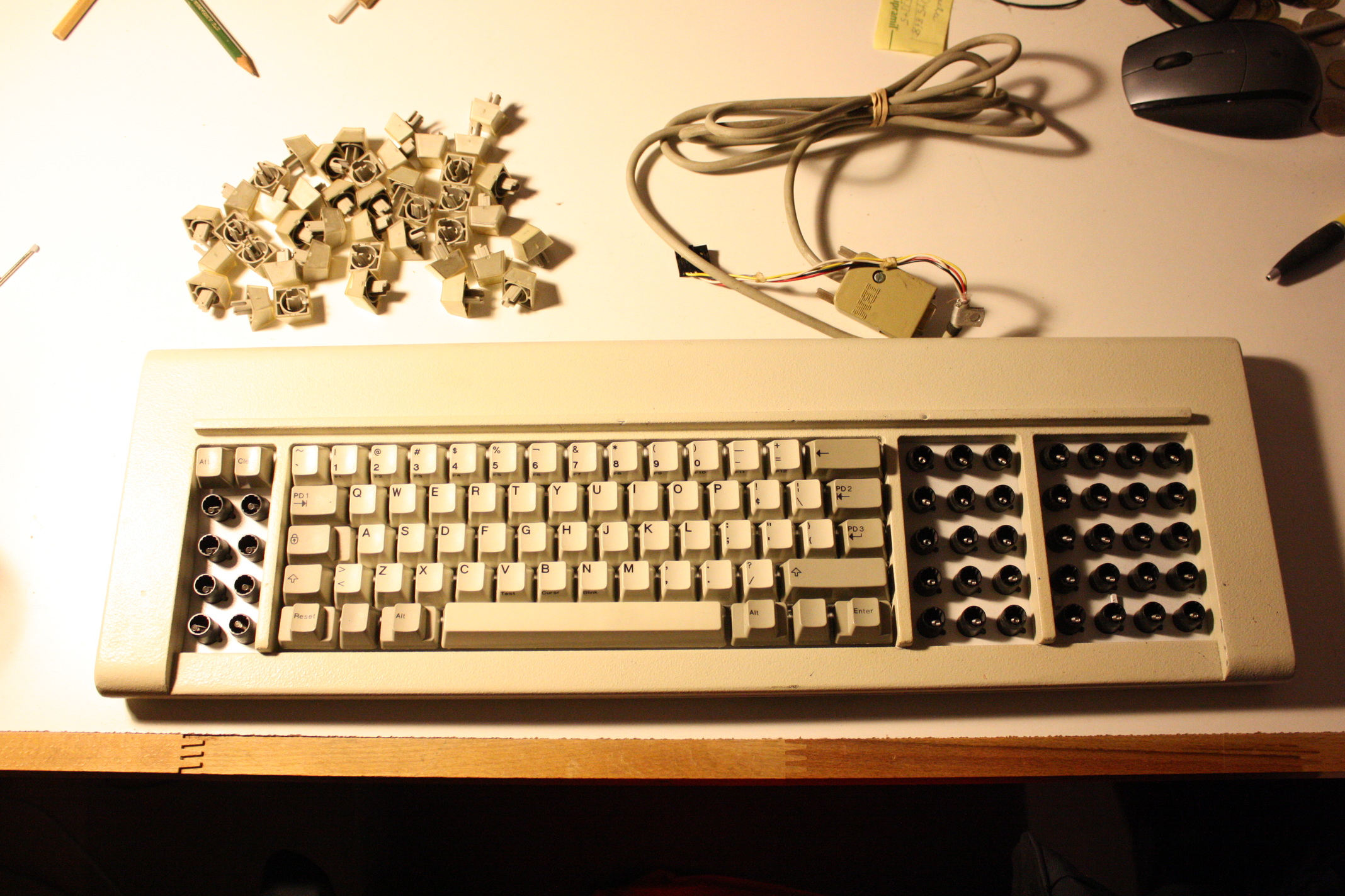

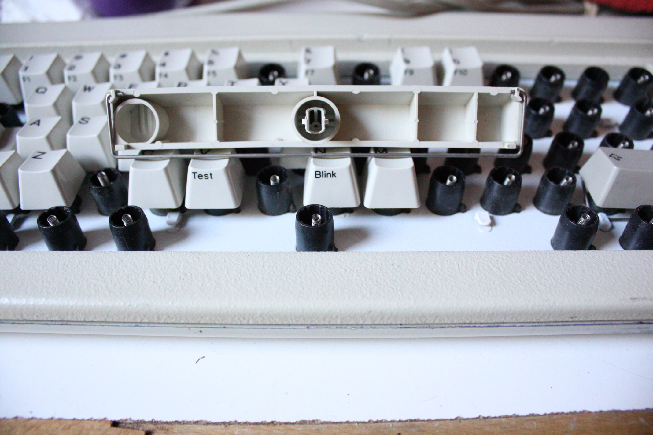

I thought I lost a spring during the whole thing. Model M springs can be bought individually for very little money, but Model F springs are apparently hardly available. So, if you do this, pay more attention then i did. Because I didn't knew what what to do i left the place where i could place the roll-lock key empty. (Do you see my mistake? I didn't).
Here it is:
Mistake
Mistake
Well, so much of the lost spring. I was very lucky to "find" it in such a odd space. :D
Here another picture of the sliding mechanism:

There is one of a spring that behaved oddly:

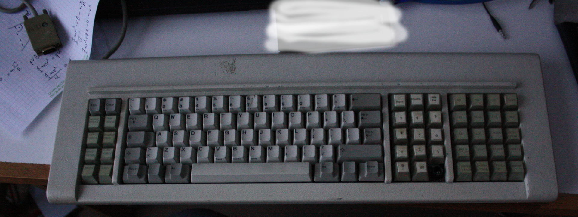

And the Keyboard in it's whole beauty:
By the way: The keycaps have very sharp edges. :(

@seebart, he didn't loose it, he put it in the second spacebar position!
And that is worse! Looking for the bloody thing all over and later realize it was there all along! :evilgeek:

@seebart: Fortunalty I found it again. Look at the spoiler. :D

And yeah, the sliding requires a whole lot of force. I just a block of wood and a screwdriver as a crank.

I have taken my F107 apart and put it back together probably 7 or 8 times now, and I have wound up putting a spring/flipper into the spacebar and backspace barrels multiple times. Incredibly annoying.

Excellent, looks like it found a great home! If you mod it to ansi or iso, you'll get another spring back :D
I don't think leaving that flippy with the spring will cause any issues as there are no pads there, but it might change some capacitance values if there's a trace running beneath it or something. Don't recall where the barrel was exactly located in respect to the pcb..

Na, the spacebar behaves funny, so I fixed it later. So far I don't have the controller so I can't test that. I'm just surprised that a tiny piece of plastic on, not even in between, such a tiny capacitor is even measurable. As a short napkin calculation gives below 10^-12 farats, that's incredibly small. Maybe this fragile circuit could be irritated by this.
Parak
22 Jan 2015, 22:42
Did you take into account that the plastic has material embedded in it to help with capacitance - a bit similar to a finger really, as any model F bare pcb can be tested by thumbing the pads instead of placing a flippy on them :D
The pcb is also 0.8mm and not 1.6.
