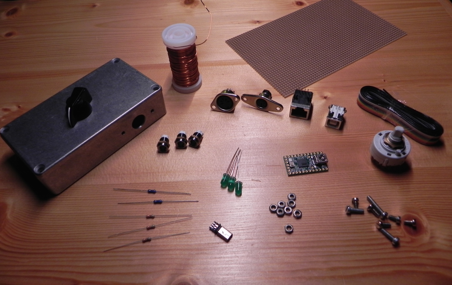

Sneak Peek:

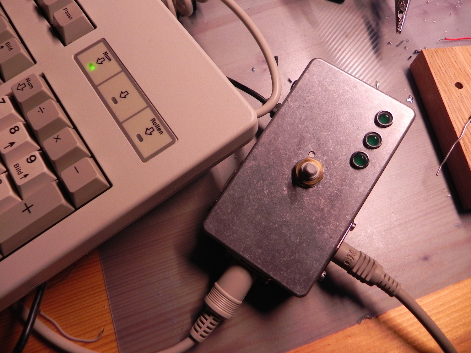

Here's were I'm currently at:
Keyboard shows NumLock LED, converter not so much. :(

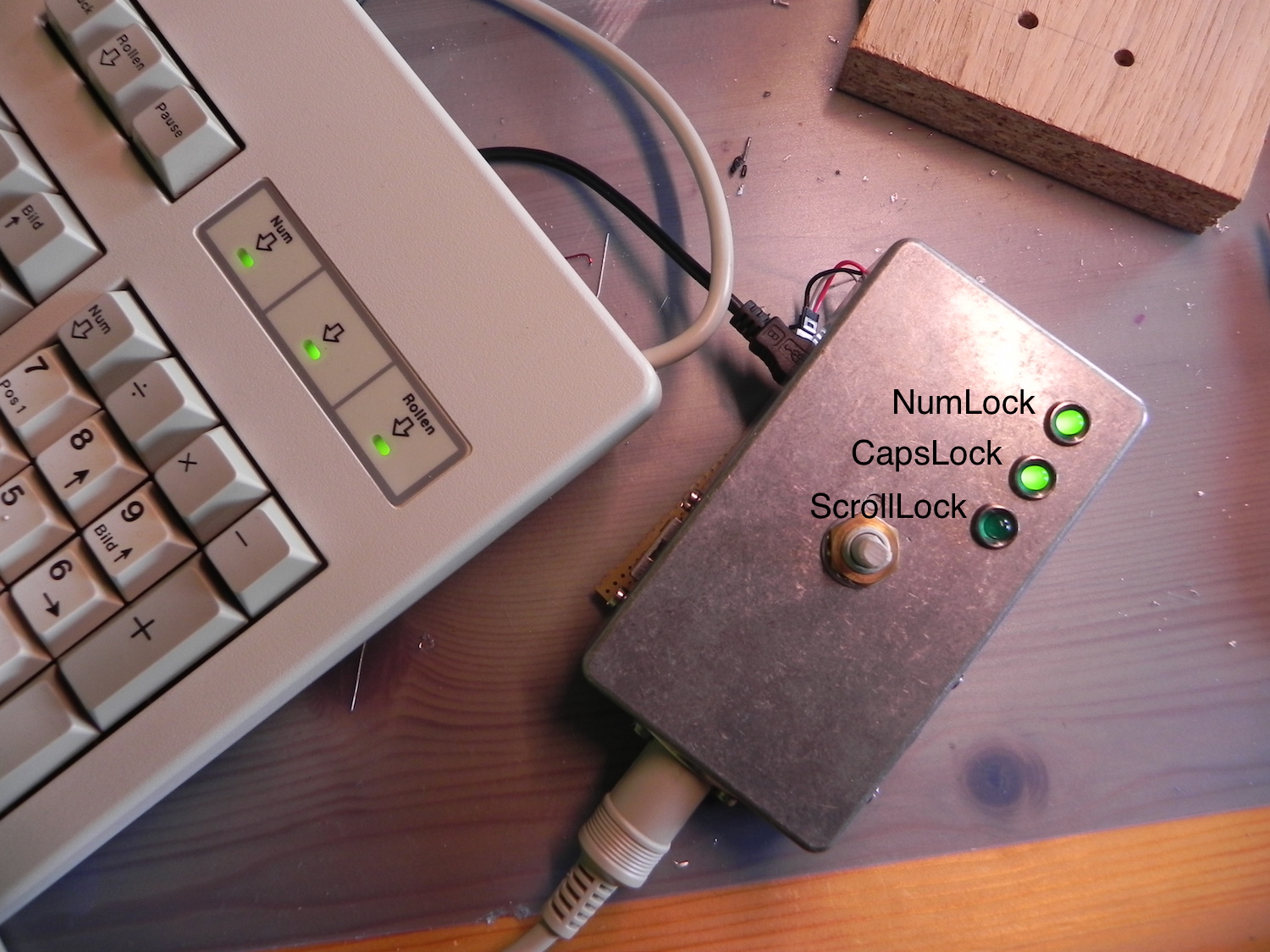

Thank you for the help Halvar! I checked the wiring again and noticed that I had the LEDs connected to RST instead of GND. Image
The LEDs light up now! :D
Except for ScrollLock :( I have to investigate further...
EDIT: Got ScrolLock working. :o

I'm still working on the automatic part. I haven't yet closed the metal box (you can see the circuit board lurking in the picture above).
