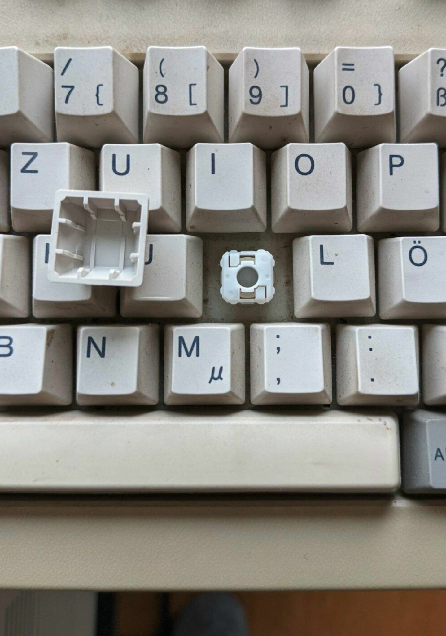

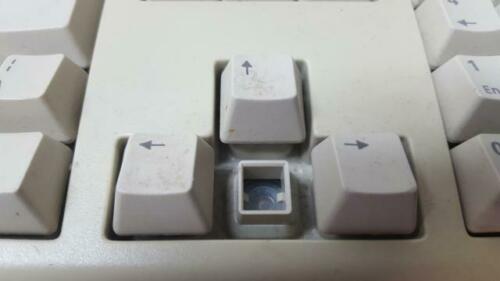

It has blacksLalaland124 wrote: 29 Mar 2021, 18:33 Is this a NCR branded G80 with vintage blacks or could it have Alps Skcl Green?

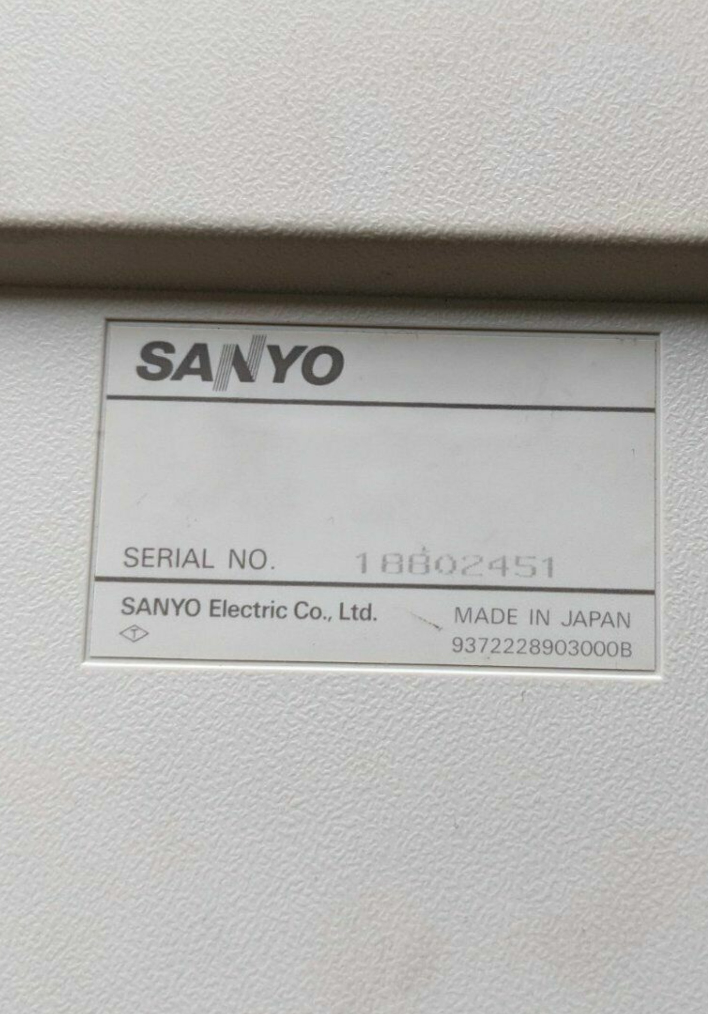

Now that I look at it more, there are 2 styles of desktop keyboards Fujitsu made for different vendors and this is in the "Sanyo style" with the cable coming from the left, the flat ridge at the top, bumpy case texture, and gentle slope at the front bezel. Then there is the more common "Tandy style" with the cable coming from the middle, bumpy ridge at the top, grooves in the left and right side, a bigger front bezel, and a thicker hollow bottom.Lalaland124 wrote: 02 Apr 2021, 18:38 Thanks! I also found this one: Seller says it doesn't click.. Some weird variant of Fujitsu leaf spring?
Generally, the Sanyo version is better built with 3mm thick ABS caps instead of PBT and a steel back panel instead of plastic. However, there is not much known about it the Sanyo version. The XT version came with the MBC-16 Plus and I do not know which computer the AT version came with. I found this video of it https://www.youtube.com/watch?v=sYxV_8kXn3o.
Here is a gallery comparing the differences of the two styles: https://imgur.com/a/EWsBJ5W

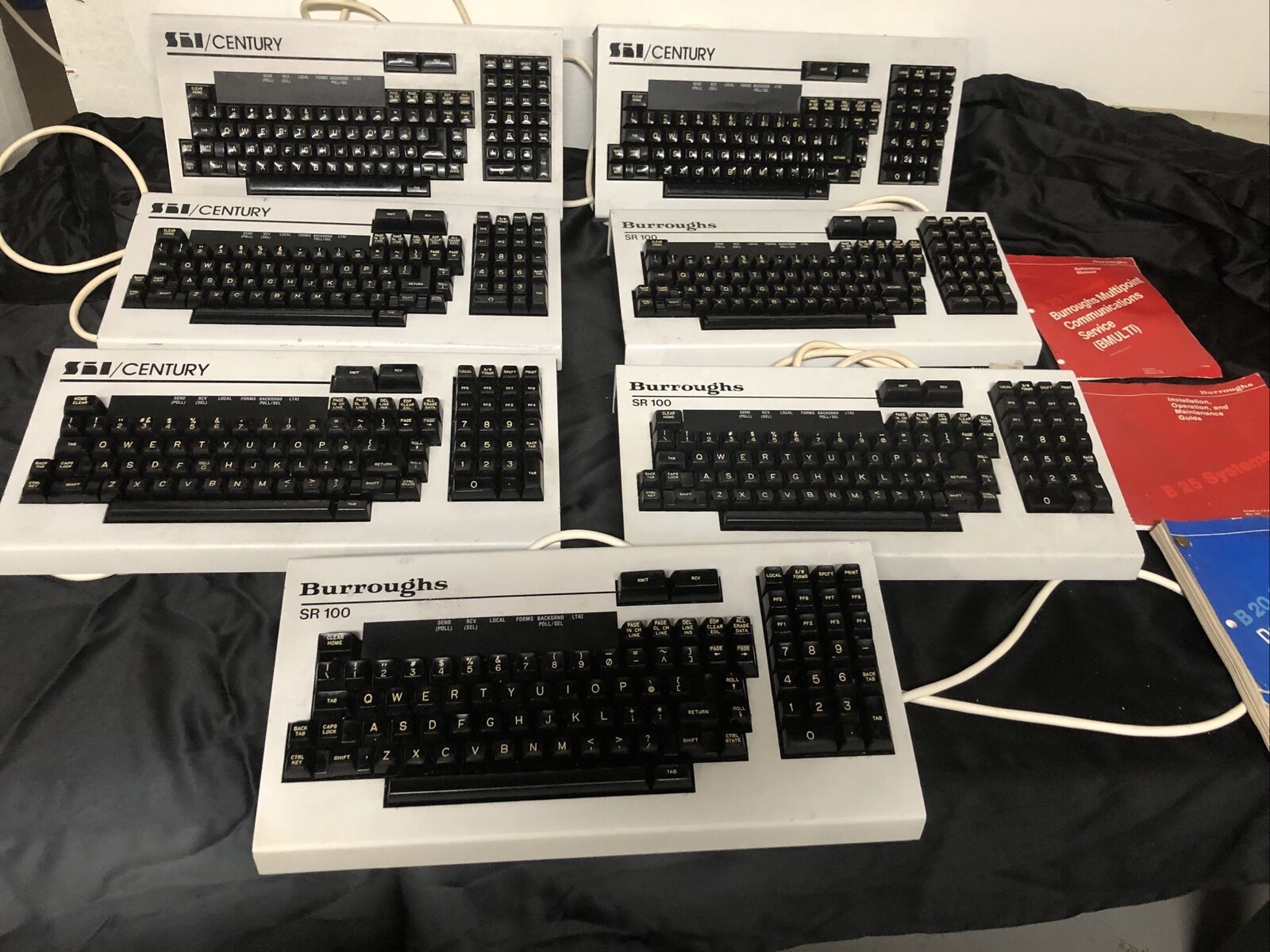

https://www.ebay.com/itm/Vintage-Keyboa ... 4678562684
Burroughs Century and SR 100 keyboards. I think probably foam and foil, but the wiki lists opto-electric for another model. Anyone have any ideas?

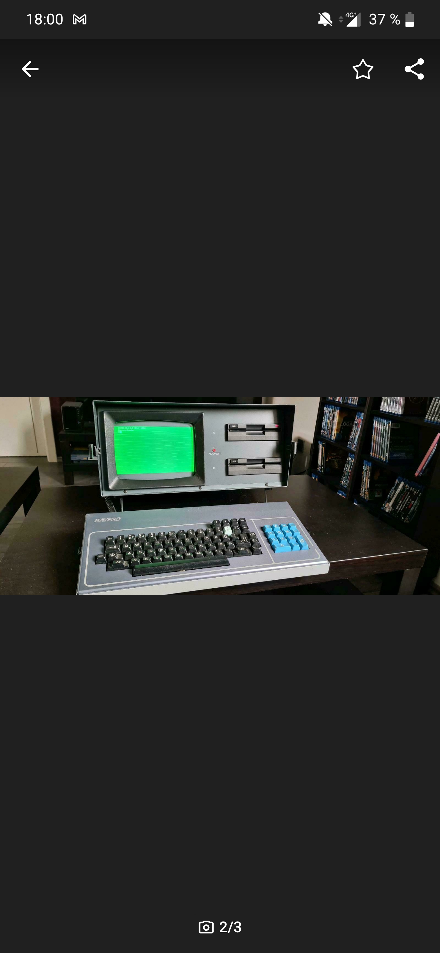

It's a Kaypro 4 computer - anyone got ideas what switches it comes with?
- Screenshot_20210419-180007.jpg (618.41 KiB) Viewed 9357 times
- Lalaland124
- Main keyboard: 3278
- Favorite switch: Beamspring
Nevermind, got it
It's the SMK J-M0404

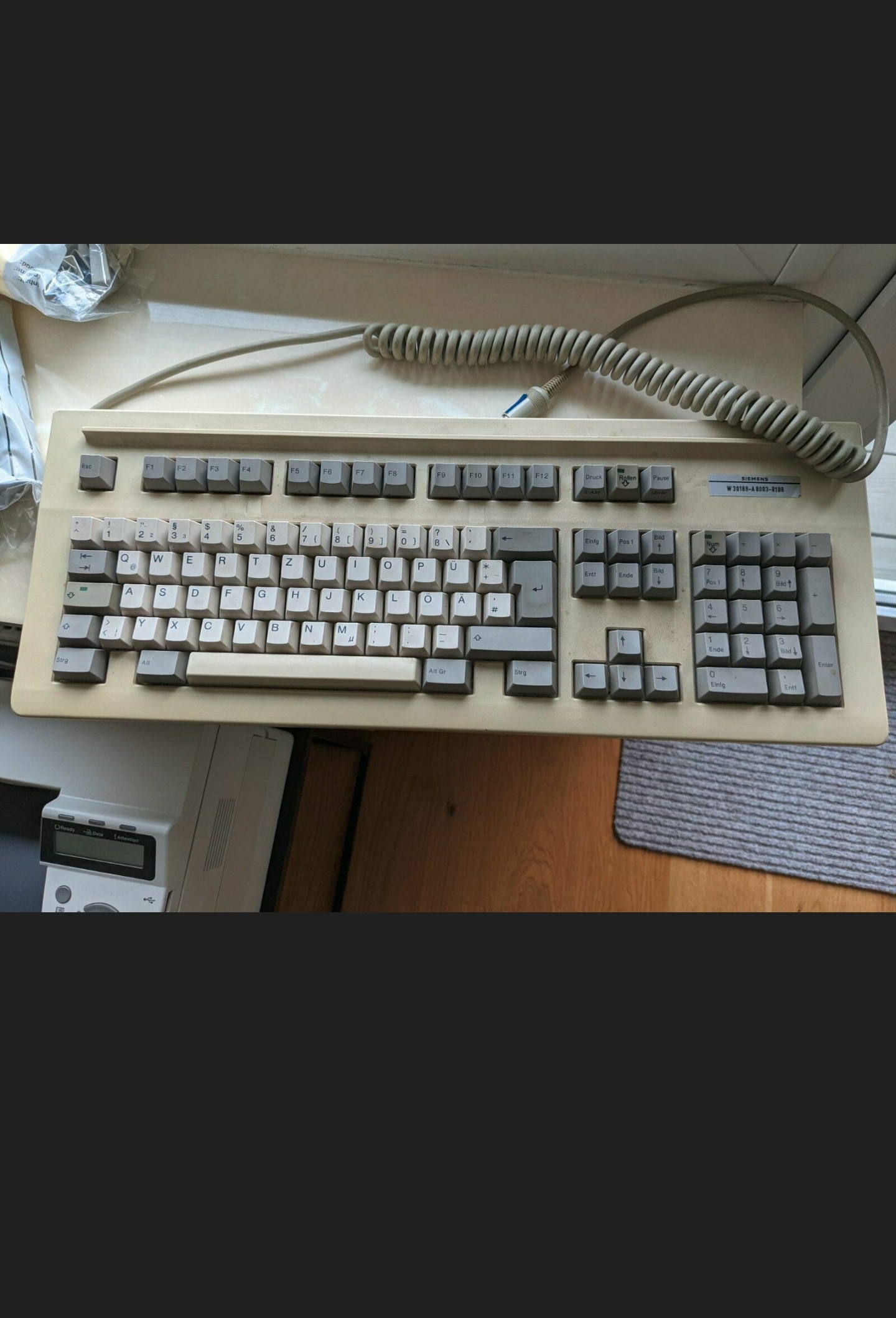

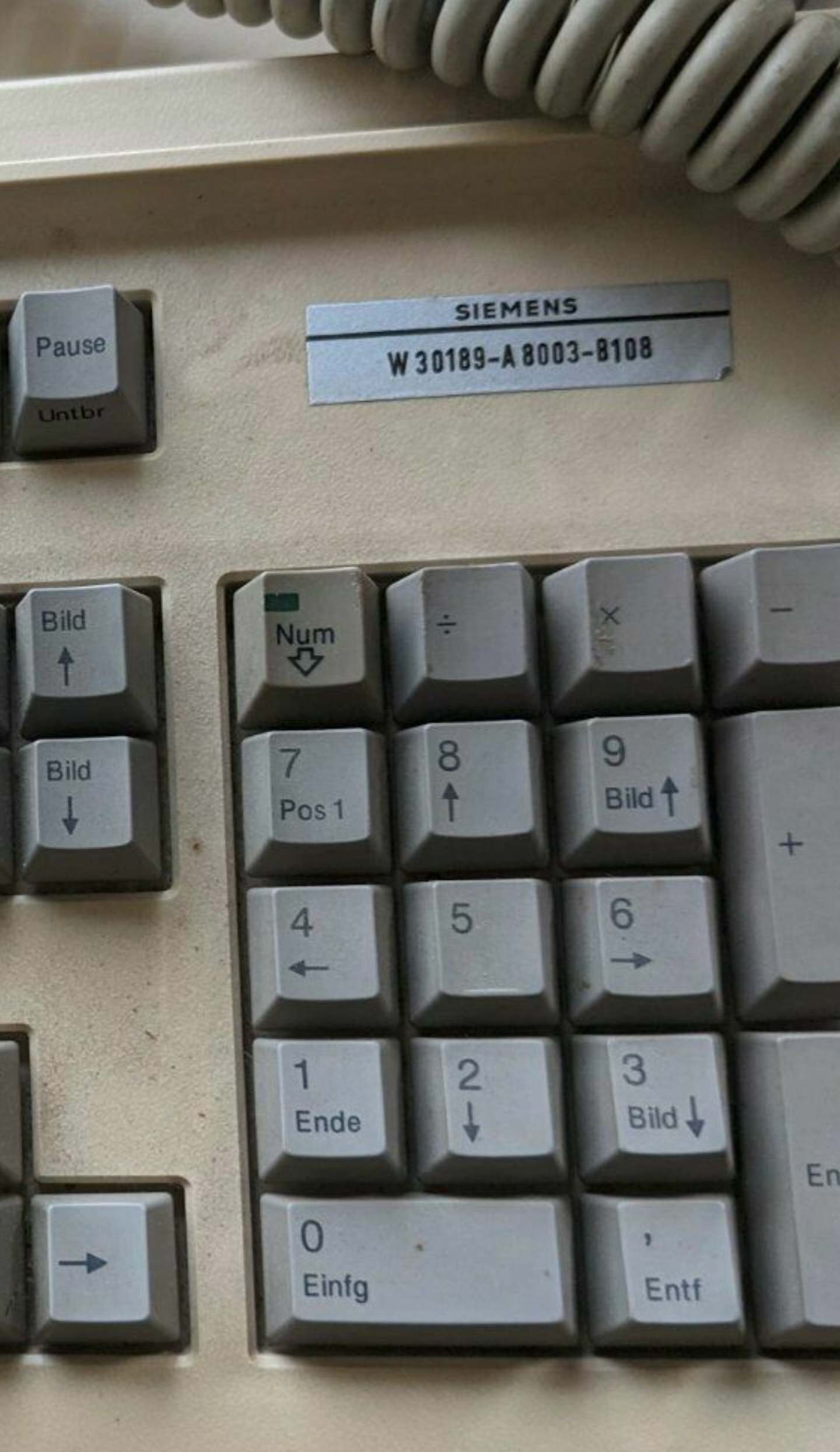

inozenz
Yeah it's a weird layout.hellothere wrote: 22 Apr 2021, 01:31 Possibly Cherry, but probably foam & foil.
FWIW, I like the idea of the tilde/accent (`~) key way far away from the other keys. However, I really dislike where the backslash/bar is (\|).
The label reminds me of Sanyo keyboards font and since it's from Japan I thought it might be a Fujitsu board.
I think I'll just spend the 30bucks for the community.
