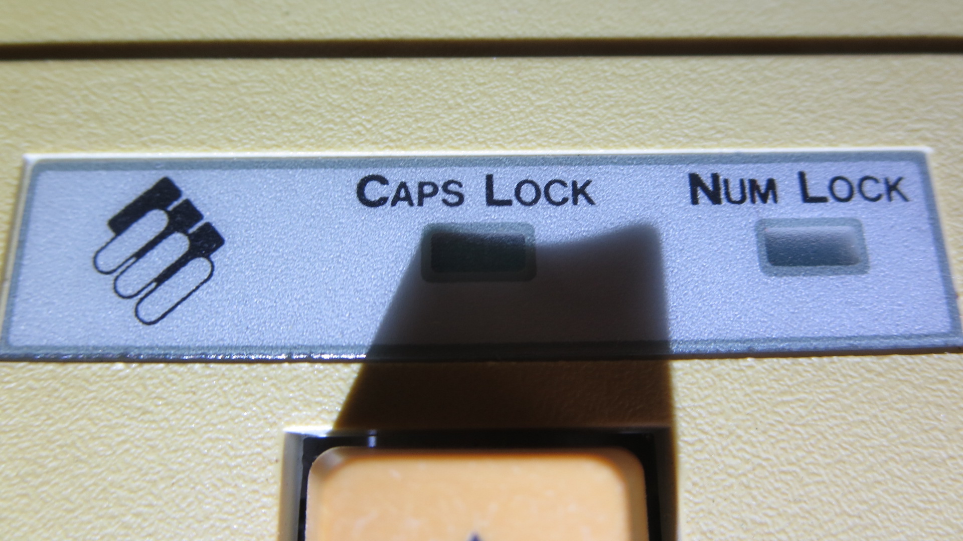

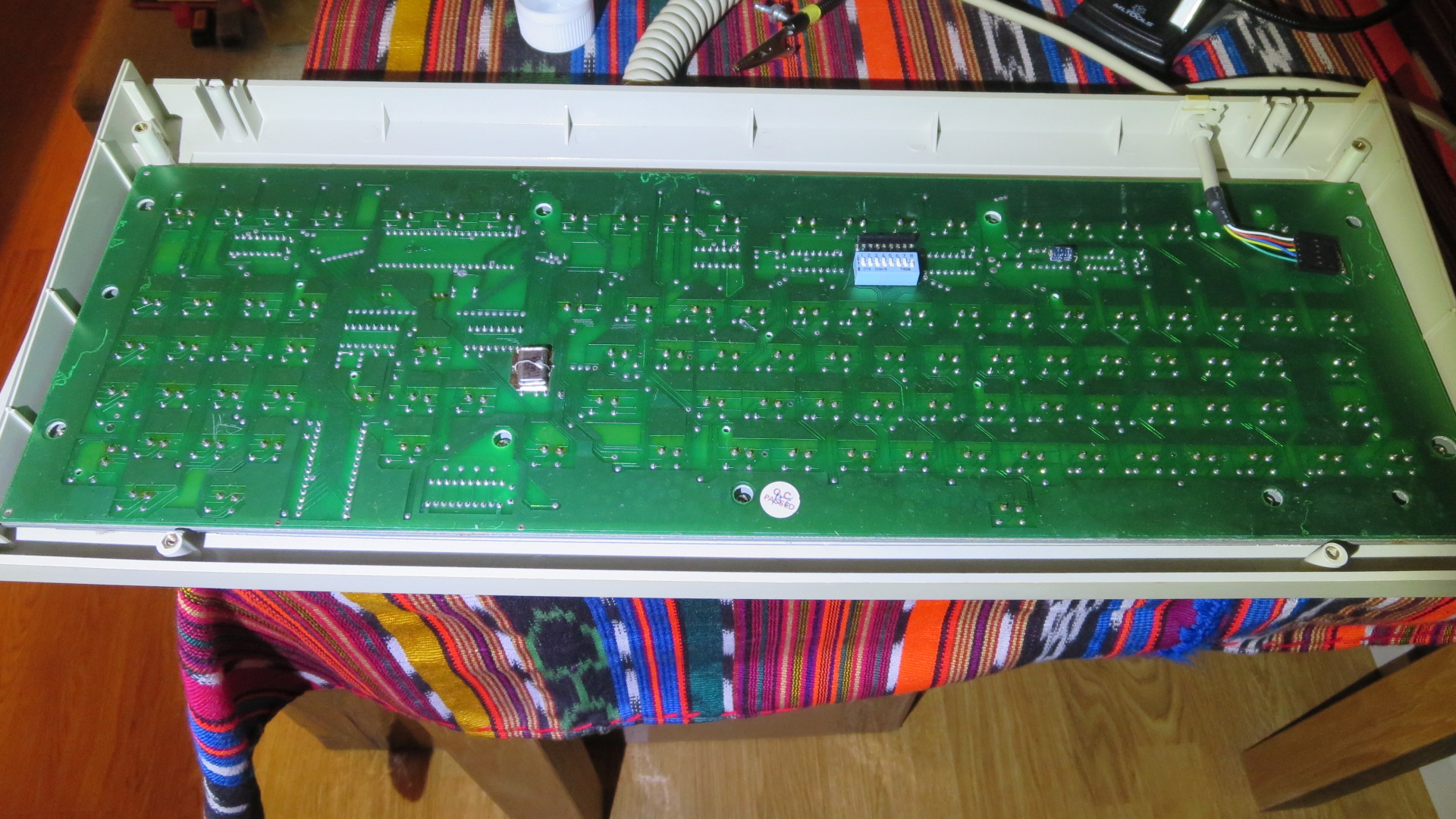

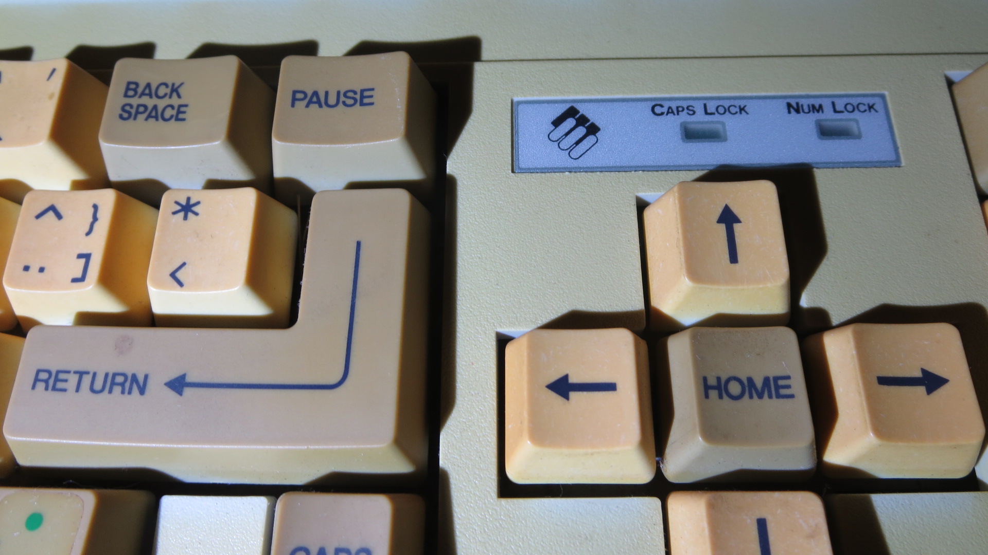

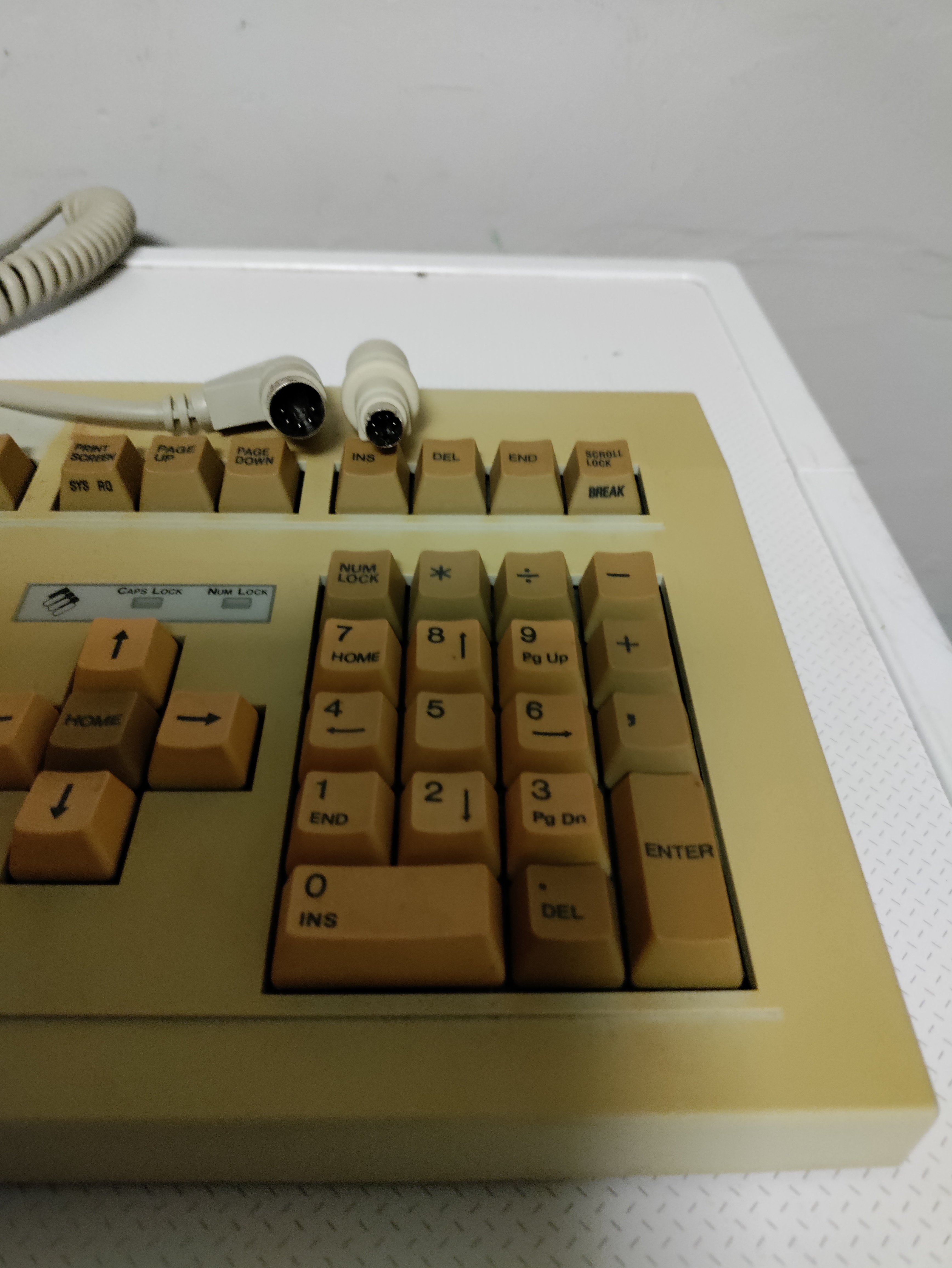

I've now received the board (actually had it delivered by the seller) :-). Was hoping to say that the mystery had now been solved as I've taken it apart – but alas, not that easy it would seem.

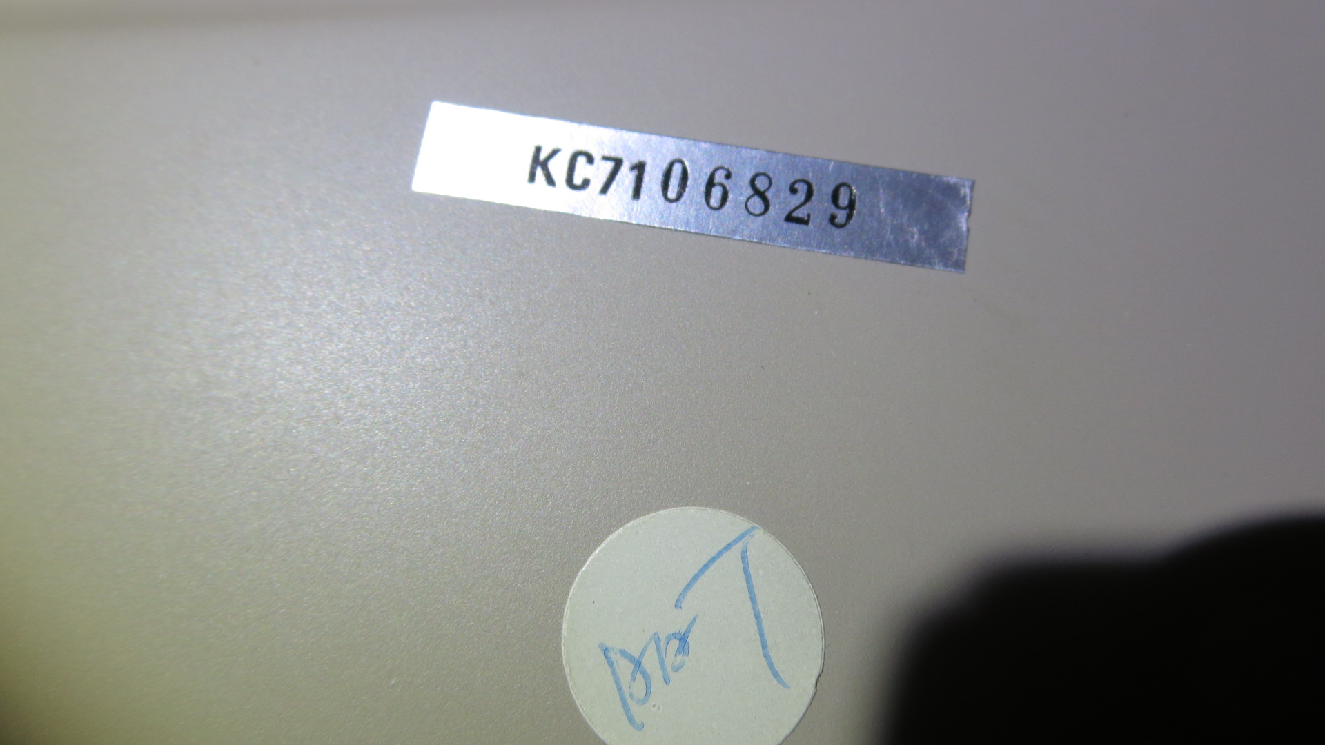

Took some more pictures. Apart from the serial number, which starts with KC71 (seemed to perhaps be a model indicator, but cannot find anything about that either). It has “PCB NO 2051526-01” printed on the back of the PCB.
Full board:
Navigation keys + lock LEDs
Closeup of the “70s Warner Bros.–like” logo ;)
Closeup of serial number (nothing else on the metal backplate)

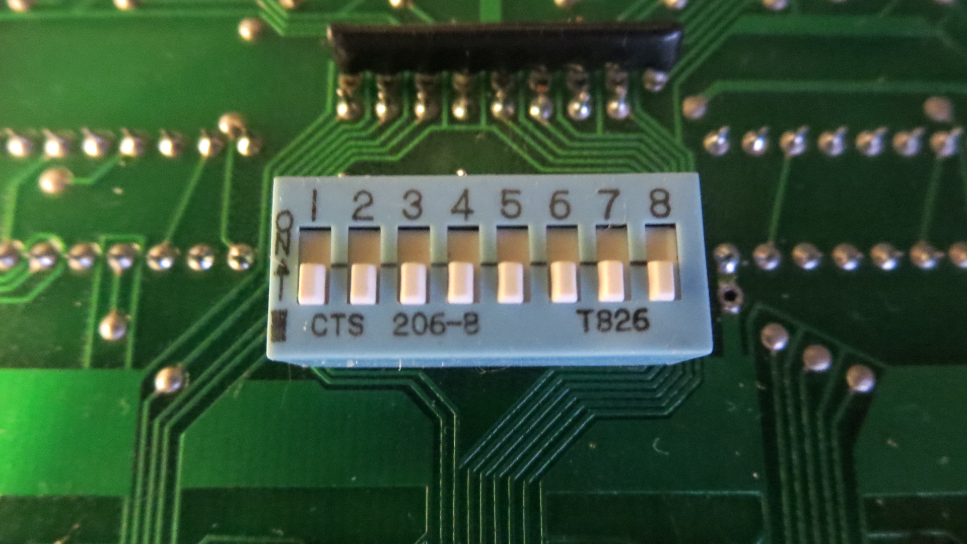

It has a DIP-switch bank with eight switches on the back (CTS 206-8 T826). It was initally set to switches one through seven as “on” with number eight as “off”. The only other text on the PCB is “UP2-1”, presumably for the chip on the other end.
Upon hooking up the keyboard, it only produced error-codes with my Soarer converters–as well as my TMK converter. The passive-AT to PS/2 adapter, together with a mouse+keyboard combo adapter to USB, did not work either. (same config works for other AT models)
I then moved all the switches to the “off” position (after finding documentation for a similar 8-DIP switch for the Northgate Omnikey, indicating that switch 8 was for sticky-keys (Ctrl/Alt/Shift), and the first switches were in order to set the protocol (amongst other things)
After doing this; my TMK converter was able to detect keypresses, and identified the board as “AT84”. The Soarer still produced error-codes though. Hmm.
I am still a bit baffled that the board was not able to be identified after looking underneath the hood, so to speak.
Lastly, I have to say that I expected the large return to be quite horrible wrt. to off-center keypresses, but was pleasantly surprised that it works flawlessly, even when hit at the extreme sides(!). I haven't experienced that with any of my “big-ass” return keyboards, which aren't good at all (even with two stabilizers) on off-center keypresses. Same story for either the "cheaper" white Alps or my more solidly-built blue-Alps board.
With regard to the build-quality:

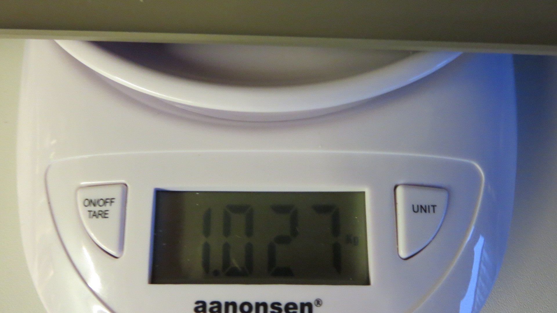

The whole thing weighs in at pretty much exactly 2.5 kg (“or in imperial units...”: <insert @Chyros quote here>) ;)
The metal backplate alone comes in at one kg (which is approx. 300 grams more than my white Alps board):
Hope some of these pictures and information are of help in identifying the board (or at the very least prove interesting to look at) ;)

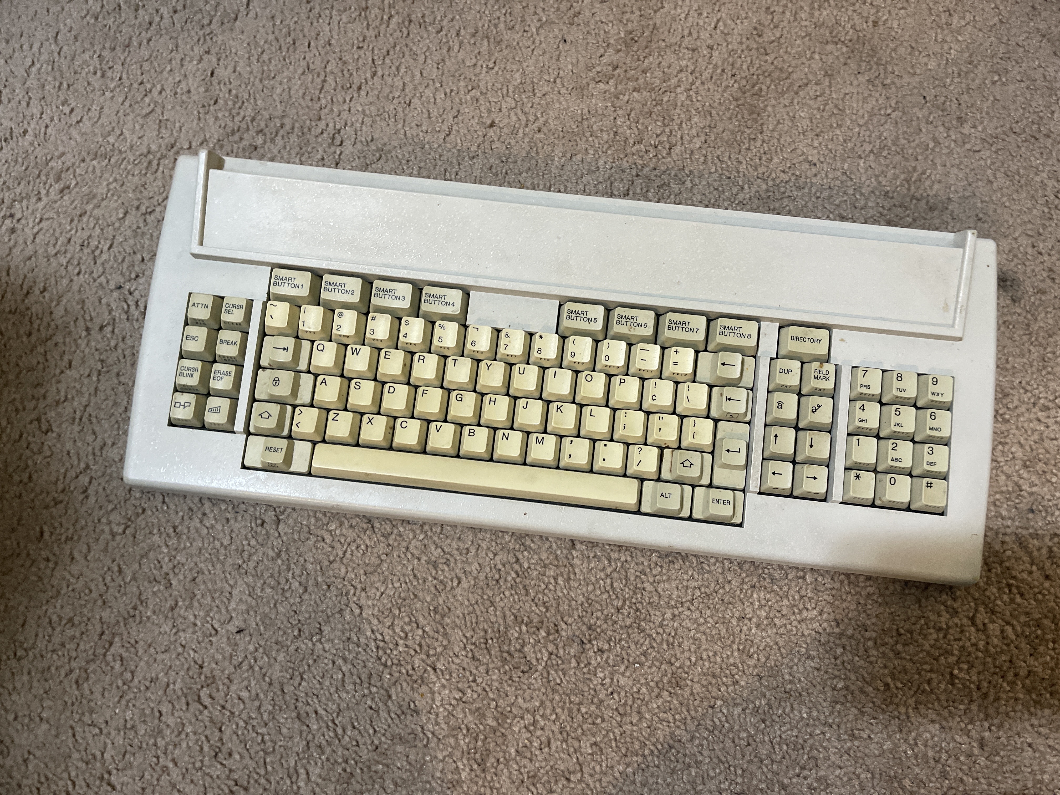

Hi y'all!

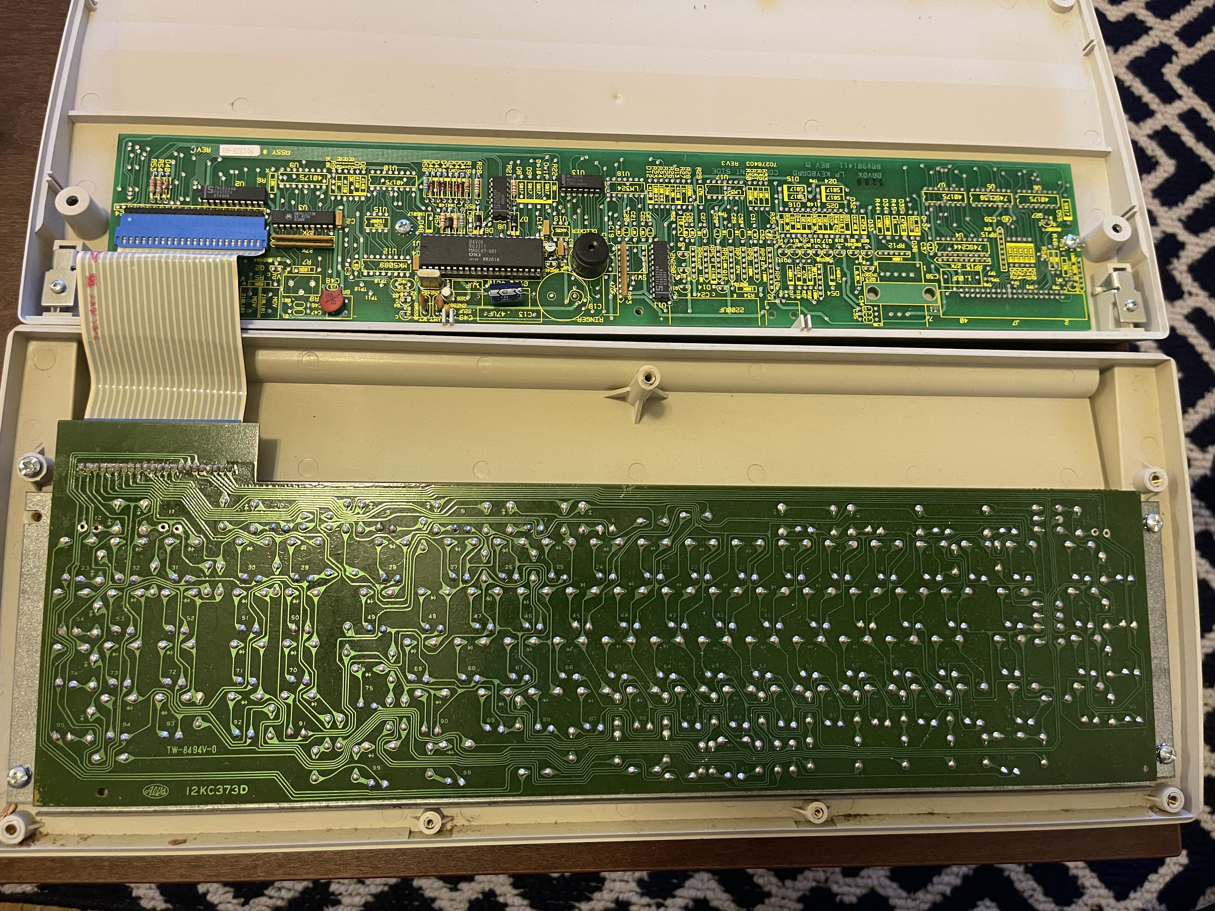

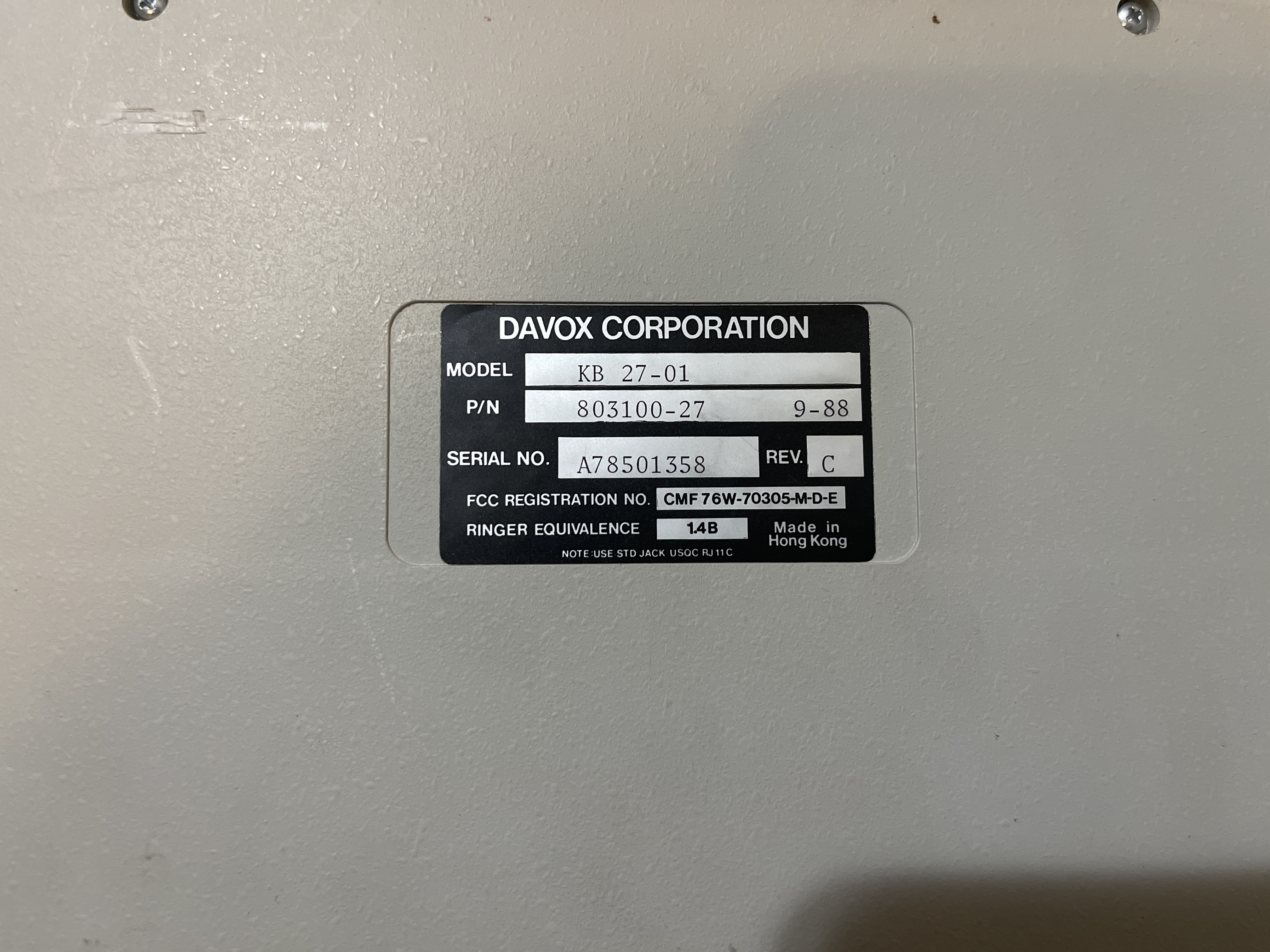

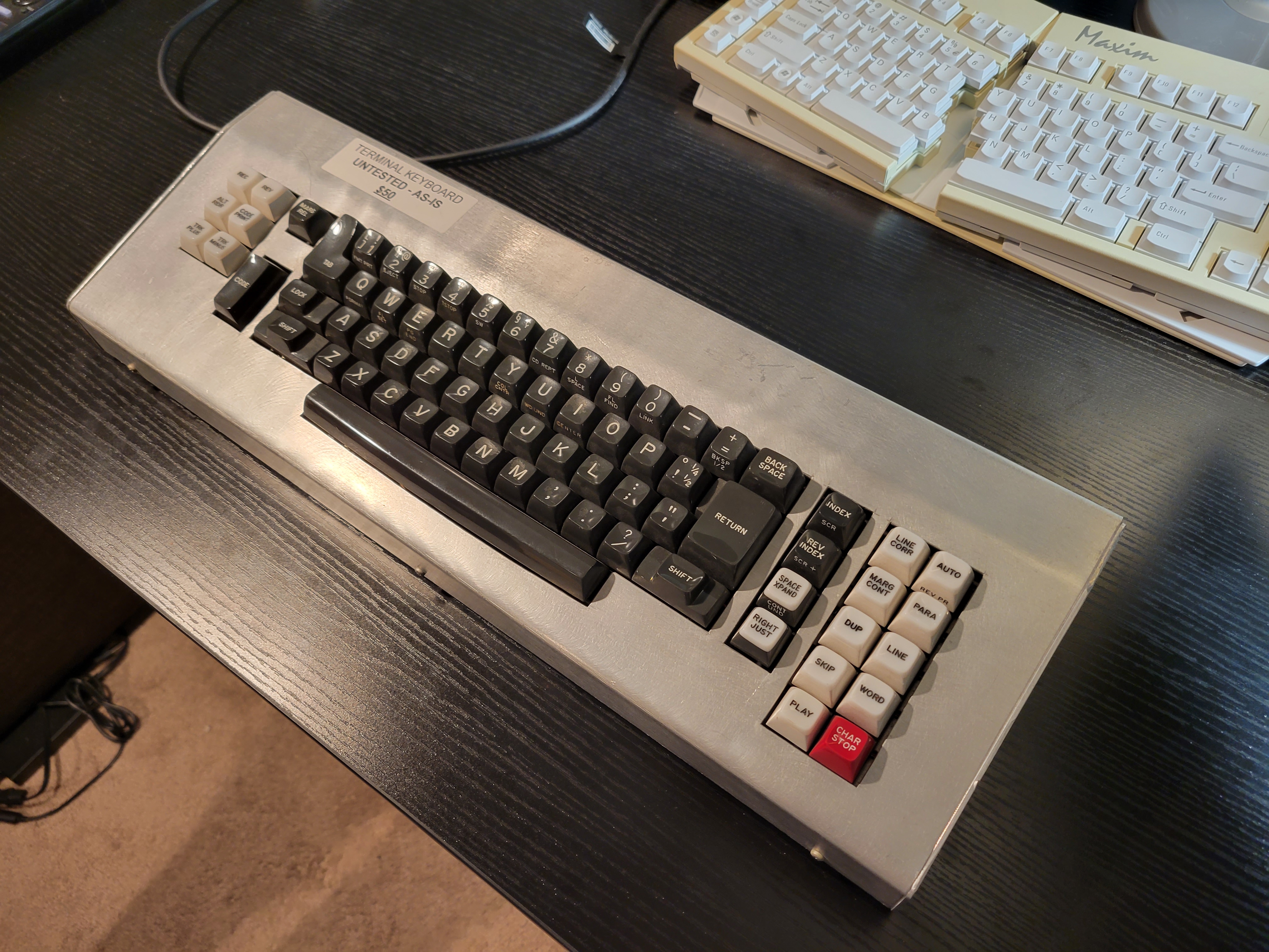

I found an interesting terminal keyboard at Computer Reset, and I was wondering if y'all might know anything about it. I've Googled pretty much every number on it to no avail. If anyone knows what system this goes with, what protocol it may use to communicate with that system, or any information in general, I'd be very appreciative of it.
What I do know is that it's a terminal keyboard, it has a jack where an Ethernet cable can be plugged in, it uses Alps switches, and I have another just like it that has a phone slot built into it. /u/tachoknight on Reddit kindly added that it looks like it would go with some sort of IBM 3270 clone (if those even existed).
Front of keyboard:
Label on back:
Inside of keyboard:
Thank you in advance!
08 Dec 2021, 09:31
Alps PCB is a good sign. Pulled a keycap to see what switches it has?
The layout looks to be compatible with IBM’s 3270 terminal family. The original keyboards were beamsprings, like my 3276:
viewtopic.php?p=494767#p494767
Your keyboard may well be a third party part for a compatible system. That’s not great news for conversion to USB, but your photo showing the ribbon connector is more promising. Looks like you have the whole matrix exposed to you right there. Could be an easy Teensy job to bring this one back to the land of the living. (My beamspring took a lot more doing.)

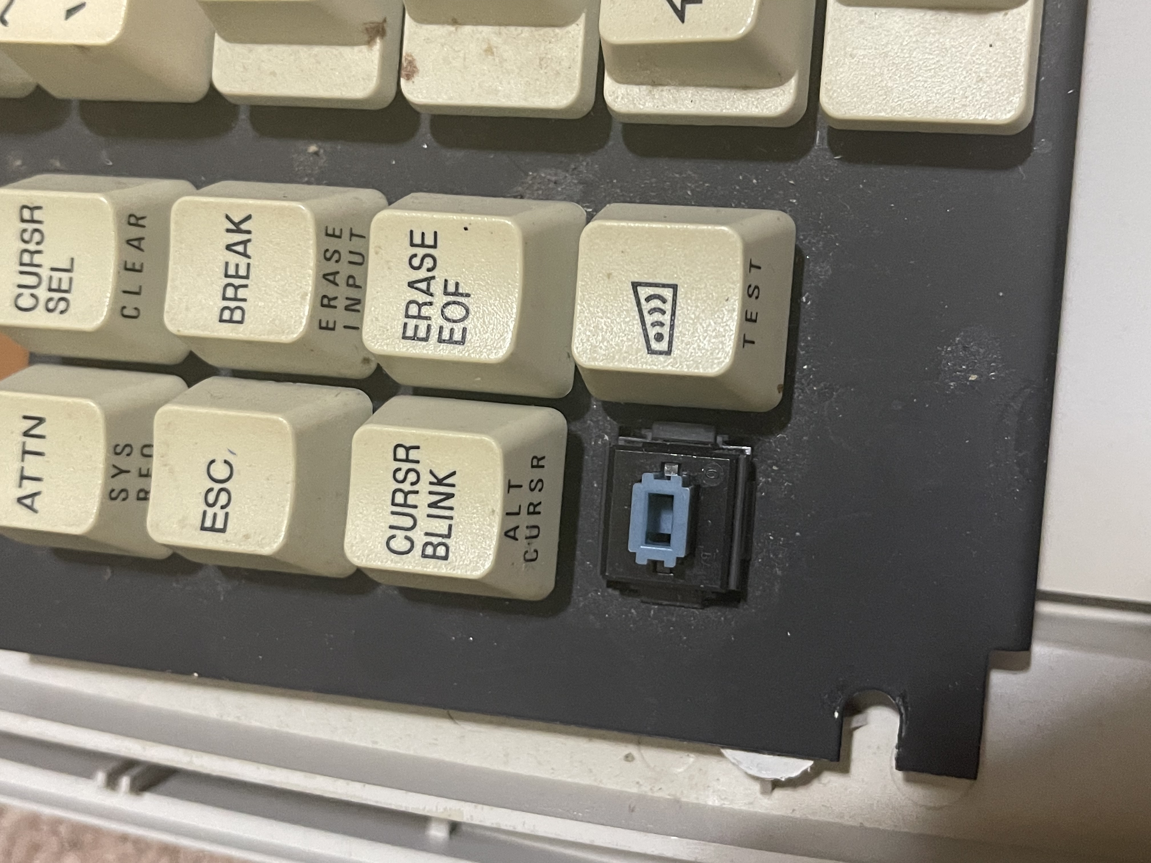

Gogogoluke
08 Dec 2021, 10:12
I got a keycap off and it appears to be Alps blue, but I'm not super familiar with Alps:
Additionally, upon closer inspection of the Alps PCB, it appears you are right about the ribbon. The traces appear to just be a grid directly connected to the traces. Thank you so much for the pointers! Hopefully now this thread returns Google results for anyone else looking to identify their Davox KB 27-01.
08 Dec 2021, 10:19
Blue Alps? Nice find! They are magnificent! Easily my favourite of the whole Alps world. Brilliantly clicky. This should be an epic board with a little controller upgrade. Well done!
All you need to do is pull the ribbon off the original 3270 controller and hook up your own. Nowadays, everyone uses an open source project called QMK for that. I’m old fashioned and tend to go the simpler route: Soarer’s Controller. (If you’re on Mac I also made 64 bit tools for it.) Anyway, you really can’t go wrong. A good authentic Alps PCB and switches mean you can expect excellent results.

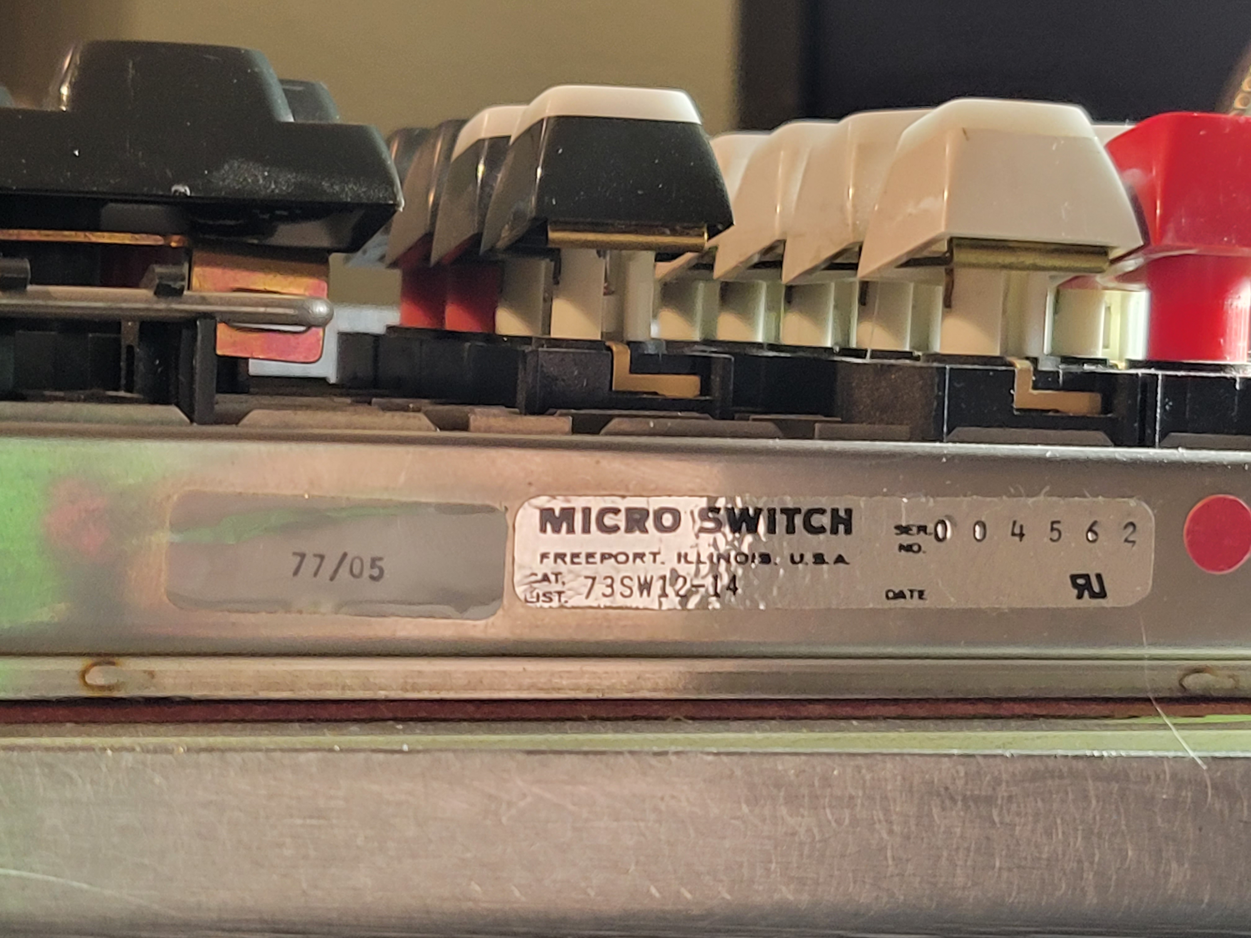

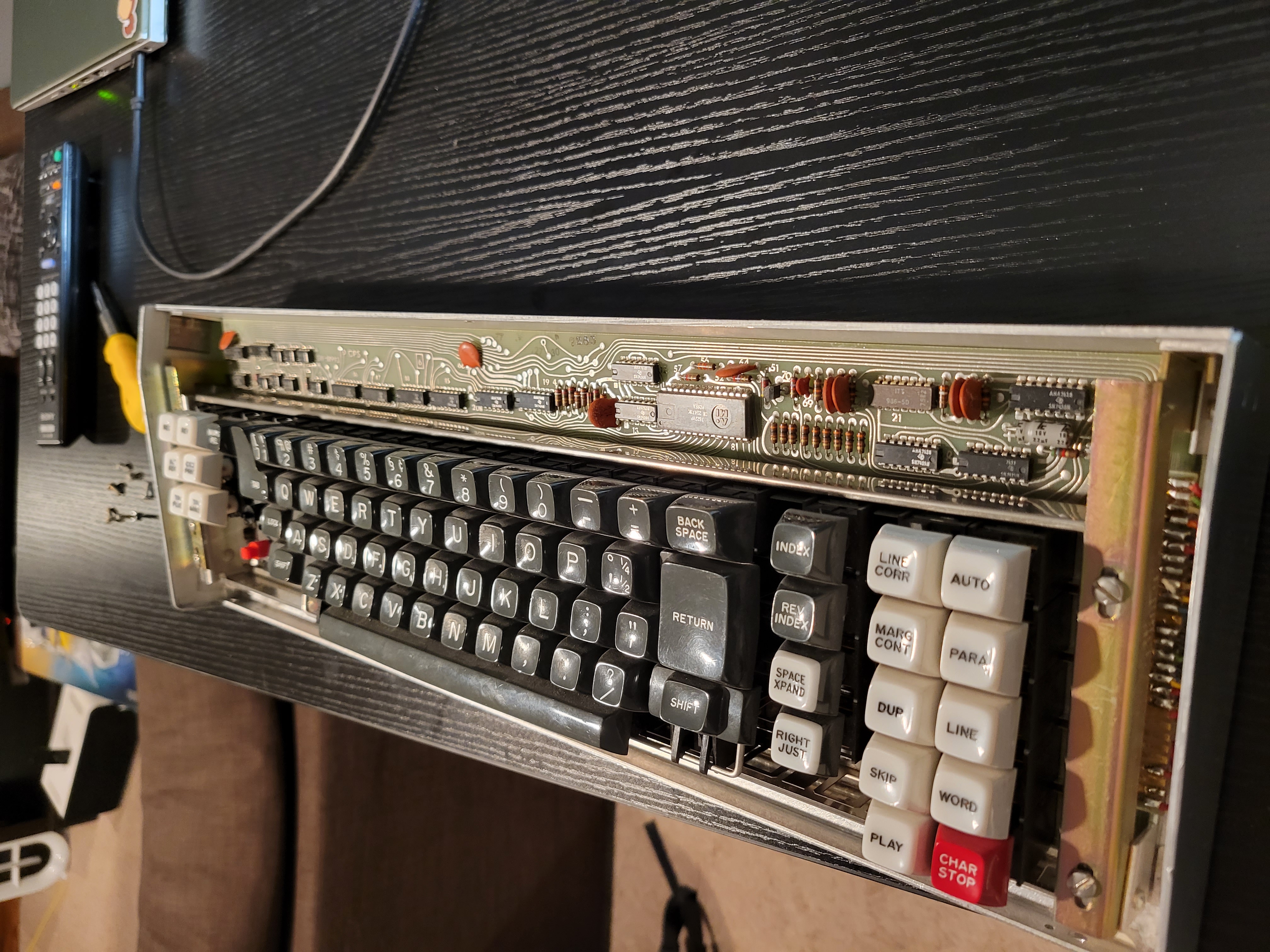

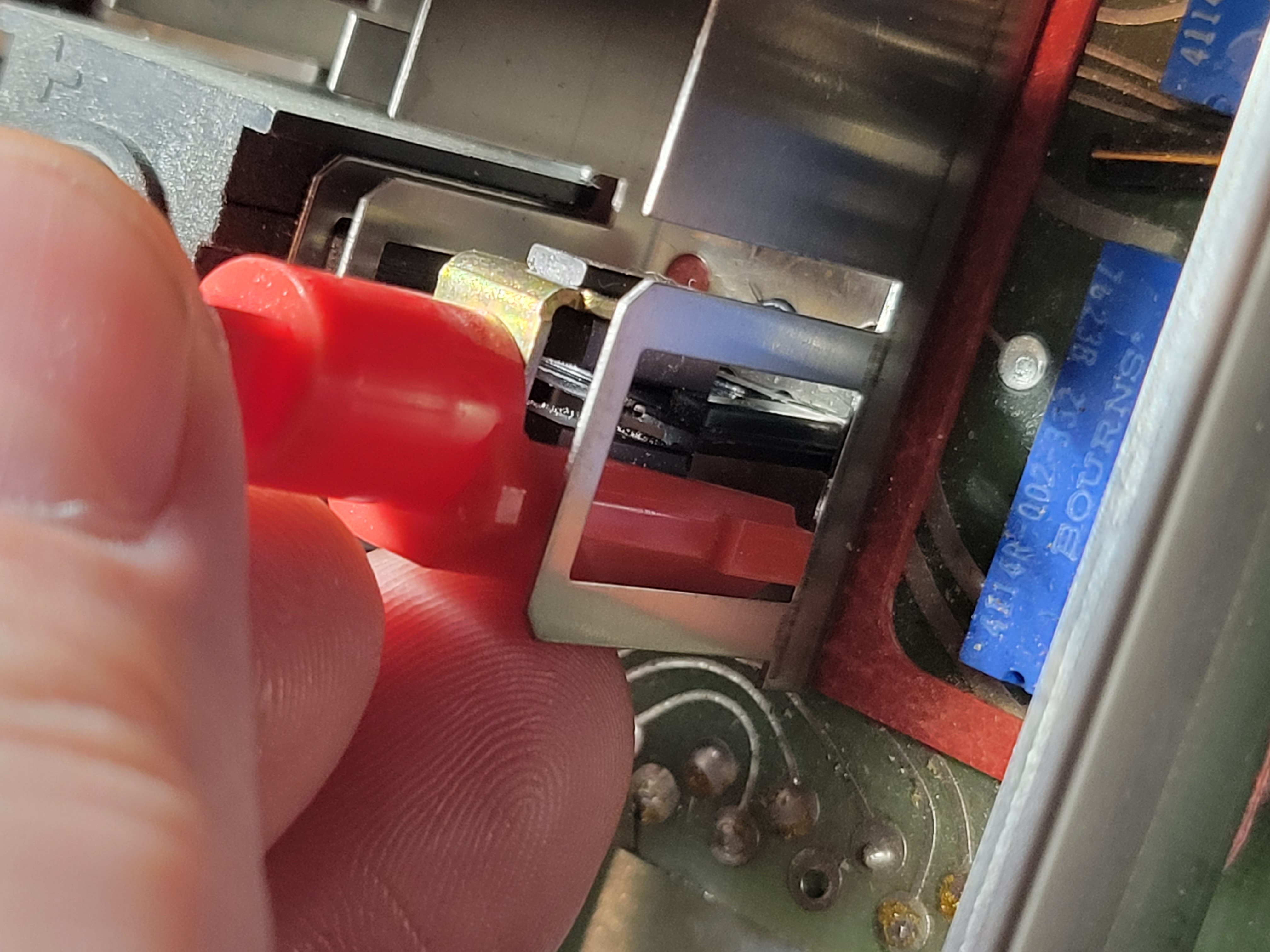

I've picked up this Micro Switch Hall Effect 73SW12-14 from what looks like 1977, super out of my wheelhouse but very interesting. Someone did the work of soldering a dsub to the edge connector and building a case. It's rad but what is it, and could I ever figure out how to tinsy it to a modern machine?
*Edit* very neat thread over here I'll keep reading on viewtopic.php?f=7&t=12379

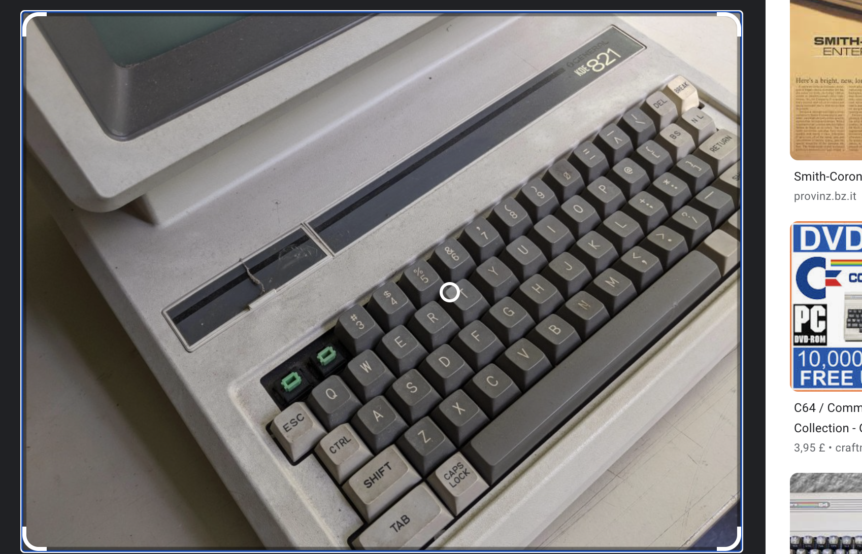

Lalaland124
16 Jan 2022, 01:17
Does anyone know where this image comes from? Can't seem to find the laptop
hellothere
16 Jan 2022, 17:09
Sure it's a laptop? Looks more like a terminal, to me.

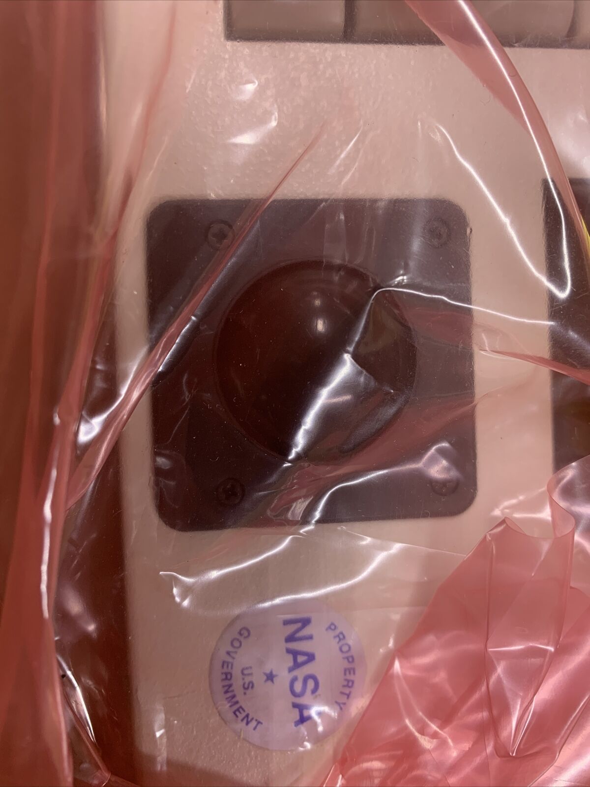

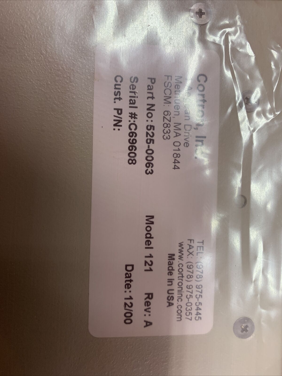

I know what keyboard this is, it is a Cortron model 121. The question is, what kind of switches does it use? Its and older model, made in 2000 if i am not mistaken.
Please dont say foam on foil or rubber domes :cry:
s-l1600 (1).jpg (173.42 KiB) Viewed 10086 times
hellothere
16 Jan 2022, 17:57
From https://web.archive.org/web/20021206183 ... SO_121.htm (2002 - 2014)
"Full-travel, solid state switches"
The Model 121 is still in production and one version of it looks an awful lot like yours.
Geekhack says it's either "rubber dome with lip-seal or hall effect." Sorry. I did say one of the things you asked not for me to say. I didn't say , though.
thor435
16 Jan 2022, 18:10
Thanks for the info, I found some info on the ones that still are produced but it did not look exactly like this.
I am hoping its good whatever it is. Its coming in the mail, so i will find out eventually. Anyway it got a cool sticker on it tough. ;)

jsheradin
16 Jan 2022, 22:05
thor435 wrote: 16 Jan 2022, 18:10 Thanks for the info, I found some info on the ones that still are produced but it did not look exactly like this.
I'd bet it's the same as the wiki/Cortron_80-604 given the environmental ratings.
There are some very similar ones with rubber domes and ITW mag valves though so you might get lucky.
