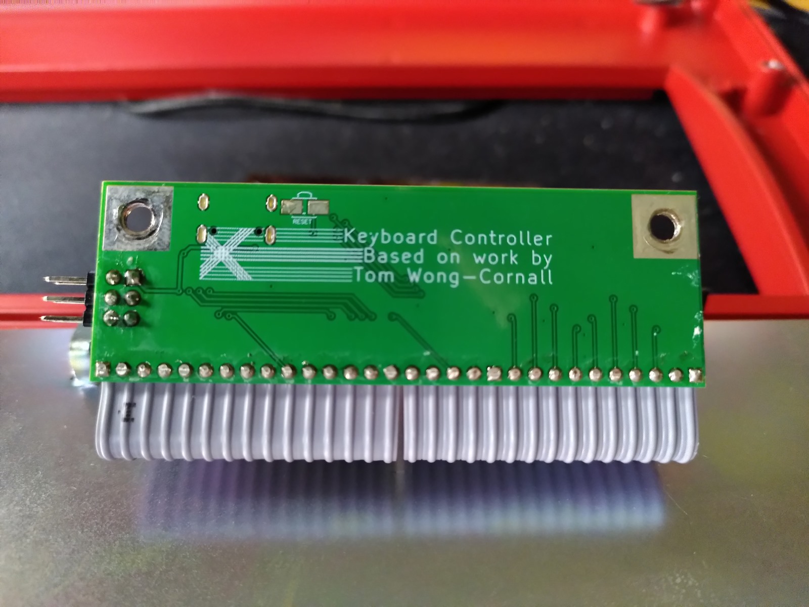

Takashi
19 Aug 2022, 22:46
Hey! While trying to figure out why my computer doesn't like the keyboard from time to time i did a firmware write using Atmel Flip with the file "Via F77 - ANSI-ISO - PrintScr.hex". Now I can't in any way manage to get the keyboard to get into bootloader mode, so I can't reprogram it. I should note that I didn't use the pandrew utility to do a EEPROM erase before I loaded the above file using ATMEL FLIP, maybe that screwed something up?
I remember the FN key default being bound to the lower right CTRL, though if I press lower-right CTRL+SPACEBAR+R, it doesn't enter boot loader mode. Tested leftshift+rightshift+b as well, to no avail.
Any ideas what I can do? Is there any other way to enter boot loader mode so that I can just do a clean eeprom-flash?
sedevidi
20 Aug 2022, 09:05
Takashi wrote: 19 Aug 2022, 22:46 Any ideas what I can do? Is there any other way to enter boot loader mode so that I can just do a clean eeprom-flash?
You can always open the keyboard and short the "reset" pads at "the correct time" (during power-up).
Or there can be a utility to switch it to bootloader mode on the fly.
Takashi
20 Aug 2022, 10:12
sedevidi wrote: 20 Aug 2022, 09:05
Do you know the name of this utility?
I opened the keyboard, and though I didn't find any reset pads, I found the PROG-pads. I followed this manual: https://www.modelfkeyboards.com/manual/
It says you should short the PROG pads and not any reset-pads.
I've tried this for over half an hour now, and it still doesn't enter boot loader mode.
What I do is:
- Short the pads with a tweezer (while keyboard is unplugged)
- Plug the USB-cable in
- Remove the tweezers (here I've tested to do it for various times, from instant to waiting a few seconds).
The keyboard doesn't go into boot-loader mode but it's still a normal keyboard in Windows.
Any suggestions?

Takashi
20 Aug 2022, 10:58
Keyboard is in bootloader mode! You REALLY need to apply force with the tweezers on the pads for it to work.
The good news is that it doesn't seem to matter how much time it goes before removing the tweezers. What I did was:
- unplug keyboard
- Short-circuit the pads (uzing tweezers with quite a lot of force)
- Plug the keyboard in
- Wait for 1-2 seconds
Then it went to bootloader mode.
Thank you all!
Takashi
20 Aug 2022, 11:20
I still have the problem with that I have to unplug and plug in the keyboard though, but maybe it's simply something with the combination of my motherboard. I'll upgrade my system in christmas anyway, so I hope the problem dissapears then.
