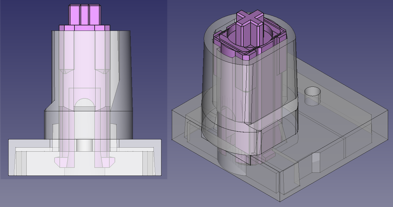

Something I've noticed about your design here: By thinning the edge of the barrel so much, you seem to be leaving about 0.1-0.2mm thick of plastic in between the outsides and the notch of the keycap. With a bit of wiggle, it might be able to tear through that thin sheet of plastic. It also seems incredibly difficult to 3D Print without some kind of 0.2mm nozzle or a resin printer. I don't think you can "square" it up so much with how thin you left it. Seems like its a circle shape for a reason.DMA wrote: 18 May 2023, 06:23 Wasn't easy, but here it is - 19x19mm, MX-mount, LED-enabled, original stem- and flipper-compatible buckling spring assembly, free of that pesky "spring doesn't buckle and requires reseating" bug.

yeah, because nothing is touching the barrel there, wiggle or no wiggle. I'm pretty sure every part that touches anything (temporarily or not) is at least 0.5mm thick - but I'll check.Liamkrum wrote: 05 Jul 2023, 06:31 Something I've noticed about your design here: By thinning the edge of the barrel so much, you seem to be leaving about 0.1-0.2mm thick of plastic in between the outsides and the notch of the keycap. With a bit of wiggle, it might be able to tear through that thin sheet of plastic.
It will indeed be stupid to use 3d printer for that - but it won't be used, those parts are designed to be injection-molded.Liamkrum wrote: 05 Jul 2023, 06:31 It also seems incredibly difficult to 3D Print without some kind of 0.2mm nozzle or a resin printer.

Hmm, looking at the file you sent, the edge seems really thin (definitely less than half). I measured the edge of a barrel I have lying around at 1mm, so considering that the wall hardly seems like a few pixels in your screenshot, I wouldn't have much faith in the durability of this if you wiggle the cap a bit too hard to the side. Those "holes" seem like a non issue, but a cap that is sideways could easily get stuck in these created "holes". Not a manufacturing or plastics expert though, if someone is here, feel free to weigh in.DMA wrote: 05 Jul 2023, 06:57Something I've noticed about your design here: By thinning the edge of the barrel so much, you seem to be leaving about 0.1-0.2mm thick of plastic in between the outsides and the notch of the keycap. With a bit of wiggle, it might be able to tear through that thin sheet of plastic.
Makes sense. Although is it possible to mould a wall that thin? With a quick google search, it doesn't seem like you want any part thinner than 1mm.Liamkrum wrote: 05 Jul 2023, 06:31 It also seems incredibly difficult to 3D Print without some kind of 0.2mm nozzle or a resin printer.
Makes me wonder why the designers made it a circle... I guess it just adds on to the point that those mould makers really were showing off lol.

again, you literally can't wiggle anything to contact that part.Liamkrum wrote: 05 Jul 2023, 08:25 Hmm, looking at the file you sent, the edge seems really thin (definitely less than half). I measured the edge of a barrel I have lying around at 1mm, so considering that the wall hardly seems like a few pixels in your screenshot, I wouldn't have much faith in the durability of this if you wiggle the cap a bit too hard to the side. Those "holes" seem like a non issue, but a cap that is sideways could easily get stuck in these created "holes". Not a manufacturing or plastics expert though, if someone is here, feel free to weigh in.
Yes, it's 0.15mm thick in lowest 1.7mm - but I fail to see how it matters. That part can be easily made thicker - it's below the LEDs anyway - I just don't really see why.
I've seen a lot of plastic parts thinner than that (in their thinnest part). You also can do that, if you just look around instead of google searches.Liamkrum wrote: 05 Jul 2023, 08:25 Makes sense. Although is it possible to mould a wall that thin? With a quick google search, it doesn't seem like you want any part thinner than 1mm.

..easy change tho:
I needed to round the sharp corners anyway to encheapen the CNC-machining both the mold and the top plate.
