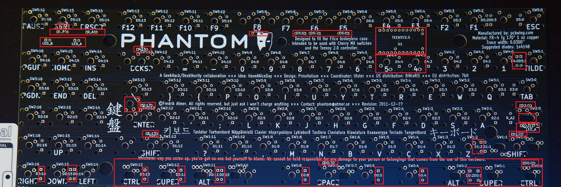

While there may not be soldering pads at other locations, conceivably, I could just run wiring to them, right? Not sure how feasible that is for more than a couple of switches, but it shouldn't be impossible. Maybe glue a little pad down there or something.
litster
27 Jan 2012, 23:26
Here is picture of the backside of the PCB, with interesting areas highlighted. I also highlighted diode locations that are no the same as the majority ones. Need to make sure your diodes are at the right polarity. Check it out.
