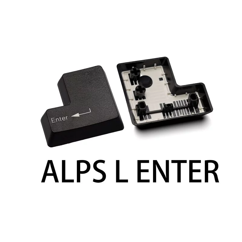

I am also puzzled with regards the vertical orientation of the BAE key switch and stabilizer and why no slider guide was provided for the thinner diameter pin. Anyway, the BAE key works with no issues as it is now and maybe a slider guide is really not necessary. Of course I would like to also have the slider guide for completeness sake but I don't think something like that can be found easily.Polecat wrote: 19 Jan 2024, 05:02 Thank you for the information on the stabilizers. Early Focus (and Northgate) keyboards had a BAE key with a horizontal Alps-style (rectangular inserts) stabilizer wire, and a guide pin on the upper part of the key. Later Focus (but not Northgate) keyboards had two stabilizer wires on the BAE--one vertical, and one horizontal, and no guide pin. That change was sometime between 1989 and 1991. I've never seen a BAE like yours on any other keyboard.
The early Focus and Northgate keyboards used a Cherry style stabilizer on the spacebar like yours, but that was changed to an Alps style setup around 1988-1989. As much as we want this stuff to be simple, it just isn't the case.
If it helps, Tai Hao sells an Alps style stabilizer kit for a very reasonable price, and their customer service is absolutely first class.
Pictures of keyboards with the horizontally oriented BAE key switch mostly show a bigger diameter pin under the BAE keycap and are also provided with a slider guide snapped in to the switch plate. It looks like the slider guide is necessary in this case as the pin is at the unsupported wider end part of the BAE keycap..
I also have not come across a picture of a keyboard with vertical oriented BAE keyswitch, but have seen some for ISO Enter keyswitch. This is why I thought Tai-Hao was meaning to issue this keyboard design in ISO layout. However, the fixed location of the keyswitch holes for the shortened Right Shift key and the Backslash key seems to not support this idea. It will require a revised steel switchplate and PCB to support proper keyswitch location for a 2.25u ISO style Right Shift key. So it seems this keyboard was intentionally designed to support a Focus layout.
Thanks for the info about Tai-Hao Alps style stabilizer kit.

The snap-in guide pin socket in your Focus FK-2001 and the Omnikey 102 appears to be the same size as the bigger diameter guide pin from the pictures here: viewtopic.php?f=62&t=13709 and here viewtopic.php?f=45&t=13609
For comparison here is the picture of the guide pin of the vertically oriented BAE key in my keyboard:

Looking at your photos I'm wondering if a guide post socket would be too tall to work with your BAE key? Those stick up fairly high from the plate, and there might not be clearance on the keycap for it to work.
I just measured some guide posts. These were done with cheap digitital calipers, so not intended as a precision spec to be used for anything more than a quick comparison.
Early Focus FK-2001 BAE key = 0.22 inch (5.6mm)
Early Focus FK-2001 Spacebar = 0.14 inch (3.7mm)
Avant Stellar BAE key = 0.21 inch (5.3mm)
Costar CSK-2101 (Alps) BAE key = 0.18 inch (4.5mm)
I also found an unidentified Alps BAE key with two stabilizer wires (no guide pin), with one set of inserts rectangular Alps style and the other set MX cross mount. I'm thinking it's from a later (Windows keys) FK-2001, but that's not confirmed yet.

There is enough vertical clearance as the guide post on the BAE keycap sits at the same level as the Alps keycap insert that mates to the Alps switch slider. As I see it, as long as the top of the guide post socket is at a level a litlle below the top housing of the Alps switch, it should be fine. The only relevant differences between the horizontal and my particular vertical oriented BAE key are the diameter of the keycap guide posts and their location.Polecat wrote: 21 Jan 2024, 02:06 Looking at your photos I'm wondering if a guide post socket would be too tall to work with your BAE key? Those stick up fairly high from the plate, and there might not be clearance on the keycap for it to work.
The smaller diameter of my BAE keycap guide post is likely very close if not exactly the same as your measured diameter of the early Focus FK-2001 Spacebar. Here is a picture in which both the Spacebar and the BAE key guide post can be seen, the Spacebar by the way is also not provided by Tai-Hao with a guide post socket:
The Chicony 5161A keyboard comes with Alps BAE key with two stabilizer wires and no guide pin.

Thanks, it's easier to see in that photo. I haven't seen a guide for the smaller pin that snaps into an Alps switch opening, but there may be one out there.
The Cherry style stabilizers keep the spacebar from rotating, so a guide post isn't needed. On Focus and Northgate keyboards the spacebar guide post was added when the stabilizer was switched froim Cherry to Alps style. That was around mid-1988. Apparently Tai Hao made the spacebar to work with both types of stabilizer.
I've seen the dual wire stabilizers on BAE caps on later Focus (but not Northgate) and also Monterey and some Datacomp keyboards. The Focus (?) one I just dug out is unusual because the two sets of inserts don't match.
edit: I just checked Tai Hao's website, and their Alps BAE key (which they sell separately) also has the mismatched stabilizer inserts. <attached>

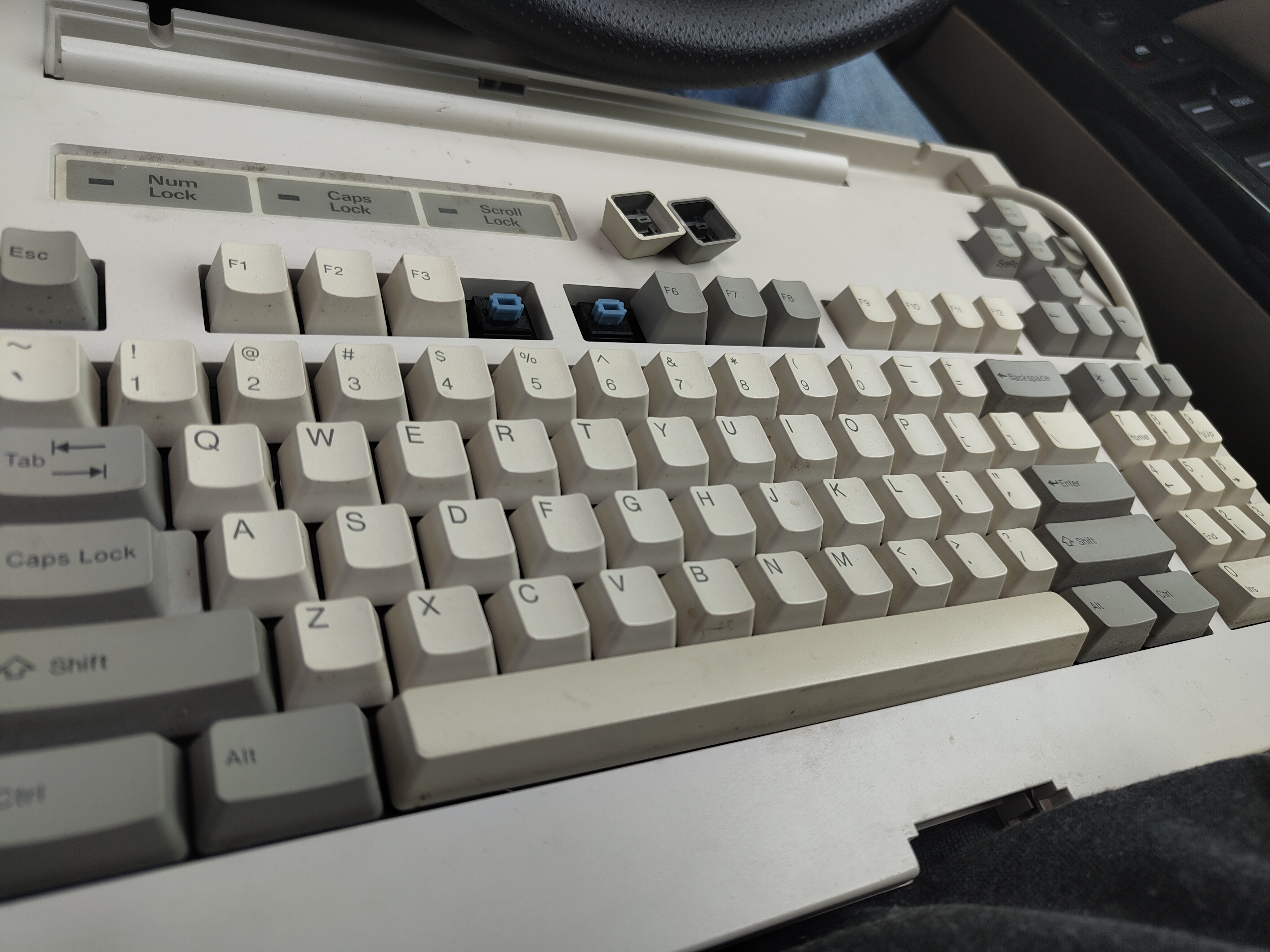

Finally got some 8/10 blue alps recently after years of hunting them down. Barely paid anything for them!
I can definitely see where the hype comes from. Granted, white alps are still amazing when clean, but there's just something about the blues that draws me back to them. I think a lot of it is the sound.

I finally got to try out some blue alps, and though they were far from pristine within a few seconds i was just like oh... I get it now.

I also finally acquired some Blue Alps today for a non extortionate price. It was known that the NEC PowerMate Portable had them, but this was a later revision of that model, I took a chance on it...
I have used White Dampened, Salmon, Orange, Ivory Dampened, Yellow, Green, and Black Alps. Not to mention many clones, "compatibles" and Matias switches (which I daily drive.)
But in my life I have never typed on such a satisfying switch as this.
The hype was real.
This is a good day.

Yeh white/cream with grey legends, very nice.
Plus I have a monochrome DOS 286 to play around with now.

The AT101W is an excellent chasis, I have one that I transplanted blue ALPS into and it is a joy to use.
The black variant of AT101W is much harder to find and looks much more contemporary.
- flowerlandfilms
- Location: Australia
- Main keyboard: Silicon Graphics AT-101
- Main mouse: Logitech MX Vertical
- Favorite switch: the on/off switch
I grabbed one.fohat wrote: 18 Nov 2024, 15:31 The AT101W is an excellent chasis, I have one that I transplanted blue ALPS into and it is a joy to use.

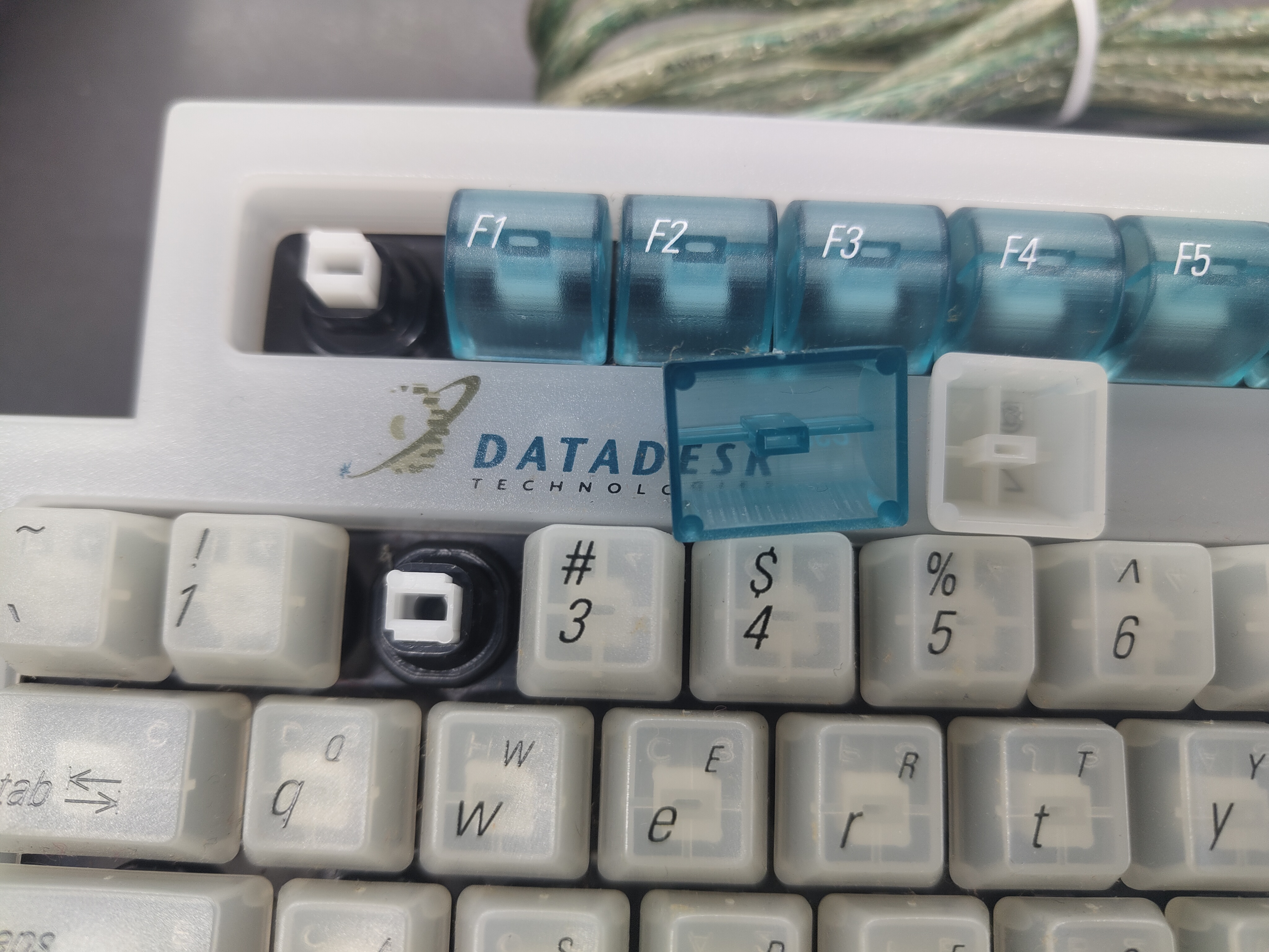

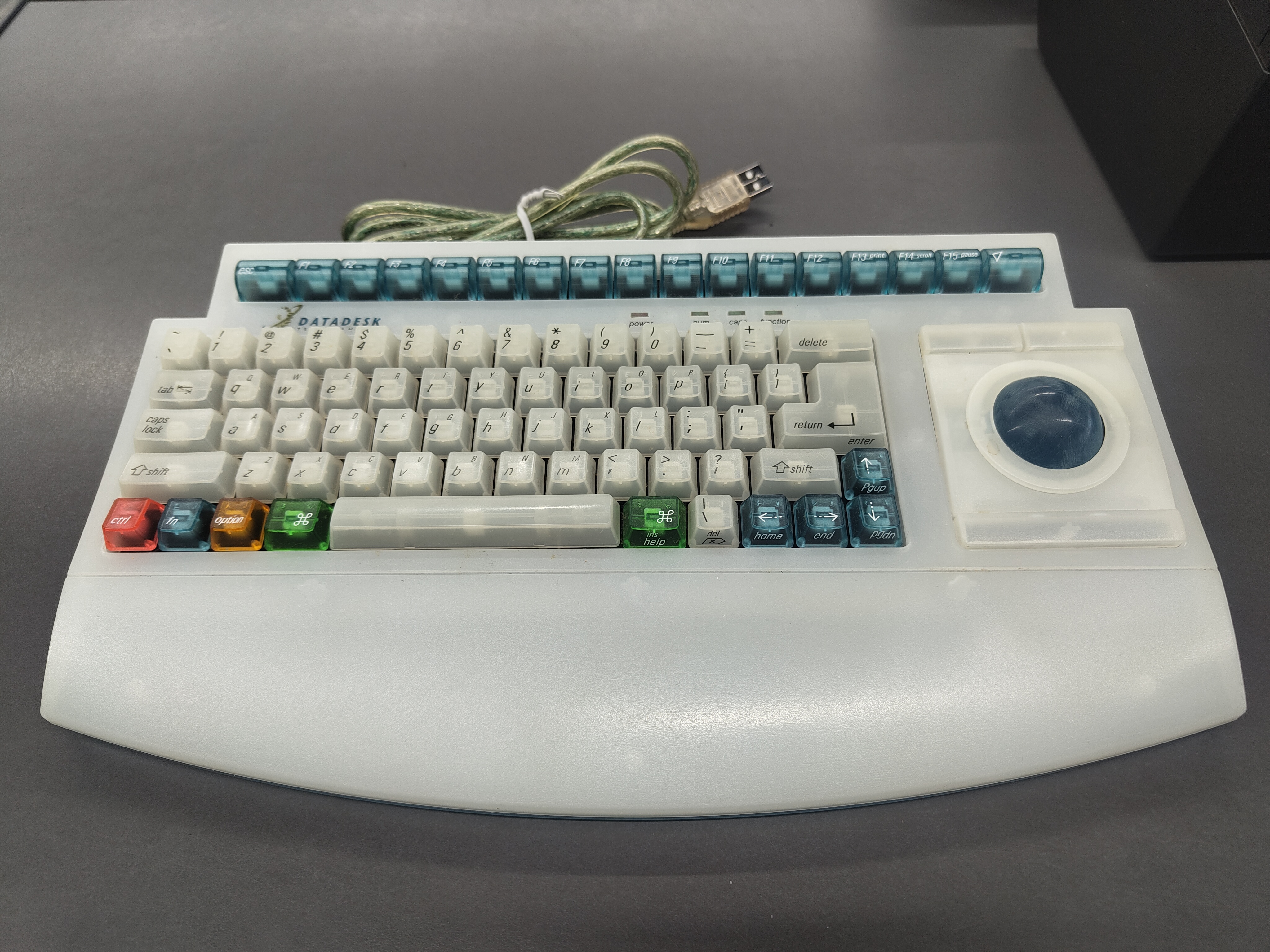

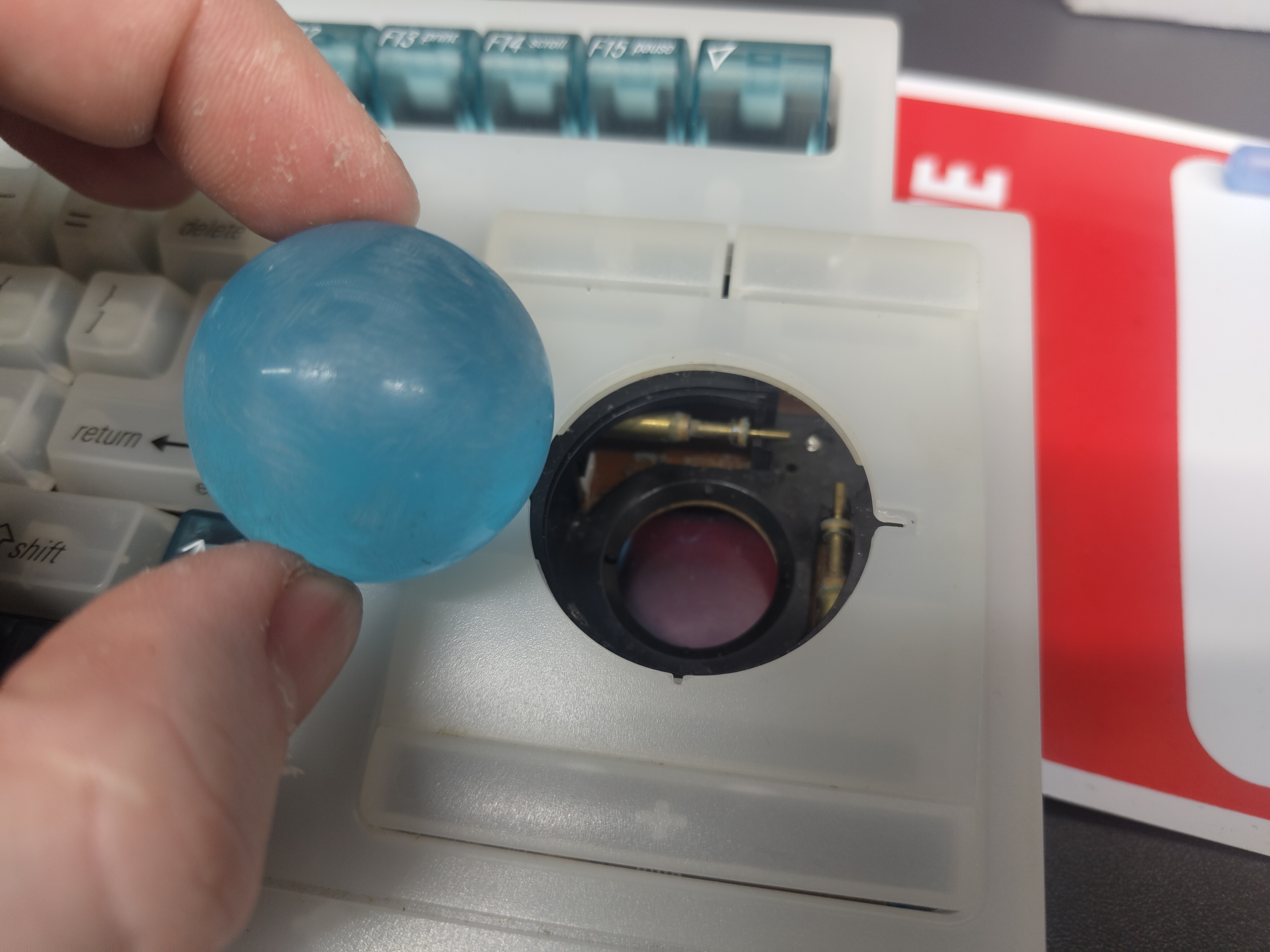

Picked up this wacky contraption.
Alps mount tiny keycaps on a dome and slider.
The translucent trackball which was one of the main attractions for me is unfortunately scuffed due to the rubber on the rollers having disintegrated years ago. I'll have to find a way to polish it.

This would be amazing converted to a mechanical. Imagine a custom PCB with Matias's switches and lighting too!
- flowerlandfilms
It would, but due to the tiny keycaps if you put proper switches in it the spacing between them would be larger and the effect would be quite strange. Would be fun to add a tiny T-NAV to a board that doesn't have it though.SK-8K wrote: 22 Nov 2024, 14:21This would be amazing converted to a mechanical. Imagine a custom PCB with Matias's switches and lighting too!

thats really coolflowerlandfilms wrote: 22 Nov 2024, 04:29 Picked up this wacky contraption.
