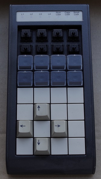

I would suggest something like this:
Tipro for Cindy.jpg (110.62 KiB) Viewed 14366 times
It is a fully programmable Tipro board (this model has an own controller), so that cursor keys could be arranged in any desired way with blanking tops between them.
It has black MX switches, so it would have to be populated with blue switches (which implies soldering because the switches are plate-mounted).
I would be happy to contribute the board and a switch donor board if someone is ready to do the soldering job.

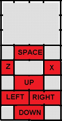

A possible layout (already sent to Cindy per PM):
8x4 layout.jpg (63.08 KiB) Viewed 14203 times

Jim likes this but he is asking if the z and x can also be 2u?
29 Oct 2015, 18:04
We can do that!

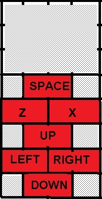

29 Oct 2015, 18:16
This?
8x4 layout.jpg (57.75 KiB) Viewed 14192 times
elecplus
29 Oct 2015, 18:39
Yes :-) He says that is super, and thanks you so very much!

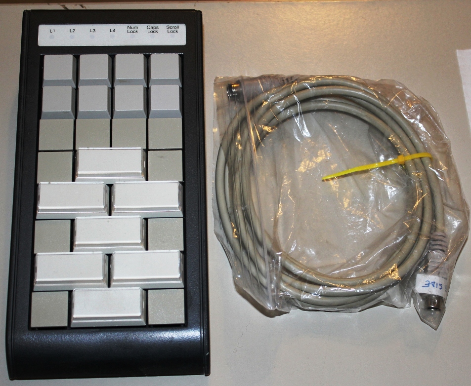

03 Jan 2016, 01:37
8:30 on a Saturday morning, and the postman is banging insistently on our door. It is 38 degrees and raining; a miserable day. The postman banging on the door is even more unusual. Usually he just leaves a pile on the doorstep, if it won't fit in the box. His mission: to deliver a box from Greece. It is addressed to me, but Jim knows it is coming, so he opens it. He is delighted! Thanks so much for all your efforts!
