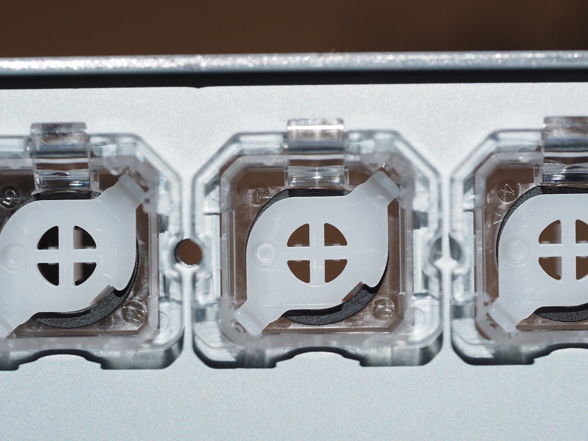

Another thing that is different and new for Topre is that the switch housings are translucent to allow the RGB backlighting to shine through. This seems to go along with Topre’s apparent decision to go maximum-bling and impact with the white backplate to enhance the lighting effect. If they were going for understated then they might have added LED windows to the standard black switch housing, but that’s probably more complex to produce than simply choosing clear plastic – I don’t know.

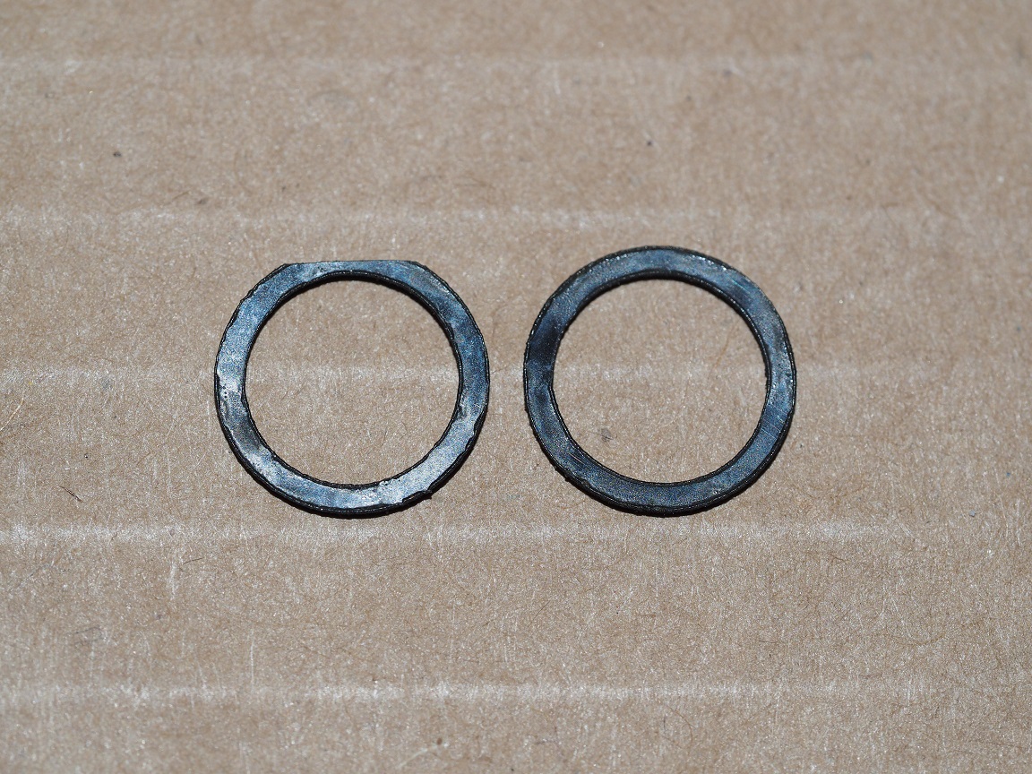

Regarding silencing rings, did you use the ones that I am selling or something else? My wife got a message from someone today saying that our rings did not fit the sliders on the RGB Topre board. I do not have one of these boards as yet, so I have not been able to test the rings on it myself.
Oops! I just spotted your other post saying that you harvested the rings from a Noppoo keyboard. Looks like I will need to get a Topre RGB for a tear-down. However, if the RGB sliders require a different ring from those used on conventional Topre sliders, I might not be able to supply them, as the cost for producing what I imagine will be a small subset of a special size would be prohibitive.
If anyone has an extra RGB slider to sell, please let me know. Alternatively, if someone would care to do very careful measurements of the inner and outer diameters that would be required for silencing rings on these sliders, I would be grateful to receive the dimensions.

I recently installed your hypersphere rings on a Realforce RGB and as far as I could tell they fit perfectly. Keyboard feels great afterwards too. Also put Leopold PBT keycaps on it. Sounds and feels great.
zslane
11 Jan 2017, 19:09
I put your silencing rings on my second RealForce RGB board and they work just fine. They don't fit as tightly around the sliders as the tiny bands that came from my Noppoo do (or the ones that come with the sliders from AliExpress), but I haven't experienced any issues with them.
Hypersphere
12 Jan 2017, 00:05
@ahjkldfghs and @zslane:
It is good to know that the Hypersphere Rings apparently work on the sliders in the Topre RF RGB keyboard.
However, the fellow who sent us a message through eBay said that he needed to cut a slice off one side of each ring to prevent it from causing the slider to bind.
He has also posted his mod on GH:
https://geekhack.org/index.php?topic=86901.0
And there are more of his pics on Imgur:
http://imgur.com/a/jJqfw
It looks as though Topre redesigned the slider not only to enable Cherry mx caps to be used but also to make room for the LED on each switch.
It would probably be cost-prohibitive for me to make separate batches of rings for the RGB RF board unless Topre decides to retool and make these new sliders the default for all future Topre-switch boards. Therefore, it is good to know that this mod is something relatively simple that would be easy for the end-user to perform on the standard-issue Silencing Rings.
