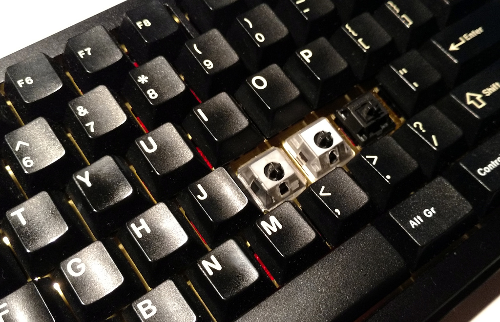

I have one of GMKs new plate-mount silencing clips on hand as well as the ZealPC ones.
So I decided do do a short comparison.
Just from picking them up for the first time you will notice that the dampening inlay on the QMX top is much softer. Also they decided to cut the corners a little to make it a bit easier to clip them on an off. That's a welcome addition to the design.
I didn't try them on a whole board or for a longer time, my setup was just one each on my regular keyboard.
On the left you can see the QMX, Zeal middle and of course the regular switch for the undampened comparison.
Dampening the switch stem is always a trade-off between switch feel and sound. The GMK clips manage to be a lot more silent, but of course this comes at the price of a bit softer bottom out.
In fact the silencing is so complete that I only now noticed how this k key sounds a bit more scratchy than the others. Might be the spring.
So yeah, turns out it really depends on how much silencing you need or are comfortable with. The Zeal clips retain a lot of switch sound whereas QMX is really quiet.
I also think the QMX feels a bit softer on the bottom out. I really should have tested this without hearing the switches though. Sound is such an important part in how you perceive the switch feel.
