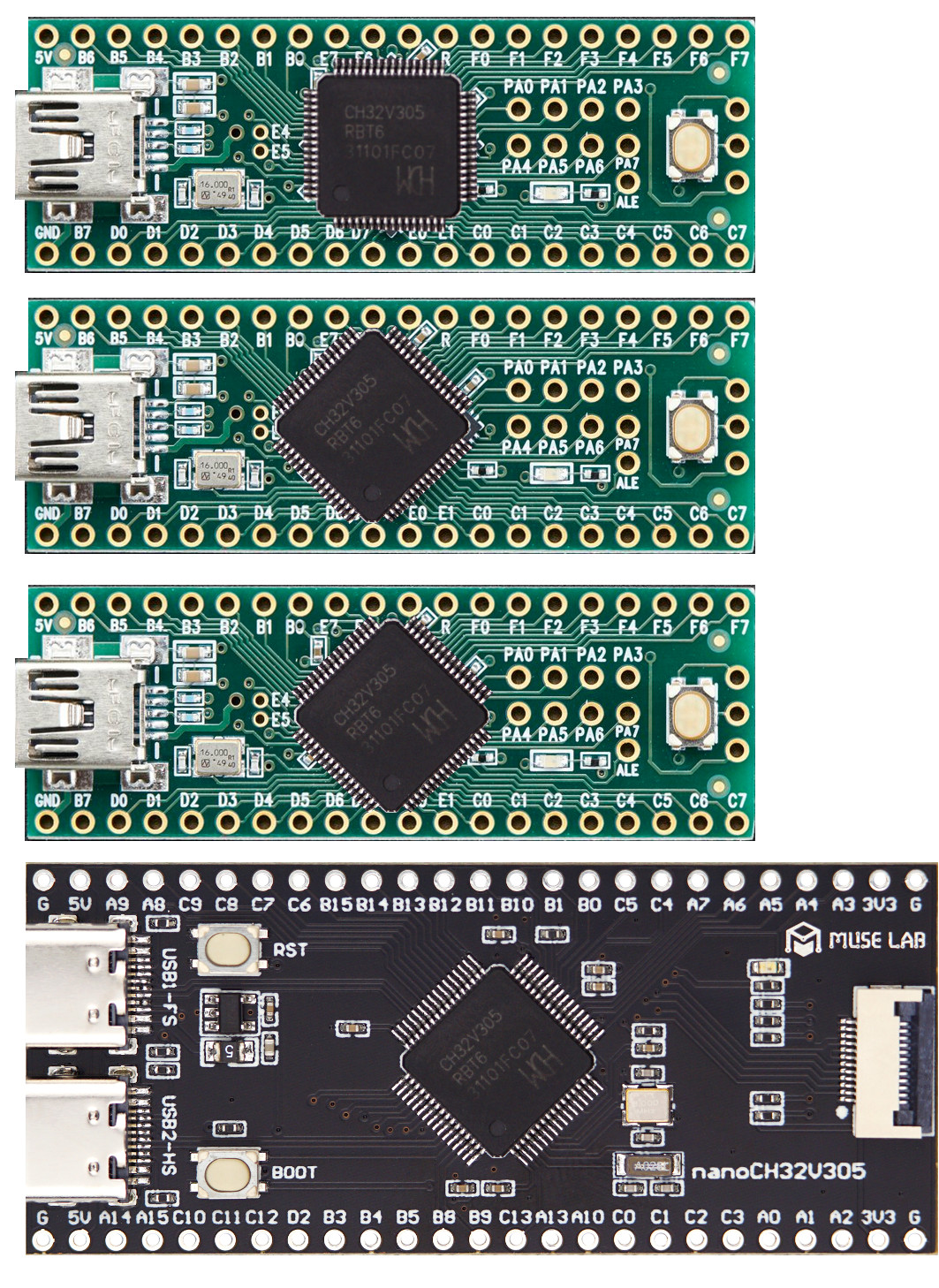

I recently found what looks to be a "dream" controller: the WCH CH32V305RBT6, in the form of Muse Lab's "nanoCH32V305" breakout board. The board offers 42 GPIOs, all of which are exposed on the outer edge of the board and only one of which is encumbered (onboard LED), a USB-C connector, and can be programmed without a special cable/tool. It's also six US dollars (or about 11 by the time postage from China is considered), so significantly cheaper than the Teensy++. I'm also a fan of WCH's generally zany product line; I spent a lot of last year on a hobby project using their CH375/376 "USB disc to random 8-bit bus" part.
So I had two problems. First, while the pinout is convenient for a scratch build, it's useless for an existing PCB, and I wanted to at least proof-of-concept it as capable of driving a full 130% board. Once I had gotten it working with a hard-wired 5x4 macro pad from my parts box, I prepared an "interposer" PCB: you attach pins on the bottom in a layout the size and shape of a Teensy++, which are in turn wired to holes you route to the nanoCH32V305. This was the smaller problem; throw $10 at JLCPCB and you've got more of them than you'll ever need. I was able to wire up one of my existing PCBs, and it worked with the same bodges you have to apply to the Teensy++.

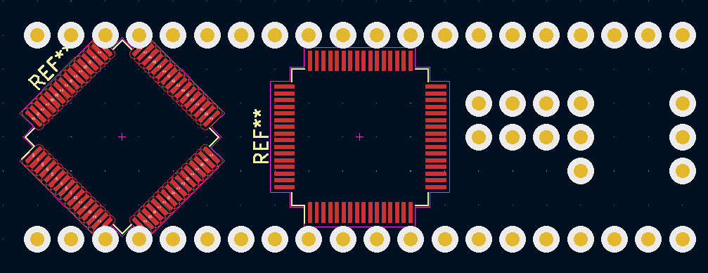

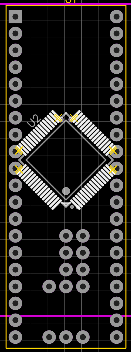

Spending two minutes playing with footprints in EasyEDA shows it might be doable, but a tight fit. Basically, the footprint for the MCU is large enough that pins extend to the Teensy++ pin footprints.
clearance issues.PNG (73.83 KiB) Viewed 6783 times
Possibility 1: Modify the footprint with shorter leads. Not sure if this actually reflects actual size of the part though, there may not be enough space to play with.
Possibility 2: Accept the conflict, likely four pins will contact if you rotate 45 degrees. You're stuck with those pins being specifically mapped to those Teensy++ pins. This may not pass any sort of automated DRC, and then you probably have risks of desoldering or fouling those pins on the MCU when you try to solder those pins.
Possibility 3: Continue to riff on the two-PCB interposer idea-- one PCB just holds the compatibility pins, and is large enough to support sockets "beyond" the Teensy++ footprint, and the other is large enough to hold the replacement MCU with easy routing. I made my original compatibility-pin board stupidly, adding like 2cm of pointless "panniers" with labels indicating pin mapping so it would be easier to understand, but which dramatically increase clearance requirements. This should be a document instead, and doing so reduces the needed footprint. You also have way more options for the "second PCB"-- I was just trying to use the canned nanoCH32V305 product there, but you could design it with, say, pins on 3 or four sides, or double banks of pins, to reduce its overall size.

If you rotate the MCU back instead of rotating it 45 degrees then it looks like it might just fit. It’ll require some clever routing, but maybe?
BorutP
26 Feb 2023, 12:19
Scarpia wrote: 26 Feb 2023, 08:52 If you rotate the MCU back instead of rotating it 45 degrees then it looks like it might just fit. It’ll require some clever routing, but maybe?
I agree, if it is placed without 45° tilt, it should fit fine but tight. Side pins routed and viad under mcu.

26 Feb 2023, 13:59
I superimposed the controller from the pic of the nanoCH32V305 board onto a pic of the Teensy++.
I cut out the controller from the pins of the controller: not the solder pads/footprint, so you'd have to imagine there being longer solder pads in places where appropriate, and shorter when not.
(the arrangement in the middle is kind'a useless though, I'd admit)
Teensy++ with CH32V305RBT6.jpg (589.03 KiB) Viewed 6648 times
The pinout of the package is important.
:!: If you'd place it diagonally, then the pins in the corners that intersect the board-pins solder pads there would need to be GPIO pins.
:!: If you'd place it horizontally then there can't be any pins on the top and bottom sides that would need to be connected to any decoupling capacitors - because you can't place any there!
