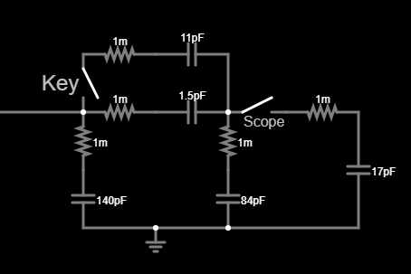

So, after measuring the encased ESSK, looks like actual key inside the keyboard looks like this (CircuitJS model), electrically:
Row and column capacitances to ground seem to be directly proportional to the PCB trace length. Mutual capacitance between row and column seems to be DOMINATED by row-to-ground and column-to-ground capacitances (connected in series). There _might_ be electrically-long-line shenanigans involved, but their effect shouldn't be _that_ bad, unless you do something stupid like overdriving the line or placing current-limiting resistors way too far from the driver circuitry, in which case ringing might kill you.
However, CircuitJS shows 50mV released/380mV pressed (62/455mV with "scope" switch off) with these parameters, and the only thing that affects output voltage is that 84pF capacitance. To bring things to observable in reality 20/150mV, I had to increase the receiving end capacitance to 260pF.
