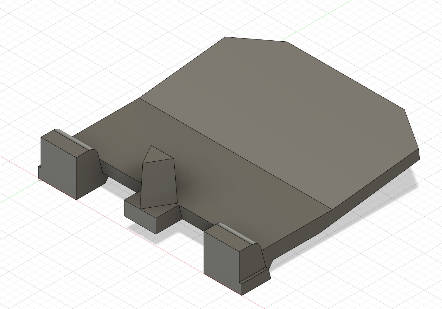

Hello again,

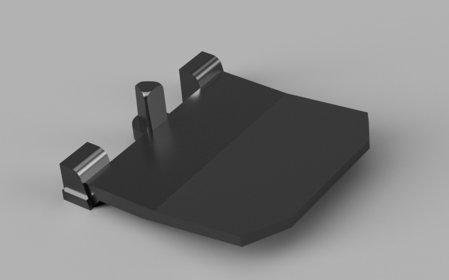

Here is the 3D model of the F flipper which I have made :)
Next step is to print it.
(check following posts for the 3D files)

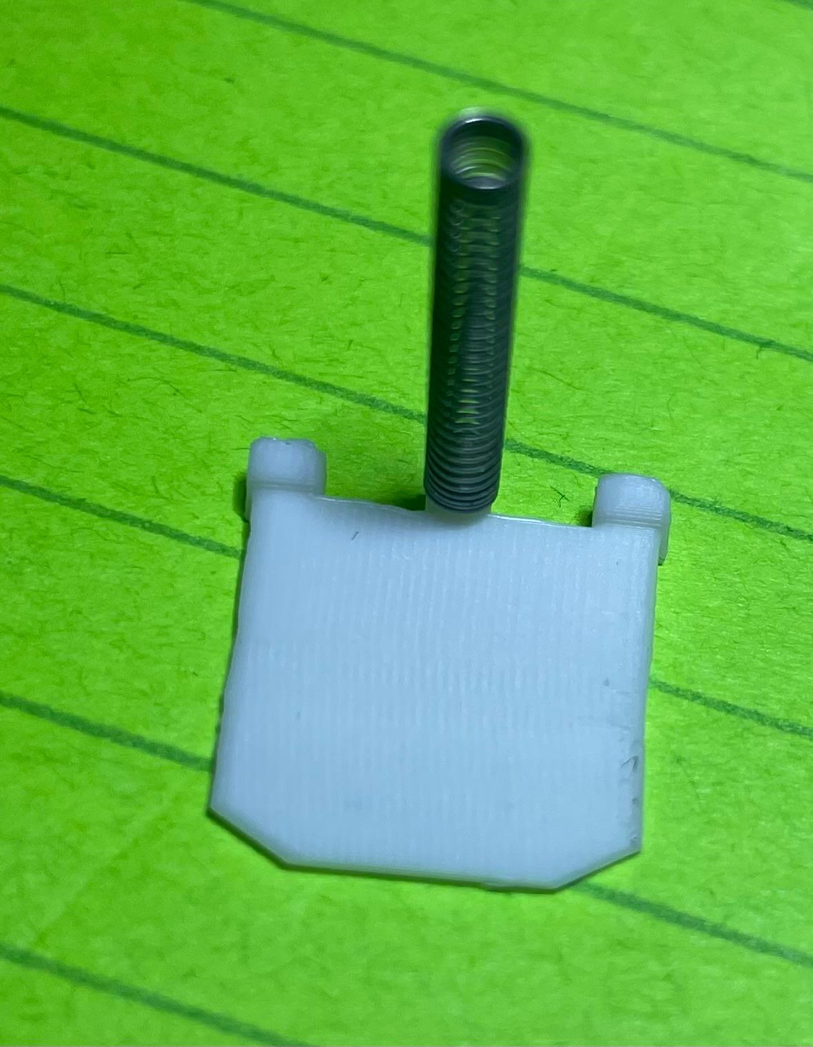

Hello,

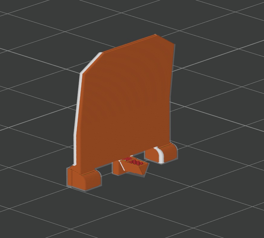

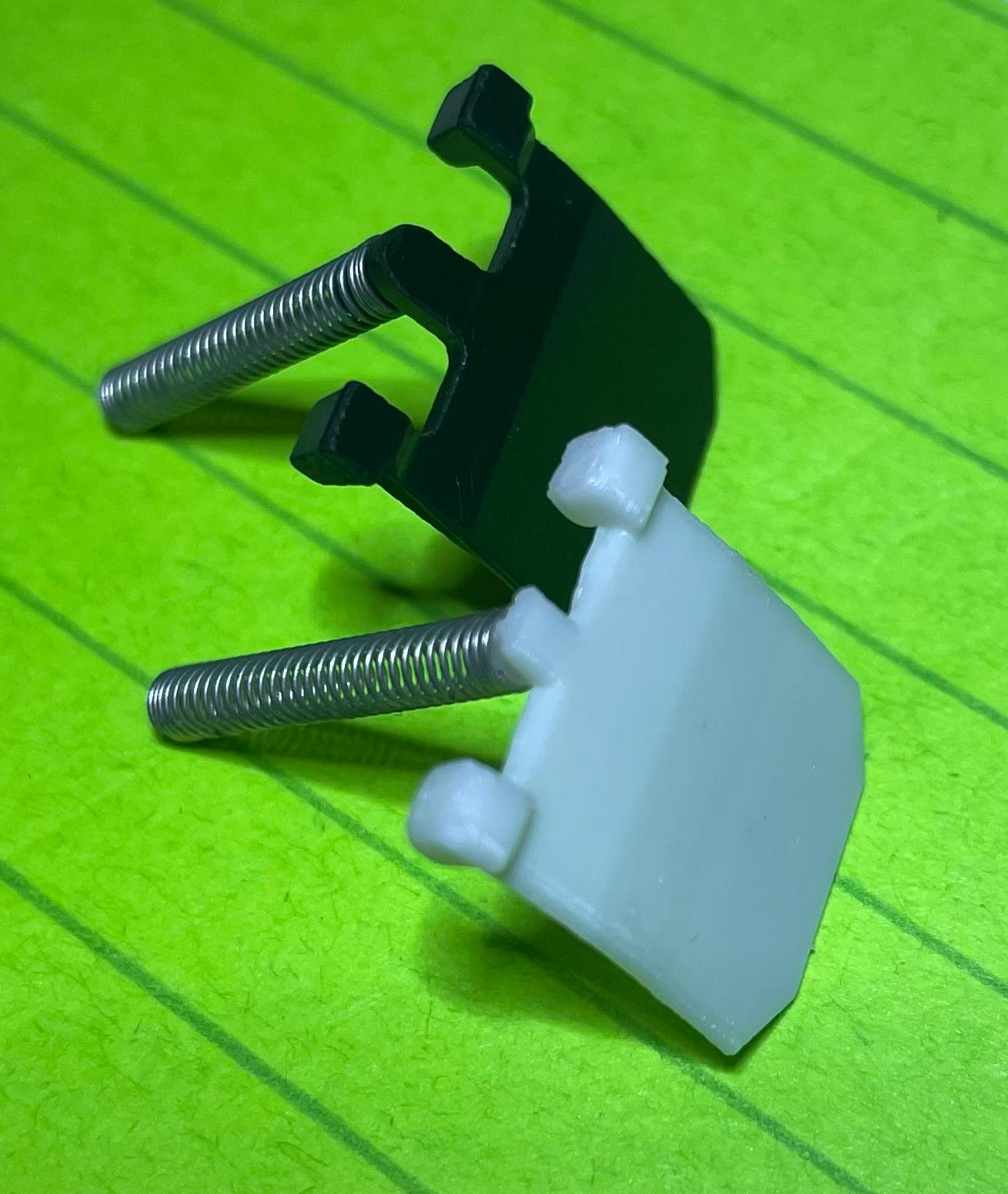

I have succeeded in creating a model which works. Check the compressed video (I will post a better one, I do not have time to do it now):
It flips.zip
(222.01 KiB) Downloaded 1403 times
Attached you can find the fusion360 file Version 5 (zip)
I also include pictures of the design, made for 3D printing and the way to print it. I also include the print project (zip)
To avoid any kind of support I have used glue in the 3D printed bed.
The printer is a bambulab XC1. I have used PLA in this test
The result is solid and good.

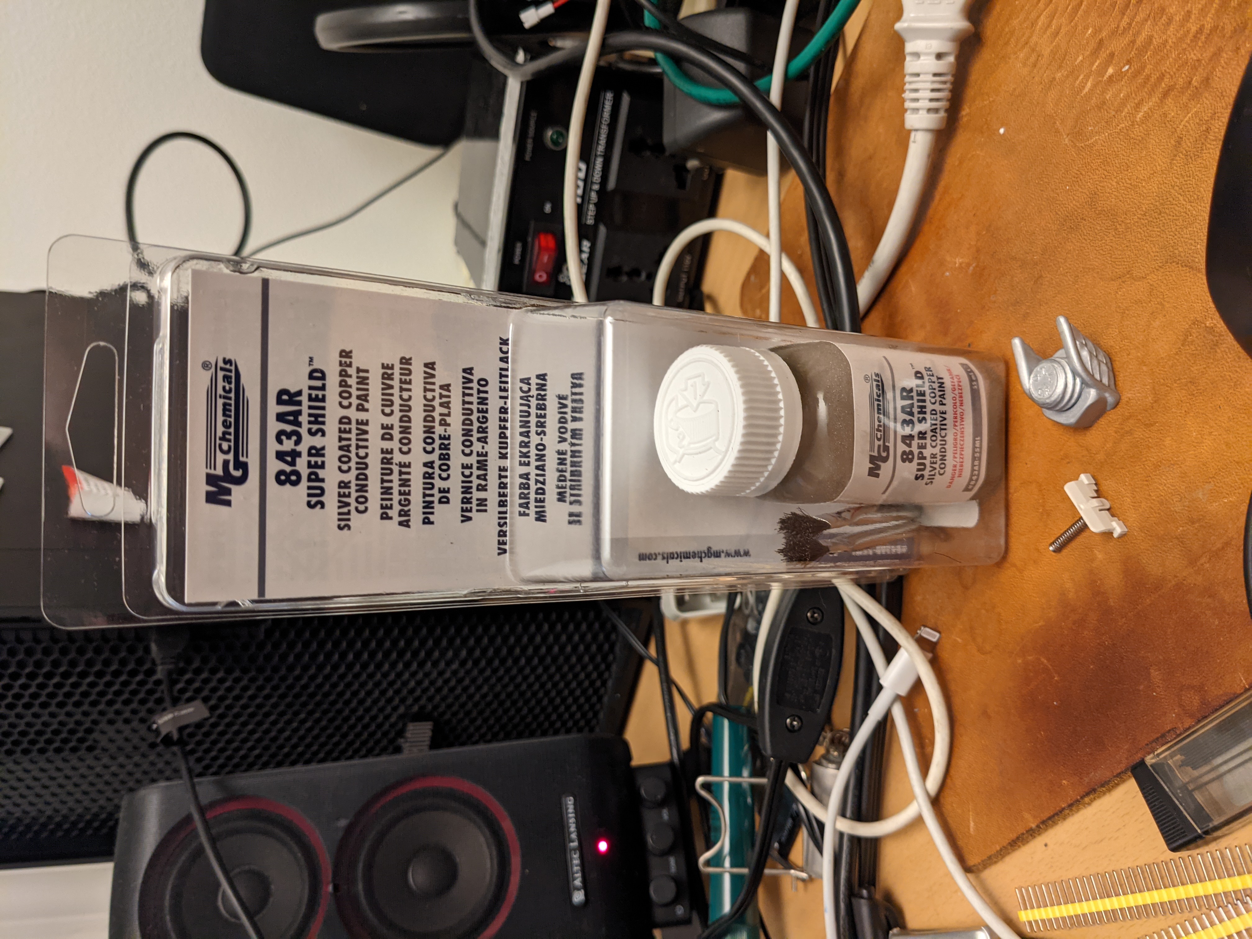

..also, since I'll have whole 55 grams of supposedly-acetone-based conductive paint along with a hundred-ish model M flippers - I can actually try and make a model M filpper capacitive by painting the underside.
it is extremely likely that PCB will need to be slightly reworked (basically, by moving the pads up almost to the round dots) - but if the point of FSSK is to have capacitive sensing and NKRO, not the sound of the model F (the feel is already virtually similar TBH), it can be achieved by spending $40 for the paint and several hours grinding out the nubs. That 55ml can is supposed to last ~21700 cm2 (3360 square inches for you americans), which is what, 20 keyboards worth? No need to electroplate - electroplating is for decorative parts, not supposed to be banged on PCB for thousands of times, plus it can produce fumes way more toxic than acetone.
DMA
21 Dec 2024, 08:01

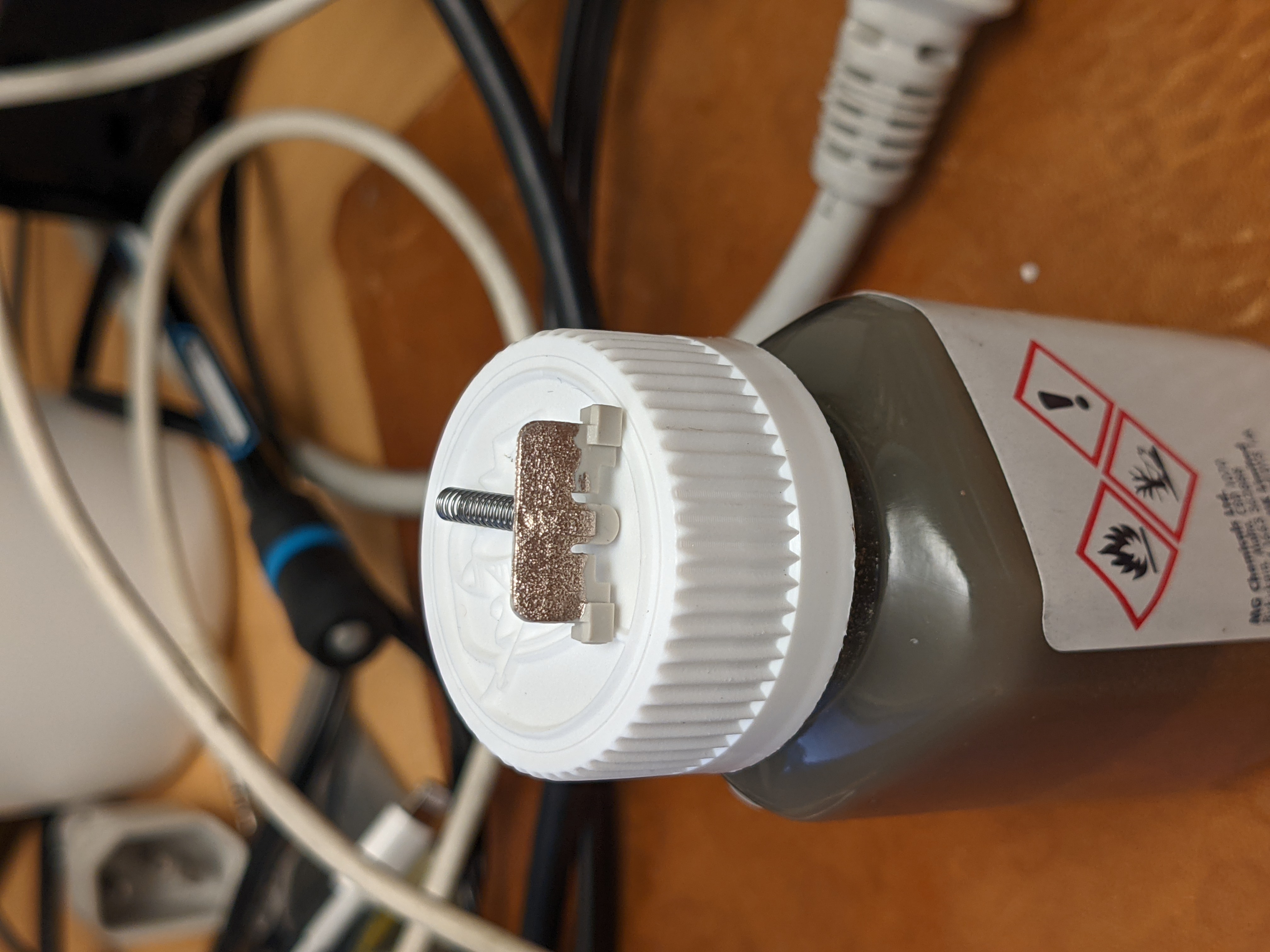

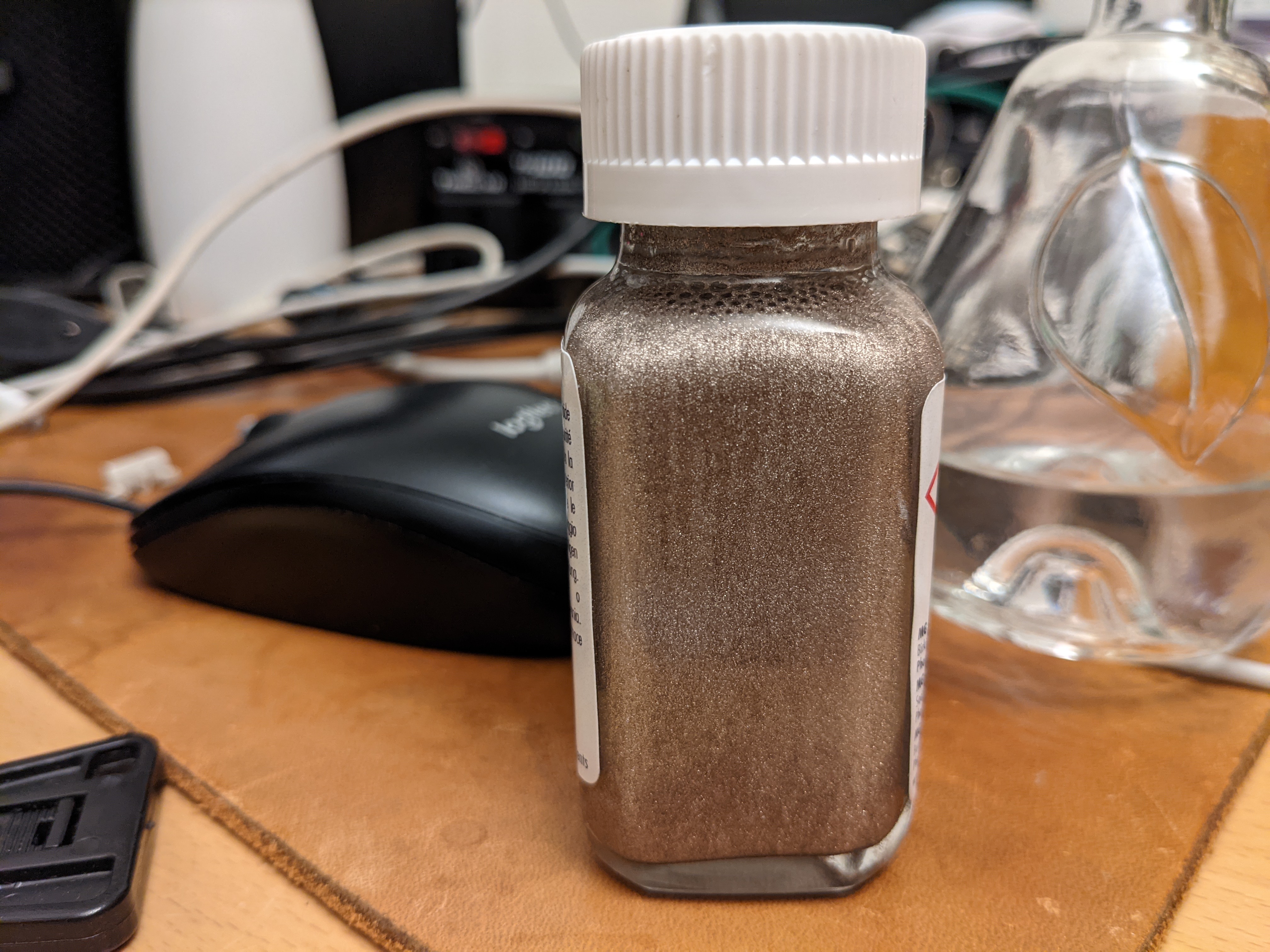

OK, I've got the conductive paint. It's acetone-based, settles really quick, looks pretty mesmerizing - like a snow globe - and is unexpectedly gold in color. I'm tempted to repaint my silver wingnut gold!
Whole thing settles in 10 minutes, and dries in 3. You can also see how good this stuff is by counting warning signs!
It's also REALLY fluid - touching surface of the liquid sucks those golden flakes into almost a centimeter of horse hair instantly. After drying on the brush, golden dust just flakes off the horse hair - so, I guess, adhesion won't be that great. I'm giving it about a day to fully dry out, then we'll see if it any good and how durable the coating is.
Overall, I think it will definitely work for painting uncured resin-printed filppers, letting it dry for 5 minutes, then covering with a layer of uncured resin and then curing the prints. Tomorrow we'll know if this is a viable technique for converting model M filppers into capacitive role.

24 Dec 2024, 05:08

Hi,
I am in contact with a company to produce the flippers from China.
Their question is:
Dear, what is the material and quantity of your products?
My answer is:
I would say that I need a first batch of 5000 but additional batches may be needed.
You may quote 3000, 5000 and 8000 and 10000
The material for this part shall be a CONDUCTIVE PLASTIC. .
I believe that plastic with CARBON BLACK will work.
The part is moving to change the capacitance of a capacitor underneath. If the capacitance is not changing it will not work
PLEASE NOTE THAT IF THE QUOTE IS ACCEPTED I WILL SEND YOU A PHYSICAL SAMPLE PART TO BE USED. The model that I sent you may not be 100% accurate.
Regards
Has anyone knows if there is a better material to be used ?
Cheers
