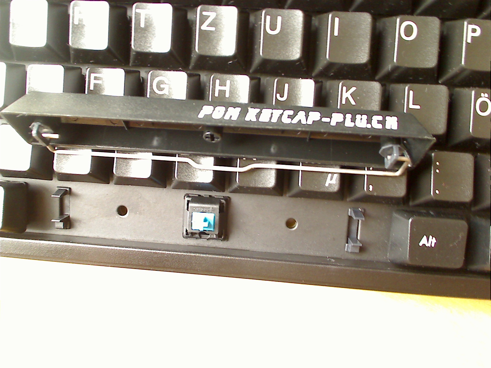

My only real problem is that stupid lasered Spacebar: thick bigass letters "POM KEYCAP-PLU.CN" on the front side. The keycaps sit extremely stiff so be very careful changing them.

I doubt the keys are coated. The spacebar isn't compatible with Filco, Cherry, Leopold or anybody else AFAIK. That's a bummer especially if you wanted to swap in KBC PBT keys.

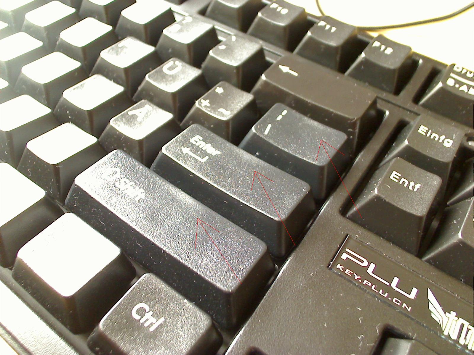

ripster wrote:I doubt the keys are coated.
You can see the difference of the shininess in the on the top 2 milimeters of the EnterKey, of the ShiftKey and the |\ Key. I think it is a defect of the sprayed coating.
Plu coating??
Plu coating??
Picture 3.jpg (253.44 KiB) Viewed 7548 times
Interestingly those three keys dos not match the color of the others. Interestingly my Cherries match the Spacebar, the Alt / Ctrl row of the Plu. But the difference in the real life is almost not noticable, my webcam is exaggerating.

ripster wrote: The spacebar isn't compatible with Filco, Cherry, Leopold or anybody else AFAIK. That's a bummer especially if you wanted to swap in KBC PBT keys.
Not sure about that:
POM plu Spacebar
POM plu Spacebar
Picture 4.jpg (461.51 KiB) Viewed 7548 times
There is a group buy on GH right now with plu keyset http://geekhack.org/showthread.php?1981 ... h-freebies, so you can ask them if the spacebar fits.

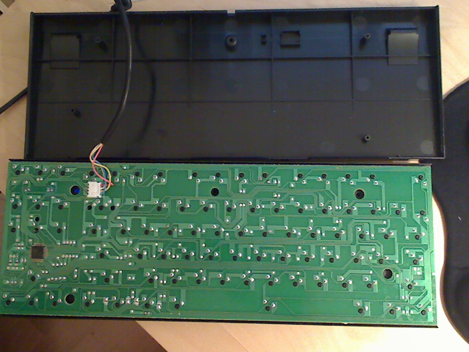

The PCB seems to be an exact copy of the Filco layout.
Picture 5.jpg (517.53 KiB) Viewed 7378 times
Replacement PCB and steel plate (including ISO, Cherry keys and fully programmable) will (hopefully) be made available by some guys on http://geekhack.org/showthread.php?2018 ... rest-check
