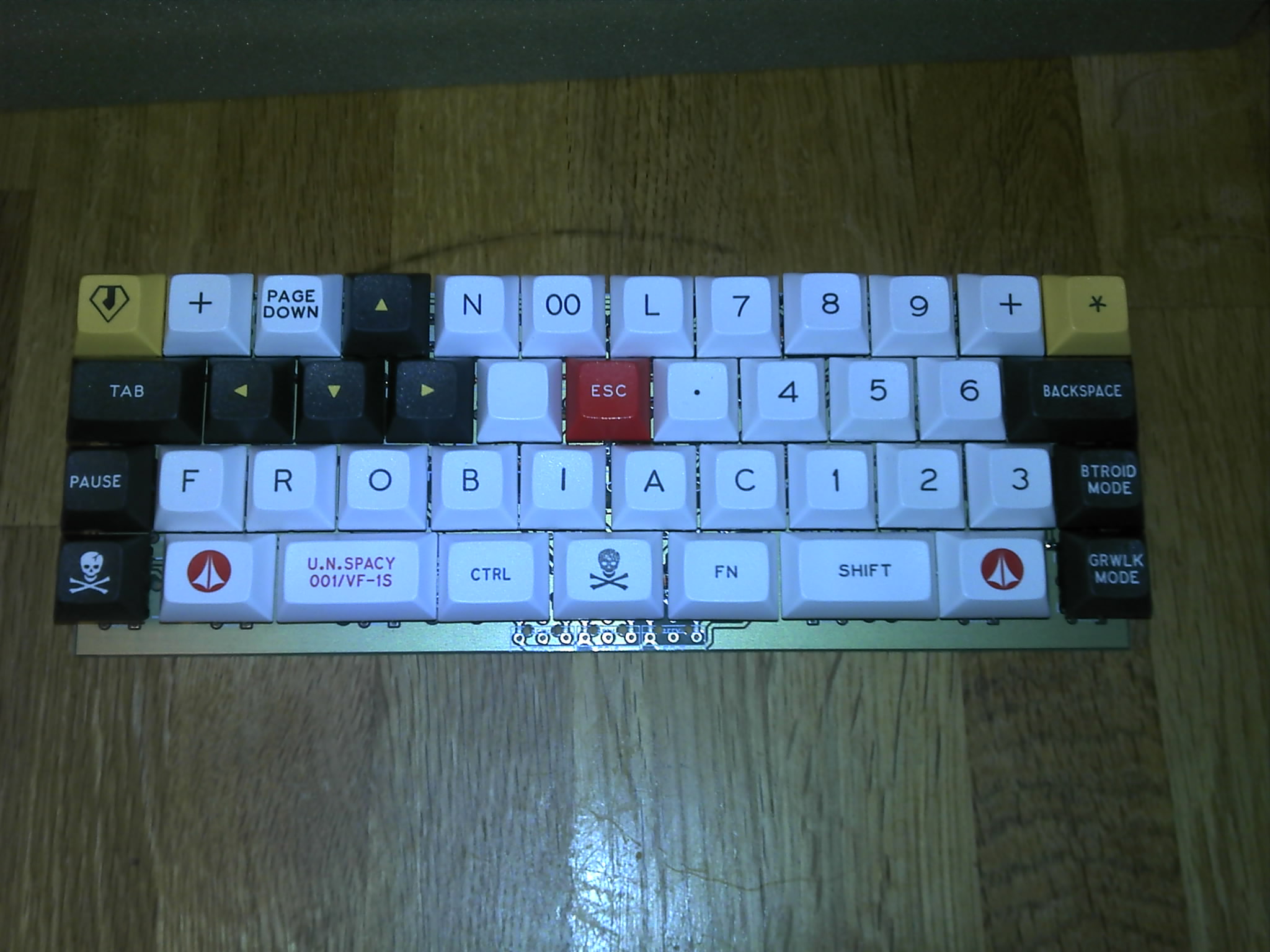

Today I received the first prototype from 7bit, in about 2 hours the keyboard was ready, the firmware programmed and the teensy flashed.
Here you go:
I wish I could say I'm writing on it right now... problem is... the keyboard doesn't work :P I'll check it tomorrow and keep you updated. At this stage I don't know if it is an issue with my code or with 7bit hardware, but surely it looks sexy :)

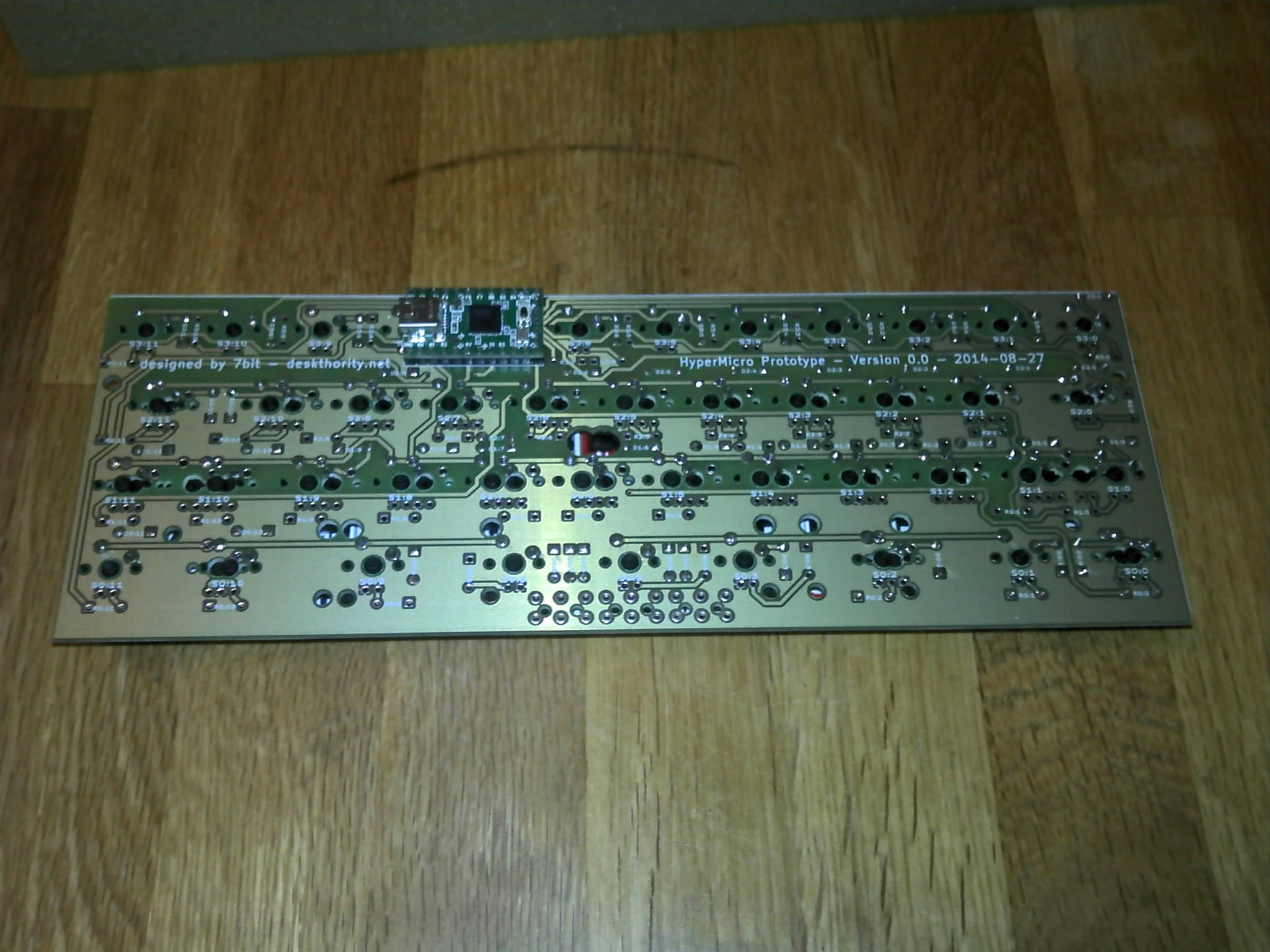

At the backside, I can see some terrible thing!
The gold stuff is all connected to GND and most solderpads are shortened against it with the solder.
:o
The gaps are too close.
:cry:

do you need a better picture?
actually... haven't you noticed the same on your samples?!
16 Dec 2014, 21:58
Yes, please full resolution of the backside!
In theory, if you are very careful, you should be able to solder such that nothing shortens.
:P
Please keep your soldering iron hot, while waiting for the HyperMicro Version 0.1 ...
:roll:
edit:
I've found out how to make the gap larger, just need to order new prototypes ...
:cool:

I'll have a look at it tomorrow, and take better pictures. Maybe I can fix it somehow.

ok, my bad.
I soldered the diodes on the back and I flipped anode/cathode :P
Everything seems to be working apart from the three microswitches on the bottom

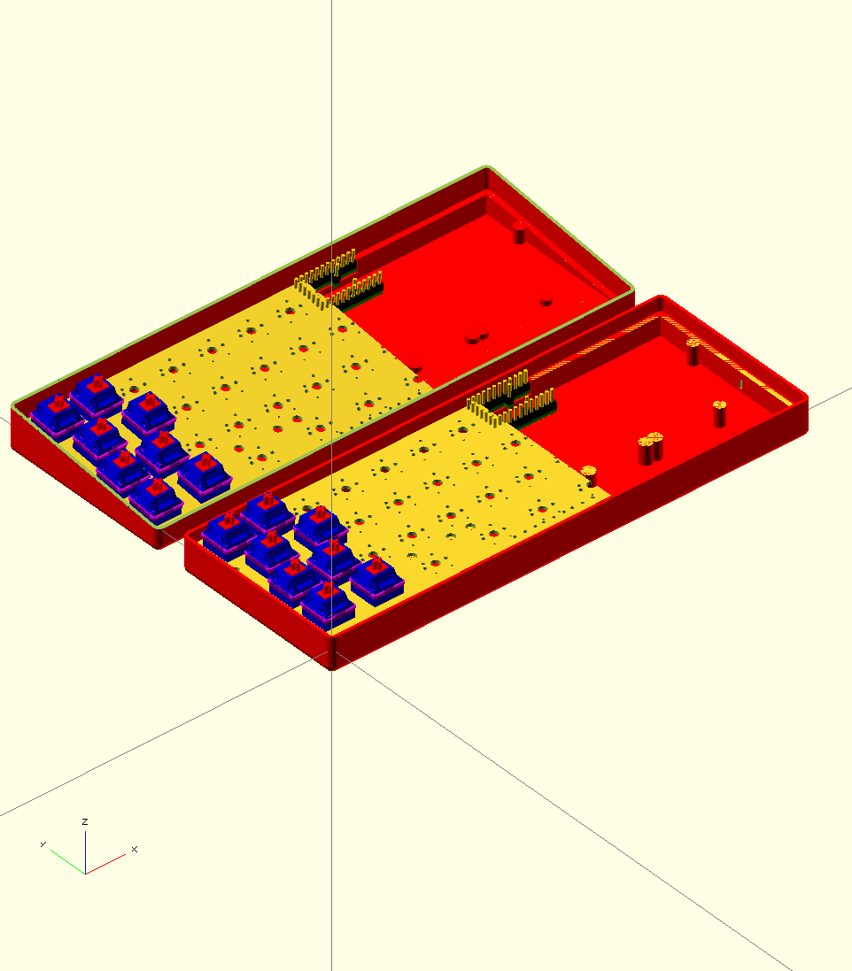

Next up: Case prototyping for flat or tilted mount.
19 Dec 2014, 14:52
Tilted! So long as it's a fairly slim angle. (I never use the extension legs on any of my boards. I like them low, but not quite flat.) Looks much better than big feet.

The final design could surely allow both with a set of optional spacers to be inserted at the screw supports and edges that would put the pcb at level. Mouse button cut-outs mean some work then, but should be doable modular enough, too.
But an optional trackpoint would mean the PCB has to sit even higher, while an extenal teensy solution would allow to design an absolute minimal height case - options over options, gotta love that prototyping stuff :-) But first I need to see if all dimensions are correct to proceed...
